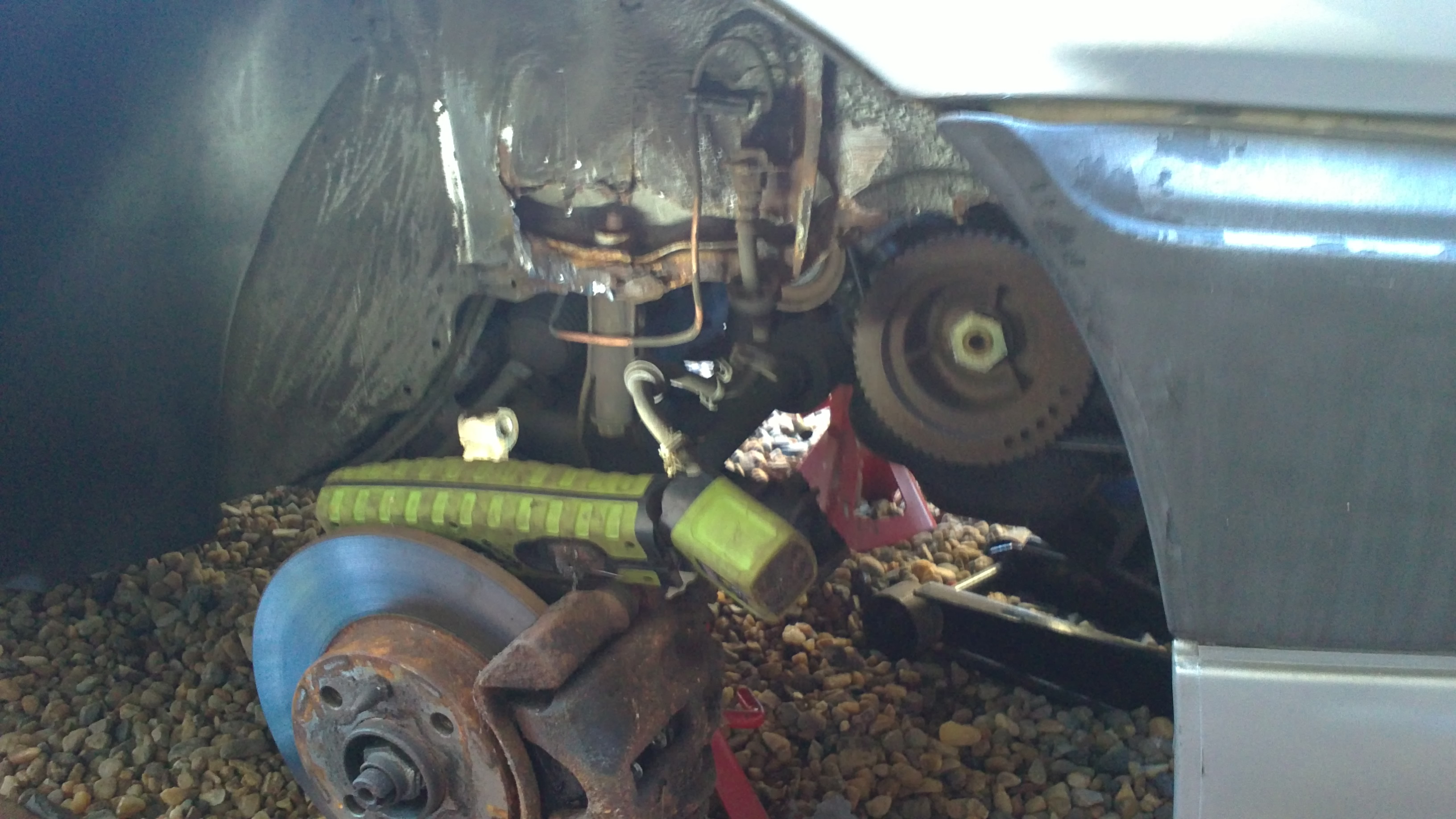

Following the demise of the red Tipo (see previous rust thread) I obtained a new one and this is work to date. This one had a fairly long MOT failure list including excessive corrosion on both front suspension mounts, 1 rear seat belt mounting point and an advisory on the other. However the 'Liberty' special edition with air-con in SX trim was tempting and the previous owner had fitted new springs and had some tidy welding done previously. So what needs doing...

The inner arches are not too far gone but there was more rust at the top and the back to tackle later.
The holes behind the front struts will be the worst to fix, just above the sub-frame mounting bolts. Both my Mk11s suffer this.

The welding looks very nice 👍

I cannot remember when I saw a Tempra in the UK and another Tipo 1 I last saw around 2005. For this repair, I found it best to remove all the old plastic/rubber strip. There will be some metal locating tabs left proud, but these stick great, even when running over those. I might buy another set and punch holes at the relevant locations so it sits absolutely flat, but even now from the outside, they look like the original item. As I say it is wise to do this, as the water is running down and collecting. I just hadn't seen these parts were damaged, until I looked to see the cause of the rust here.
This year the Liberty finally lived up to it's name. MOT passed and a trip to AutoItalia North followed. This was an enjoyable day with some lovely cars and a thumbnail in Autoitalia mag later, surrounded by much more exotic italians. The engine light (scan says TPS ground wire fault) disappeared, unless it was solved by greasing the idle motor plunger. The flickering oil pressure light at higher temps continued to stress and depress, after all the work done. Expecting no change, I tried a different switch and have not seen the light since. :D A minor car on car collision on the driveway will require a new rear light (should see the other car....).
