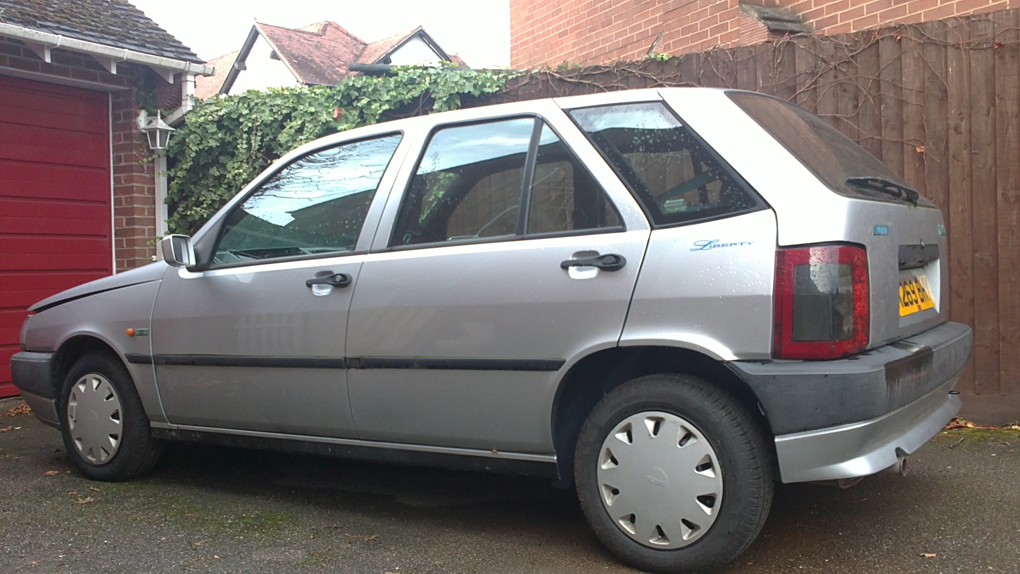

Tipo (Classic)  New Tipo (old model!)
Following the demise of the red Tipo (see previous rust thread) I obtained a new one and this is work to date. This one had a fairly long MOT failure list including excessive corrosion on both front suspension mounts, 1 rear seat belt mounting point and an advisory on the other. However the 'Liberty' special edition with air-con in SX trim was tempting and the previous owner had fitted new springs and had some tidy welding done previously. So what needs doing...

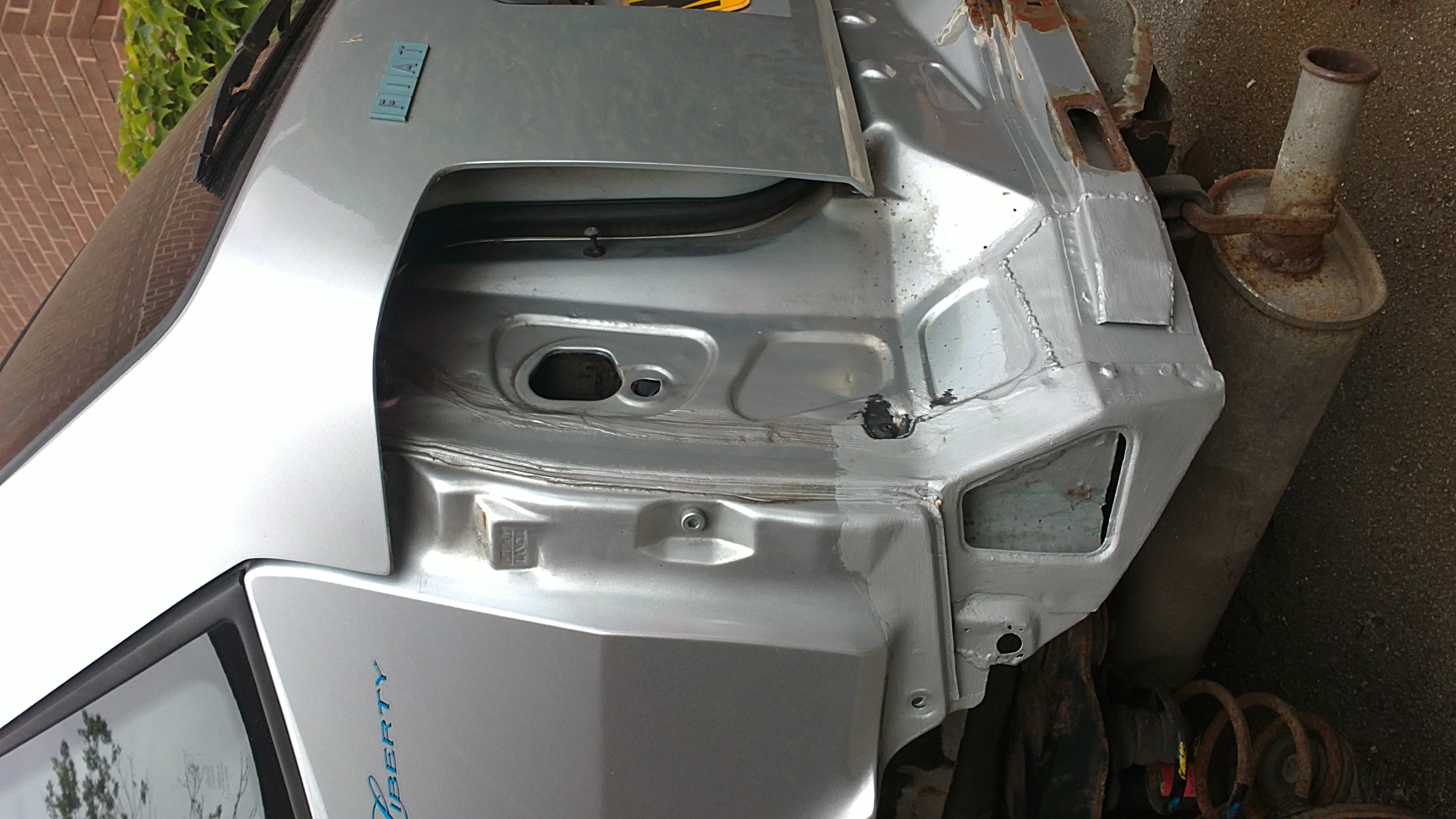

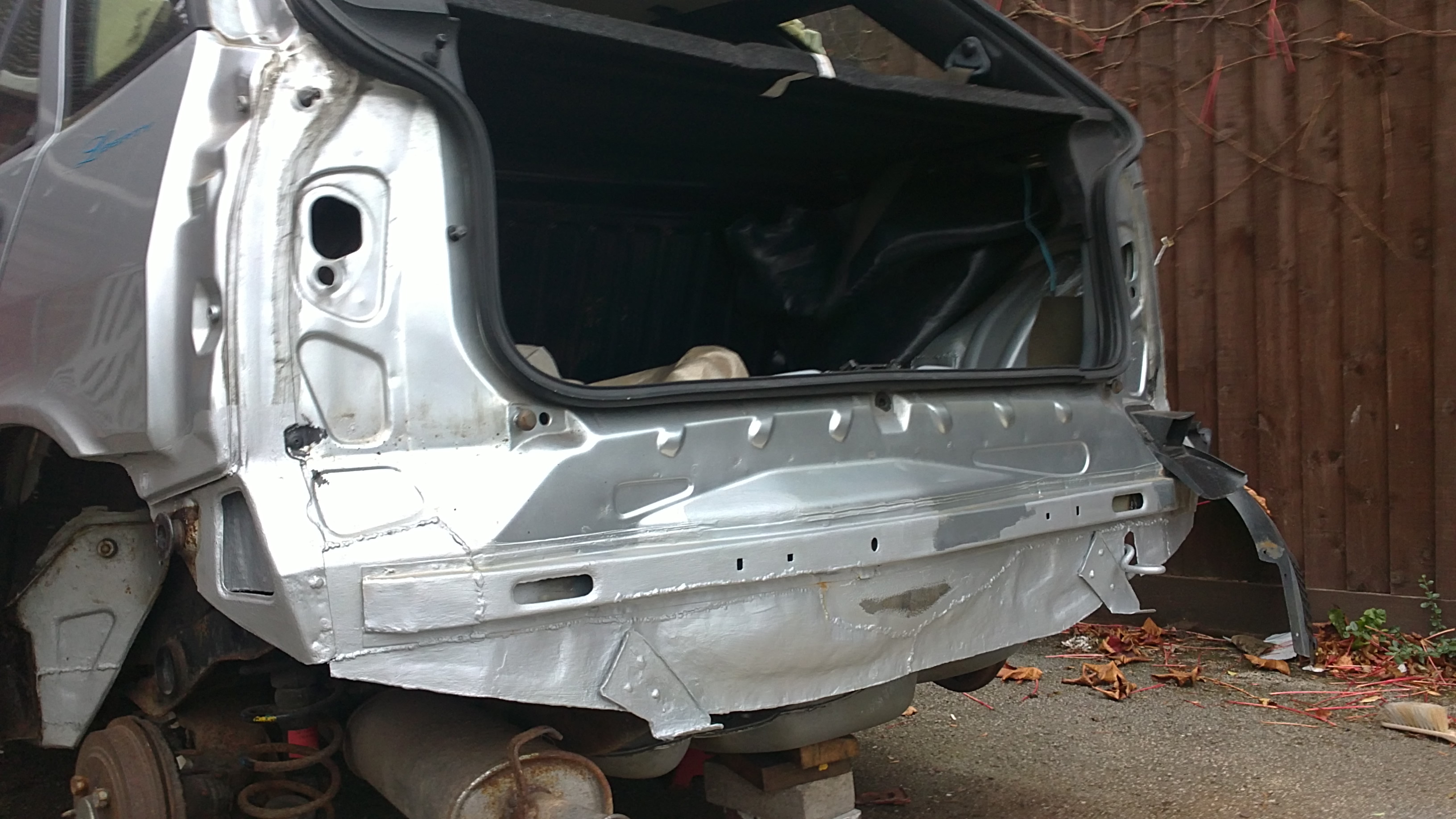

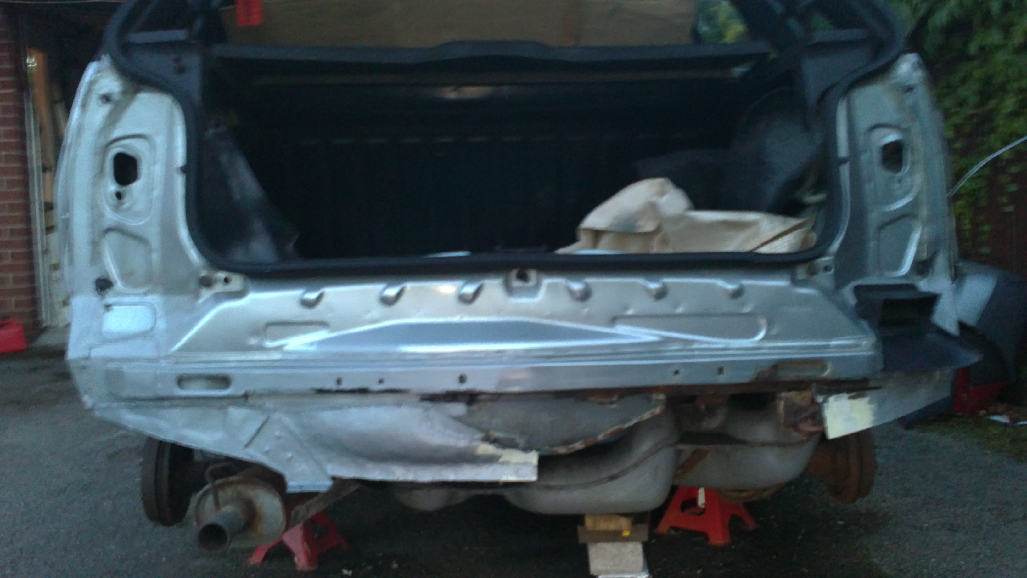

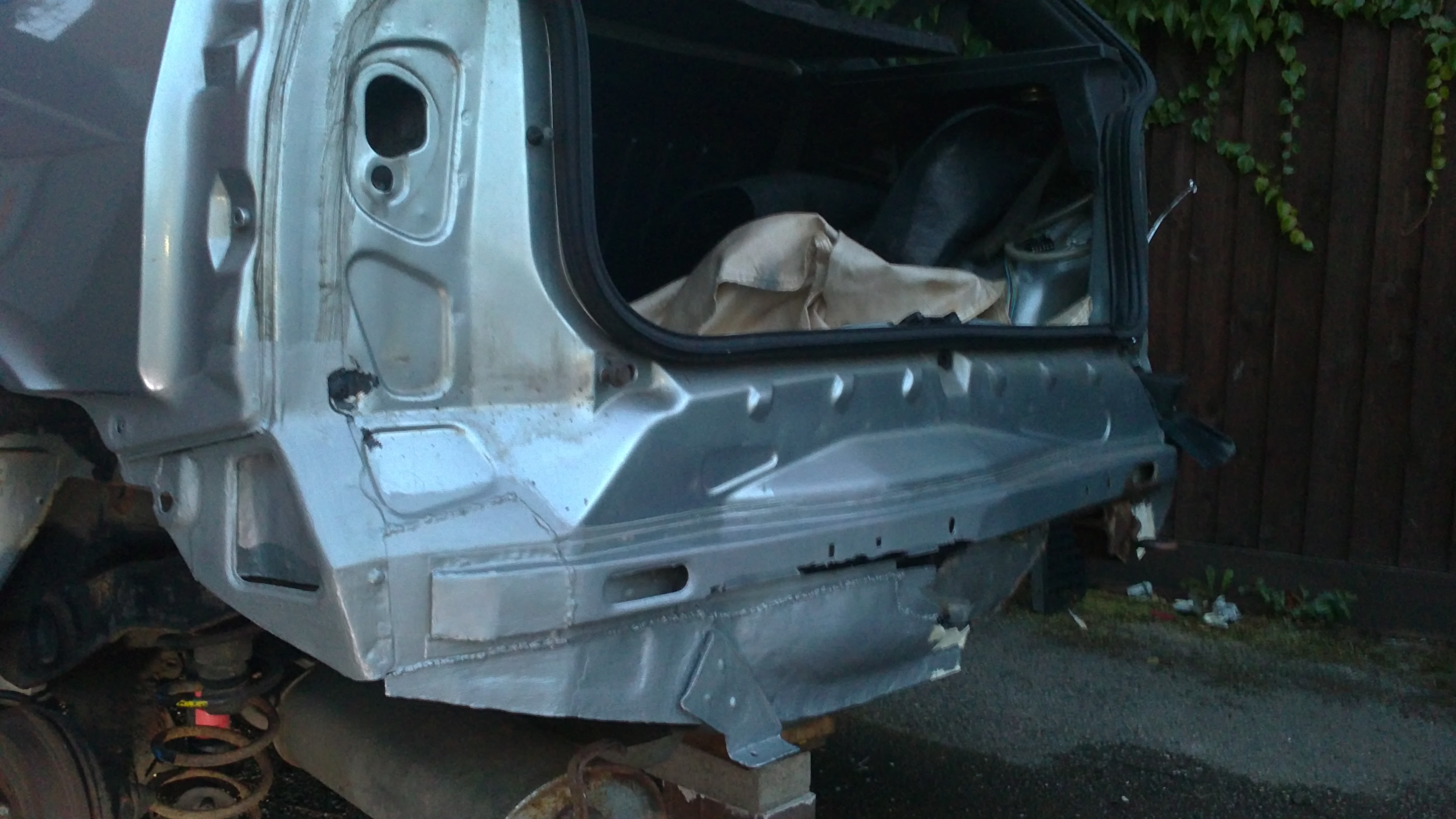

The rear valance is heading the same way as the red Tipo and cutting off and using the remade valance from the red one may be the way forward later on.

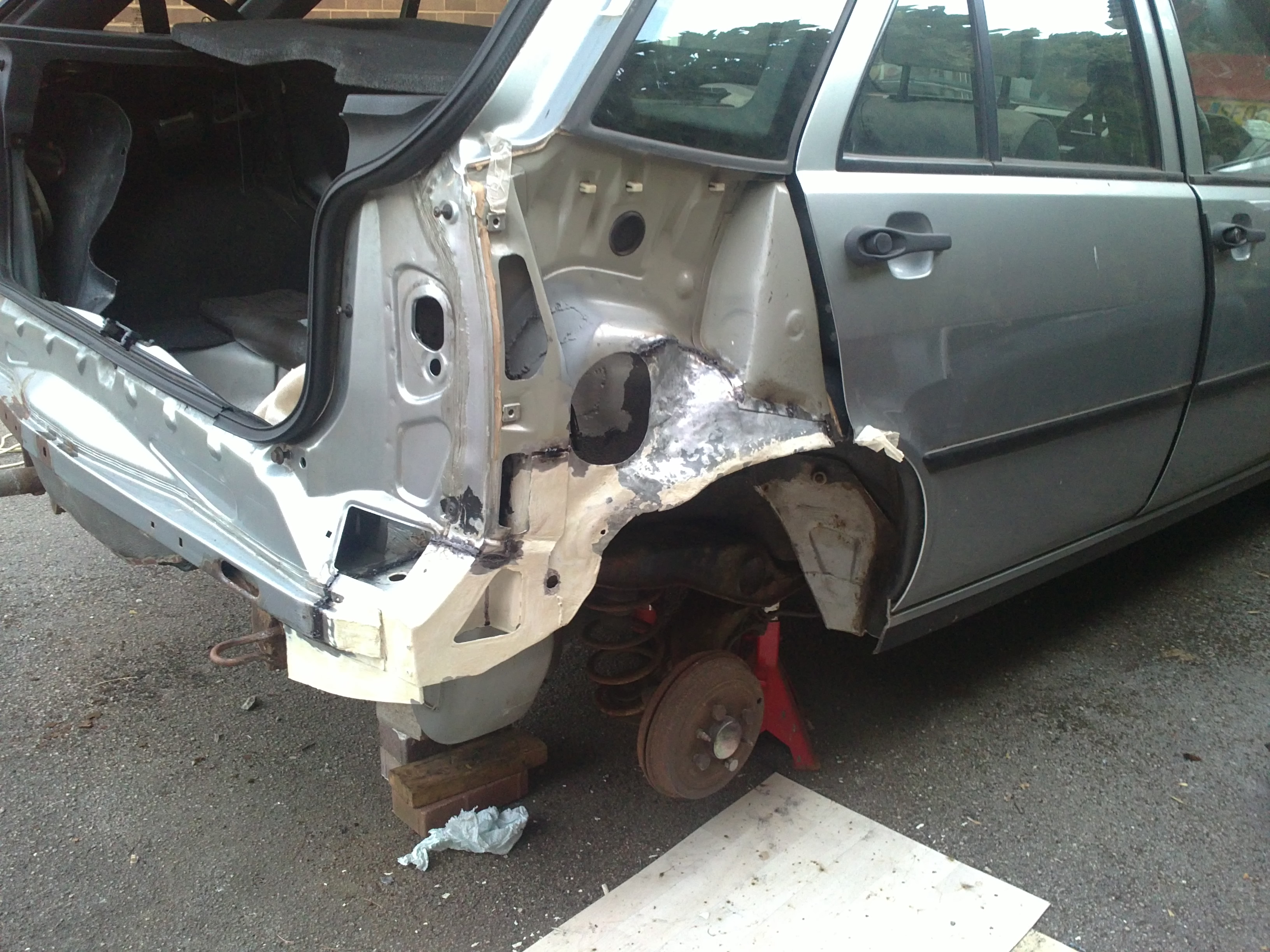

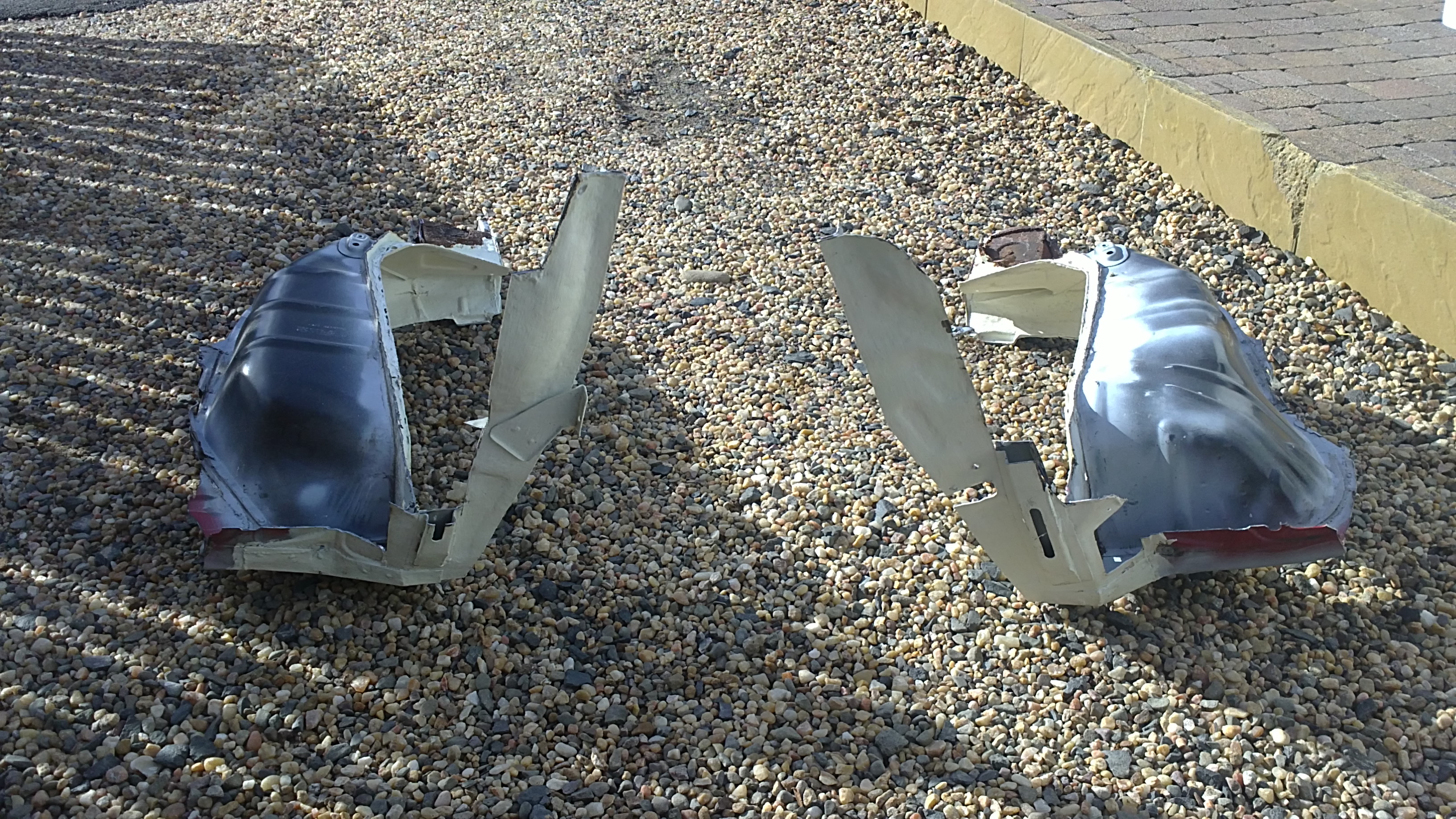

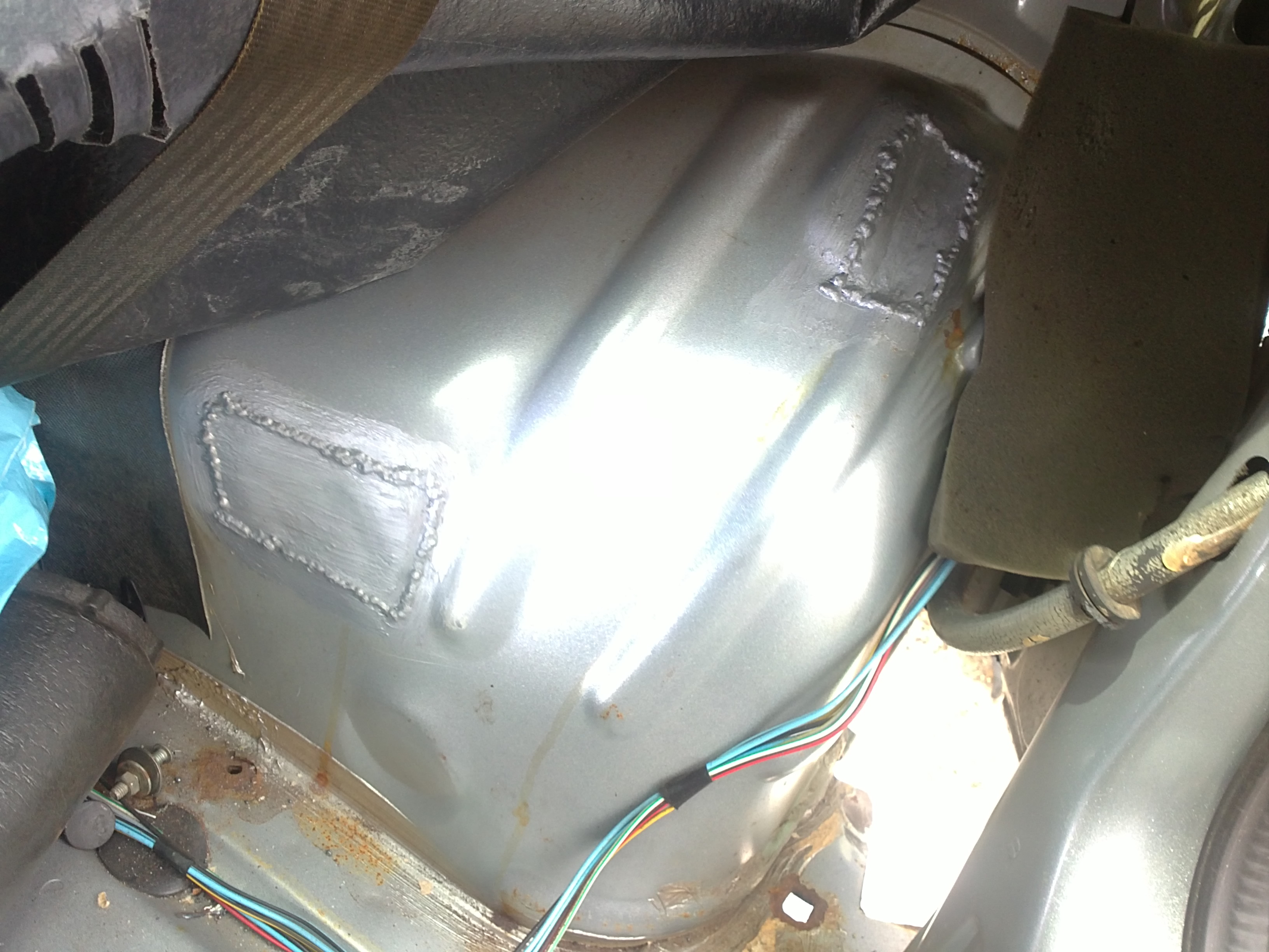

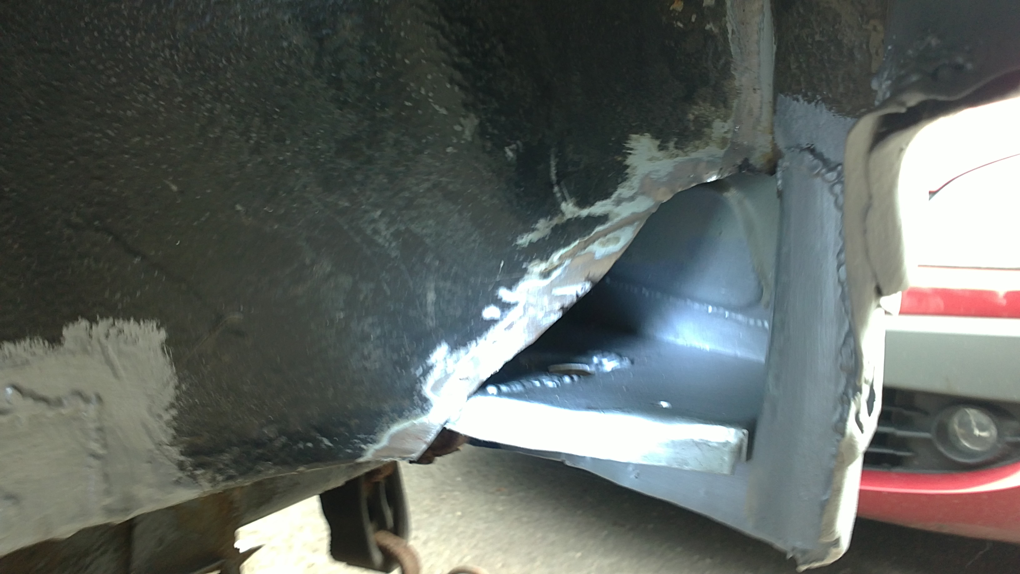

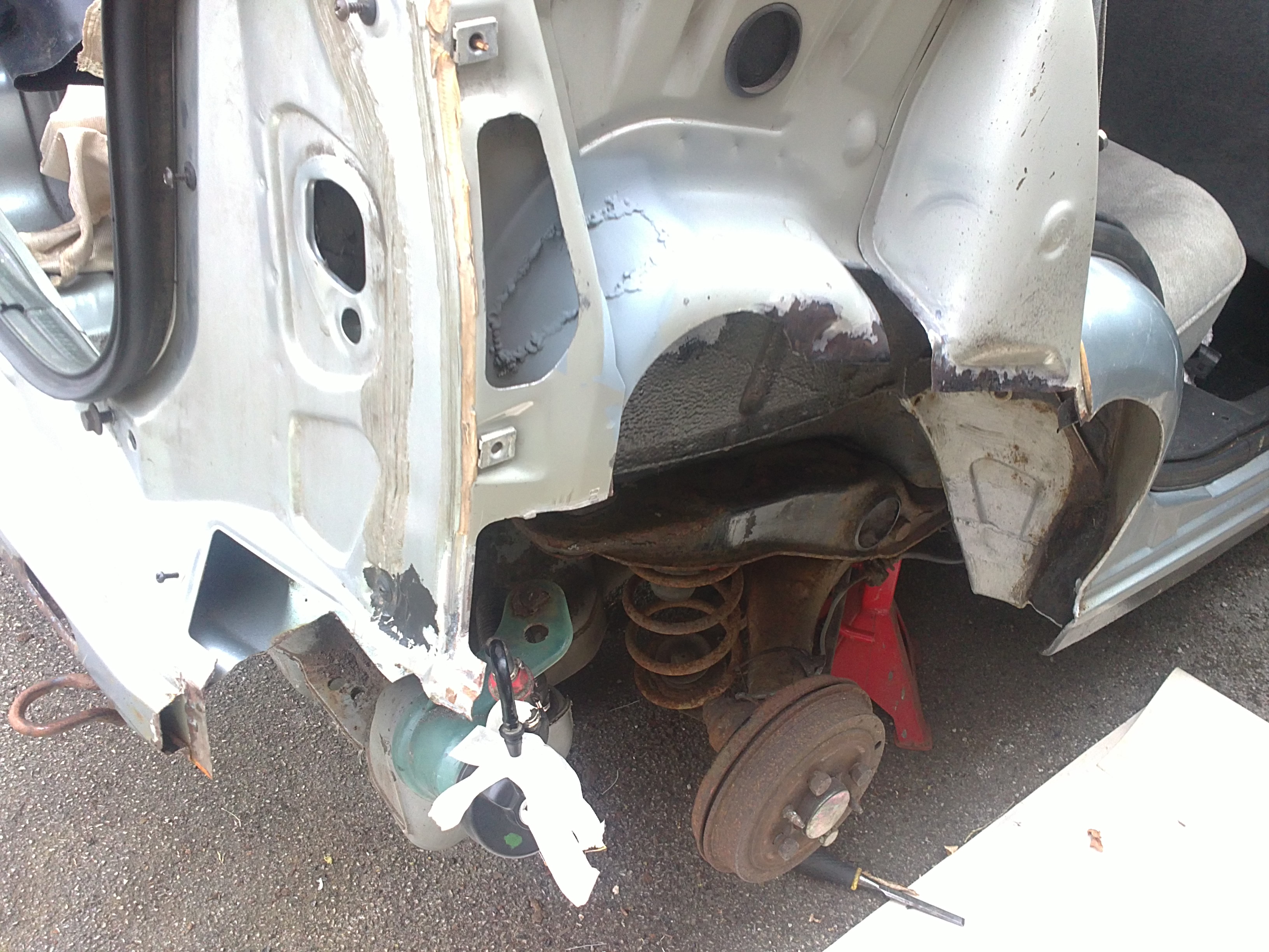

The inner arches are not too far gone but there was more rust at the top and the back to tackle later.
The holes behind the front struts will be the worst to fix, just above the sub-frame mounting bolts. Both my Mk11s suffer this.

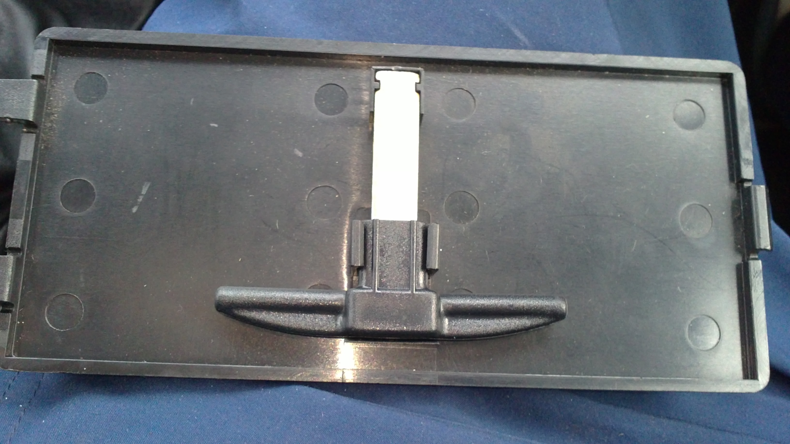

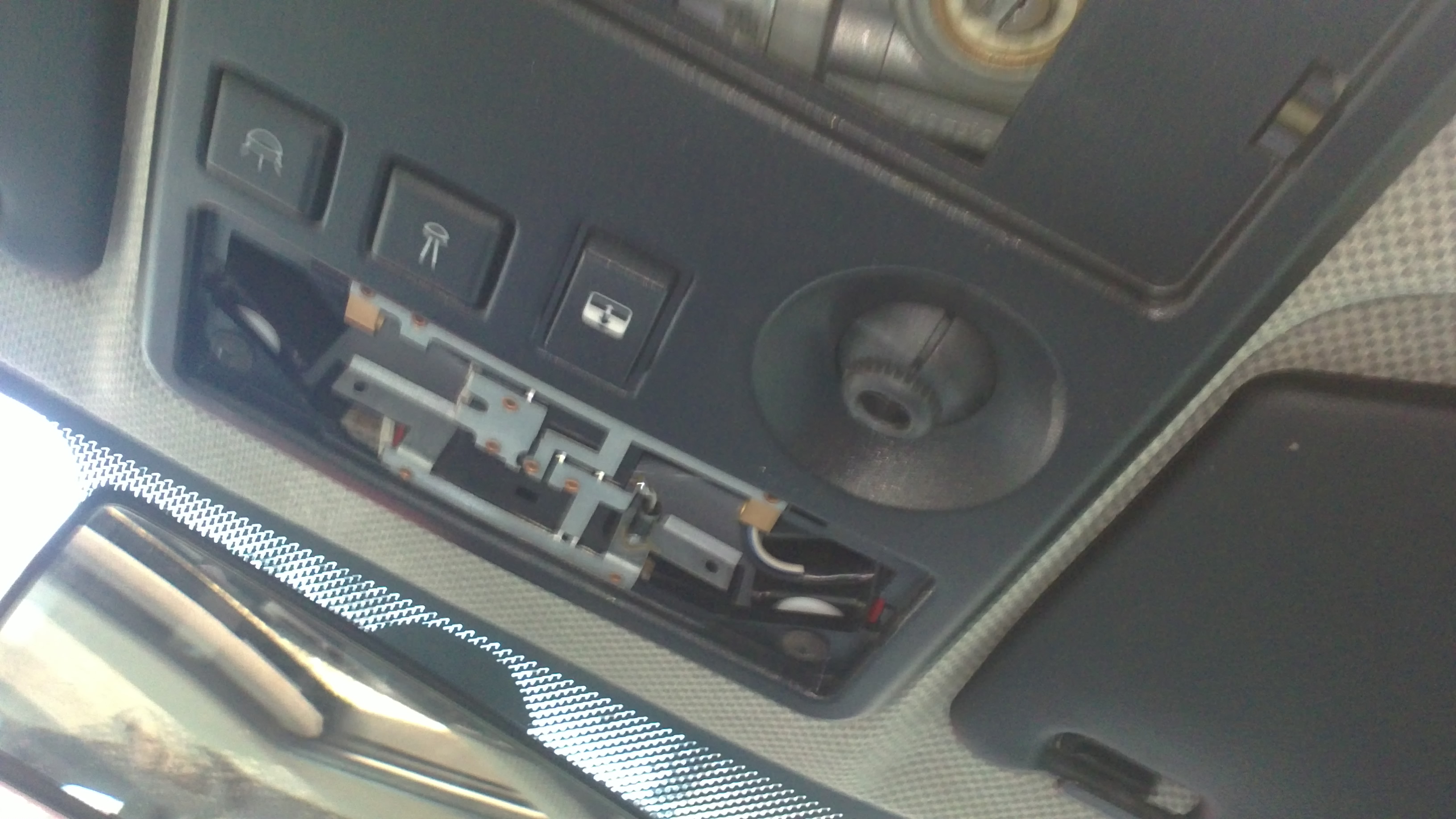

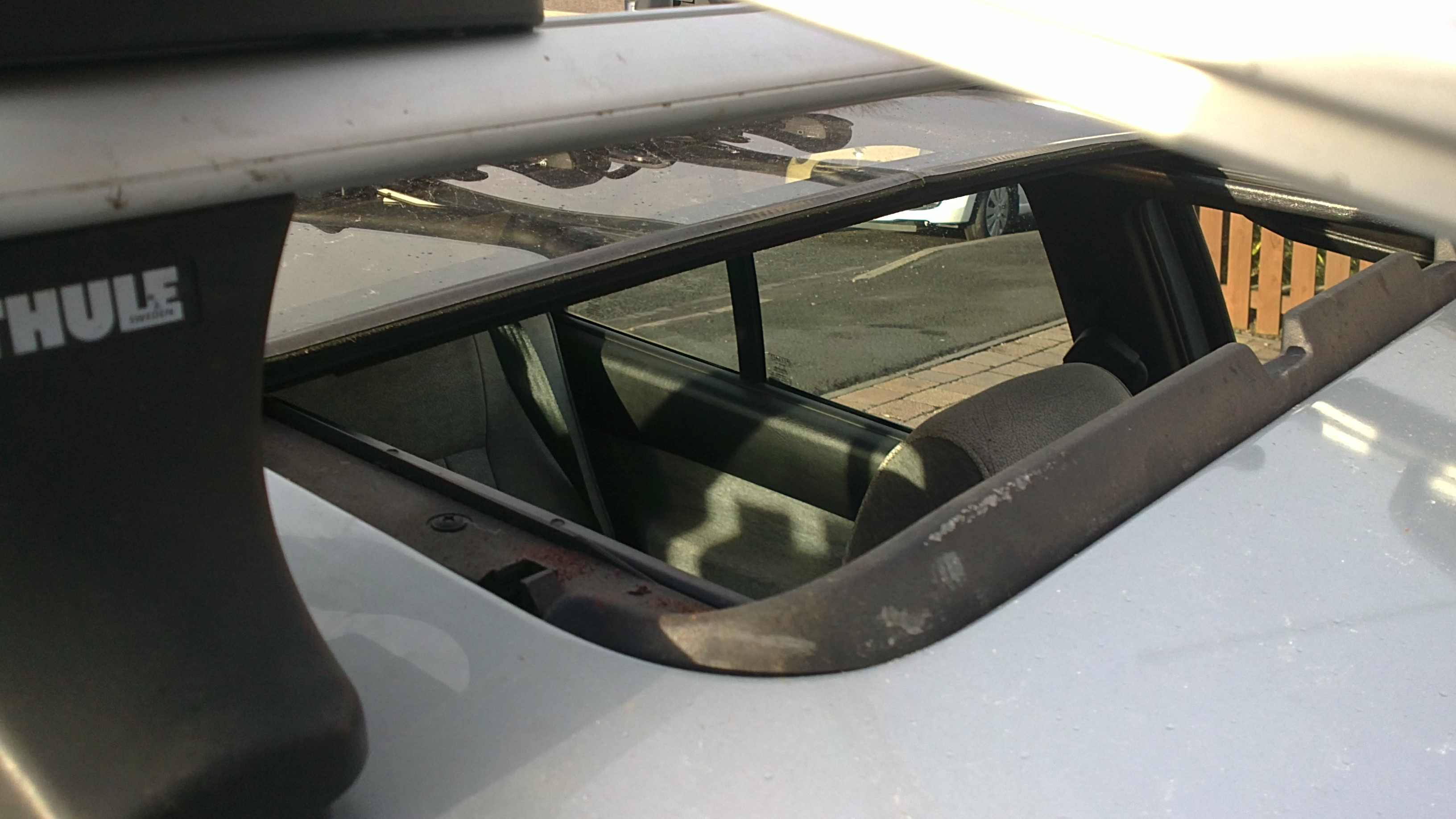

The sunroof had been immoveable. I swapped the motor out of the red one and using the emergency key, which always makes me laugh, was now able to turn the spindle and was pleased that the sunroof opened ok, with just a little shower of rust.
With this proof of concept lol I greased the moving parts, replaced the broken white clips that push the blind back and then tried motorised operation - which was also ok.

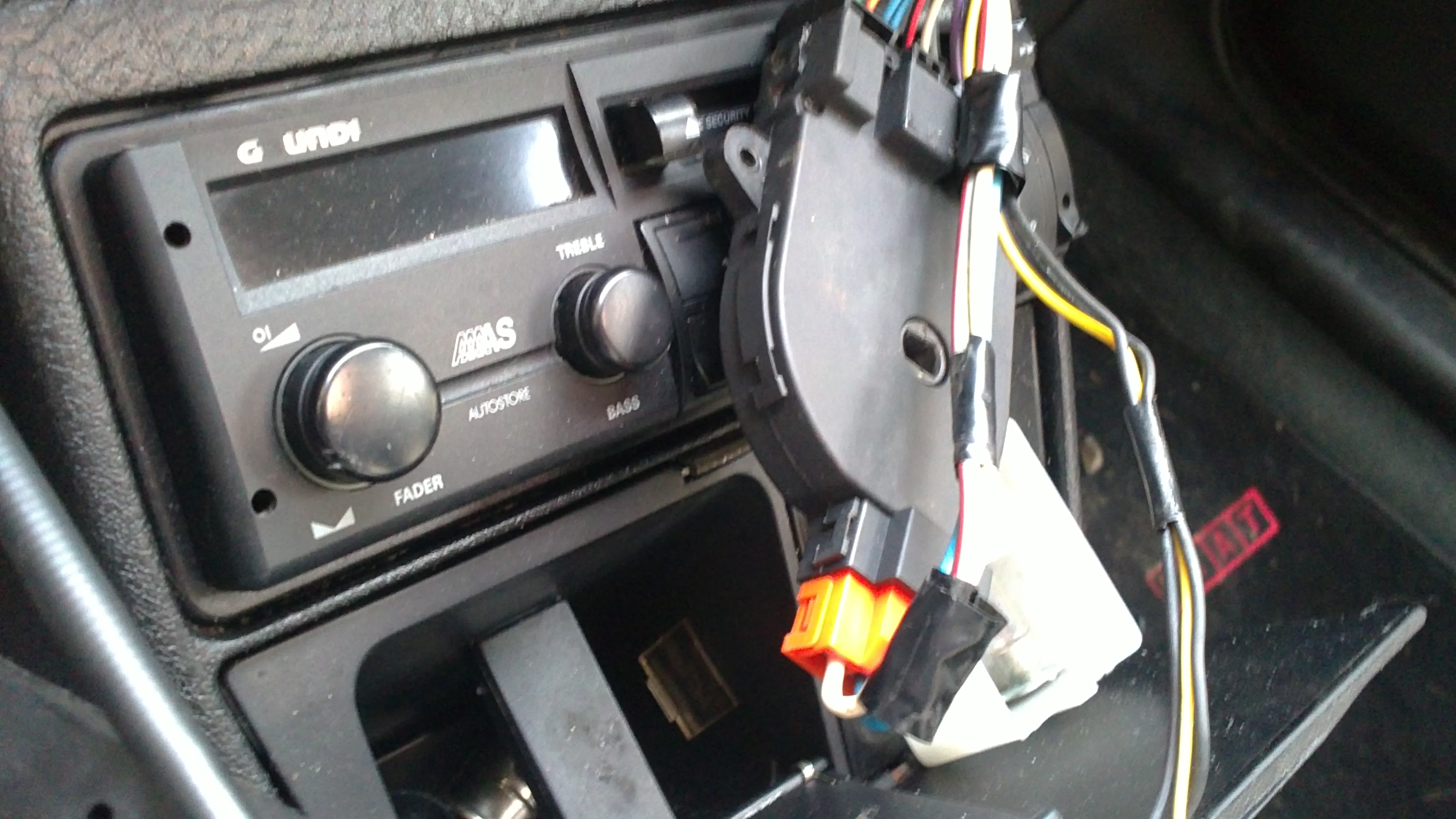

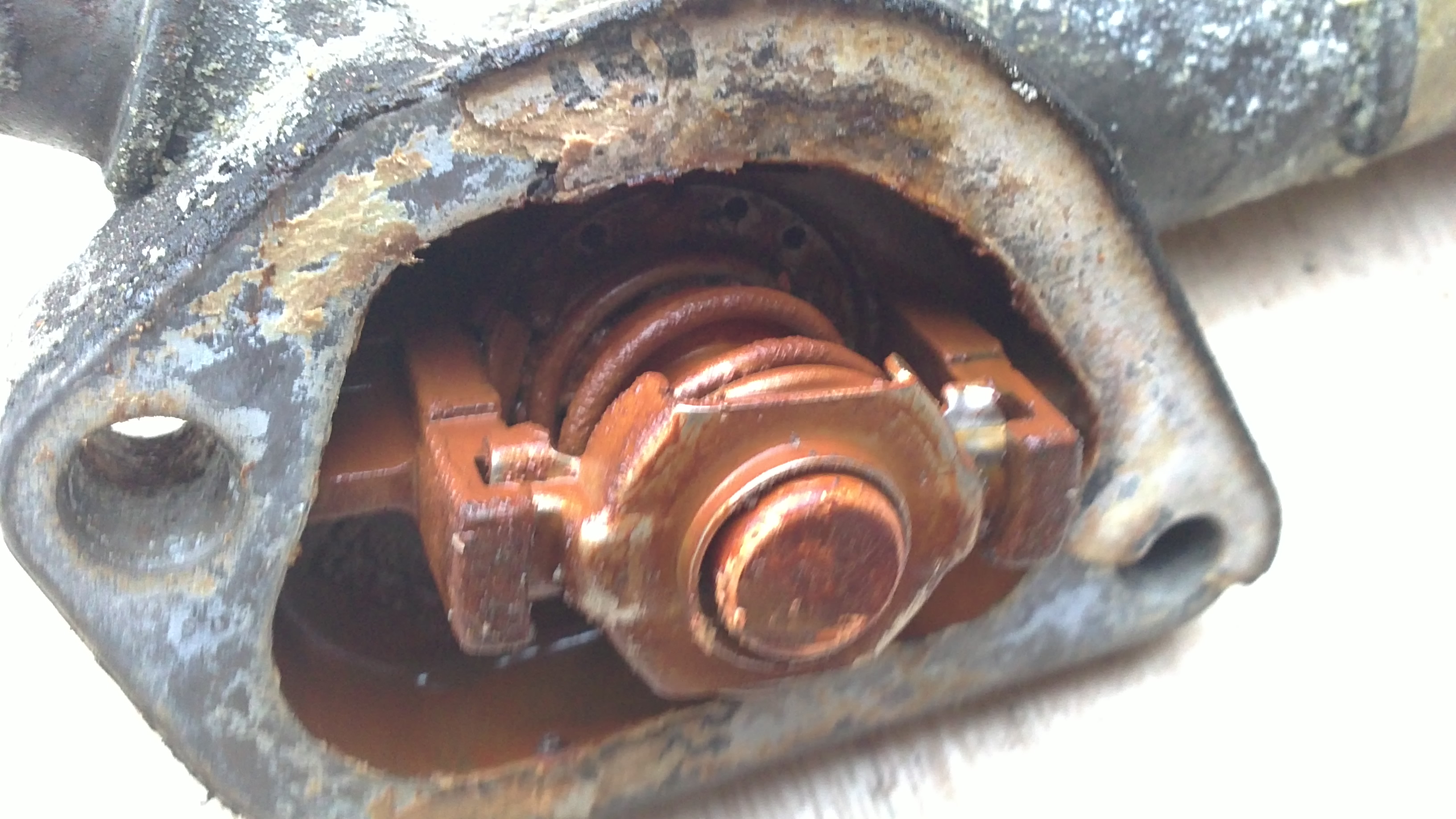

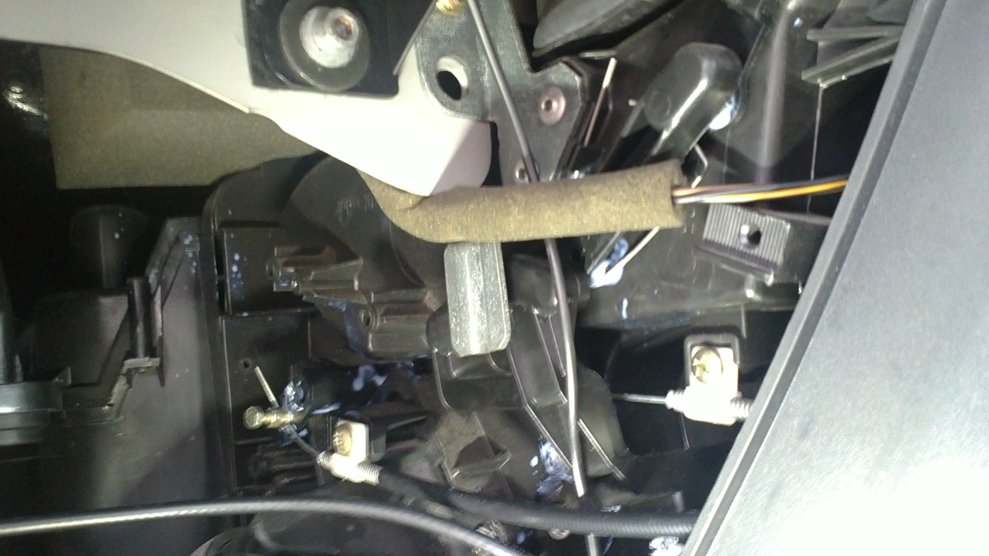

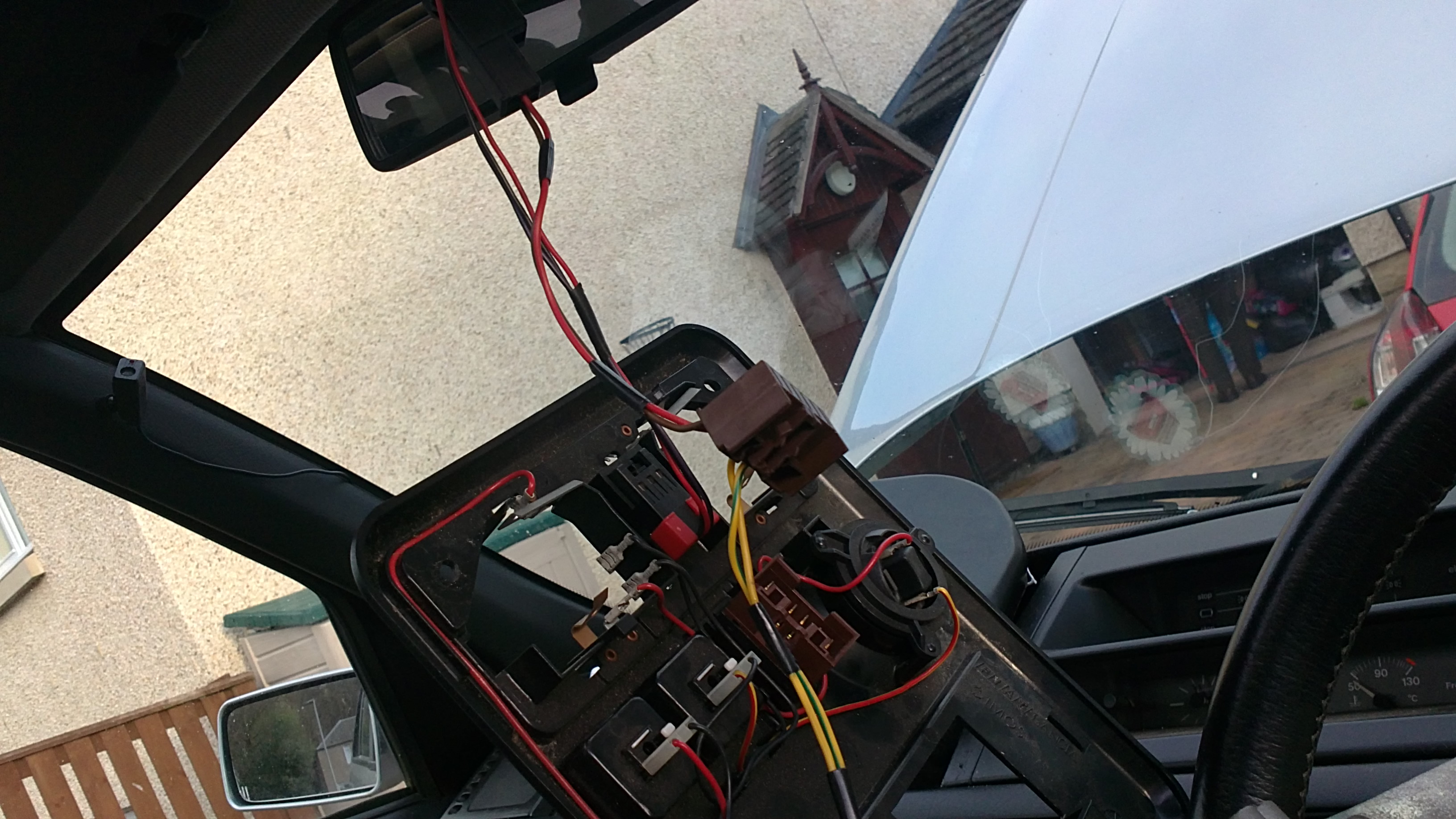

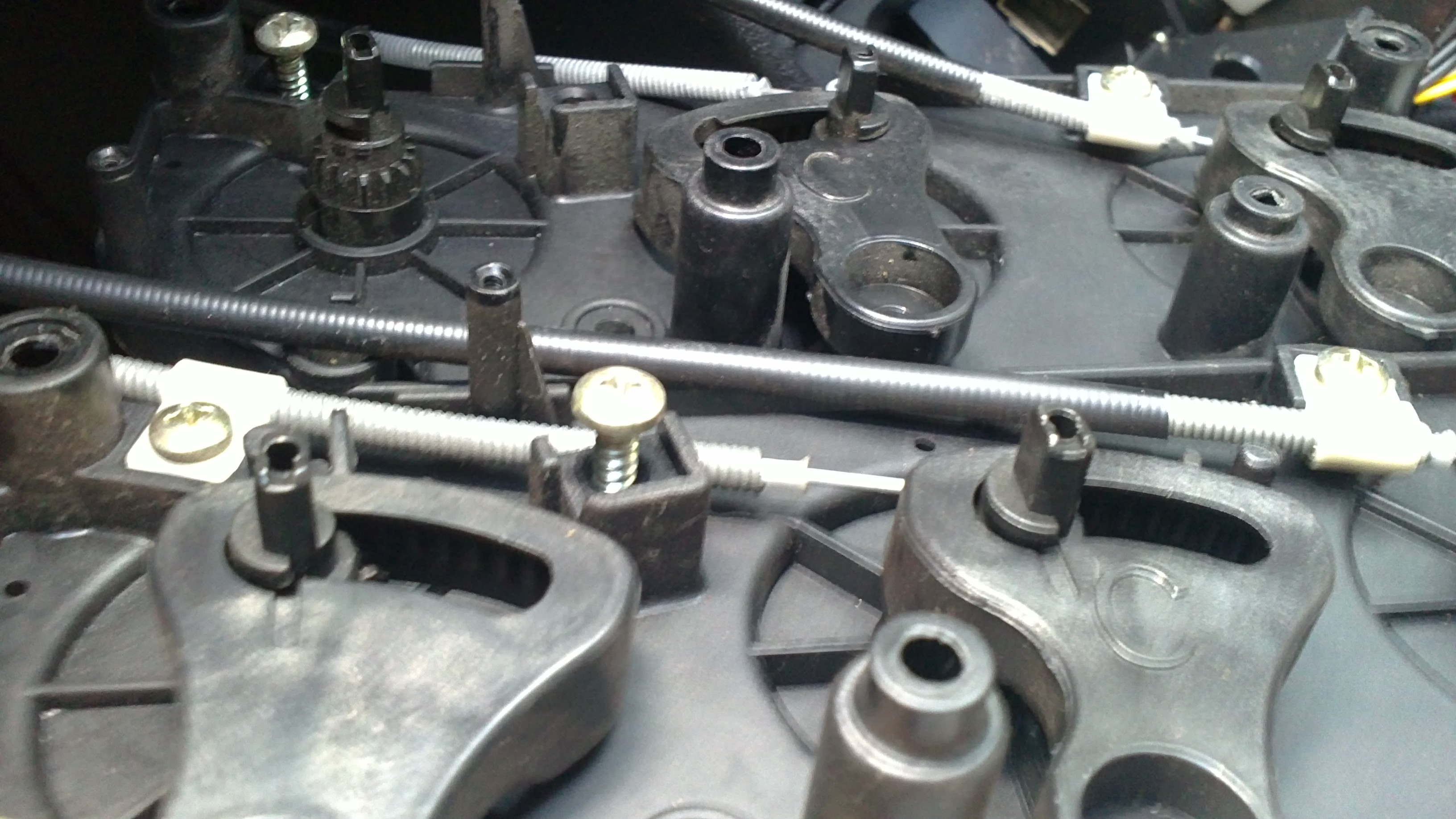

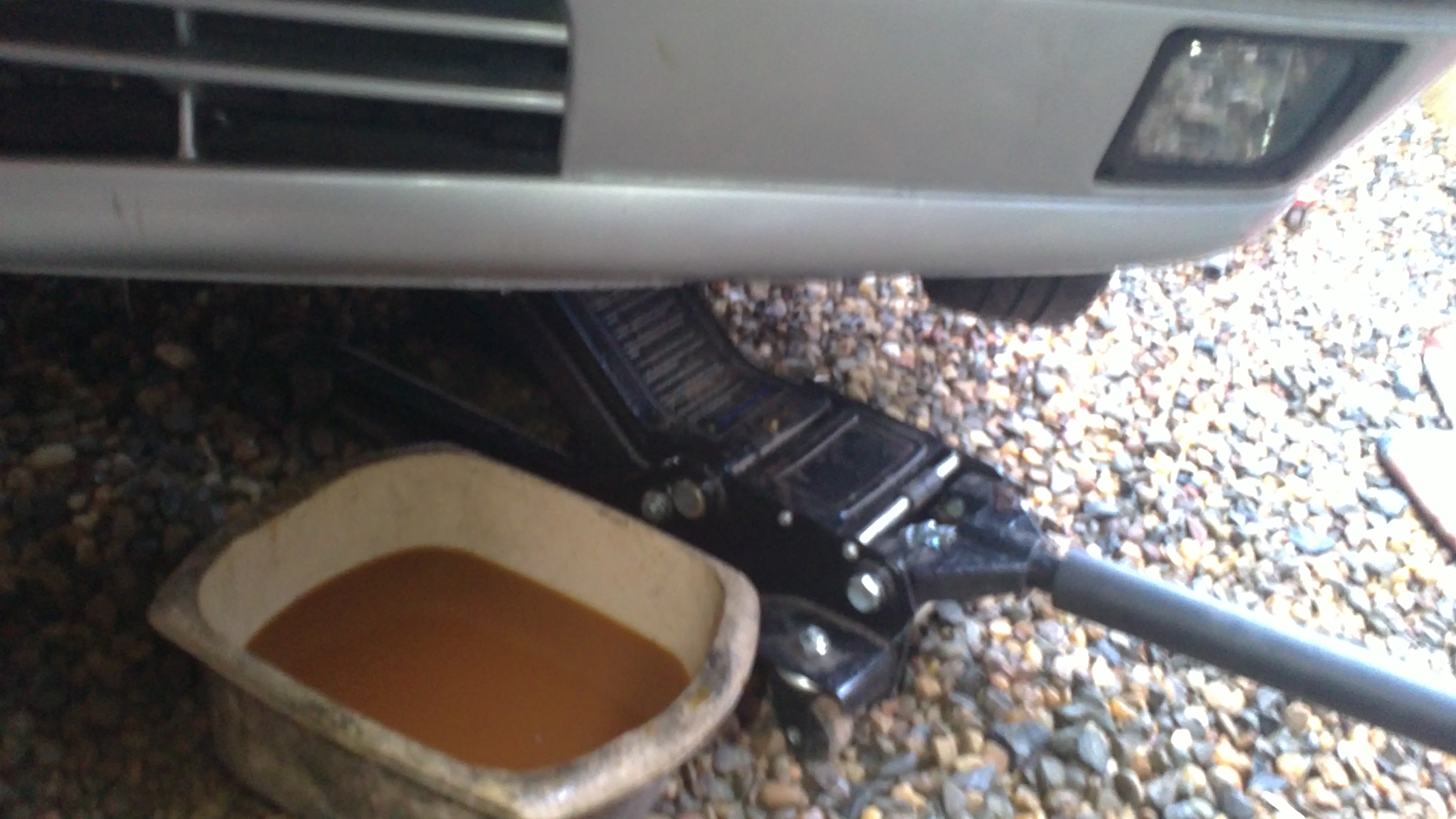

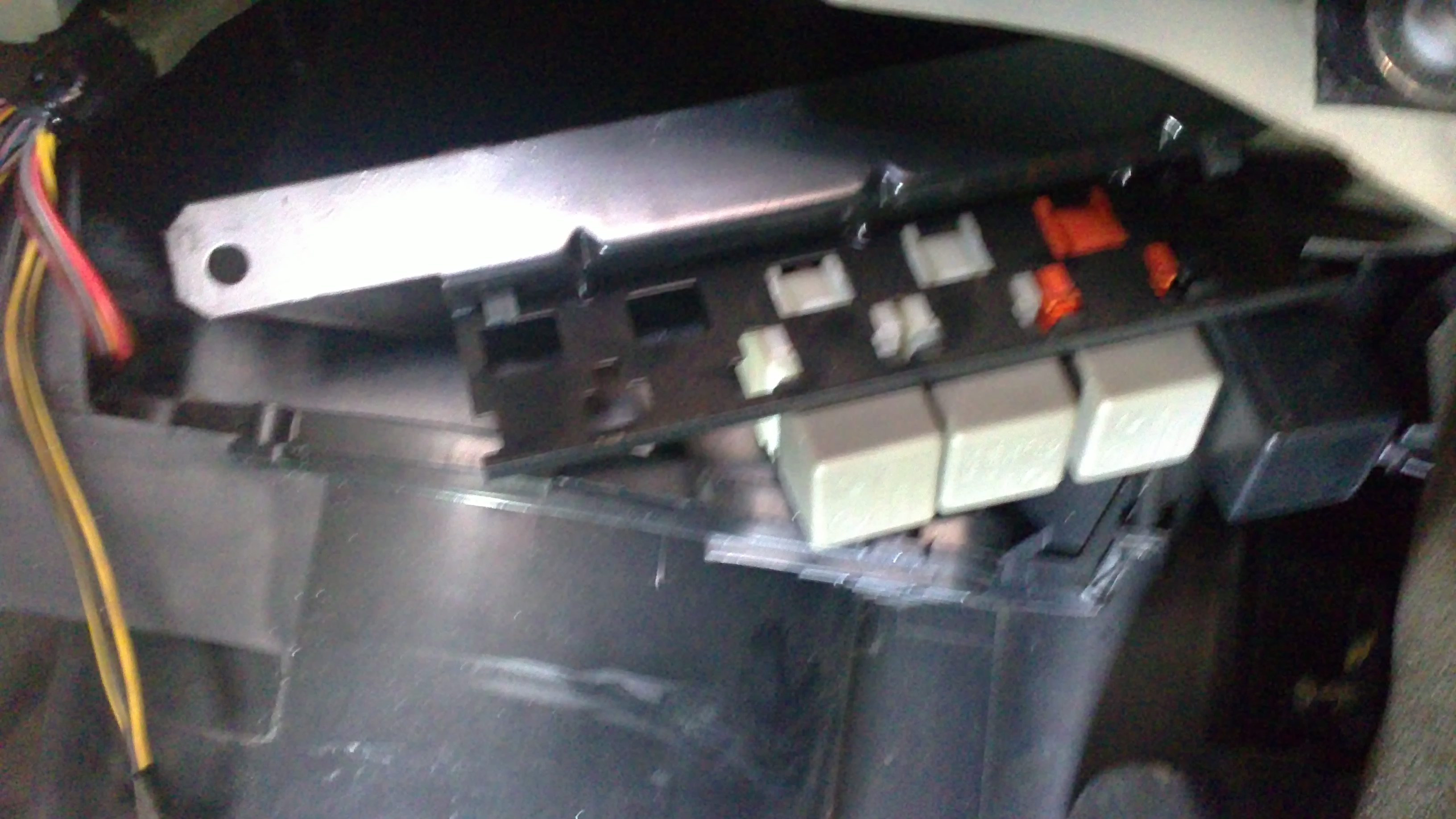

Then to the heating system which has never worked. Having swapped in the resistor and fan from the red Tipo, the blower worked. The terrible state of the coolant had clearly killed the thermostat, so both were replaced.
The liberty has cables controlling the temp. and flaps as usual, but the fan switch is electric. White securing clips that kept the cables in tension had cracked however, meaning the dials only worked one way! Without looting the red car's cables, this would have been difficult to fix. I also lubricated all the moving control parts behind the facia. The upshot of this work was that the engine now gets to temp, there is air and heating and there is less strain on the dials.

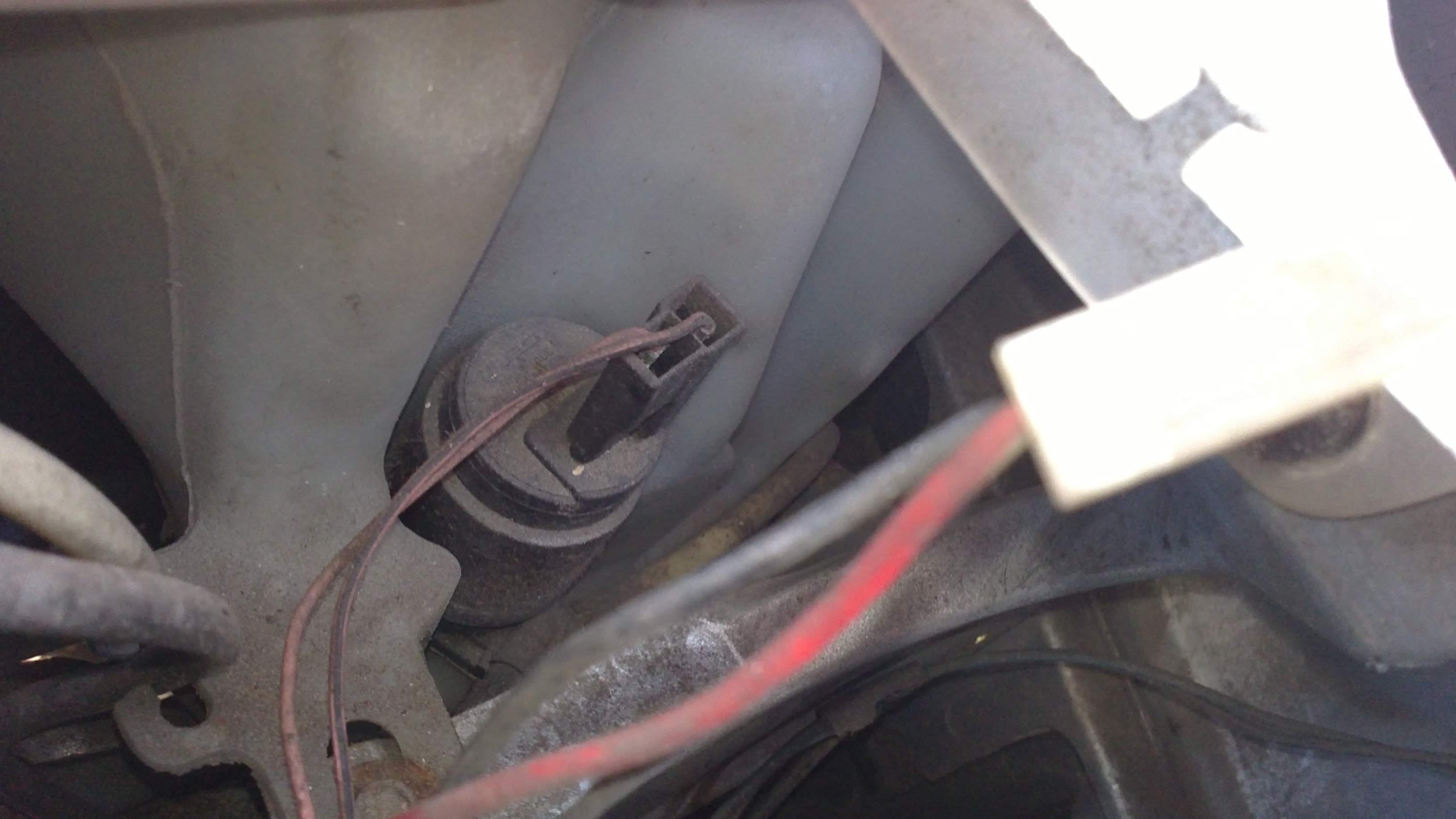

I saw the loom had a spare plug for the headlamp washer pump and hoped I could reinstate this feature on the silver car using bits from the Tipo TD. There was no power to it though. Checking this feature out it turned out to be rather more complicated with various fuses, wiring and a relay which were never fitted to the silver one and almost impossible to recover from the red one, so I gave up.

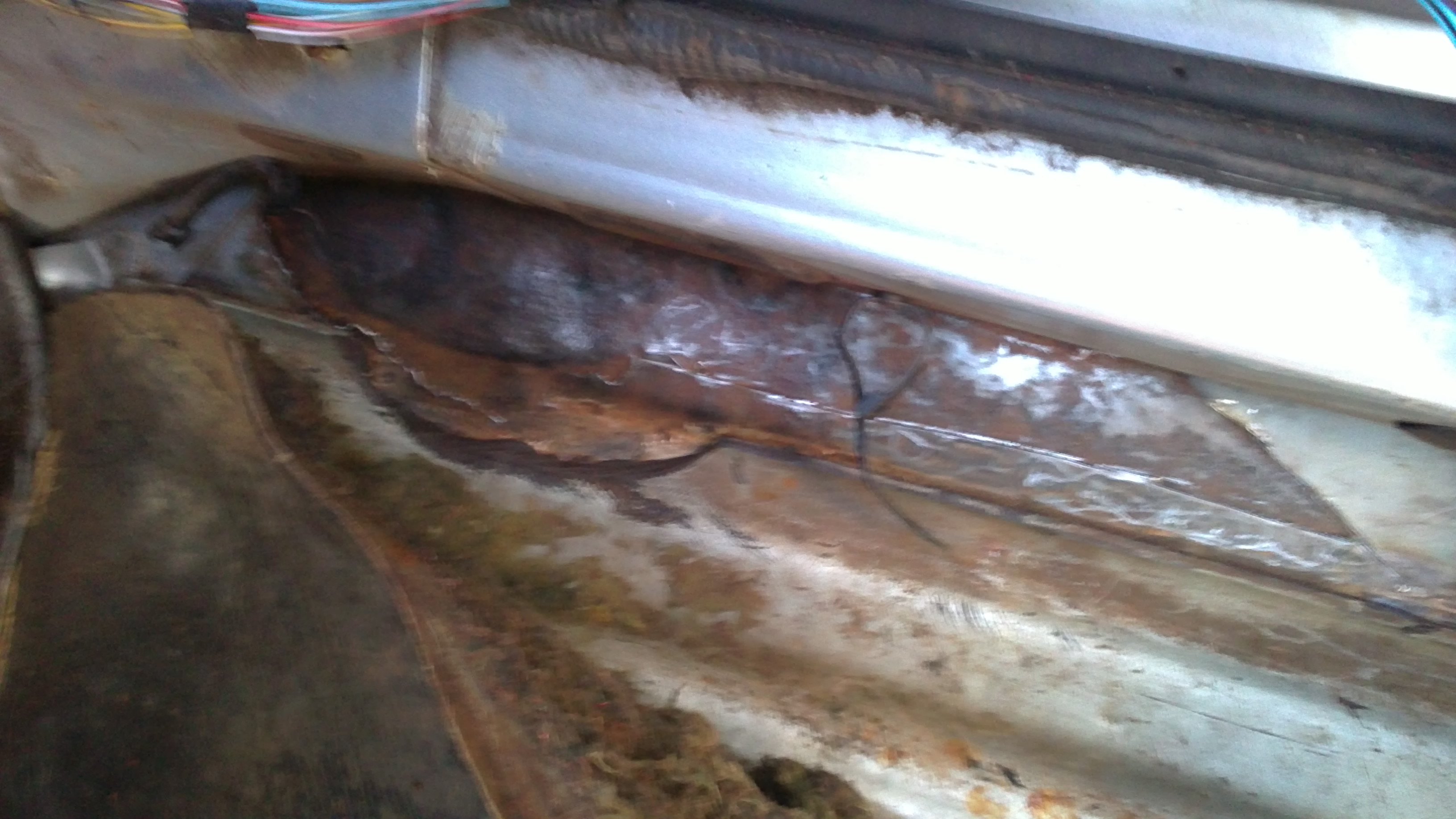

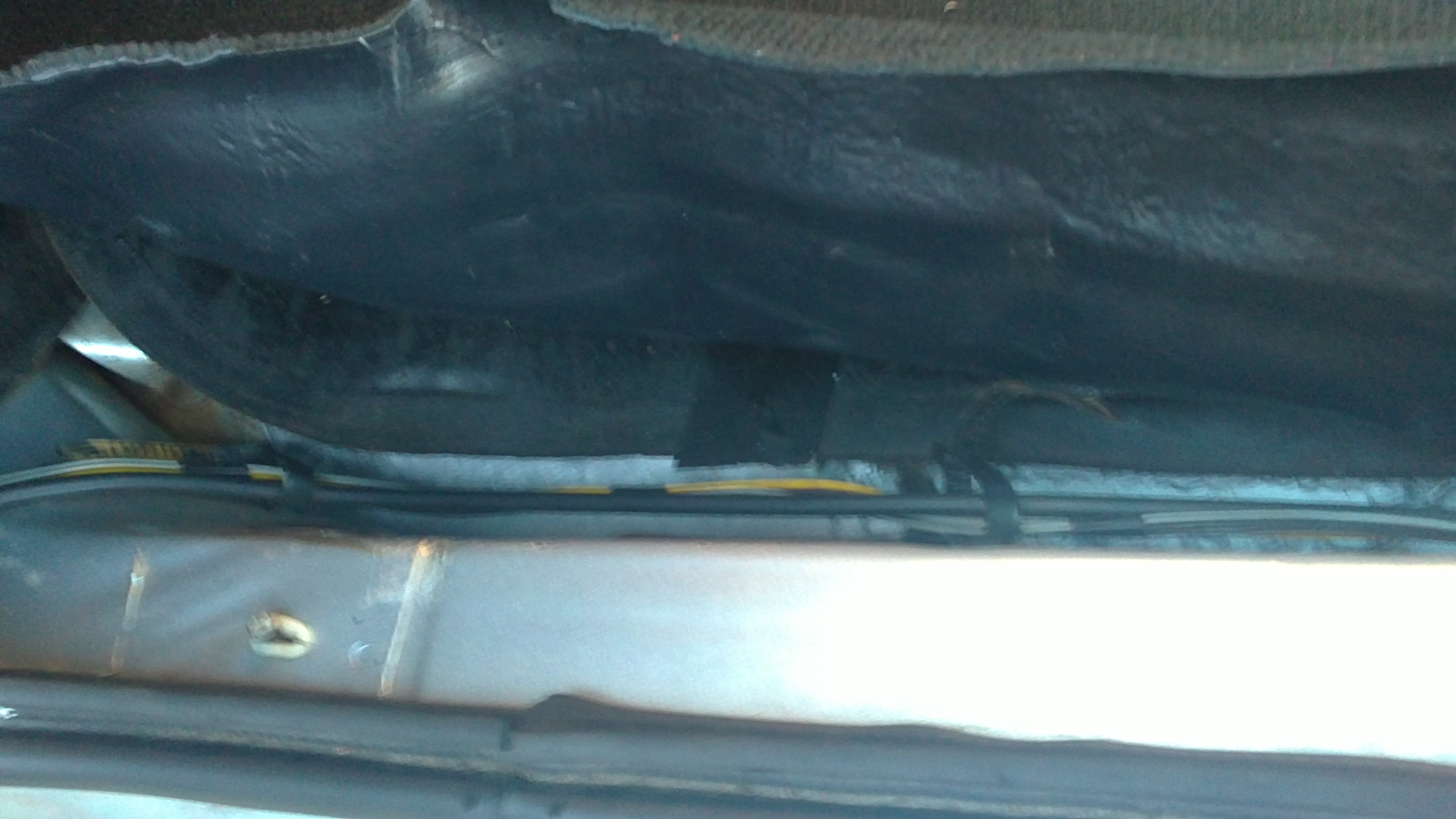

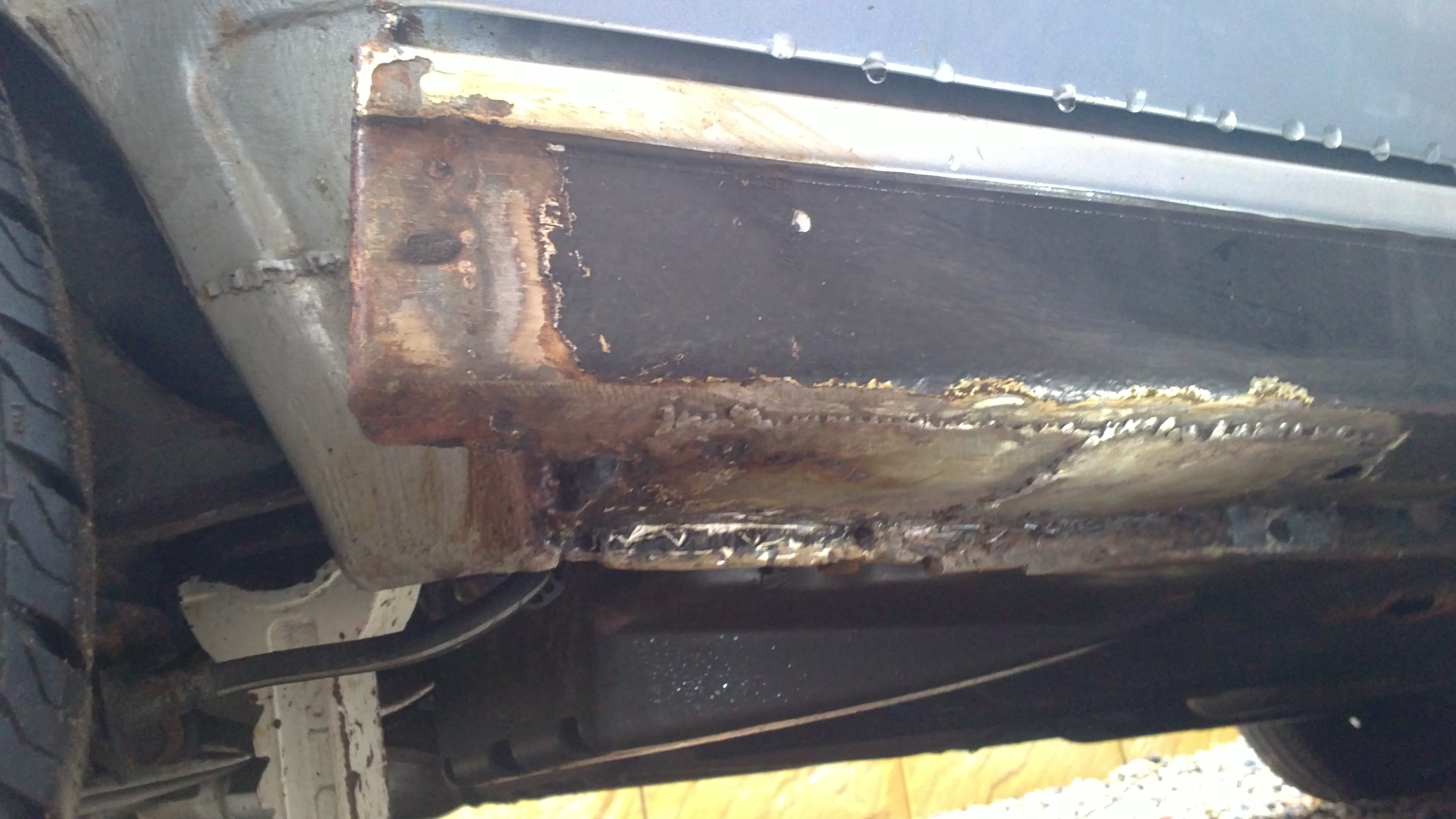

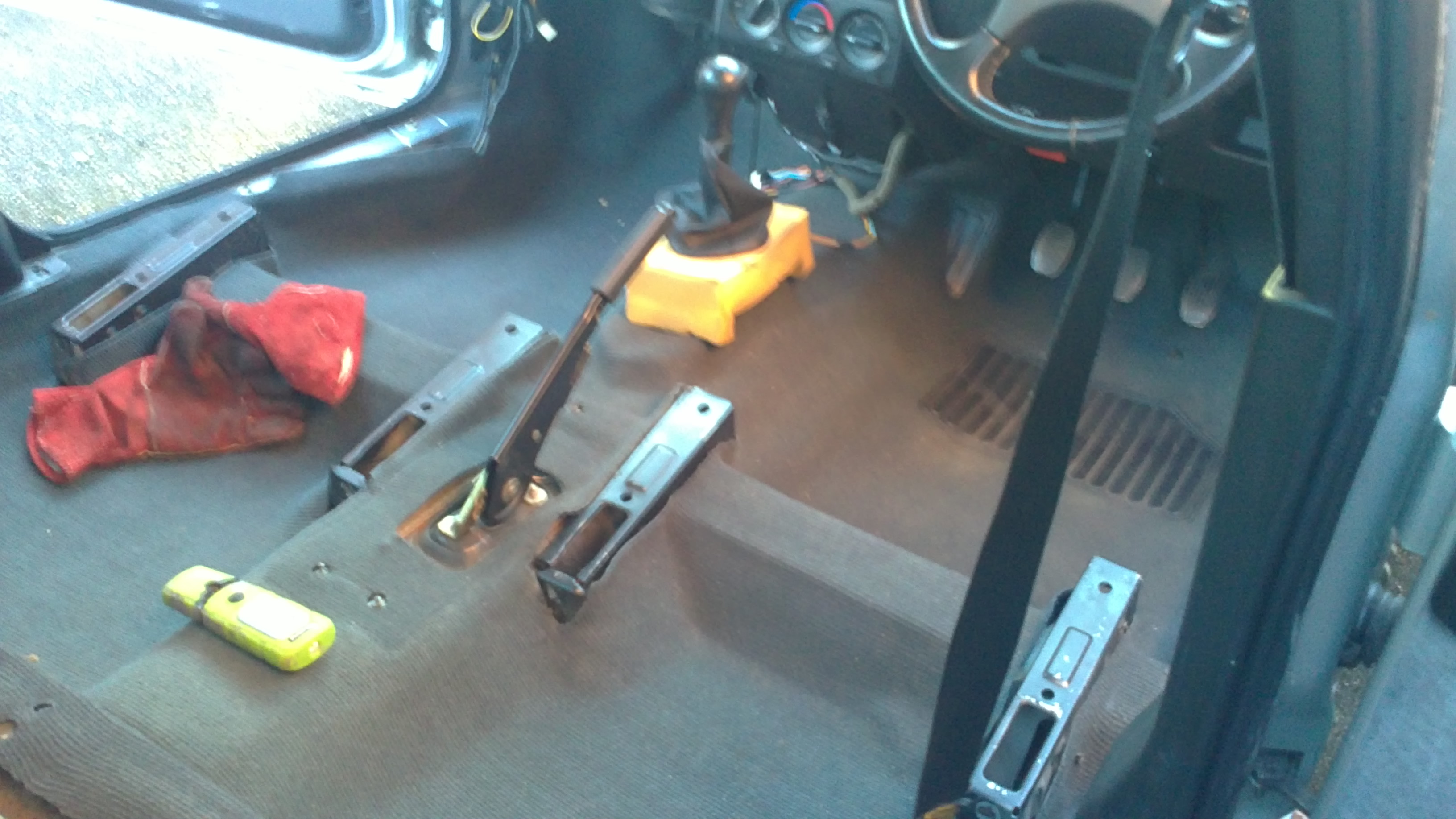

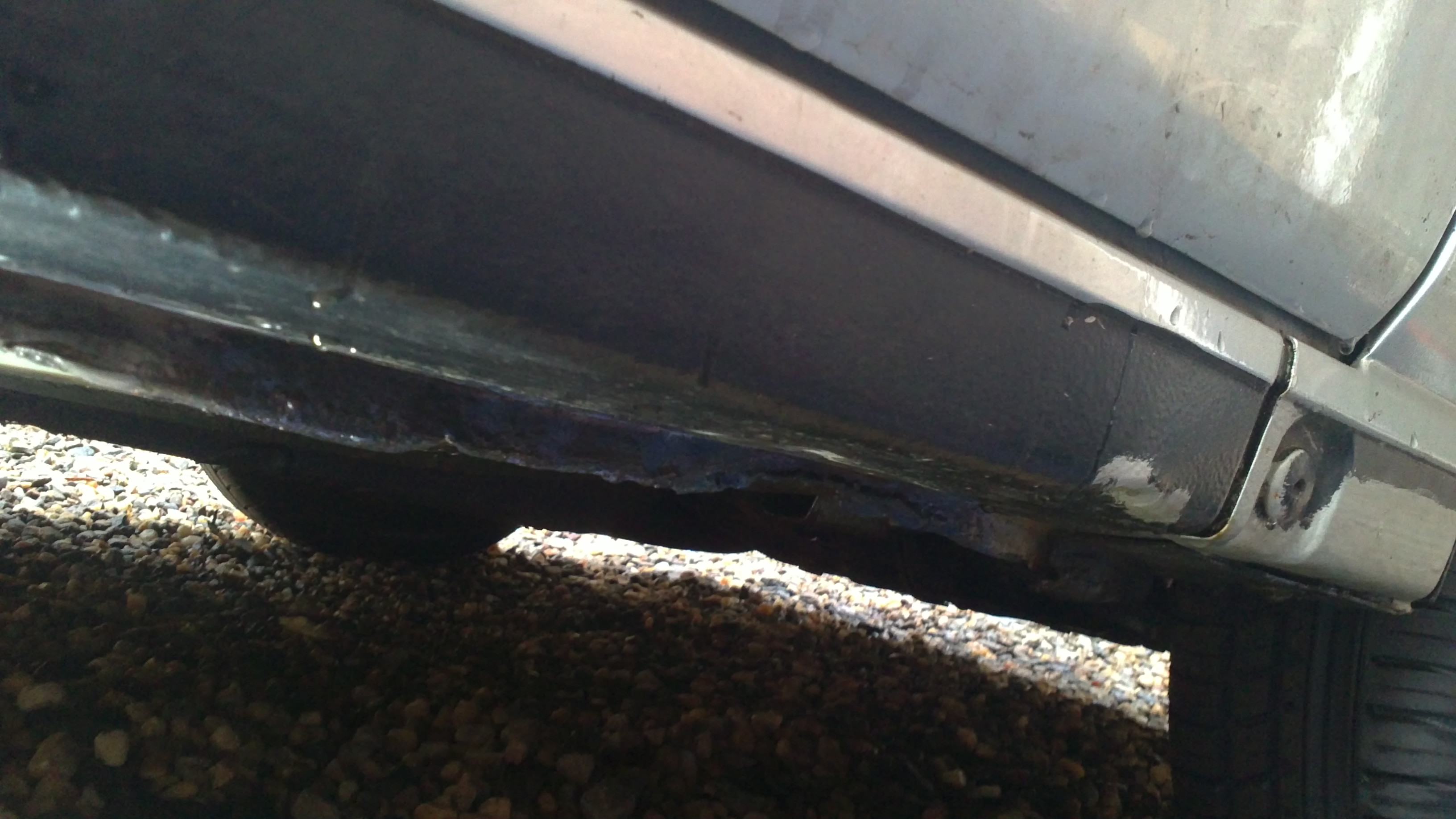

Next task was to strip all black underseal applied over previous floor and sill welding, which tends to fail and hide rust, and repaint this with epoxy mastic, welding up three little holes in the process.

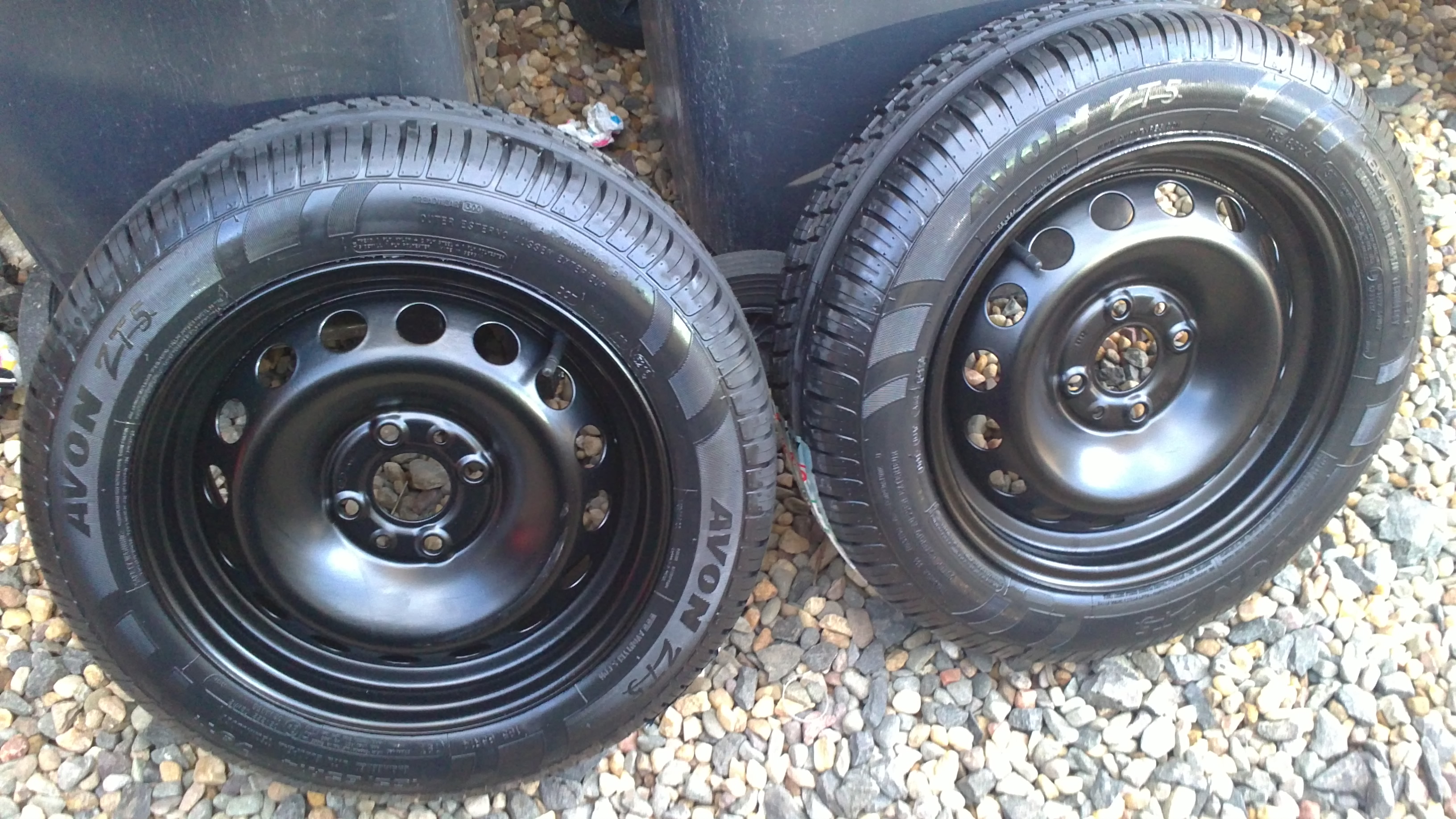

The wheels are brava ones I've had powder-coated for this teapot, with a fractionally wider offset than the originals.
Great progress with all that welding and the MOT.. and yes the coolant was even more disgusting than I'd imagined. Probably giving it another flush (with additive) and refresh after a year or so assuming all else is well with the car.

I've just recently finished redoing mine manually which was a major slog (5 wheels..). I'll fit them soon, just wearing out the last of my old current all-season tyres. Incidentally which tyre size did you go for... standard skinny 165/65 or wider Brava-style 175/65? I'm assuming 14" wheels not 13"...
Cheers BlueJohn - and for your update. That sounds like hard work... it's a slog but we try to get there, or somewhere! Like you say I went from 175 to 185 width on the diesel, all good, but this one I've stayed at 165 (14"). They look rather narrow but I think you have previously tended to advise keeping the rolling weight down?

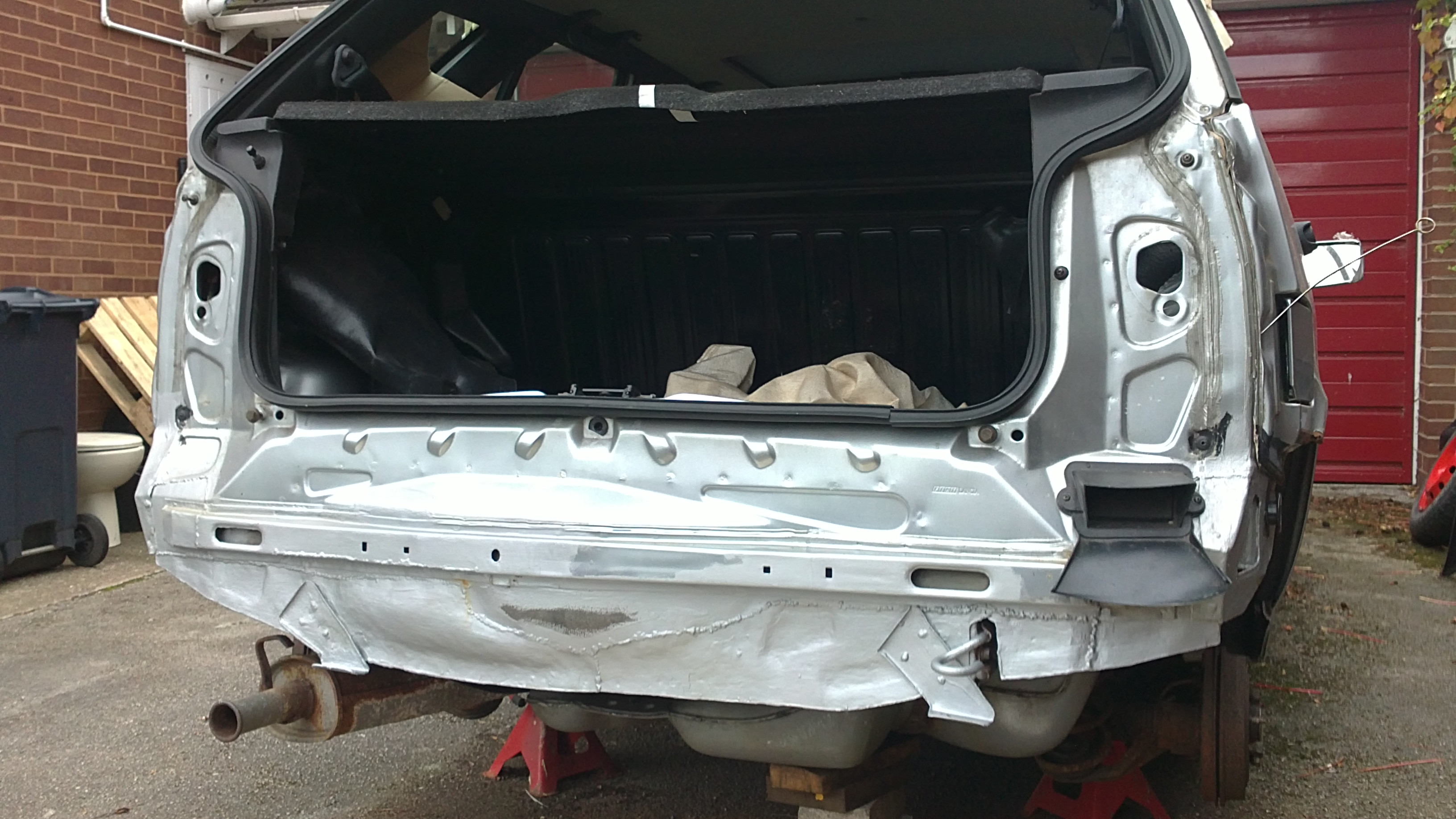

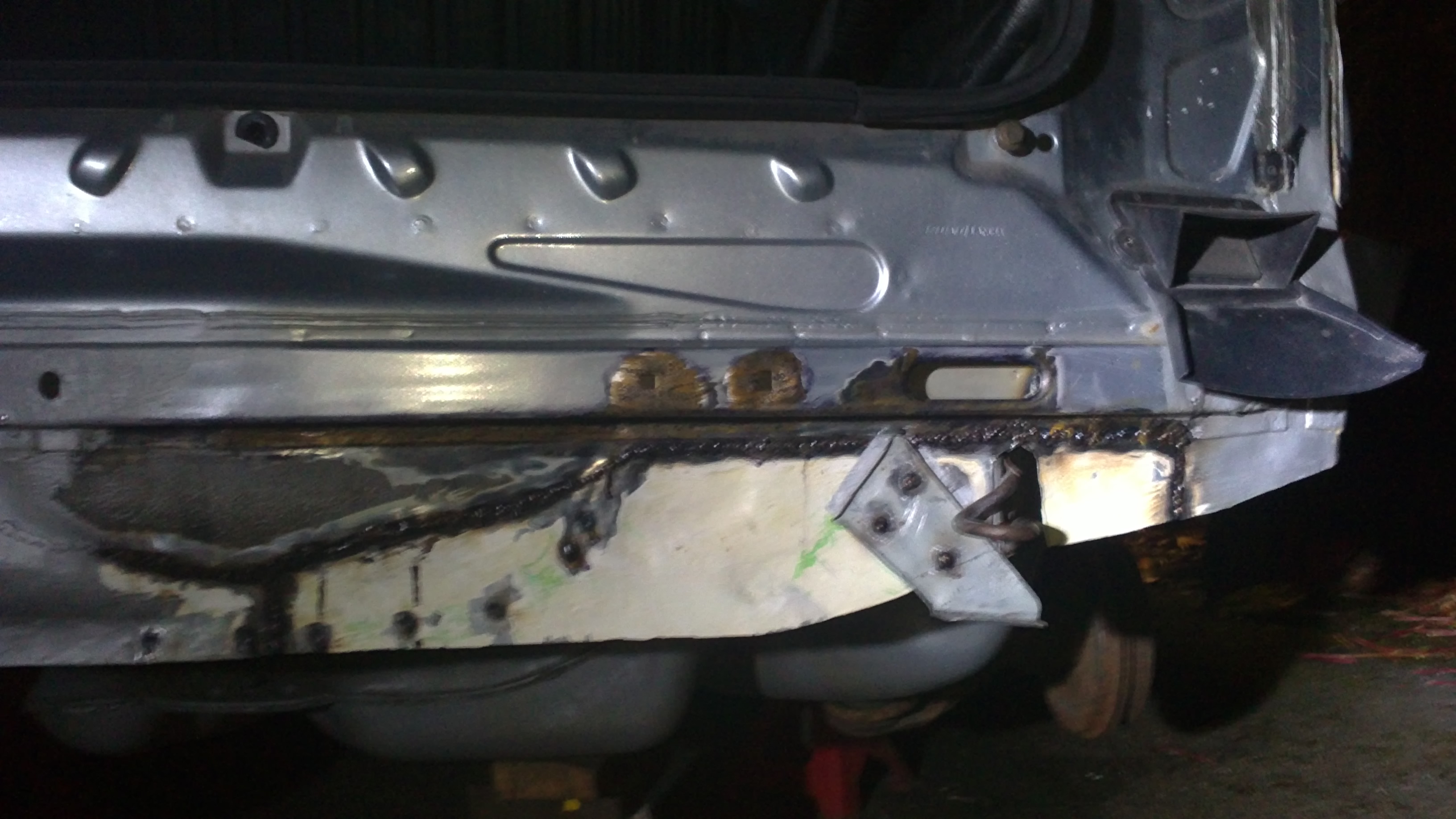

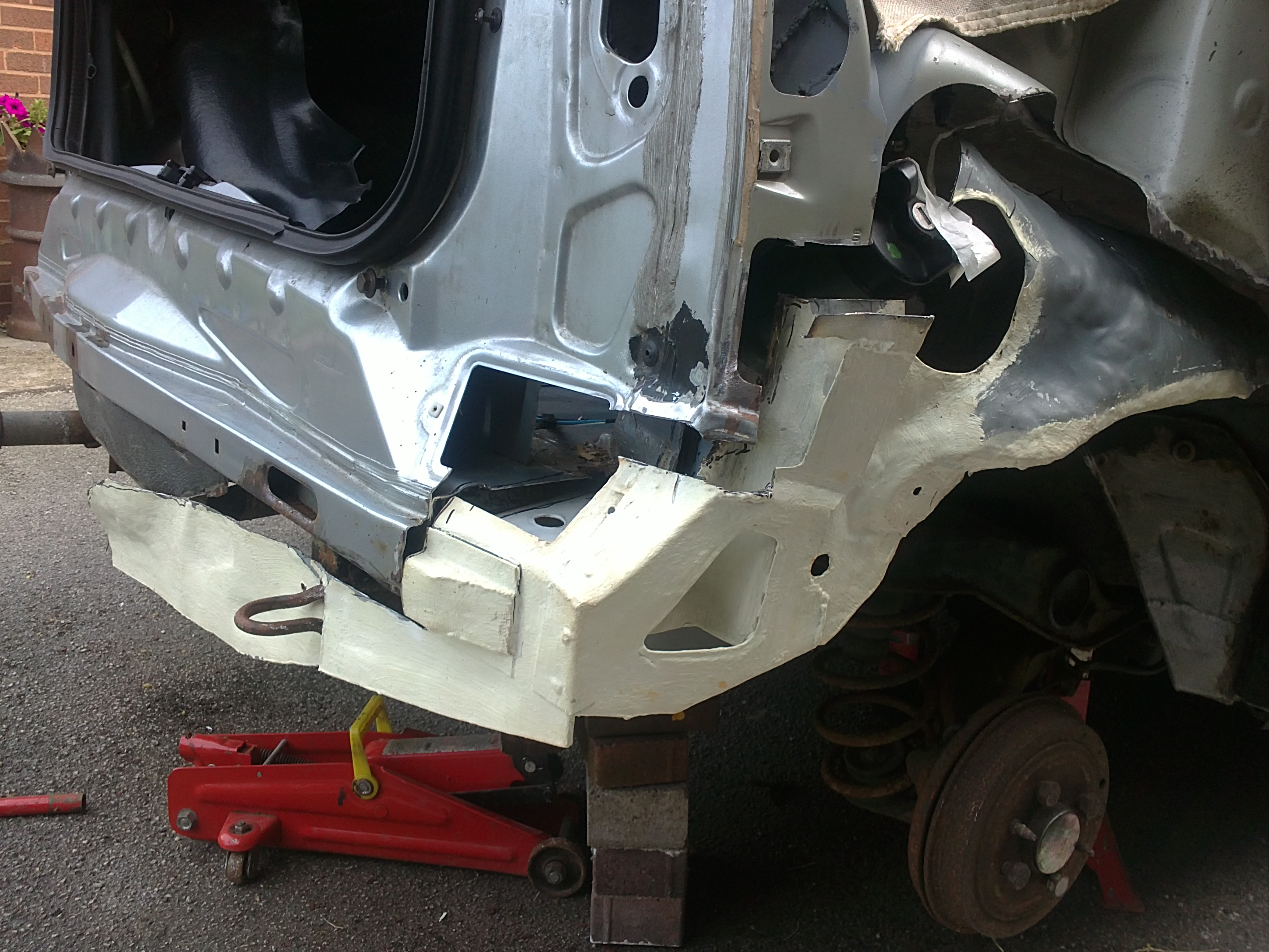

With the Winter over and Summer starting I began to tackle the rot at the back of the car.

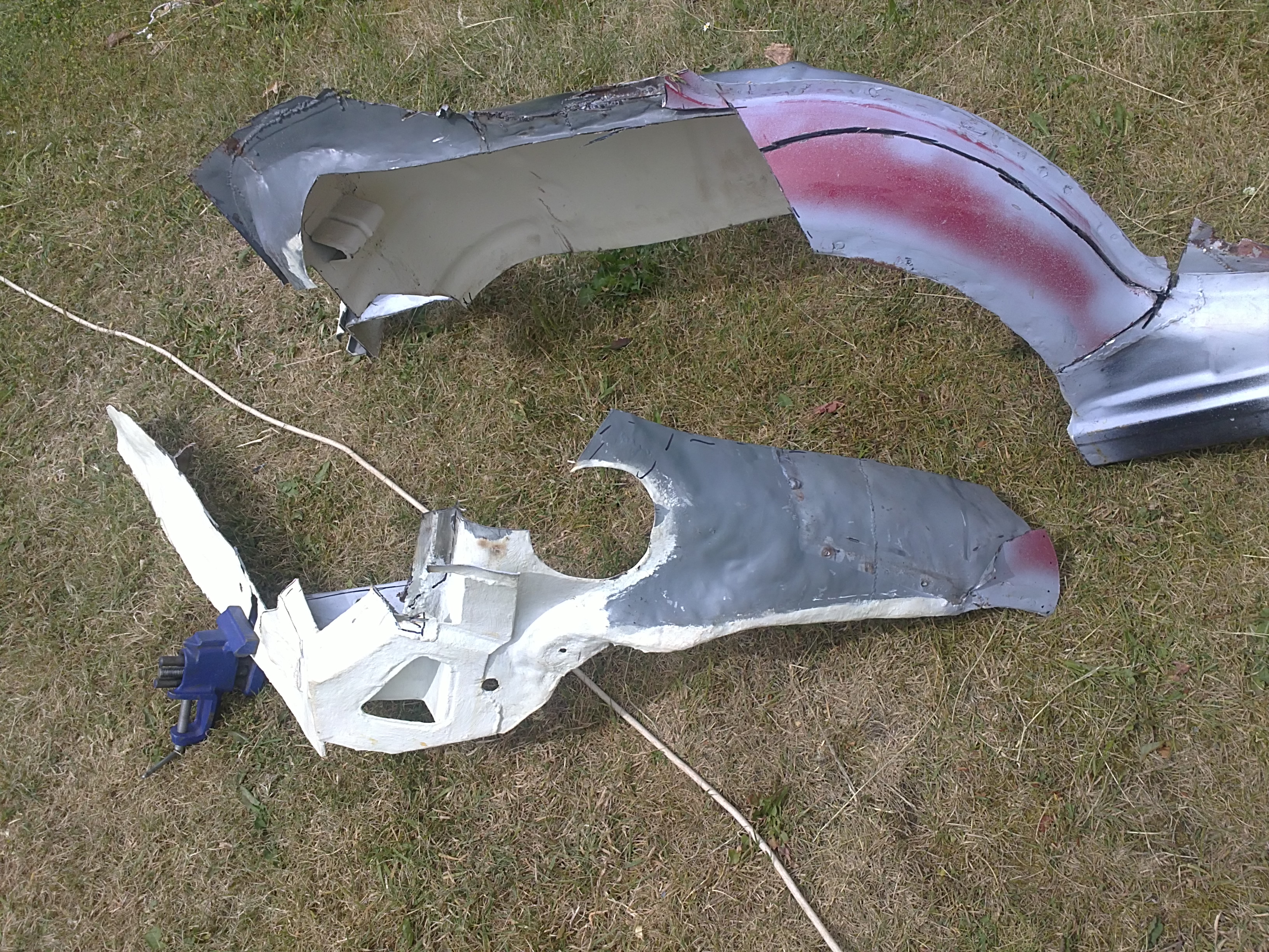

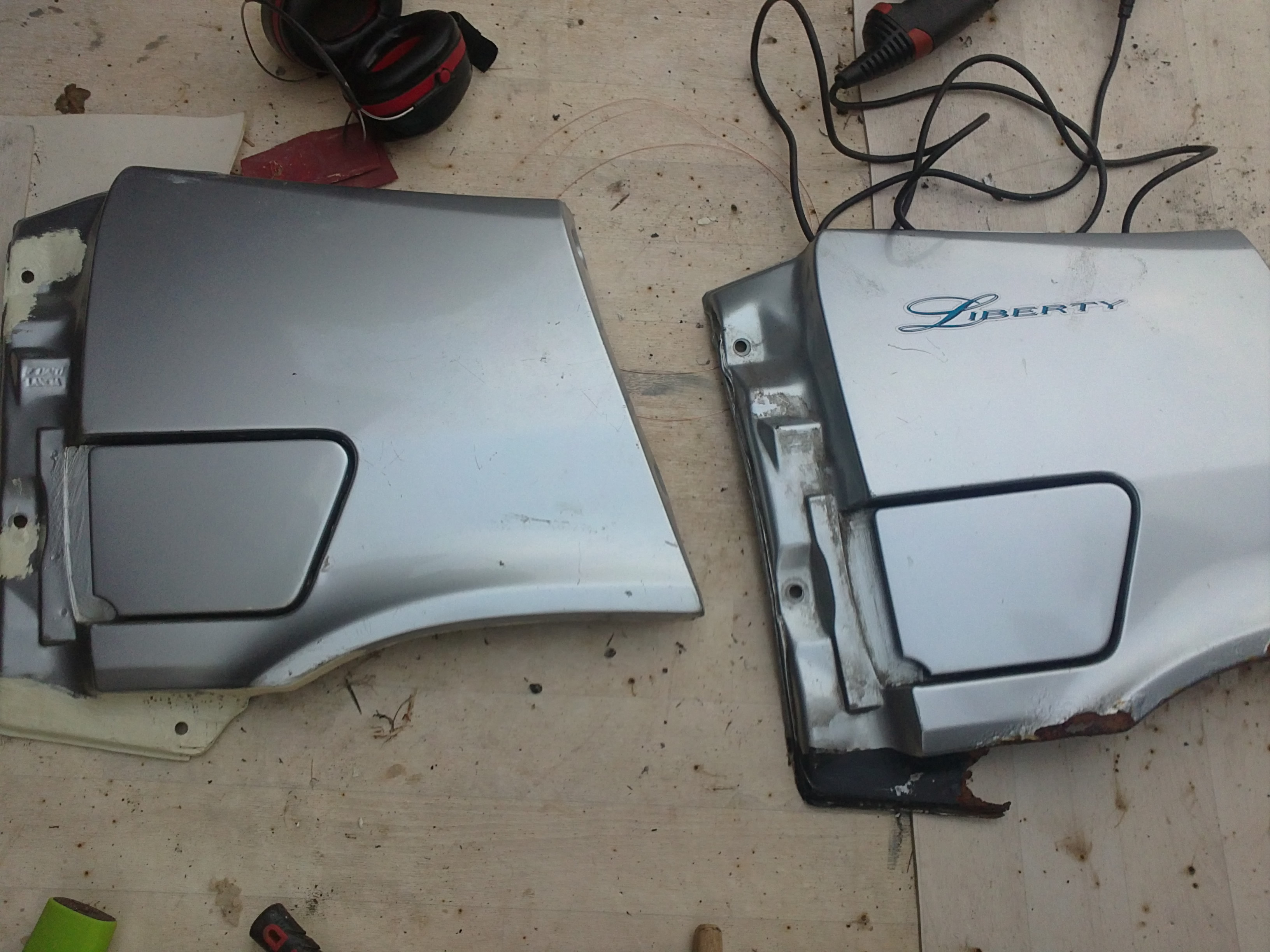

I used parts of the fabrications I had originally welded to my TD which I cut off before it was scrapped.
The offside corner took a lot of fitting as the panel needed to go a long way under the inner wheel arch where the rot had spread. This will also need the replacement wing.
The nearside corner required sheets on every plane to be repaired but I was able to avoid taking the the wing off.

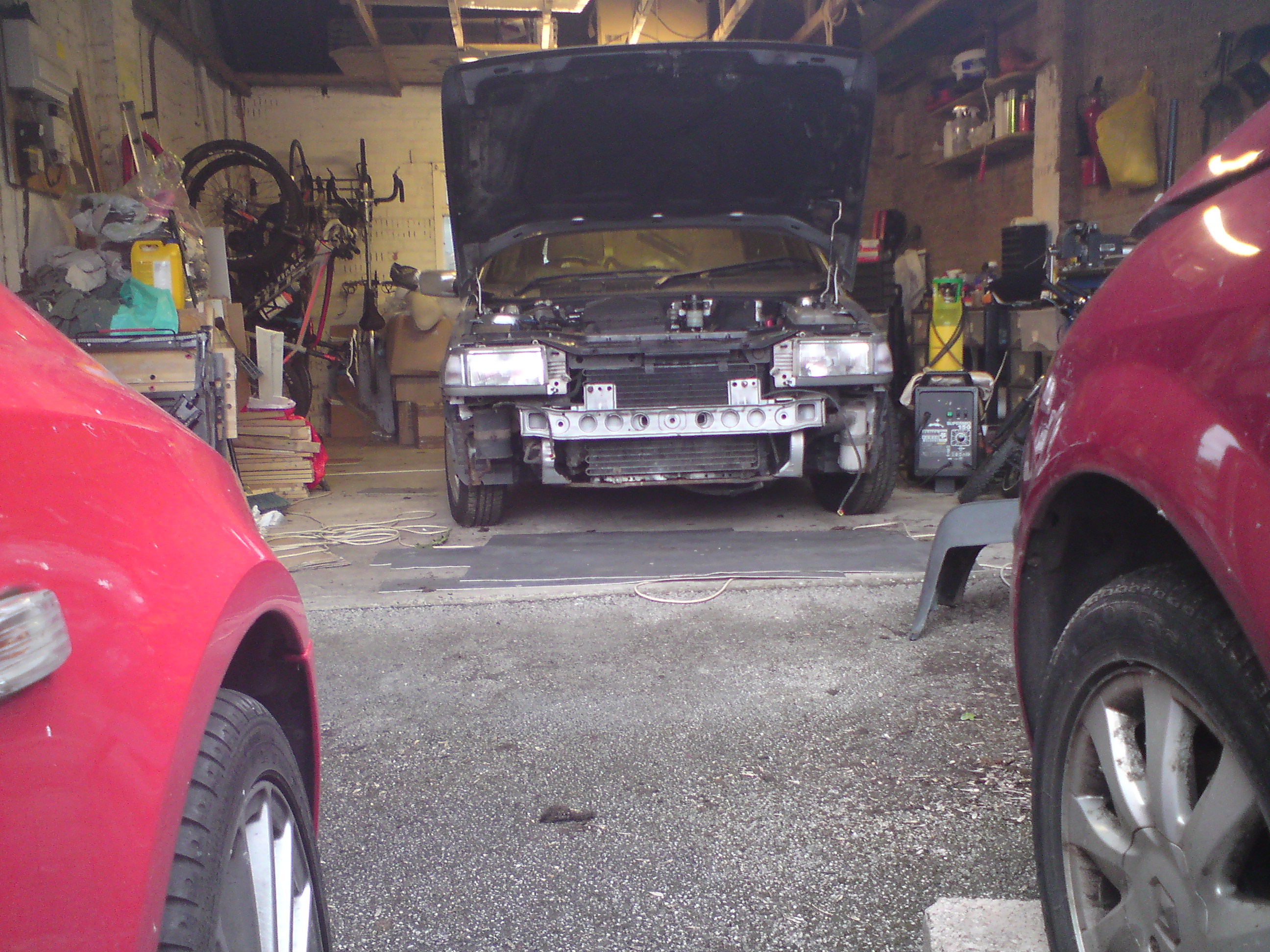

It's probably time to update this thread as recent weeks permitted a resumption of work. Firstly, late last year after finishing all the welding I chanced an MOT. Unfortunately during the emissions test, the interior filled with coolant from the matrix area. Removing the carpet to dry it out revealed that the old outer floorpan repairs had been welded over the top of the rusty panels. This won't last, so it needed the old metal cutting back and a good tidy up. And more welding...

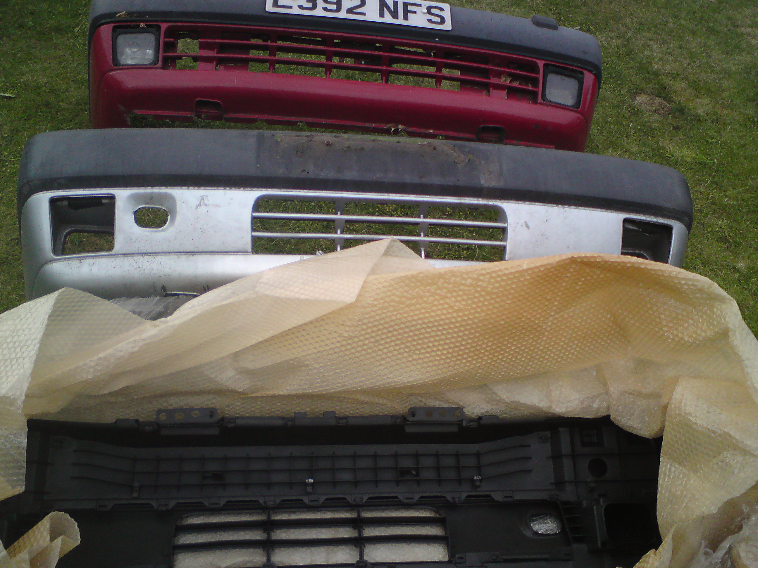

A package from Italy is always a treat so here is a new correct pattern bumper in the packaging as the old one in the middle was badly cracked and the TD bumper is incorrect. However the new one needed the moulded fog light apertures cutting out.

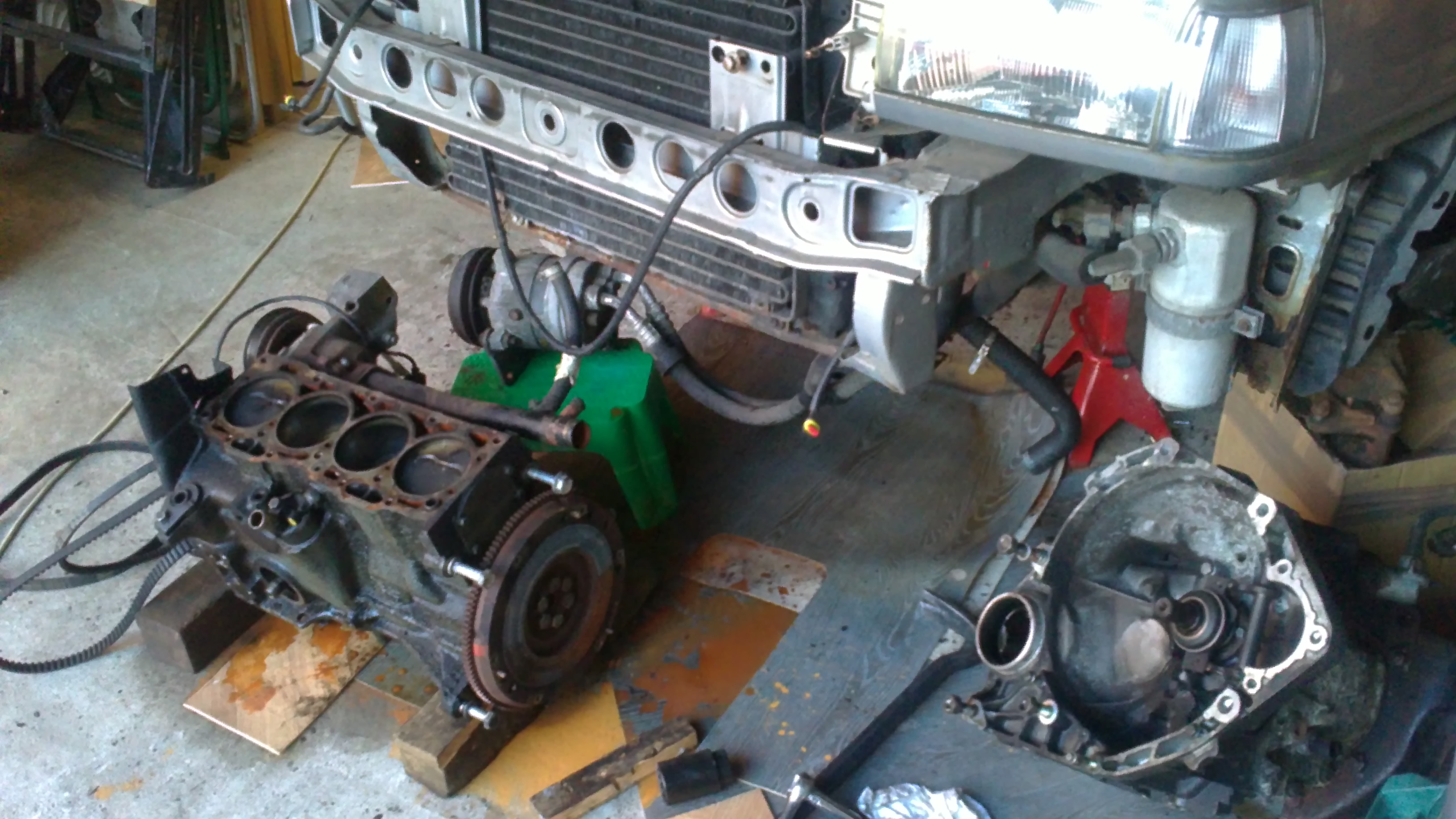

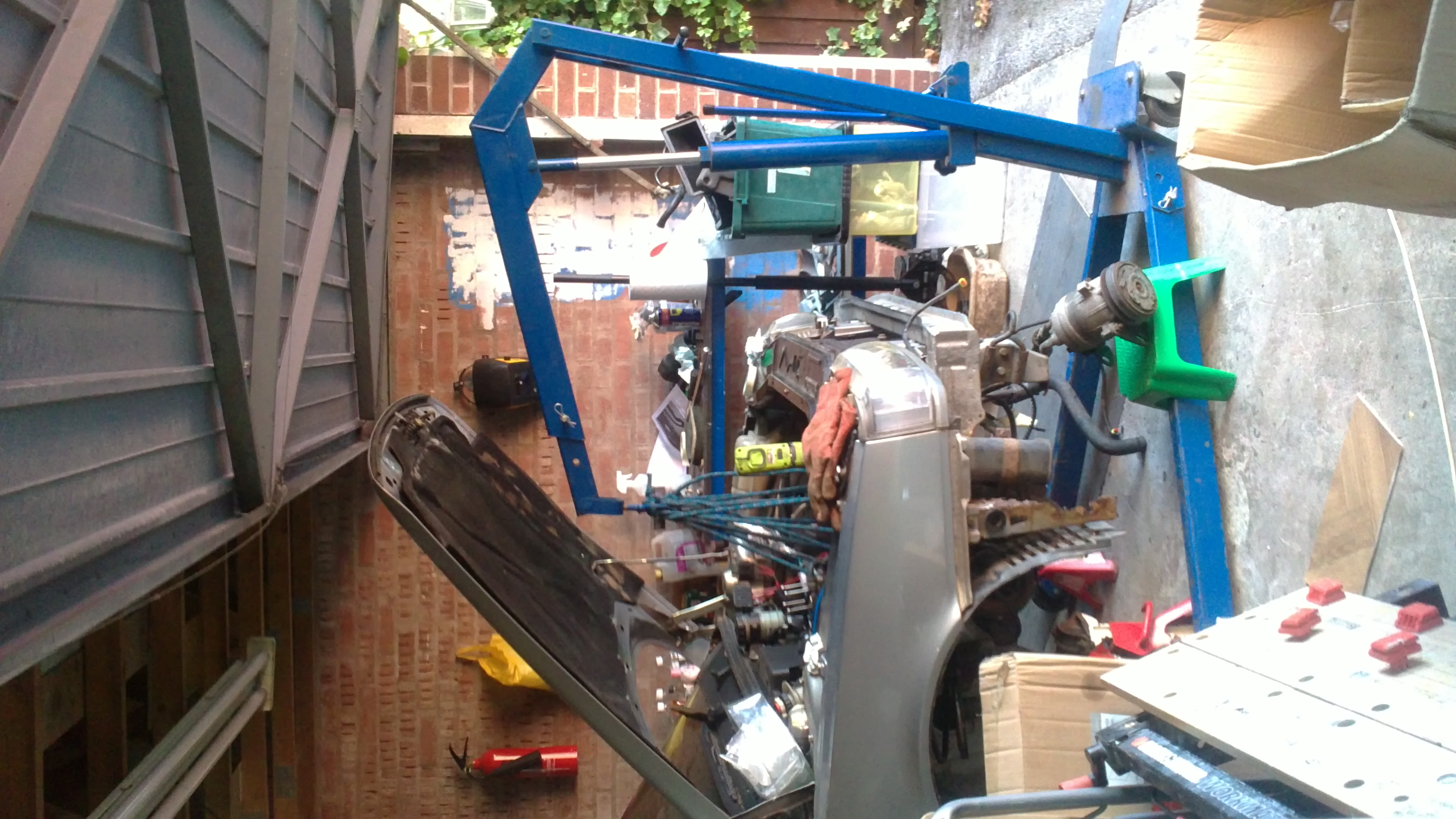

Next the engine now has to come out as there is coolant in the oil and the crankshaft seems to be rattling. After tackling rusty bolts on the the suspension and taking the head off the engine is ready to come out. There doesn't seem to have been much oil in the gearbox either. What maintenance regime was this car subjected to lol, it couldn't be much worse ! :shakehead:

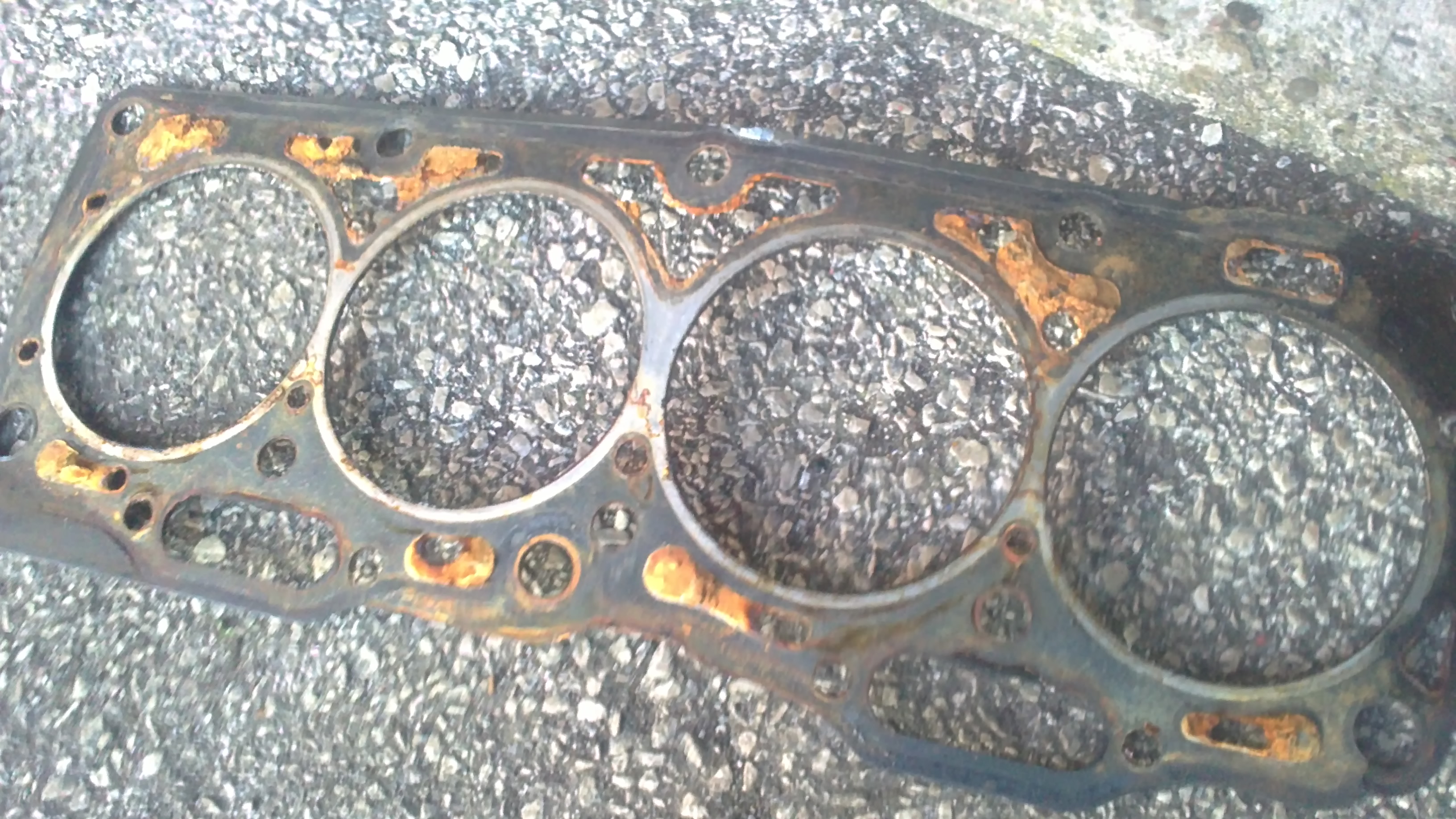

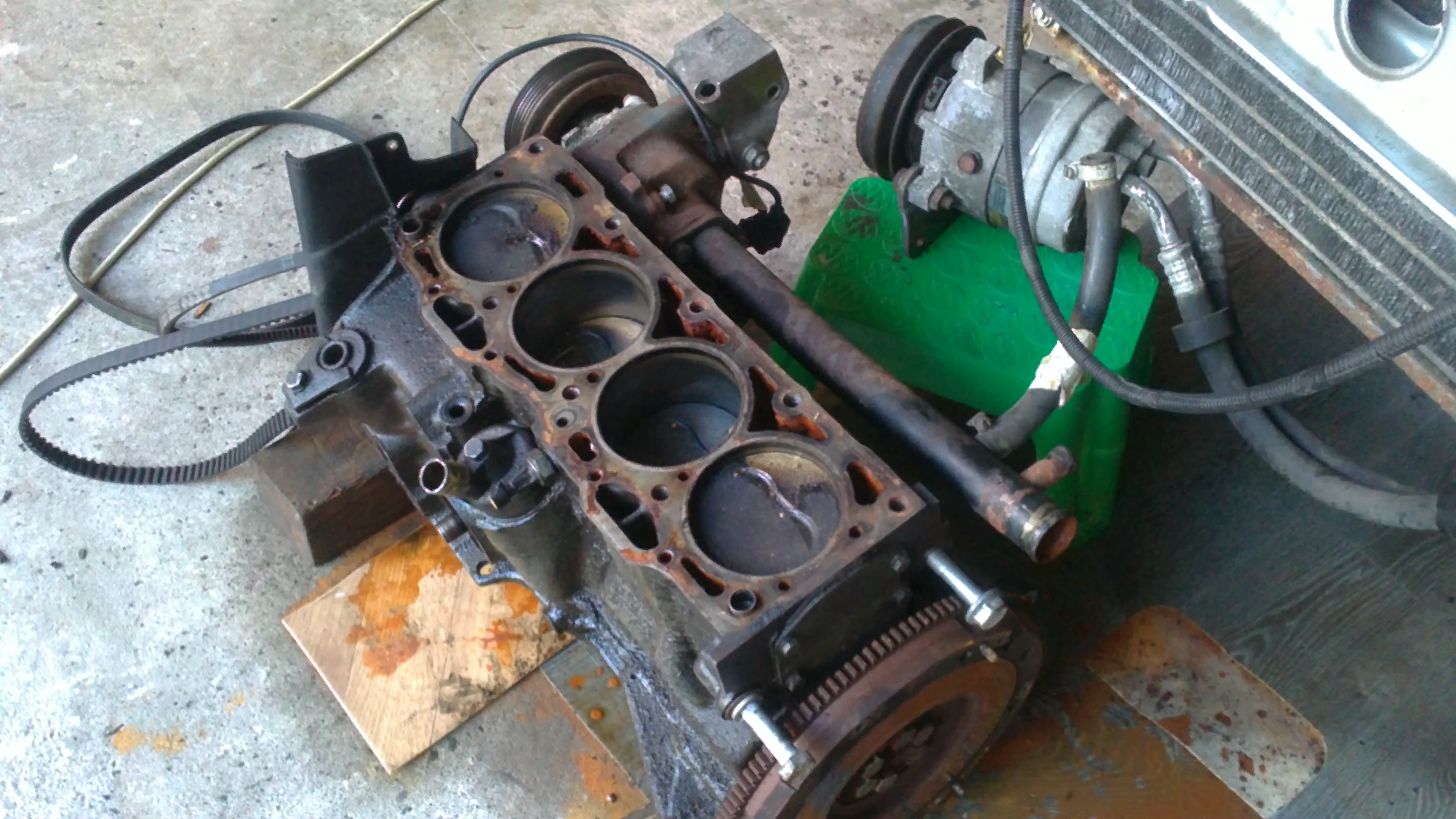

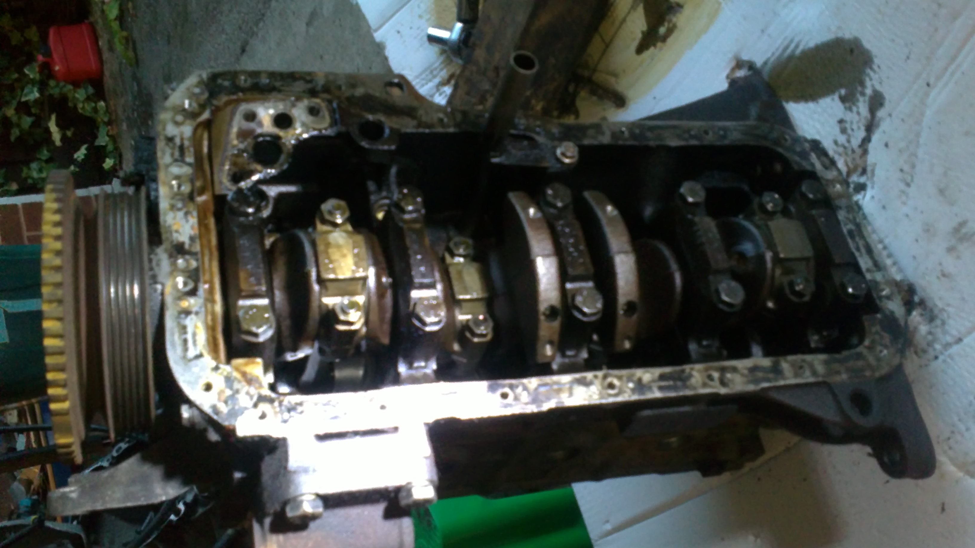

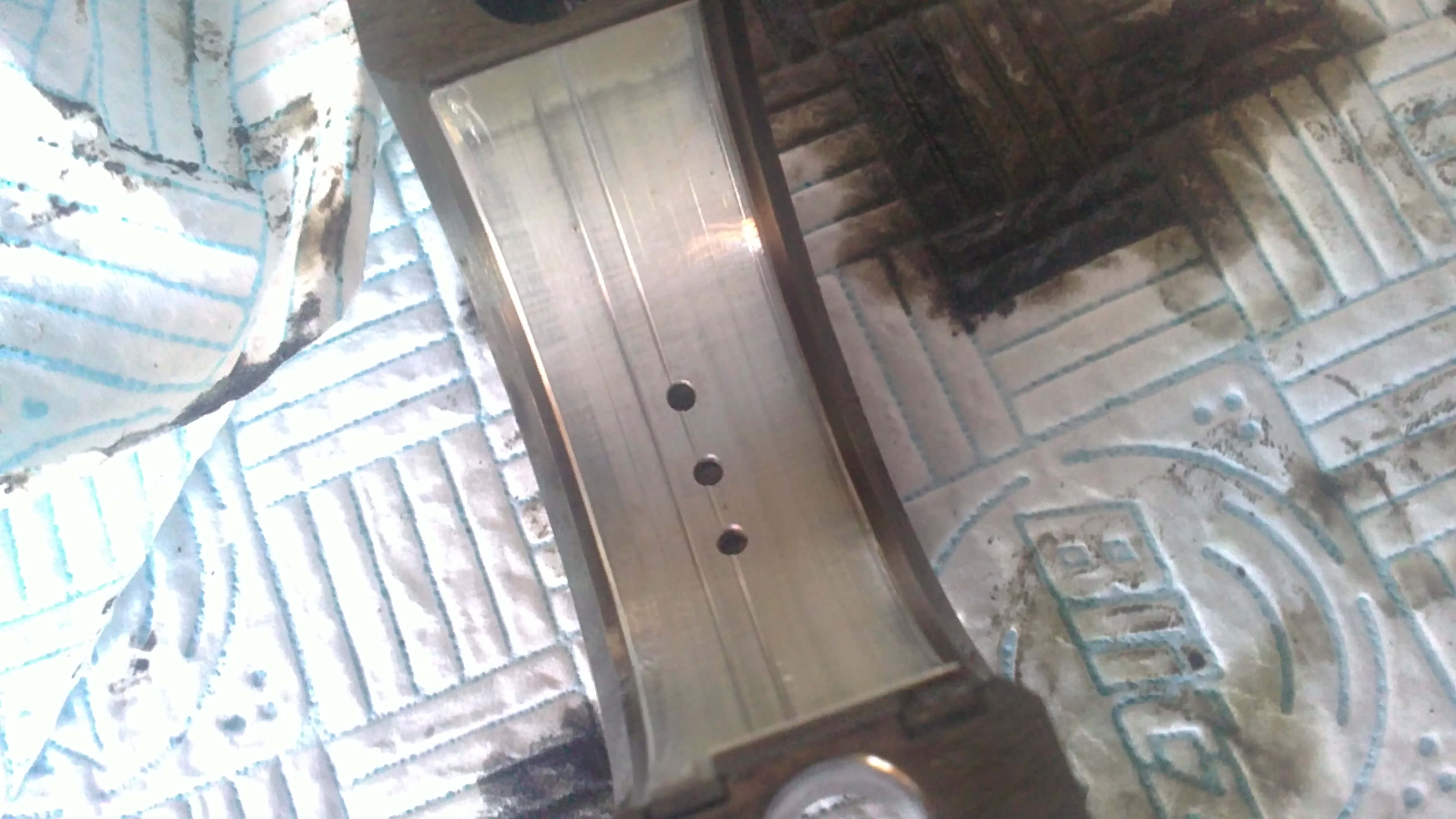

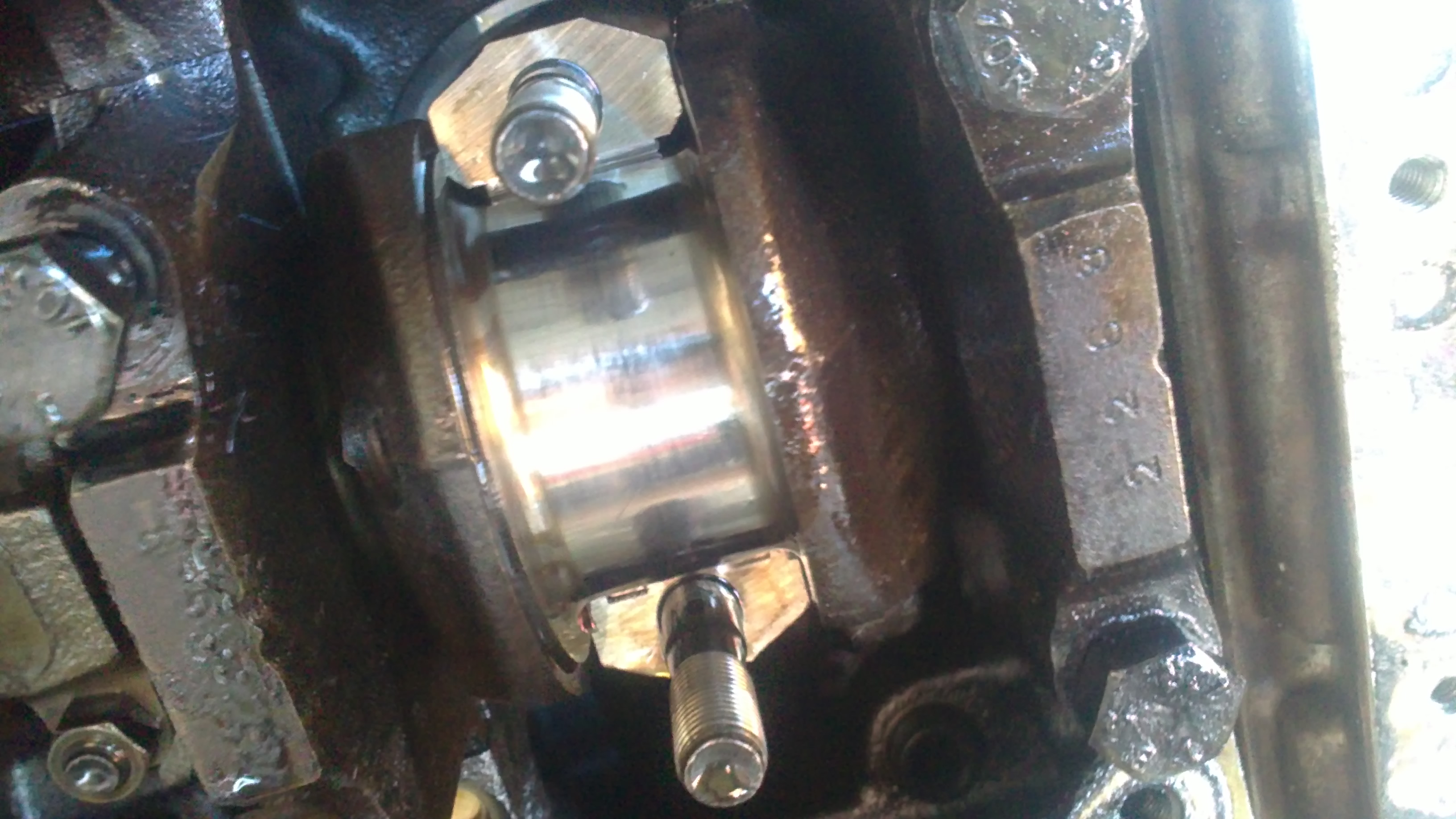

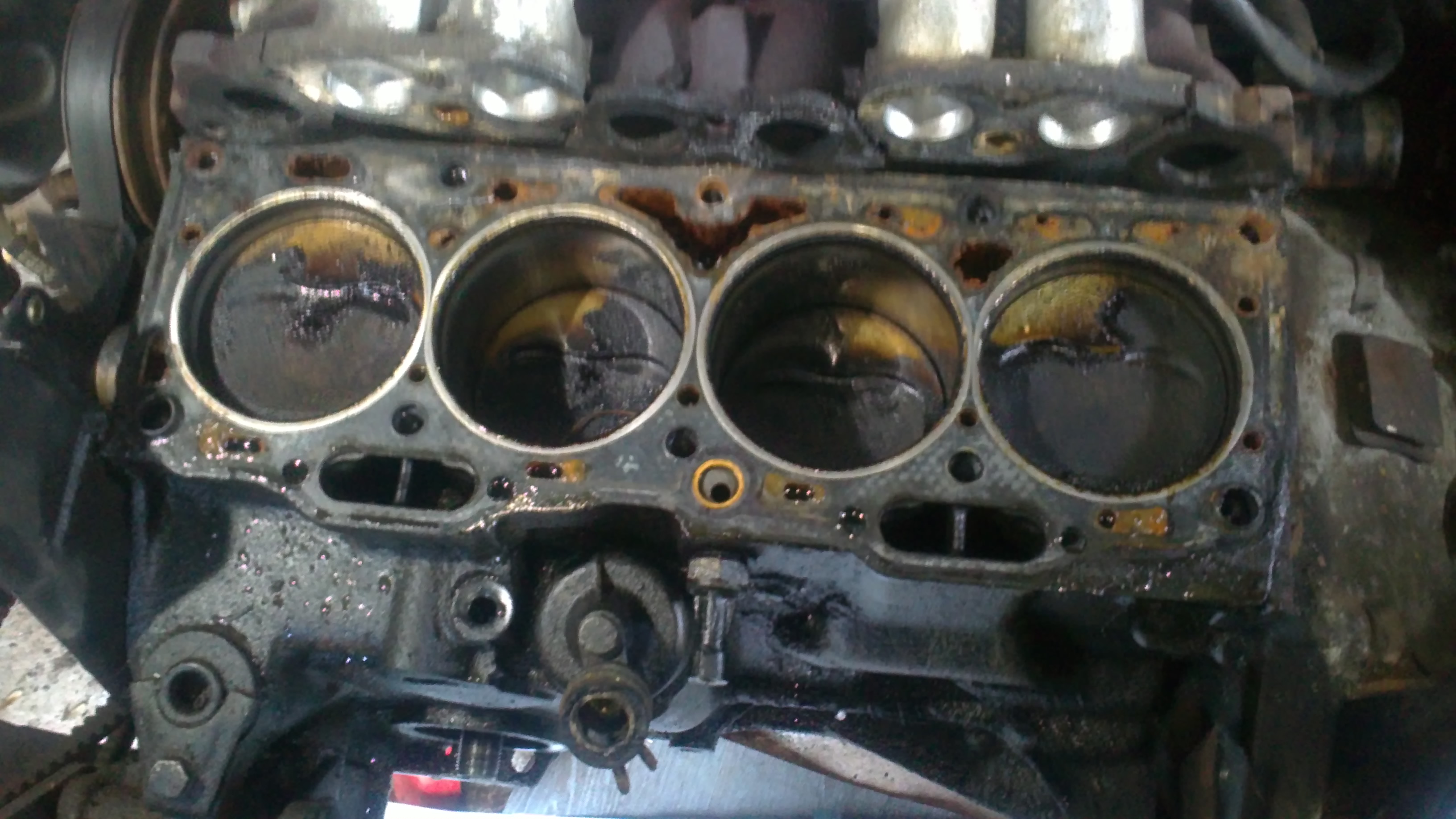

So finally here is the venerable old Lampredi 1581 unit on the floor to see what has gone wrong. The heavy item behind is the aircon compressor.
The gaskets look ok, seems to be much gunge perhaps this was an attempt to bung some gasket seal in to cure the oil/coolant mixing but it shows that it blocks up holes at random. The inside of the head has lost some metal, possibly this is where the mixing is taking place. As I suspected the crankshaft bearings don't look too good with scoring marks, not sure if this is due to grit, overheating or lack of oil.
Sadly I think that engine is firked... seems like classic abuse overheating lack of oil etc.
I think you're looking at a transplant realistically... I’d took for a scrapper mk1 Punto 90 1.6 with MPI.... same engine but efficient fuelling, should’nt be too hard for you to wire in if you’be got all the bits.
