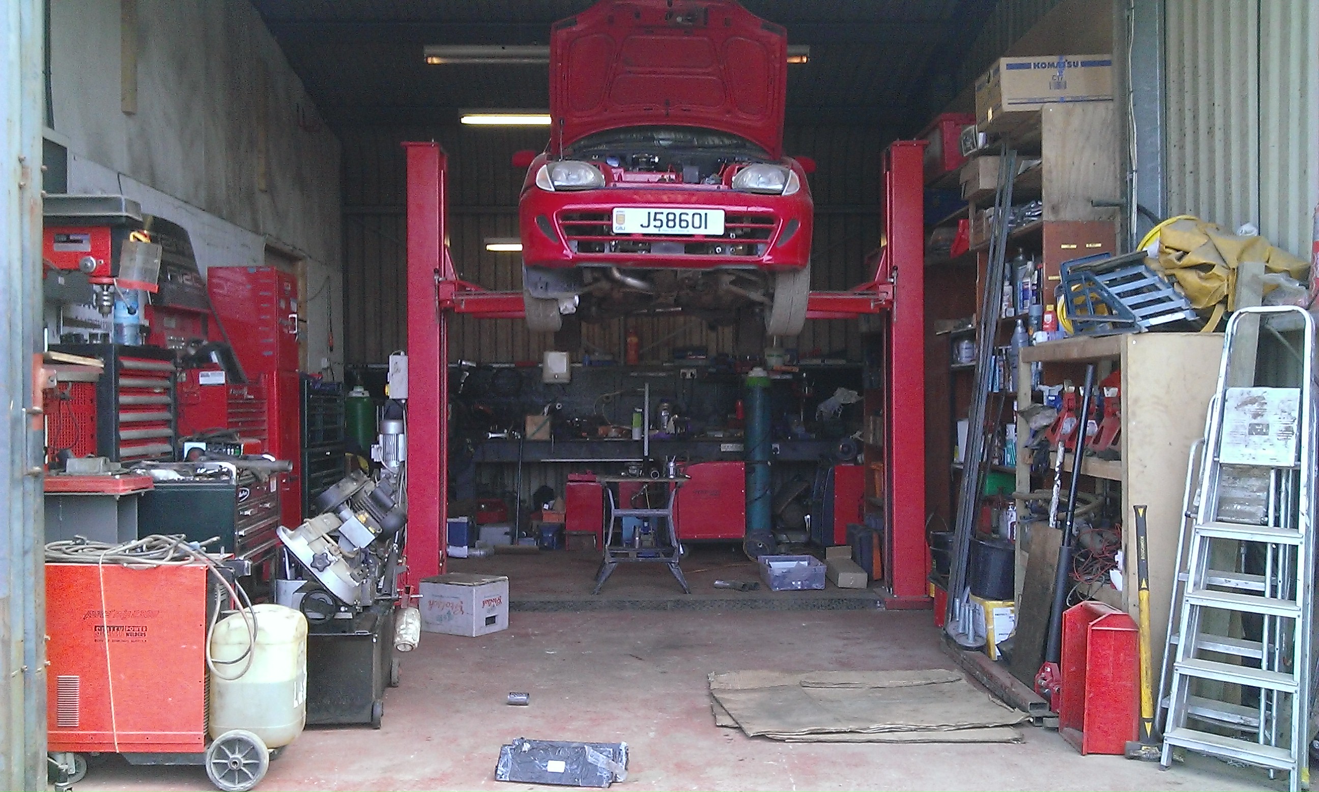

Well starting this is well overdue although technically it's still just a car and a big pile of bits at the moment. It will come together quickly though as I have access to a commercial garage in the evenings and on weekends which belongs to a good friend. I'm lucky enough to have another good friend who is a self employed coded welder/fabricator and yet another good friend who owns a powder coating business. Myself, I do electronics so pretty much everything is covered.
I'm not going to go into minor details as most of it has been discussed before (especially the engine which was purchased from Gazzaman). However I will answer any questions and will go into detail with the DET 3 setup and installation as there are no UK guides I'm aware of for this.

I will just post some pictures of the bits for now and then intermittently as I fit them.
I do however need to keep this car mobile to park it back in my workshop so it will be done in big chunks.
