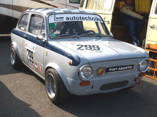

I actually have a full spare Abarth body kit in silver and boxes full of Cinq spares (including a manifold and a turbo), however if I do another small Fiat it would have to be something like this:
I'd like to do a project that is actually worth more than when I started for a change... lol
An 850?
That's a bit random is it not?
No thanks, cool looking car but...
My friend had an Evo 2 and although I have to admit he should of used it a bit more than he did, that car was a permanent headache. Constant rust, electrical problems, pipes blowing off the turbo, doors and windows seizing up etc. Sounds like a proper Italian car I know lol. Also (this will some cringe) I scrapped a non Evo HF turbo when they wern't valuable some years back because it needed a turbo (I wanted the leather interior). :D
The car was fairly clean until we started cutting up, then we discovered it was like a reversed Dime bar, chewy on the outside but crusty in the middle. Man rust protection sucked in this era, you really have to be keen to own something like this. I like little Fiats anyway, easy to manage, simple to work on, cool looking and things like the 850 are as rare as a good mortgage deal during a recession. :devil:
