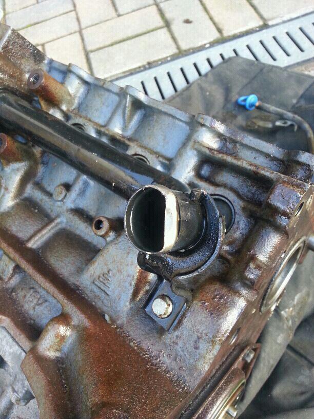

Went to the post office today to collect a missed parcel.... It was my new water pipe. :D
Now that's what I call quick delivery, next day to Jersey is almost unheard of! :worship:
It has a much improved version of the original seal which is nice. The first thing we did was to cut it up LOL.

i'll go put my rolling pin down, good post.. Thats exactly what i was thinking with the water pipe (y)
