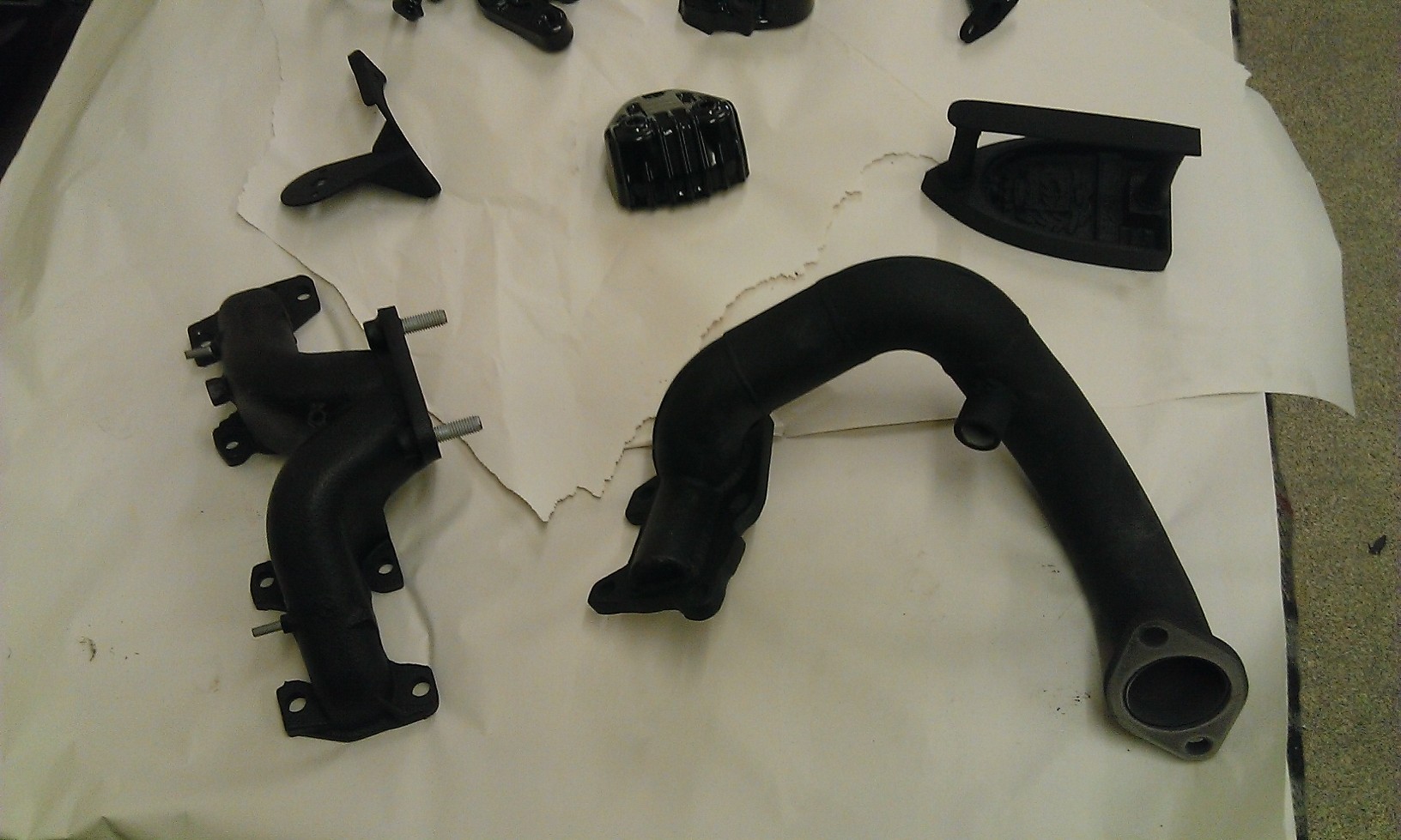

:yum: More powdercoated bits:
Notice the mat coating is supposedly 800 degree Celcius on the exhaust manifold, downpipe, drain, actuator bracket etc. The other stuff is is just the standard spec. Obviously the motorbike caliper and antique iron are not for the Cento. :D
Hope the weather is nice tommorow, look forward to sticking these bits on permanently at last. (y)
