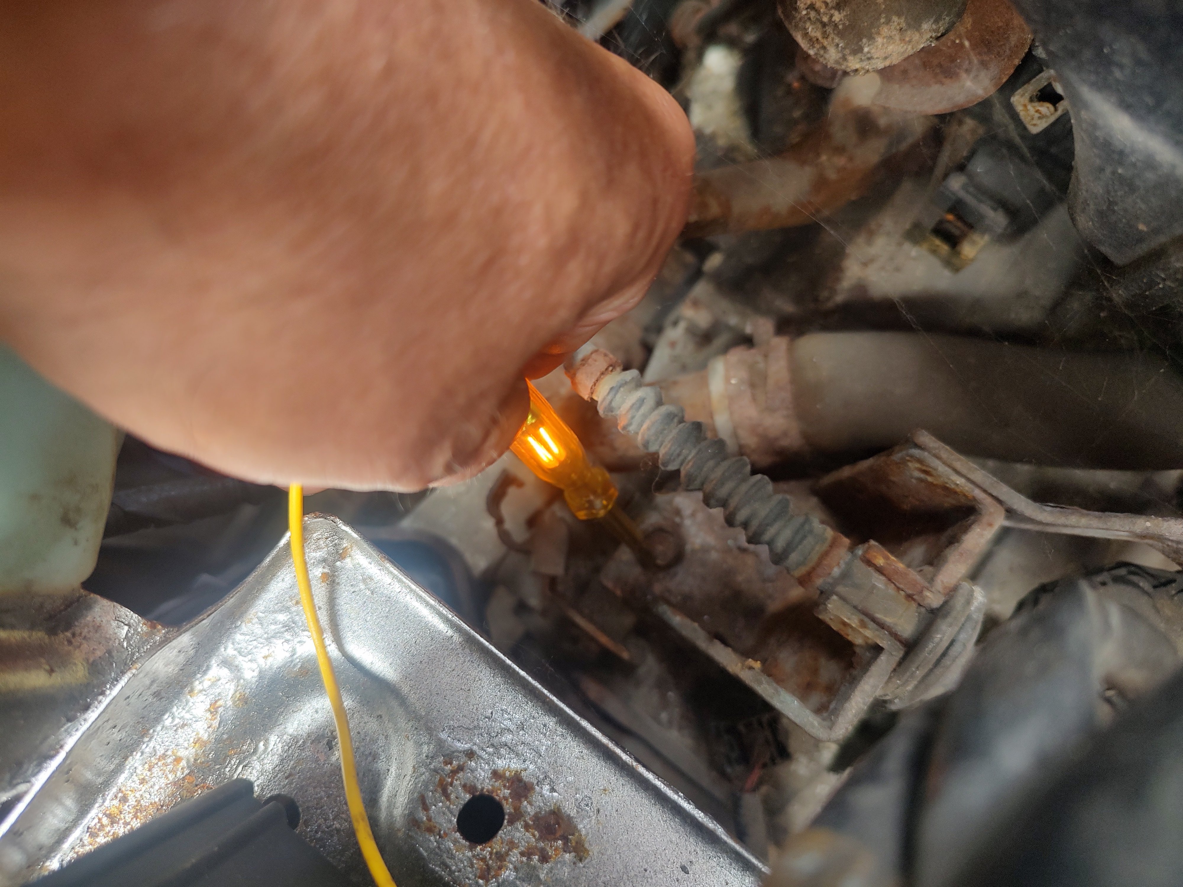

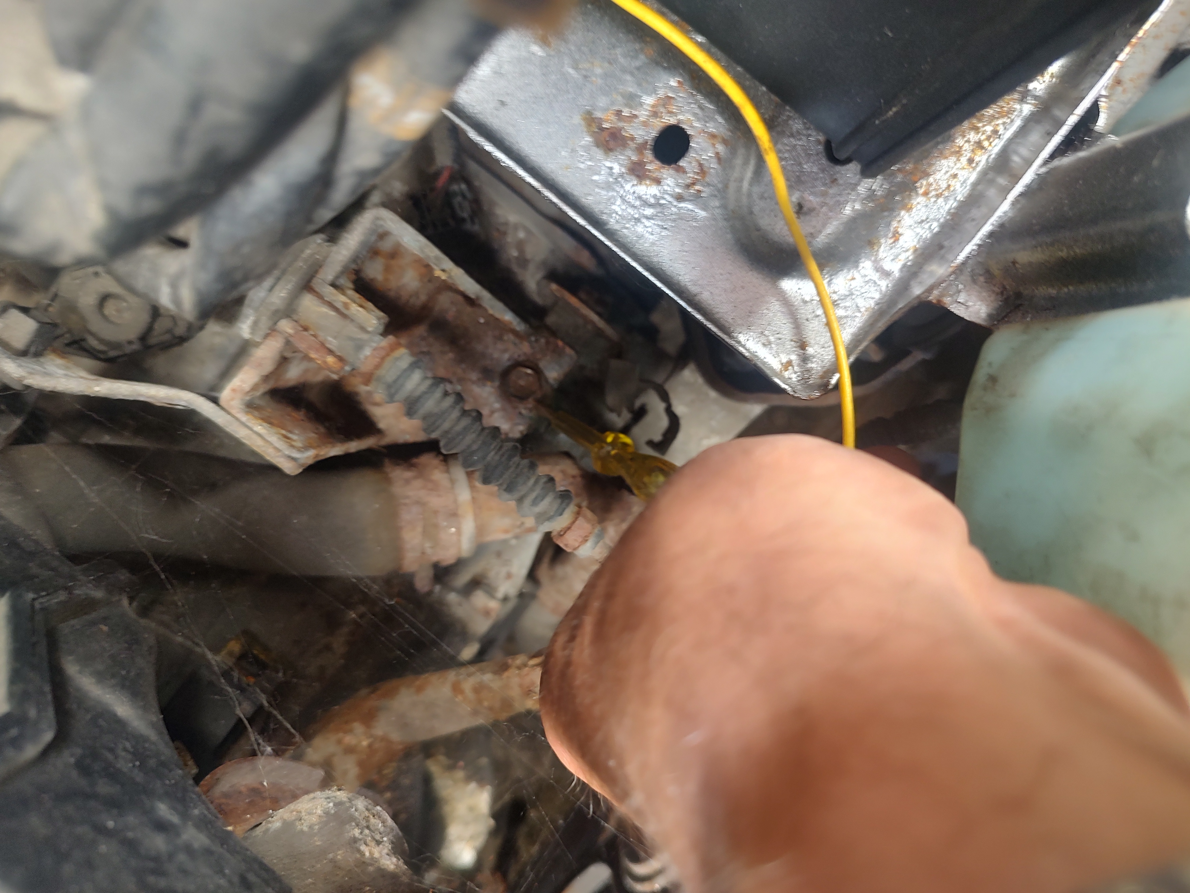

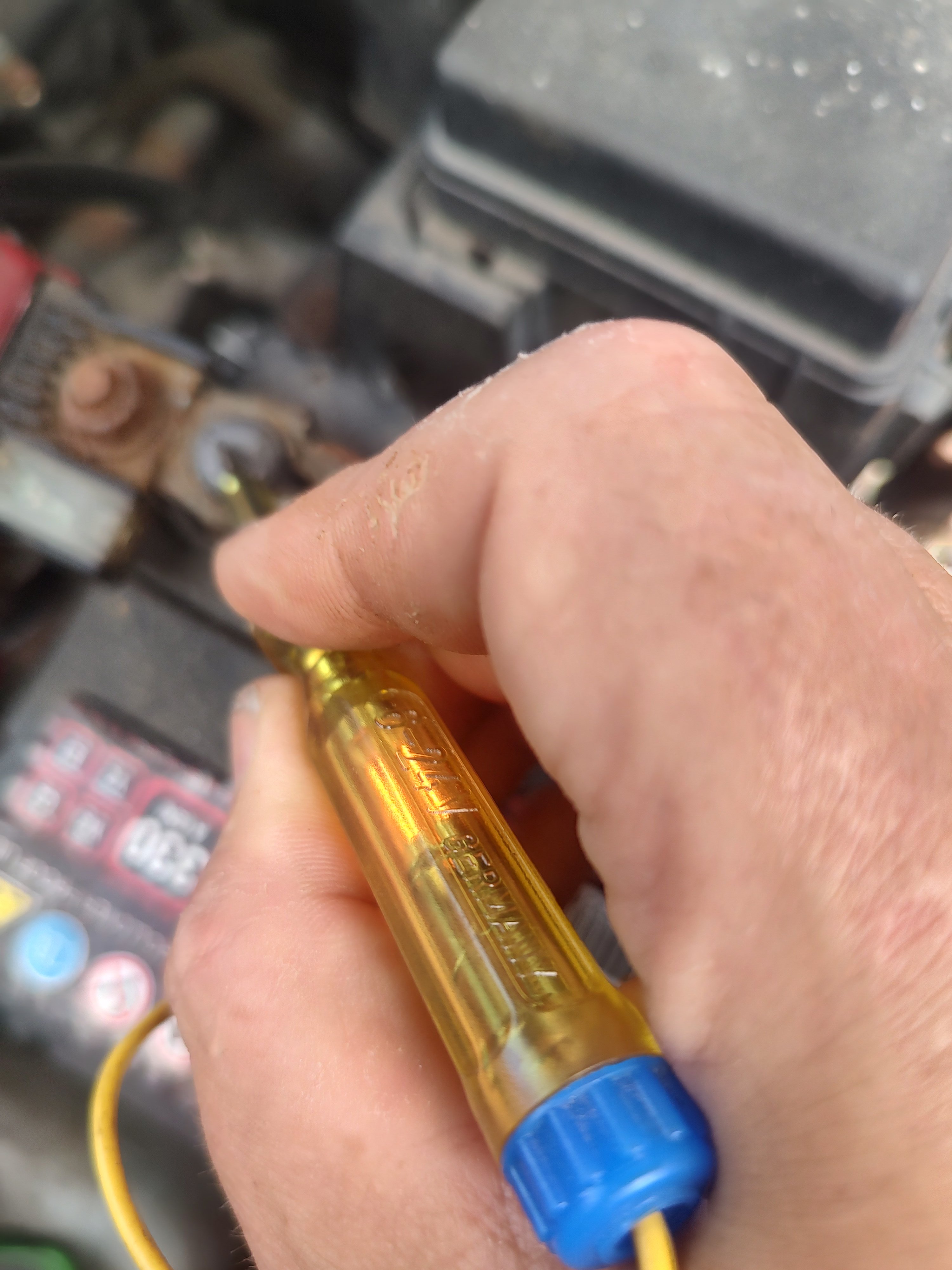

Hi koaler success someone had insulated the small thread that fits inside the battery tray with tape presumably to stop it rusting I took the tape off so I could get the bolt off then the gauge instantly went to 3/4 so thanks for your help
