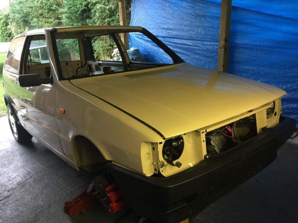

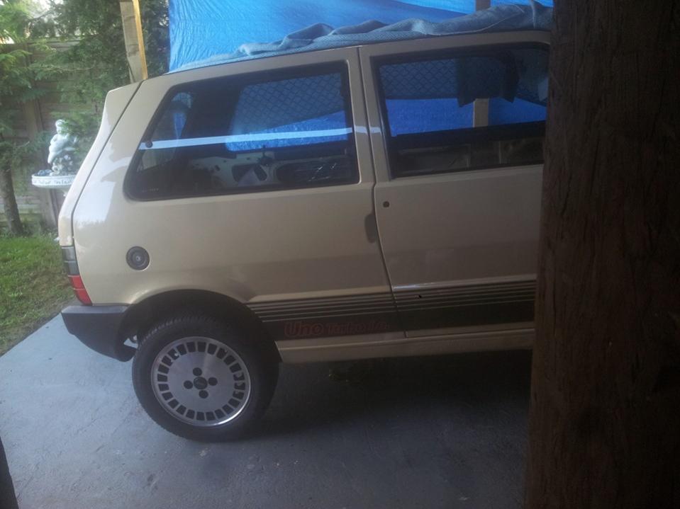

so the car is a 55 s which i purchased without seeing and got it transported to me, the main issue with uno's are rust to rear and front suspension turrets, luckily i got lots of pictures sent to me before buying and this one had a gleeming shell (strength wise)
now the colour is a bit of a marmite colour but i kind of like it all the modern fiats are in this colour so why not hey

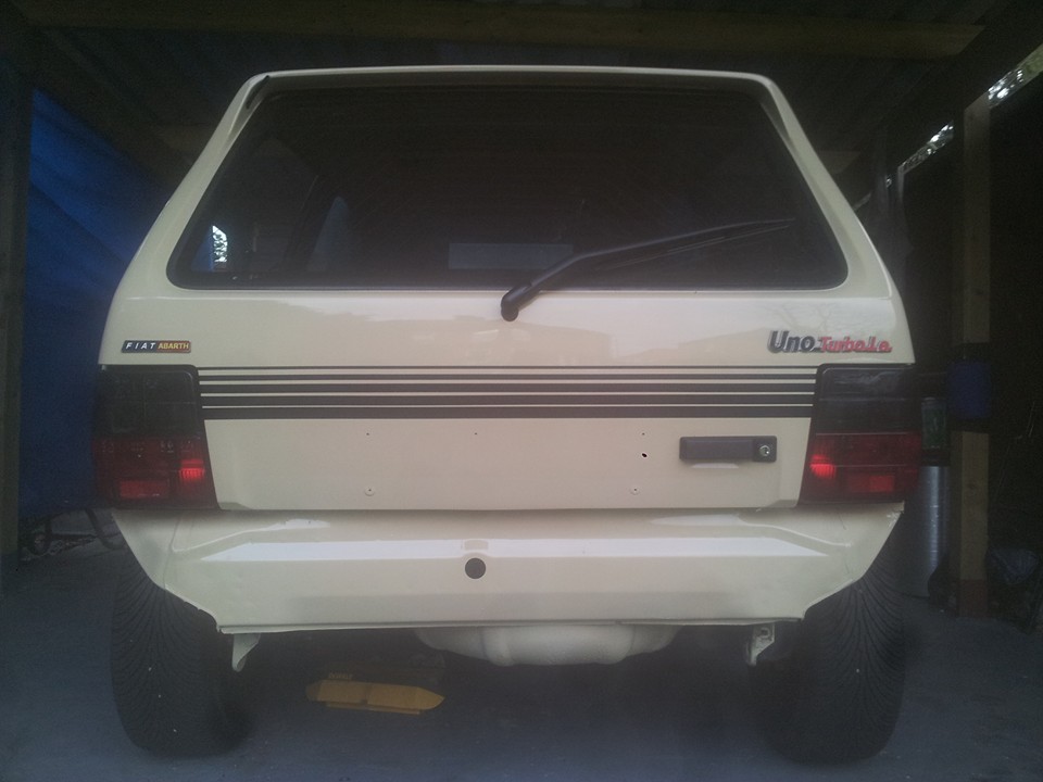

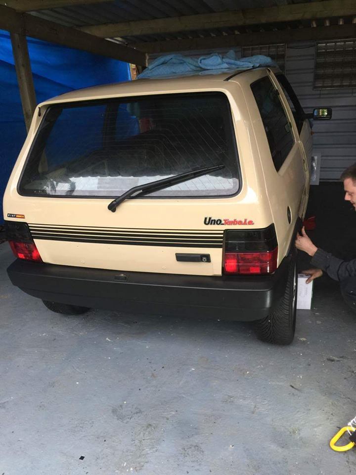

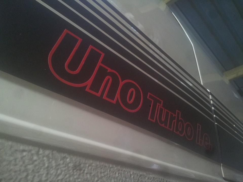

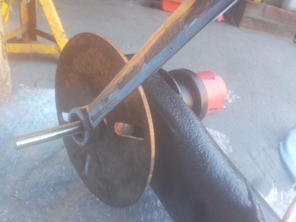

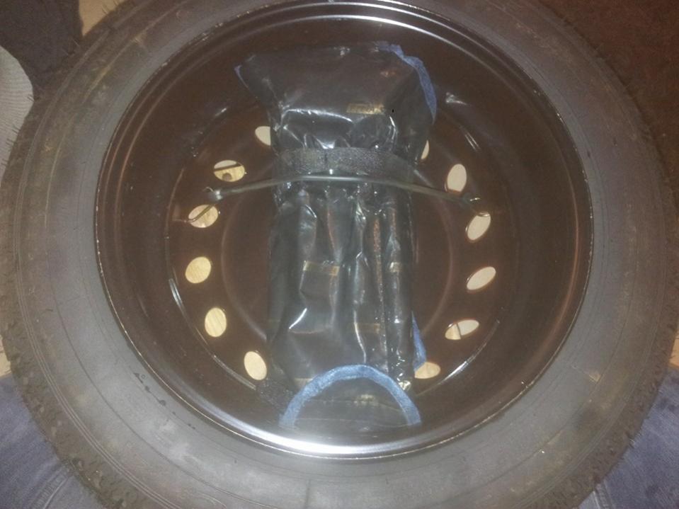

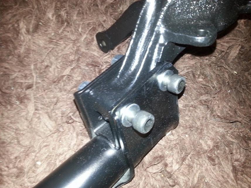

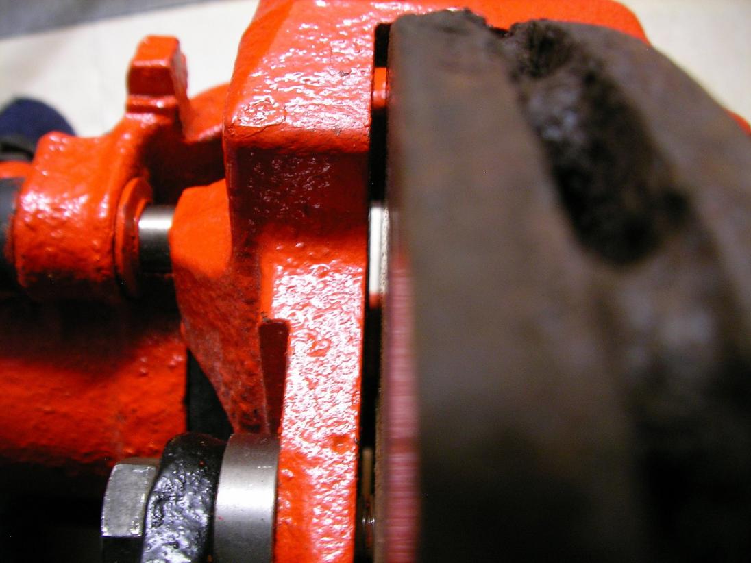

heres some pics so far of some bits and bobs i have done so far
donor vehicle reg and bootlid on another scrap shell

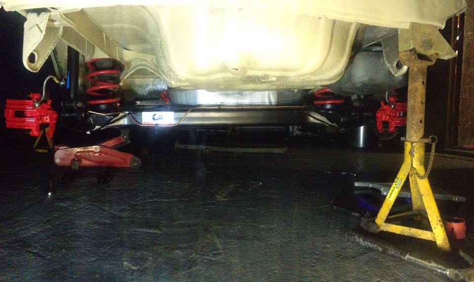

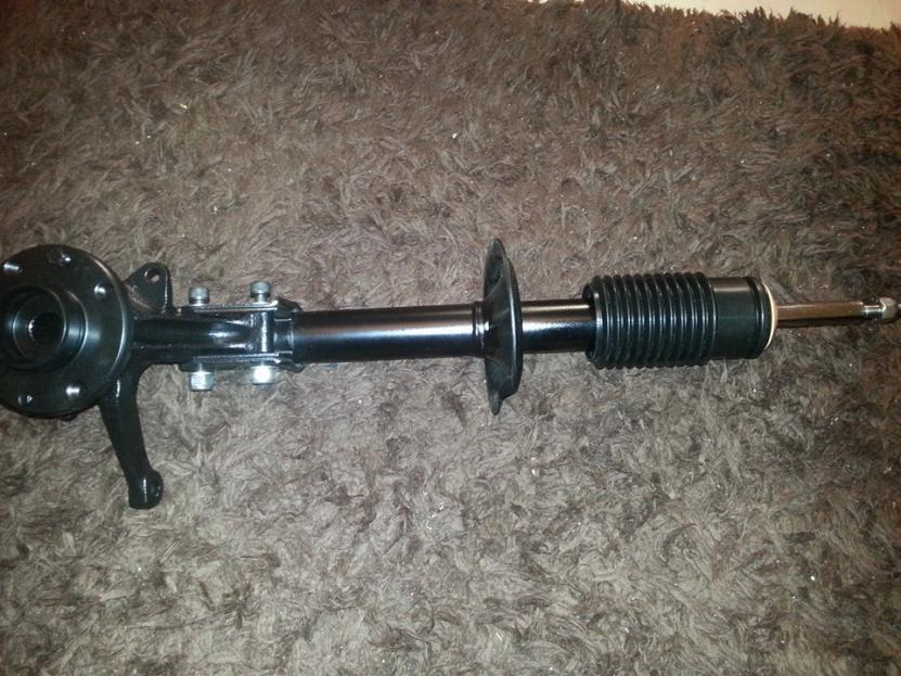

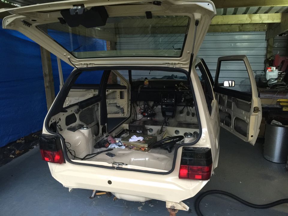

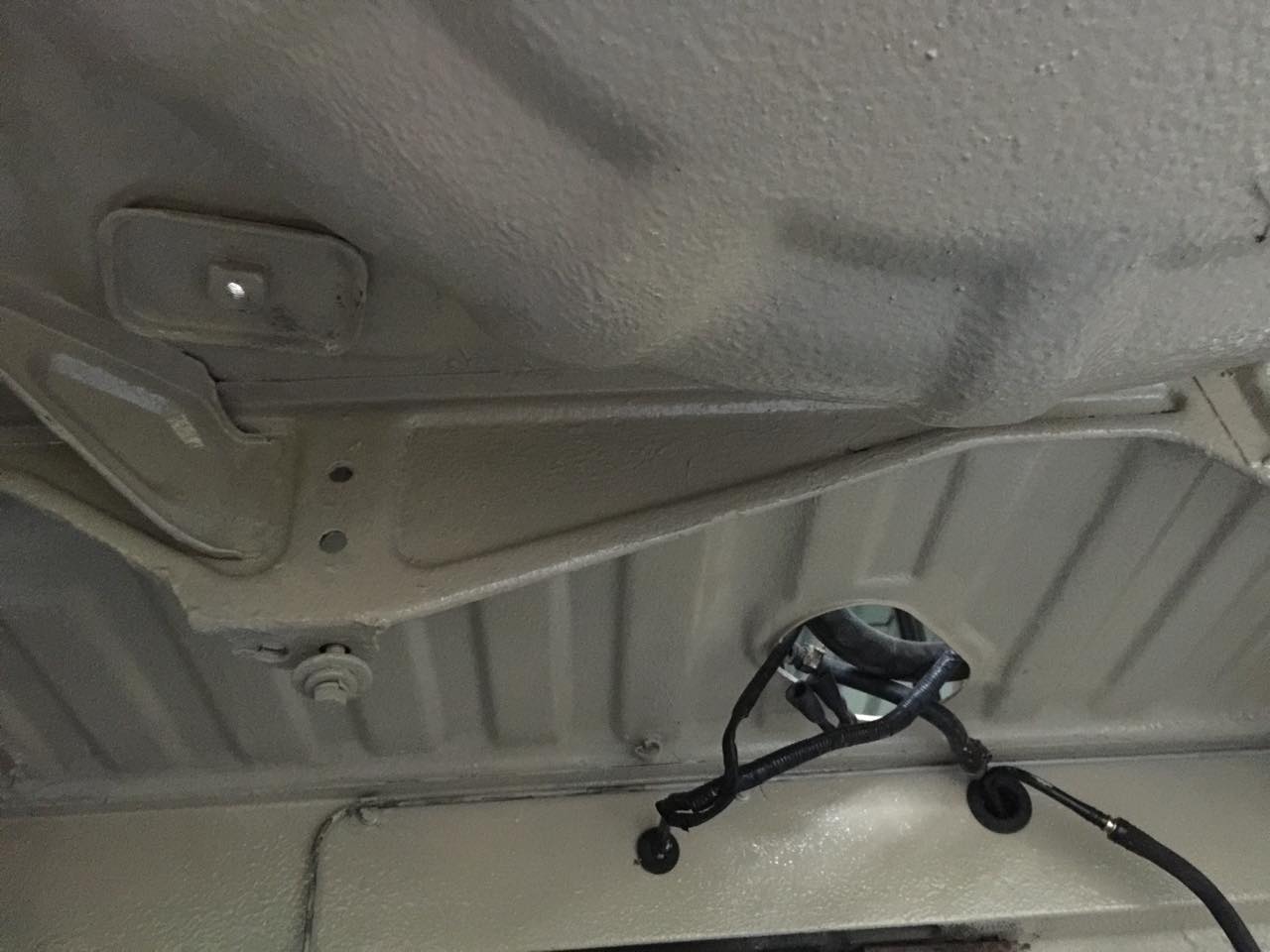

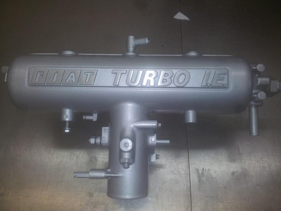

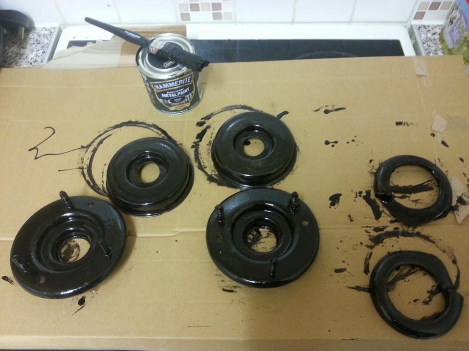

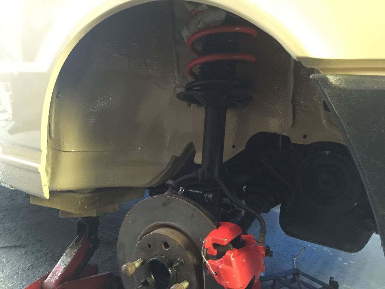

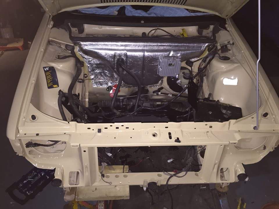

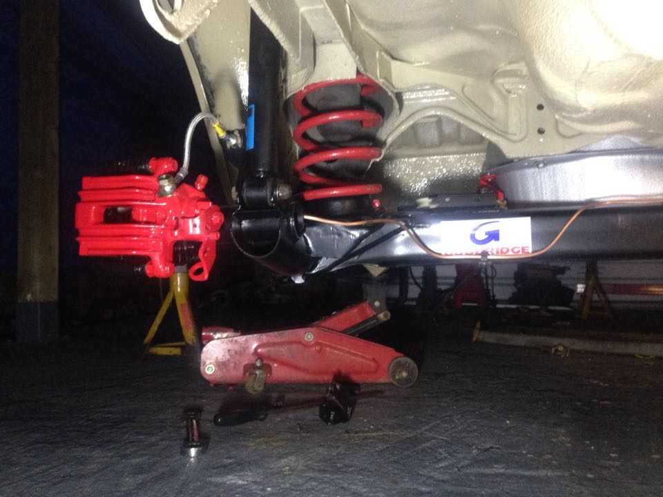

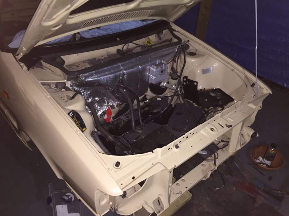

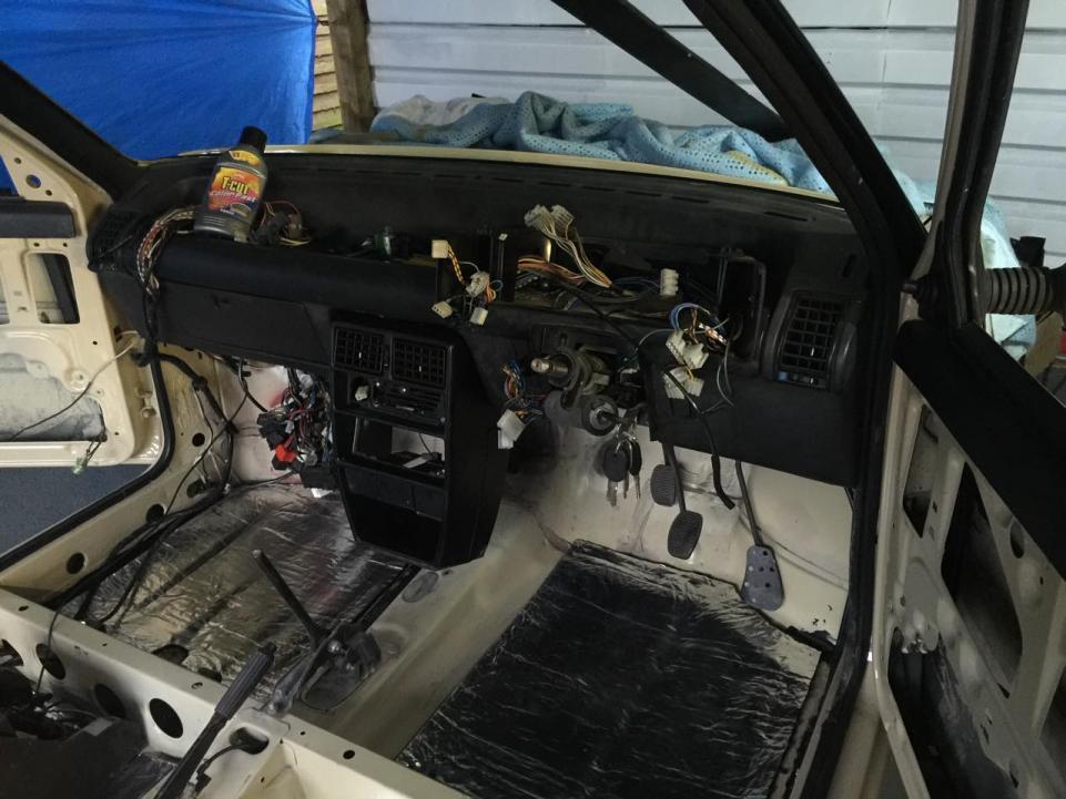

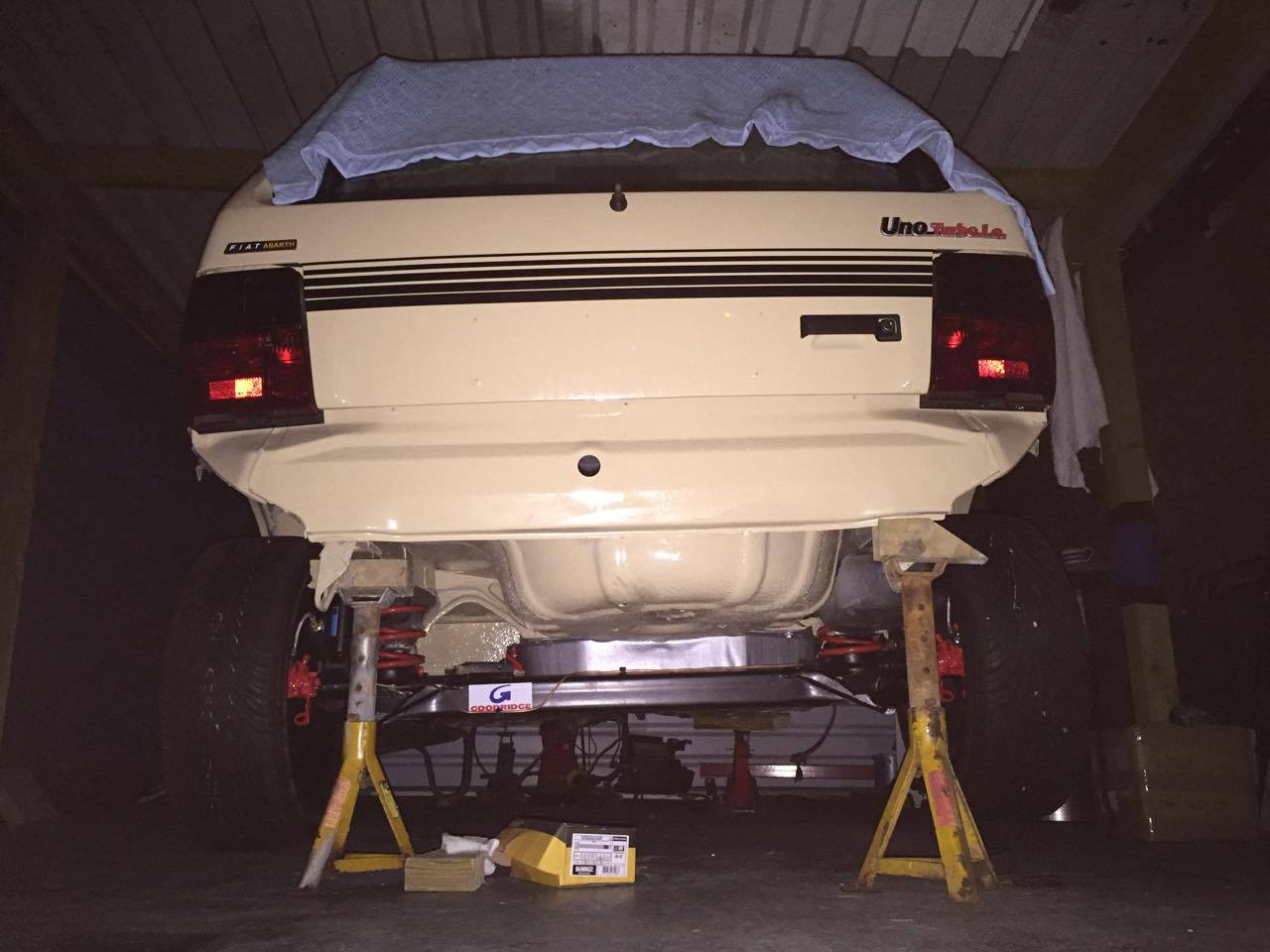

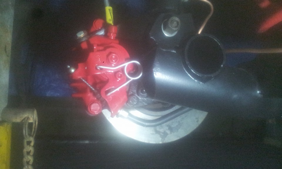

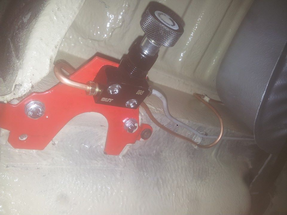

more painting underneath and more bits and bobs fitted aswell as dash
a dawnting job but getting there slowly, i couldnt imagine doing a modern car

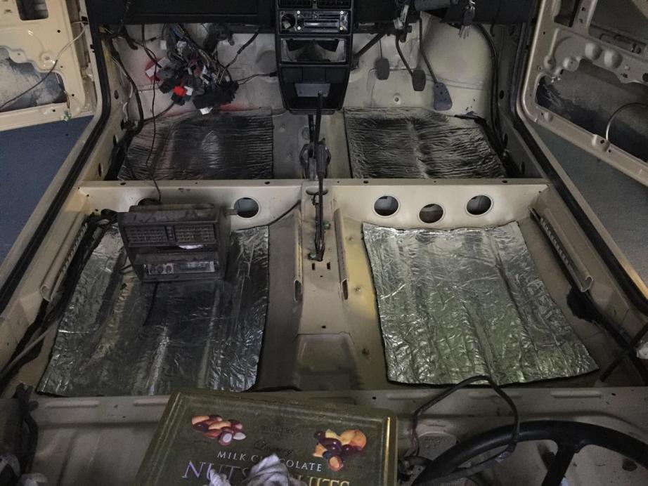

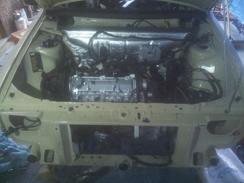

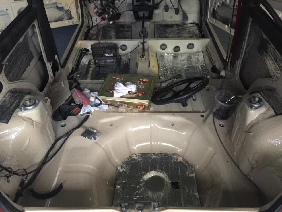

the glassmat stuff i got for the firewall isnt very fire resistant so decided to use it for interior sound deadening instead not the tidyest of jobs but all going to be covered up with carpet and panles so doesnt really matter, and a lot better than fiat done originally

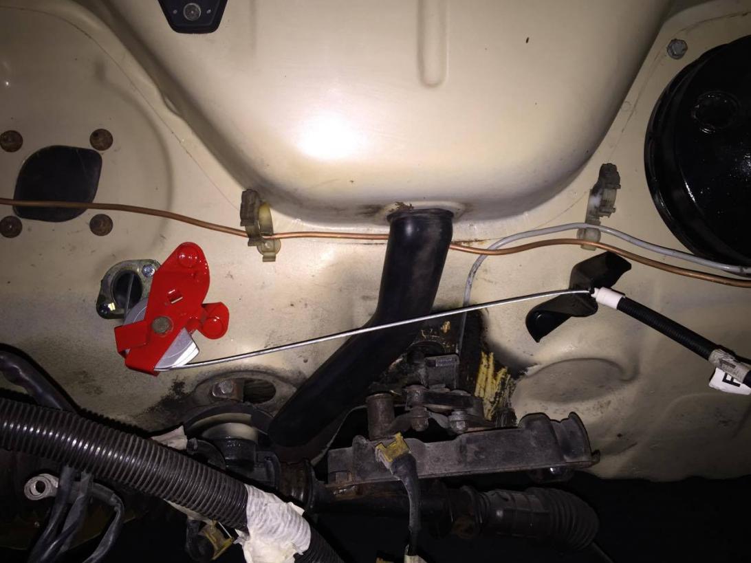

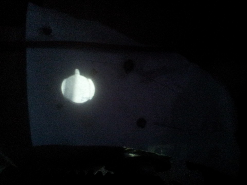

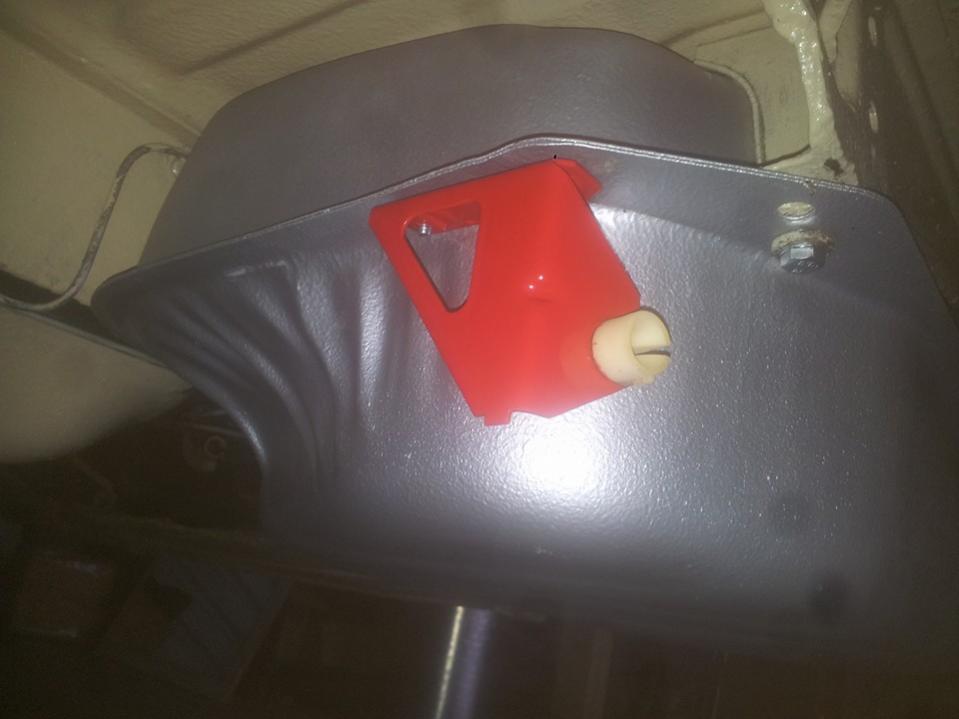

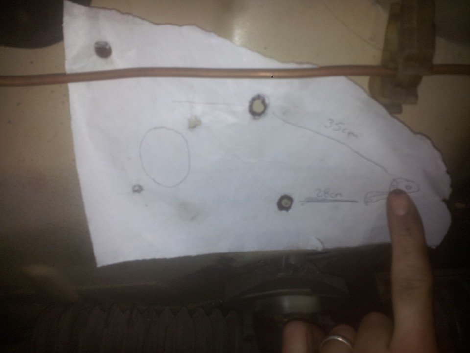

clutch cable bracket holes on the bulkhead sketched from my mates uno, i really was worried about this, fingers crossed i drill in the right place, this is one of the downfalls of having such an old non turbo uno shell the newer unos turbo or not have all the holes ready togo, but typically my luck i would get one with no predrilled holes

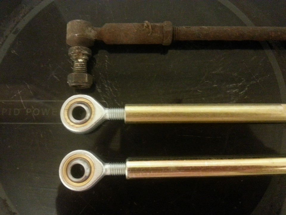

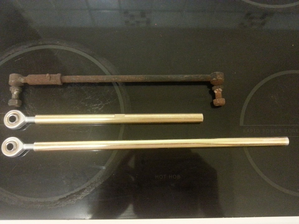

also got some custom gear linkages from mcgill motorsports to replace the tatty originals
Exclusively from McGill Motorsports. McGill Turnbuckle Linkages are constructed from Carbon Steel 1045 (C45) and are zinc plated for corrosion resistance. The linkages are internally threaded right hand at one end and left hand at the other to make them adjustable in length without having to remove the bolts from the rod ends
1 x Turnbuckle M8 Link. Adjustable from 340 mm to 370 mm linkage
( 190245601889 )
1 x Turnbuckle M8 Link. Adjustable from 240 mm to 270 mm linkage
( 161117449463 ) <<ebay item number
2 x 8mm Male Rod End Bearing, Left Hand Thread M8X1.25 Rose Joint, Bronze Liner ( 320997270991 )
2 x 2 x M8 x 1.25 Male Rod End Rose Joint Right Hand Thread 8mm Metric Bronze SA8 ( 121688612551 )
