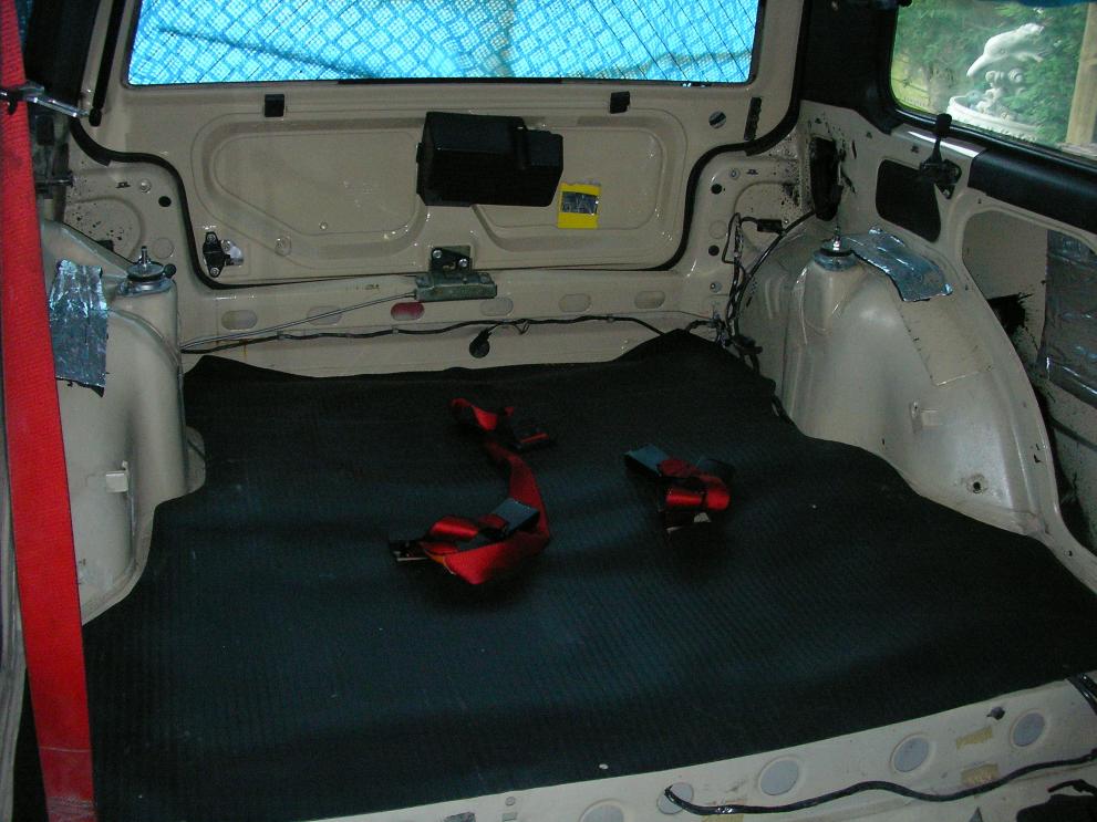

heres some pics so far of some bits and bobs i have done so far
donor vehicle reg and bootlid on another scrap shell

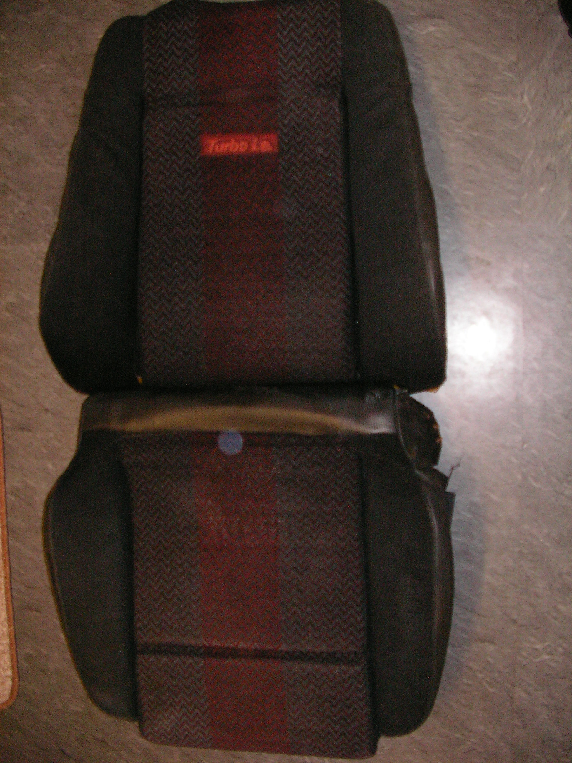

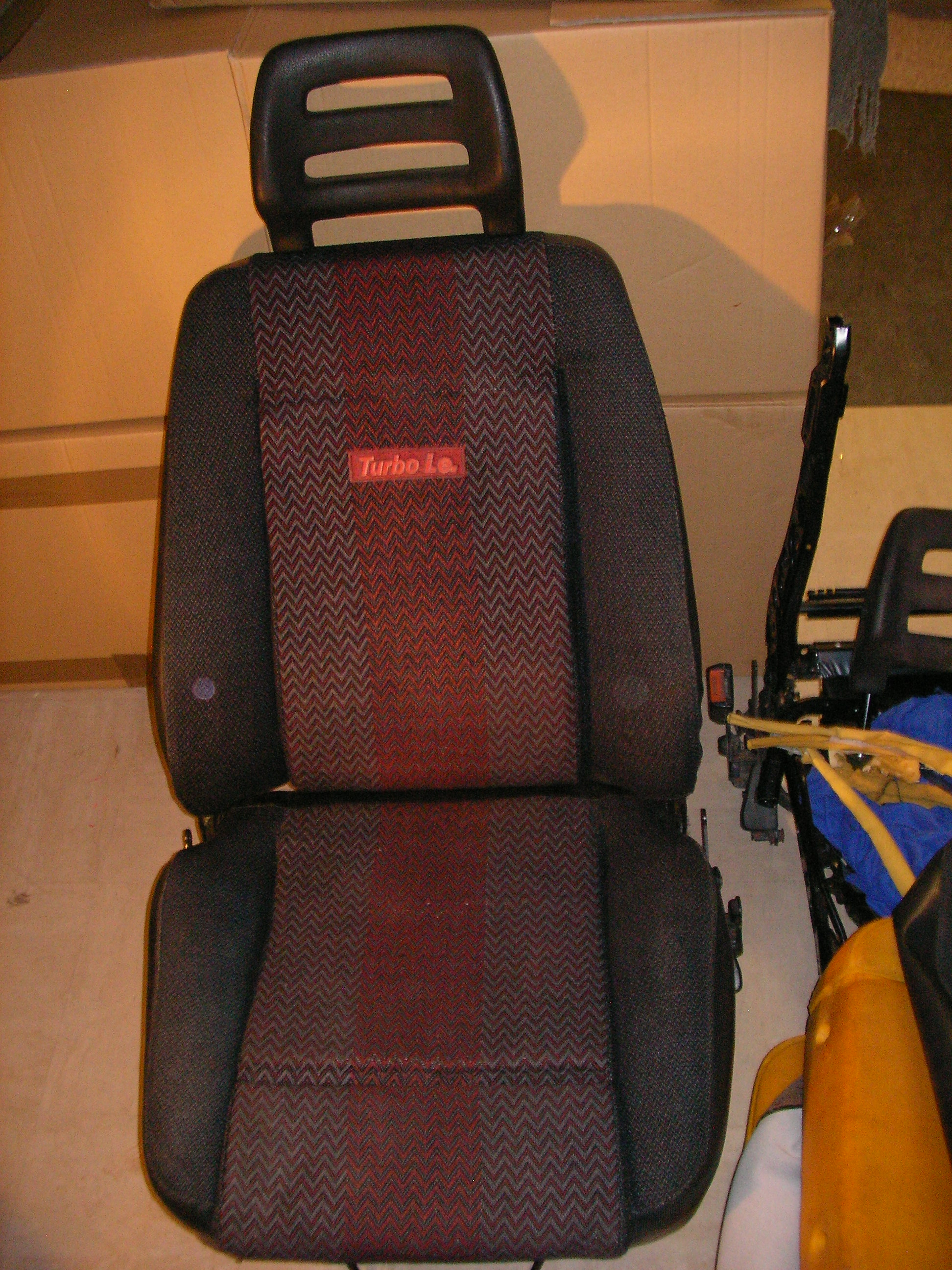

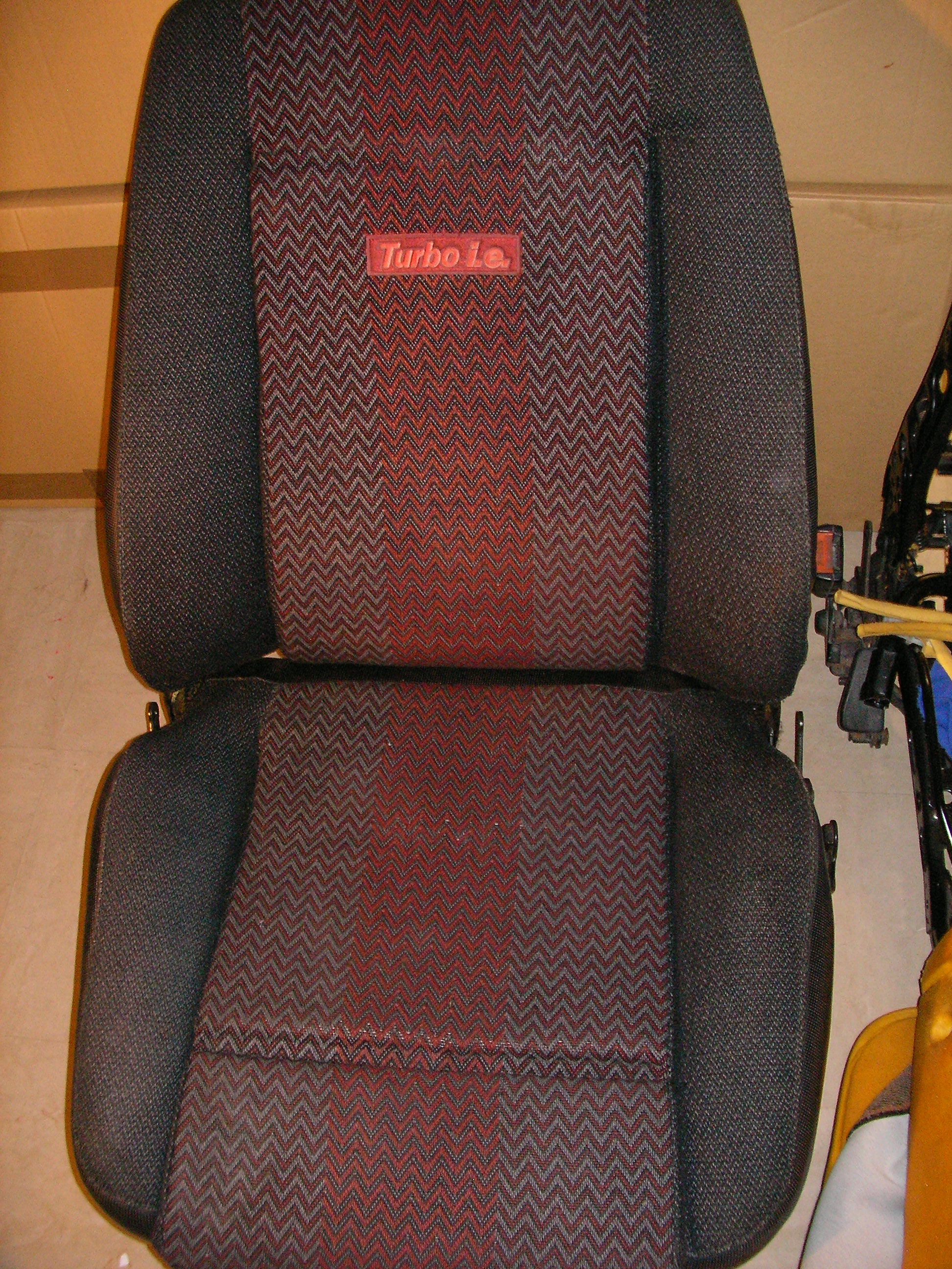

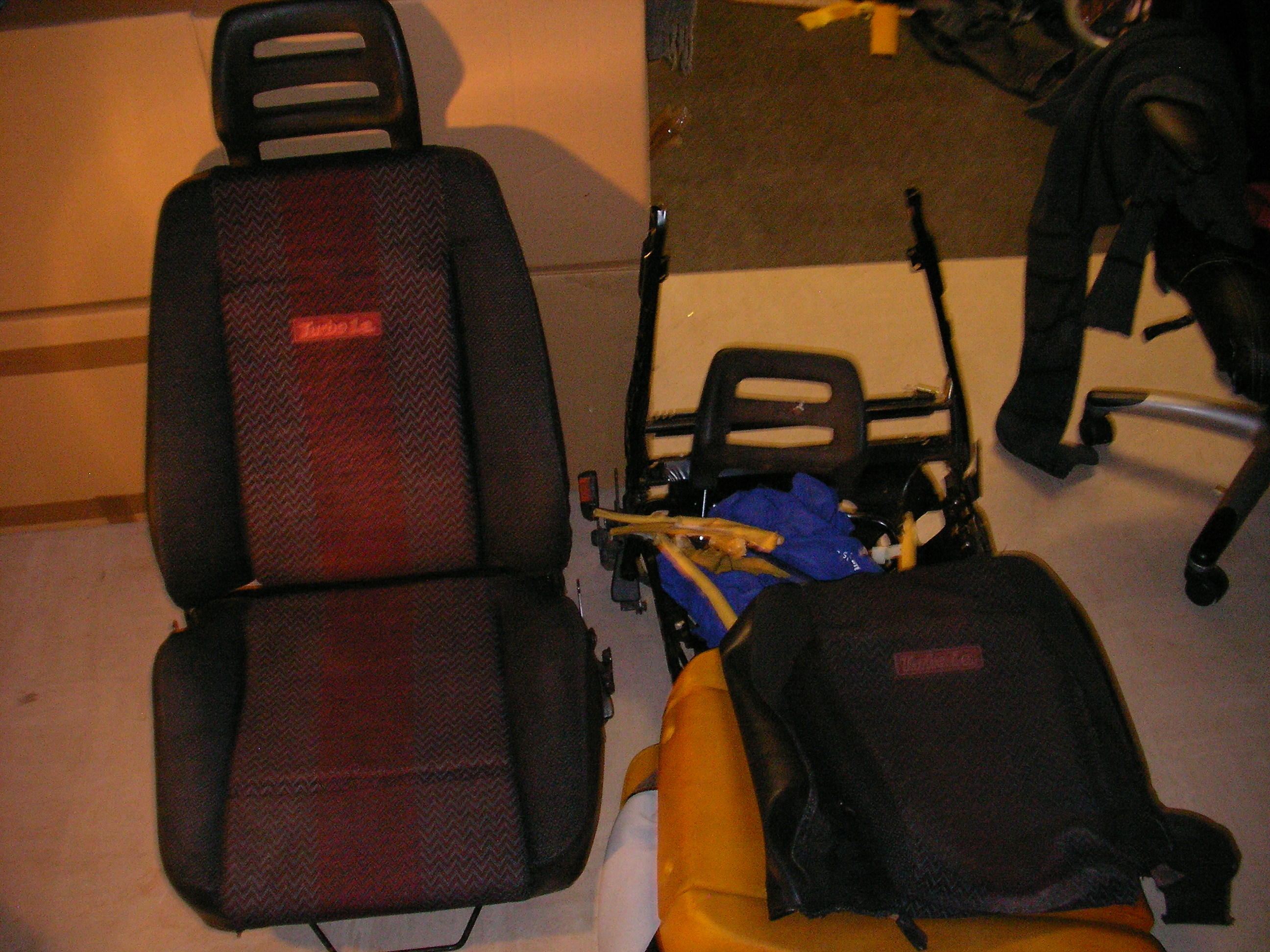

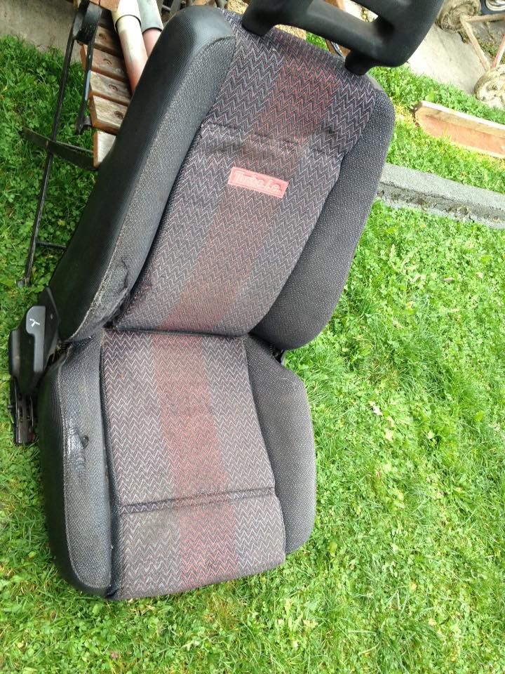

the drivers seat was looking worn and torn so i got another passengers seat and transfered the fabric, was not an easy task but worth it

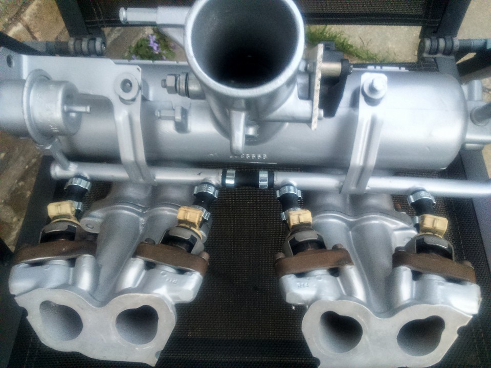

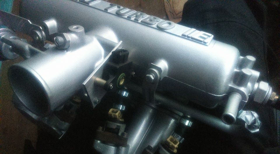

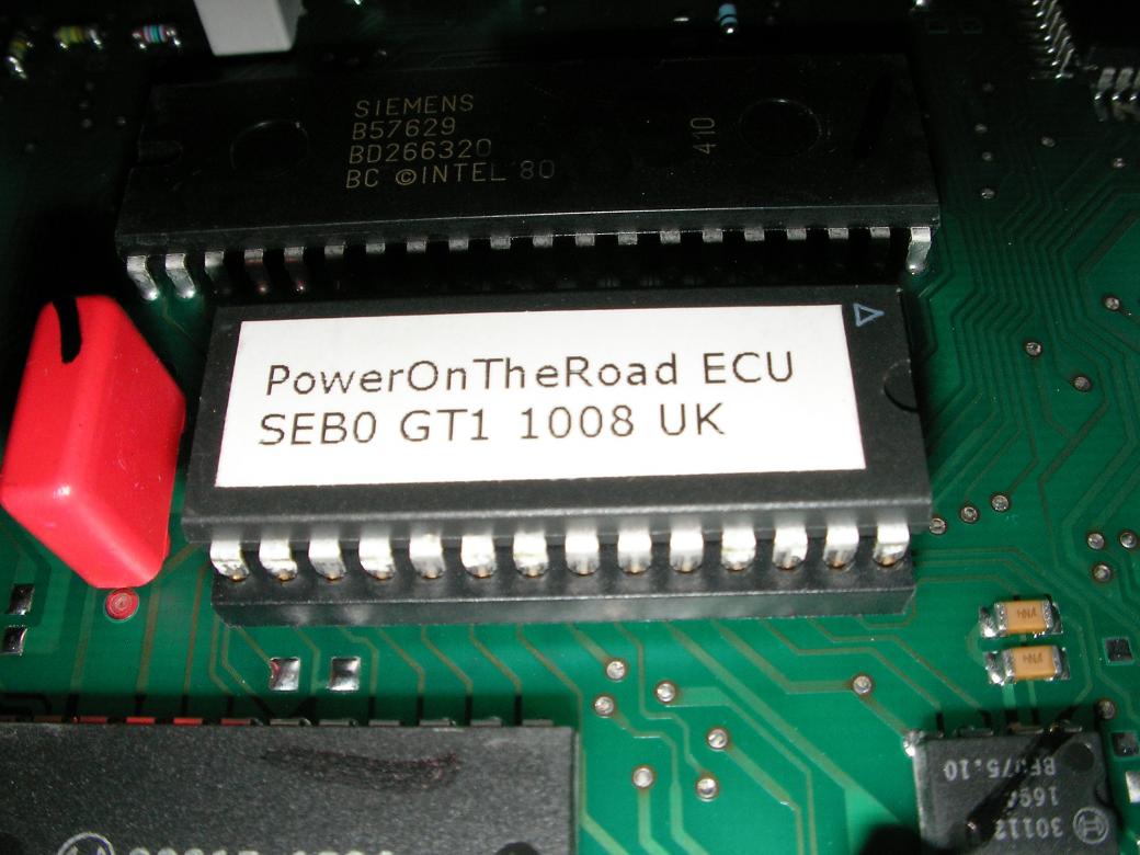

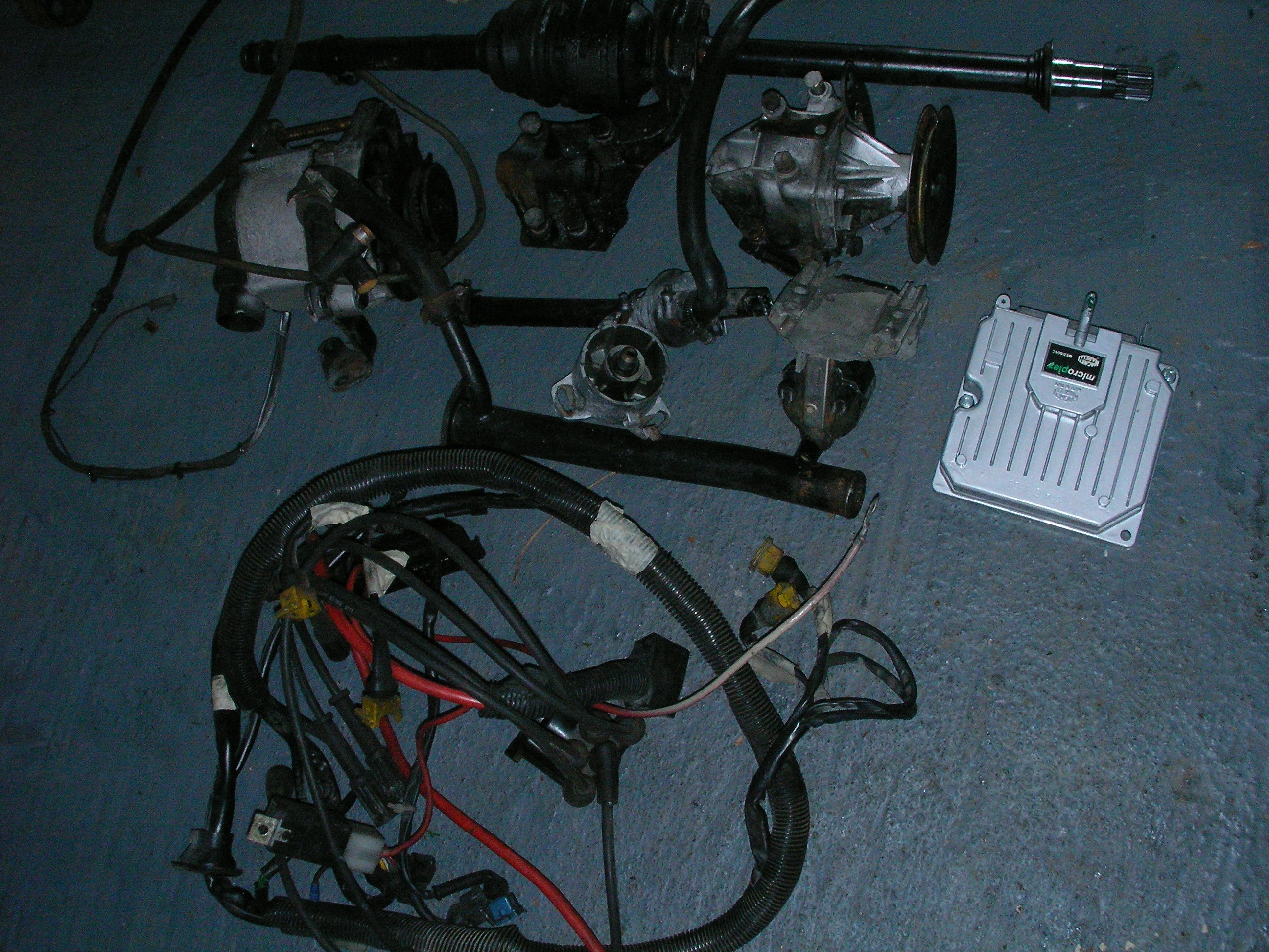

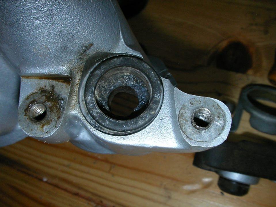

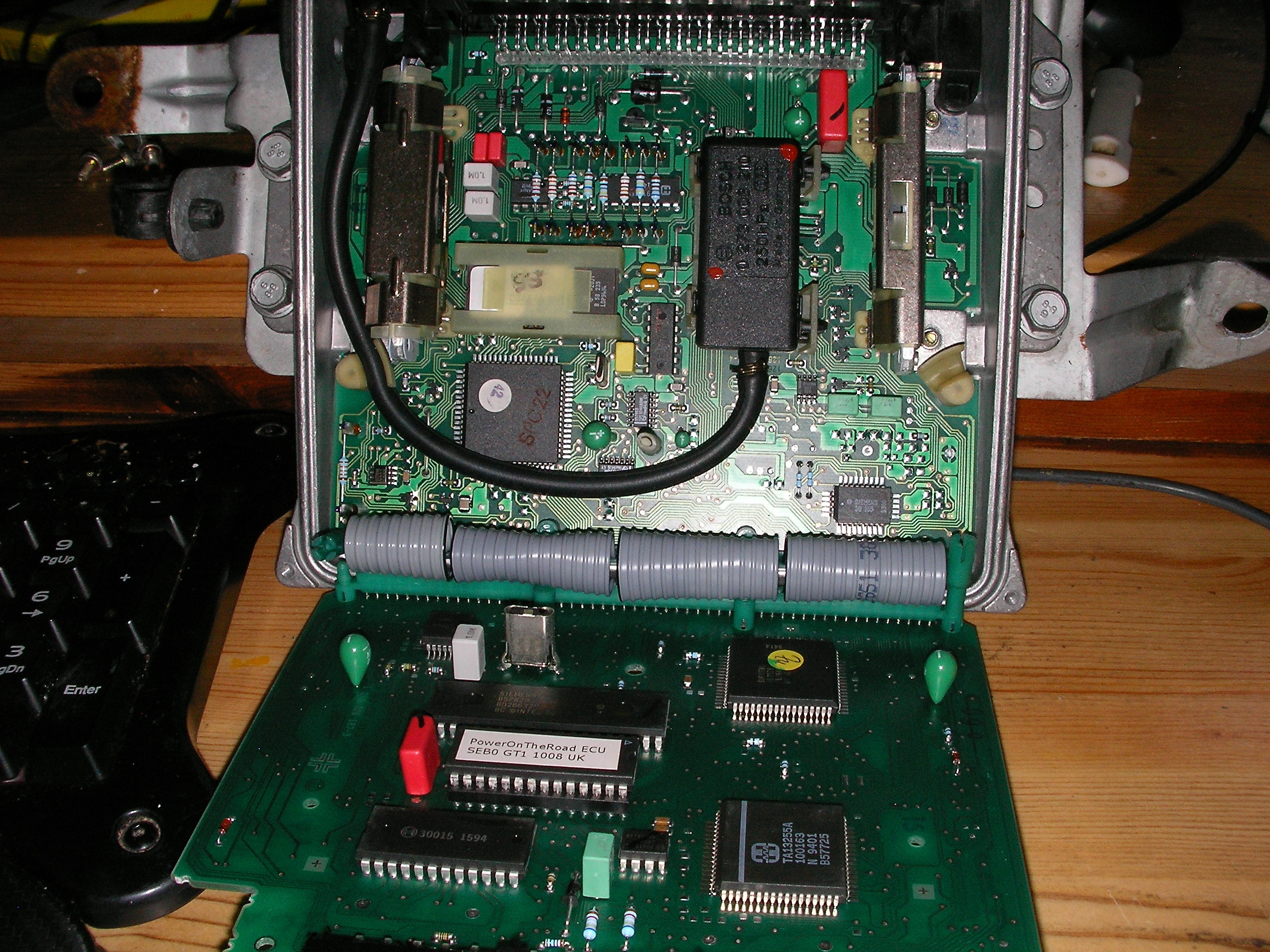

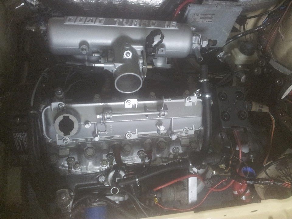

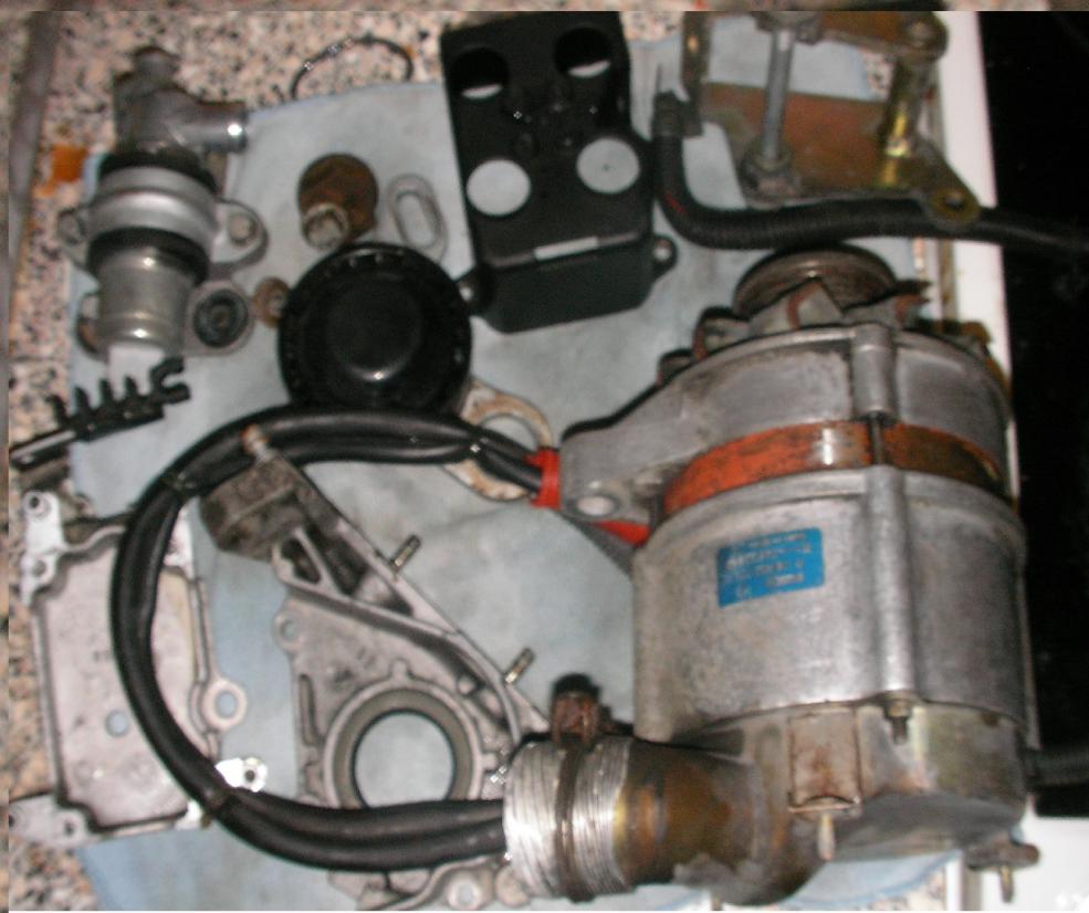

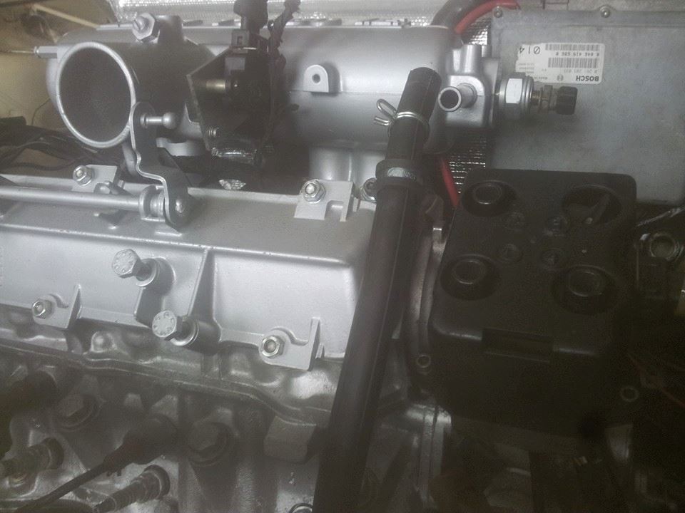

i am now converting it to run on Punto gt management for better running, so these bits were removed
and then these bits purchased the seb0 chip is a copy but will be fine for my little standard engine

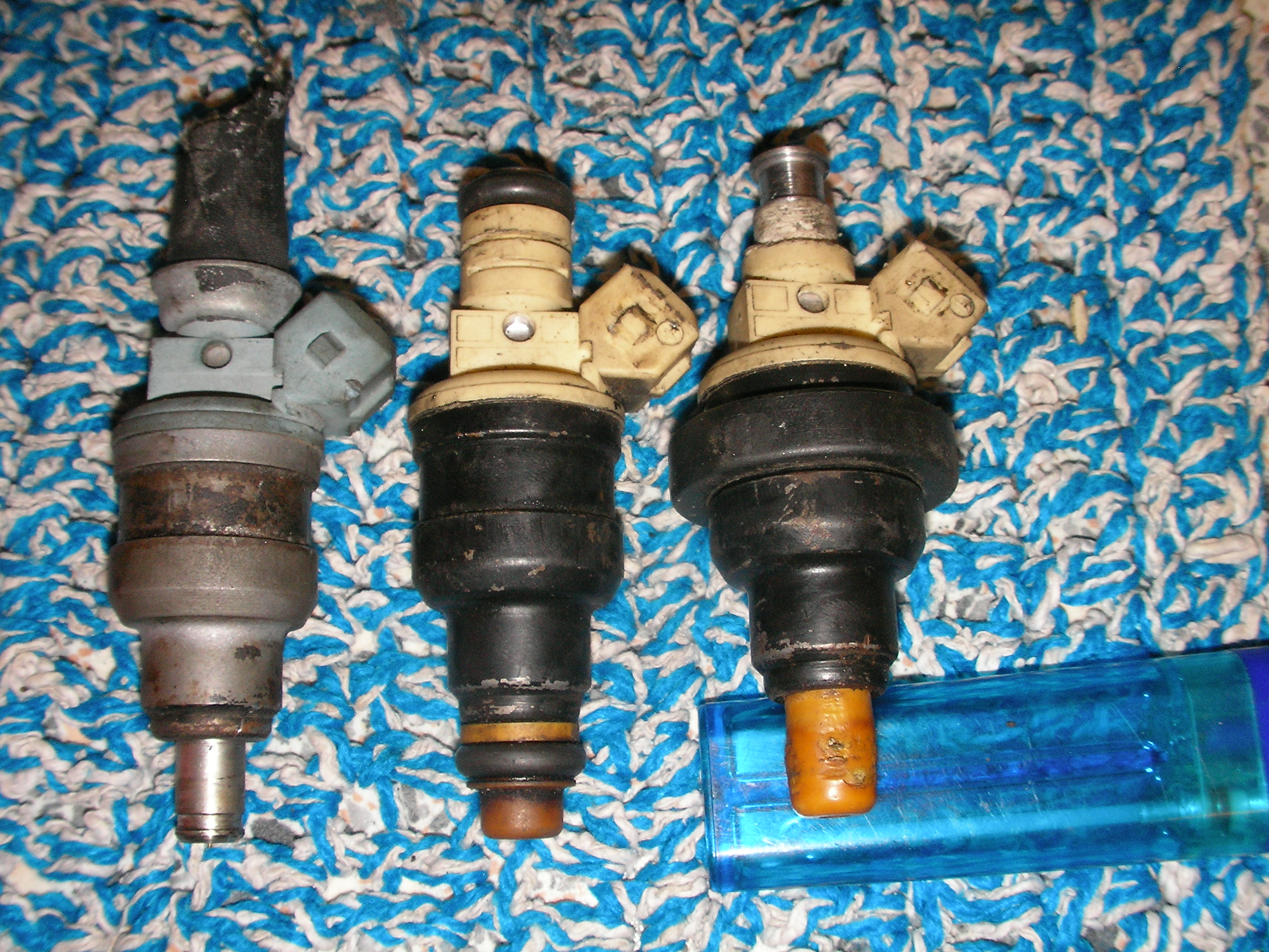

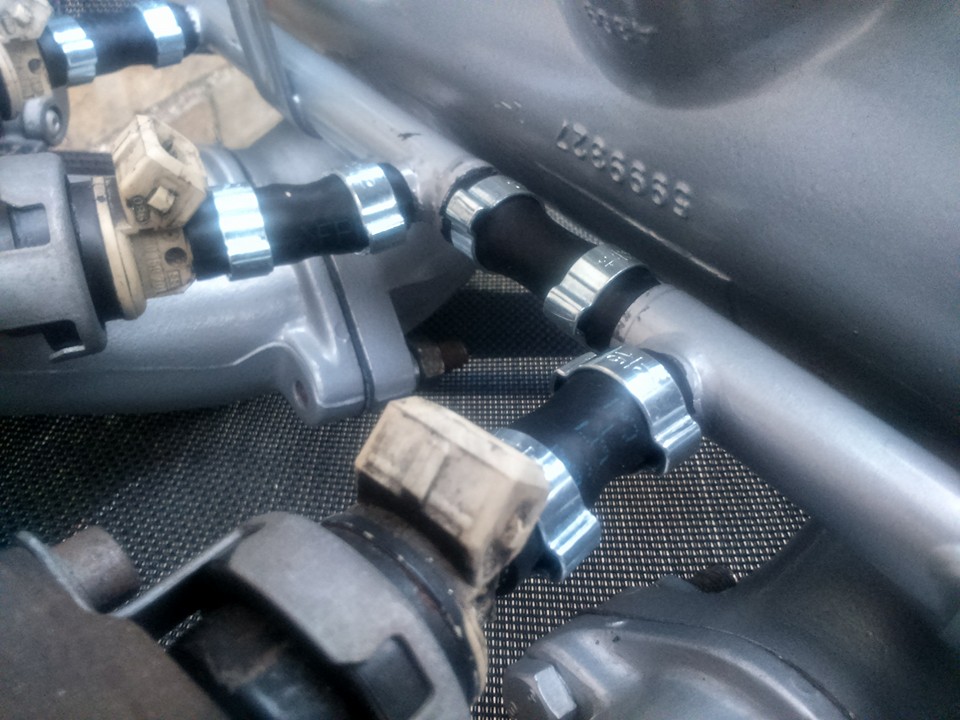

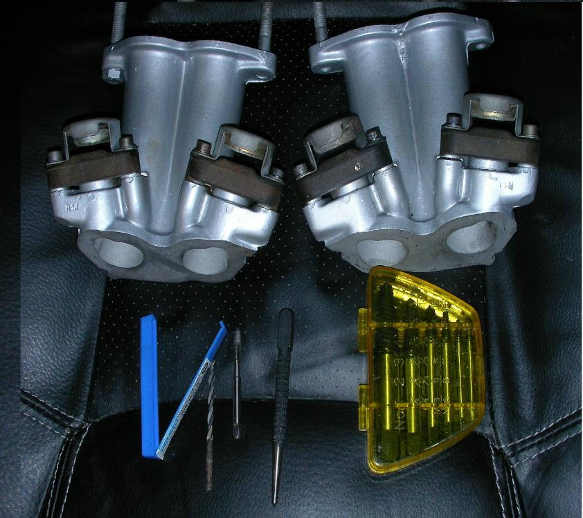

also got punto gt injectors as there a big bigger, so got uno turbo pintle caps and seals and modified the injectors to fit the uno rail which is pipes rather than a clip on rail here also a video of how i done it
