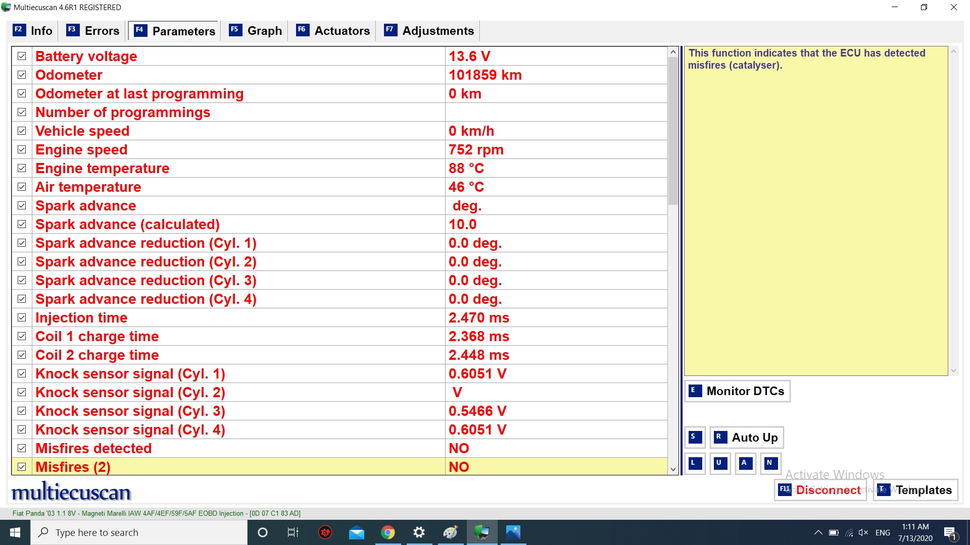

Hey guys thanks for your suggestions and your will to help me. Now, I made 3 screenshots from MES registered version.
Spark advance is constant, it shows 10.4 degrees all the time.
Spark advance reduction shows 0 all the time, not sure why.
Injection time is constant, around 2.470 all the time.
Coil 1 and 2 charge time is also constant.
Knock sensor signal is 0.5-0.6 to all 4 Cylinders.
RPM is stable, 750 - it doesn't fluctuate.
You can see other parameters too and tell me if anything is wrong or unusual.

Everything seems normal there.
