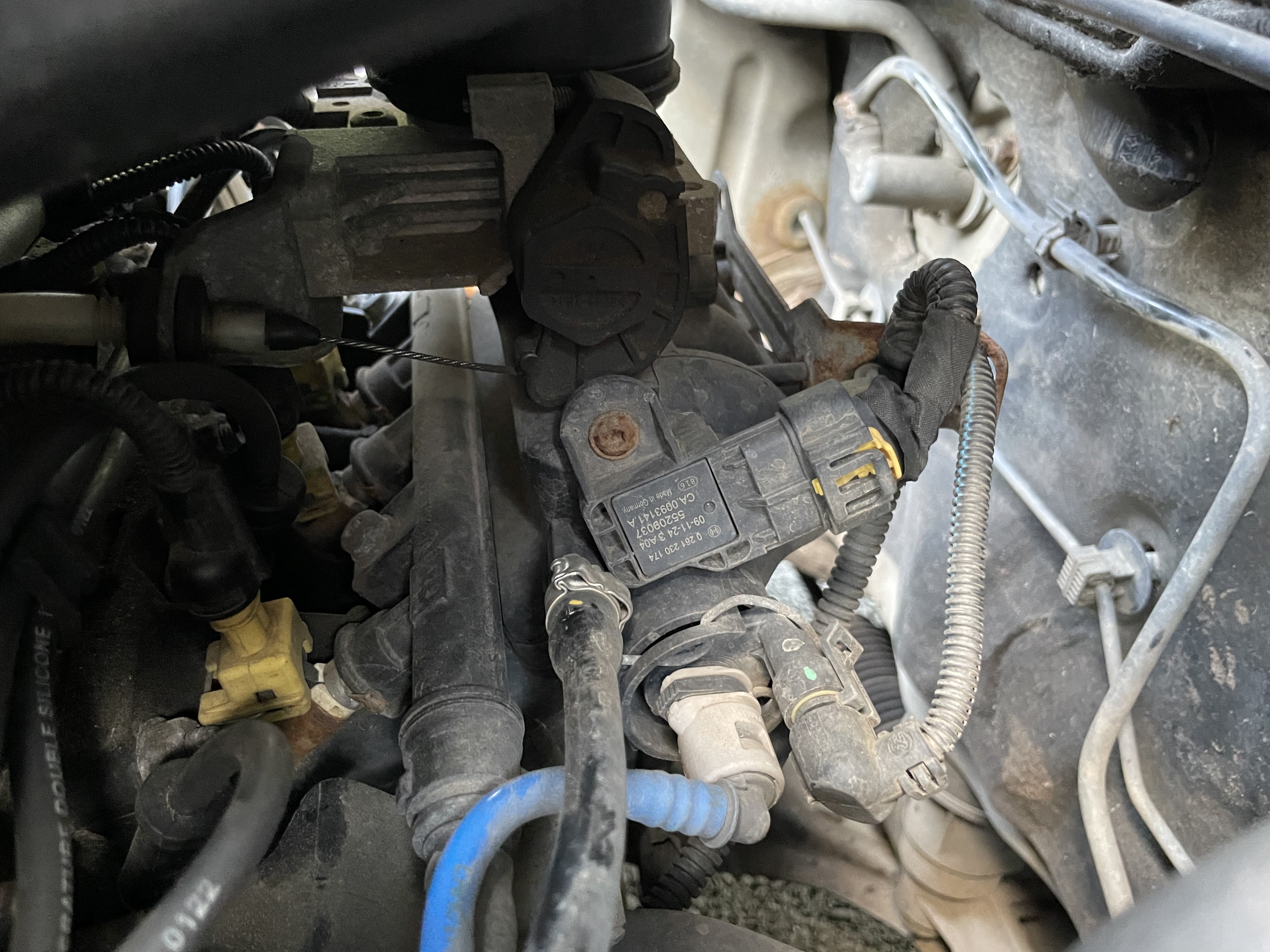

Take the MAP sensor out and look if it's covered in a white oil emulsion
It's on the side of the black air intake, held in by one torx, you can leave the electrical wire connected normally

Good suggestion koalar. About a year, possibly slightly longer, after Becky joined the "family fleet" and after I'd done all the outstanding stuff I considered important - new cam belt kit, full service, new front shockers and top mounts and a few other things I decided to clean her Map sensor. She was, I thought, running quite well before although I did feel that she "held back" a bit on large throttle openings. The sensor is very easy to remove, just one screw holds it in, and when I pulled it out the end was absolutely drenched in engine oil, but no Mayo. I cleaned it with sensor cleaner - brake cleaner works just as well I'm told - and the difference was quite noticeable. She was considerably more "eager" and pulled more strongly. I now clean the sensor every year as part of the service procedure.

Just checking, are we talking about this here?

No, not wd40 it will leave a wax deposit
Brake cleaner
Carb cleaner
Meths
Hold it downwards and flood it
The circuit board end isn't sealed I believe
Just to get it working you can probably get away with soaking it up with some toilet tissue
Poke a rag down the hole is the manifold full of oil?
