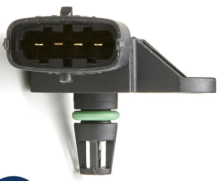

Lots of questions, just so I’m clear here, am I cleaning the part that I pulled out and spraying the connector cleaner on, or should I be spraying something down the hole?
Hold it this way up and spray the cage at bottom, below the green o ring
Push a rag through the hole it came out of and make sure it's not full of oil, otherwise the fix will only last a day or so before you are back to square one

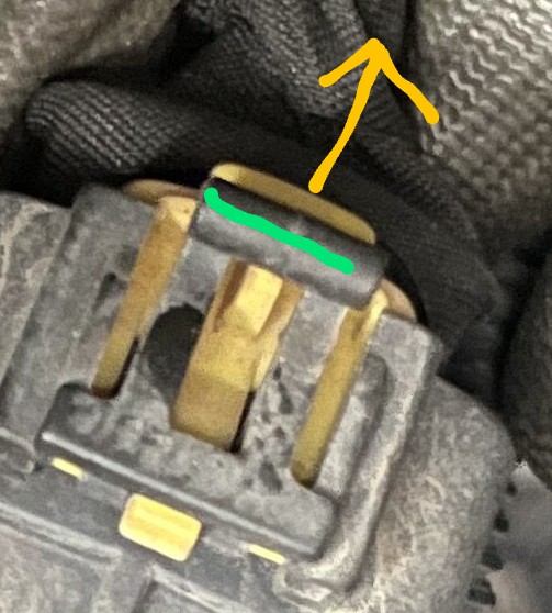

I’m going to sound more dense, but how do I disconnect from the actual cable? I can’t seem to remove it from the yellow clip.

I usually leave it connected, the less you touch the less to go wrong
But
Move the yellow clip up, carefully they can snap if you are rough, but no big deal
Push down on the green while pulling the two parts spart

Gotcha. Just realised looking at your picture again you don’t have to remove the cable. I thought it had to be disconnected.

Not sure if koalar has mentioned this? but don't go poking anything physically around the tip of the sensor, just give it a good spraying with the cleaner. Physically "assaulting" it with a bit of rag or anything else may end in tears as it's quite delicate. By the way mine looks a little different to the illustration above in that it's not a "cage" but more like a small tube with a hole in the end. Same principle for cleaning though, just give it a good spray. Oh, and let it dry out properly before refitting - which doesn't take long as the fluid is very volatile. As koalar says, the hole in the manifold needs a good clean too just to delay when enough oily deposits build up again. Mine seems to be fine getting cleaned once a year.
