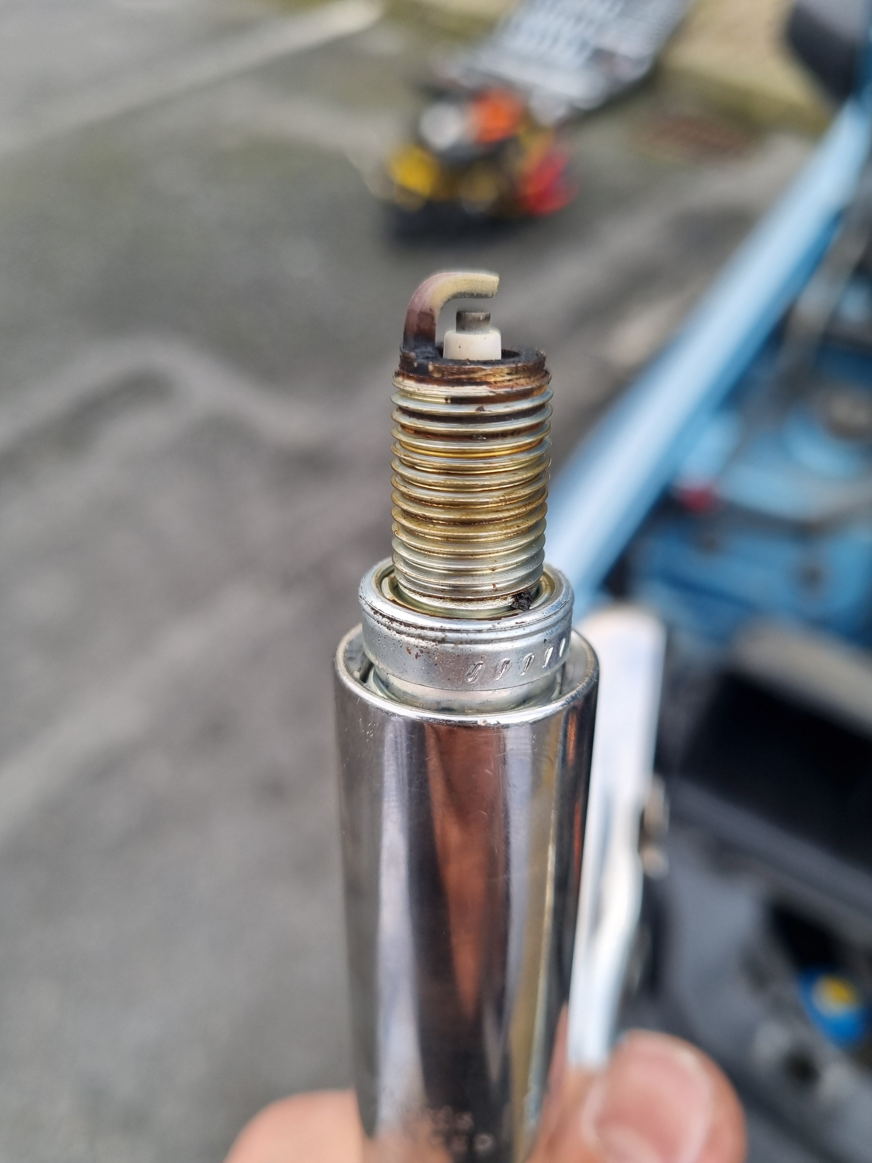

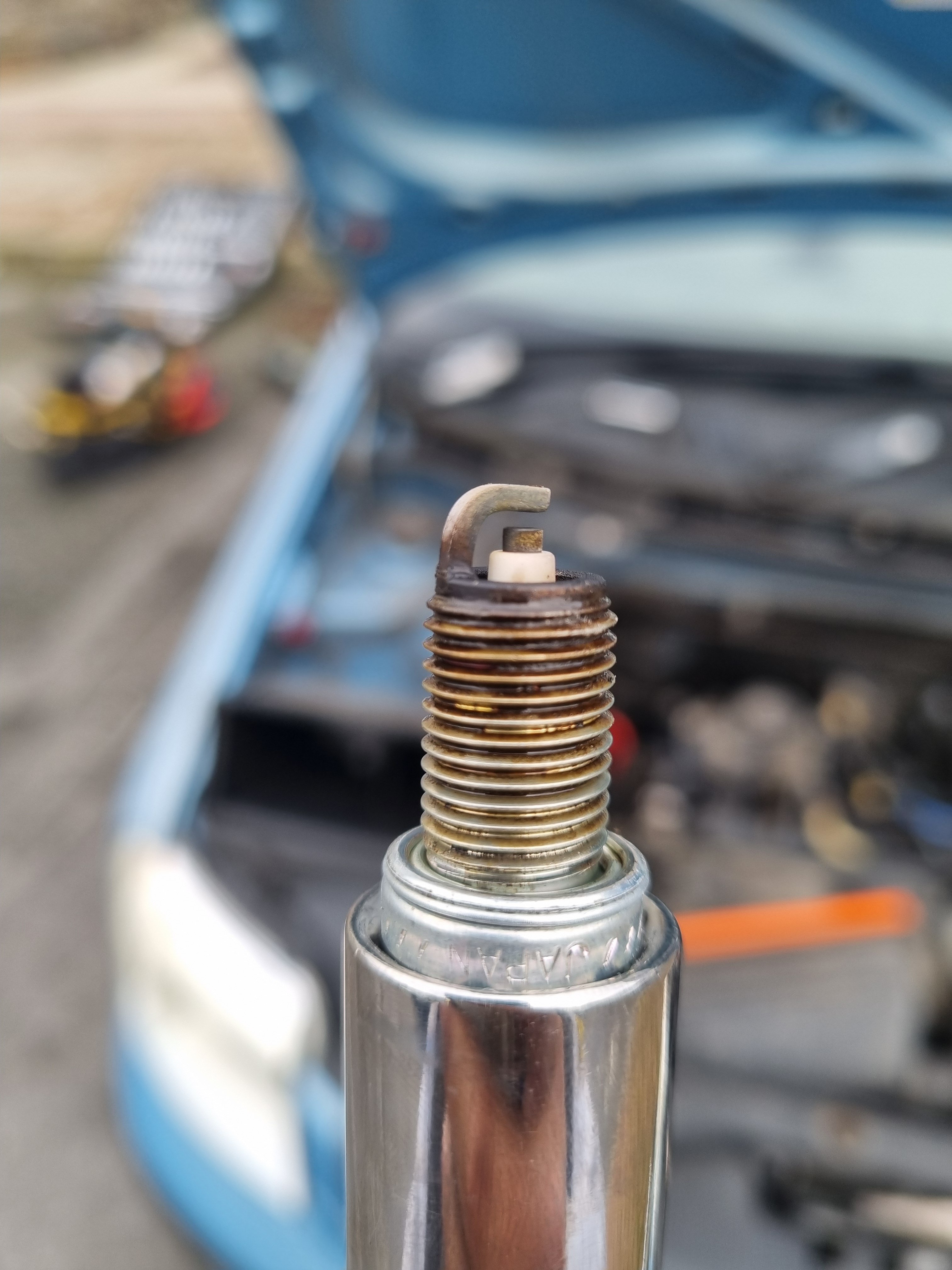

I have removed and inspected the spark plugs and found no issues with them (attached pictures of them). They were replaced less then 5,000km ago, so were the coil cables and the coils (minus the one I just replaced)

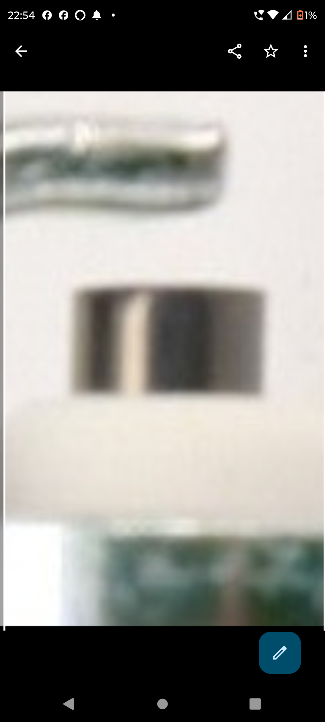

A quick comparisons, the plugs don't appear too wide not exactly scientific
New plug
Yours
A measure would be better though
They should start at .8-1 mm depends on make and start to fail at at 1.6-1.8 mm

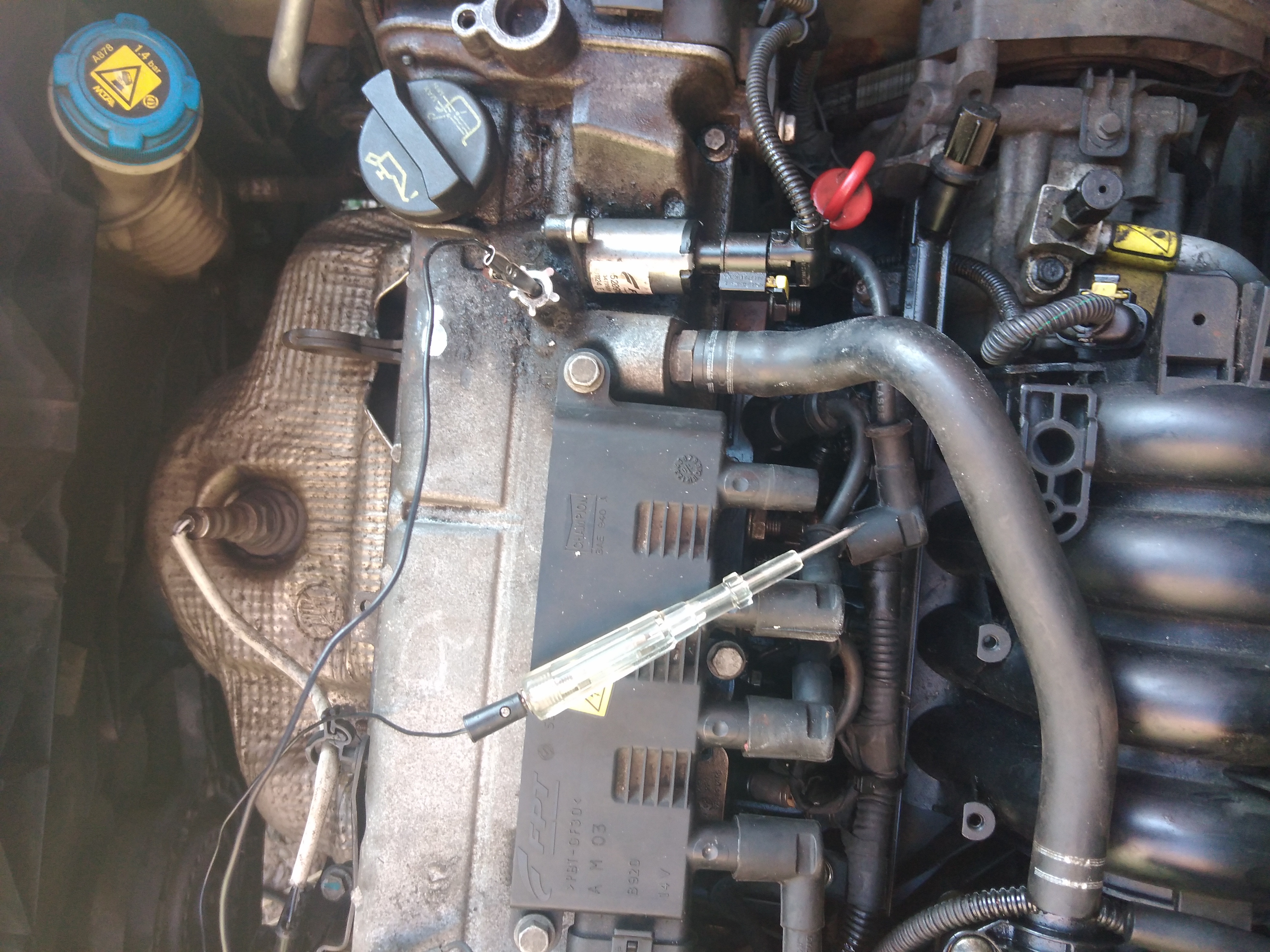

Check all the cylinders are firing, yours will be slightly different as the coils are on the right not under the air box
If they are not check you have a strong spark at each
Make sure the spark has an easier path to ground than through you, then you will not get zapped

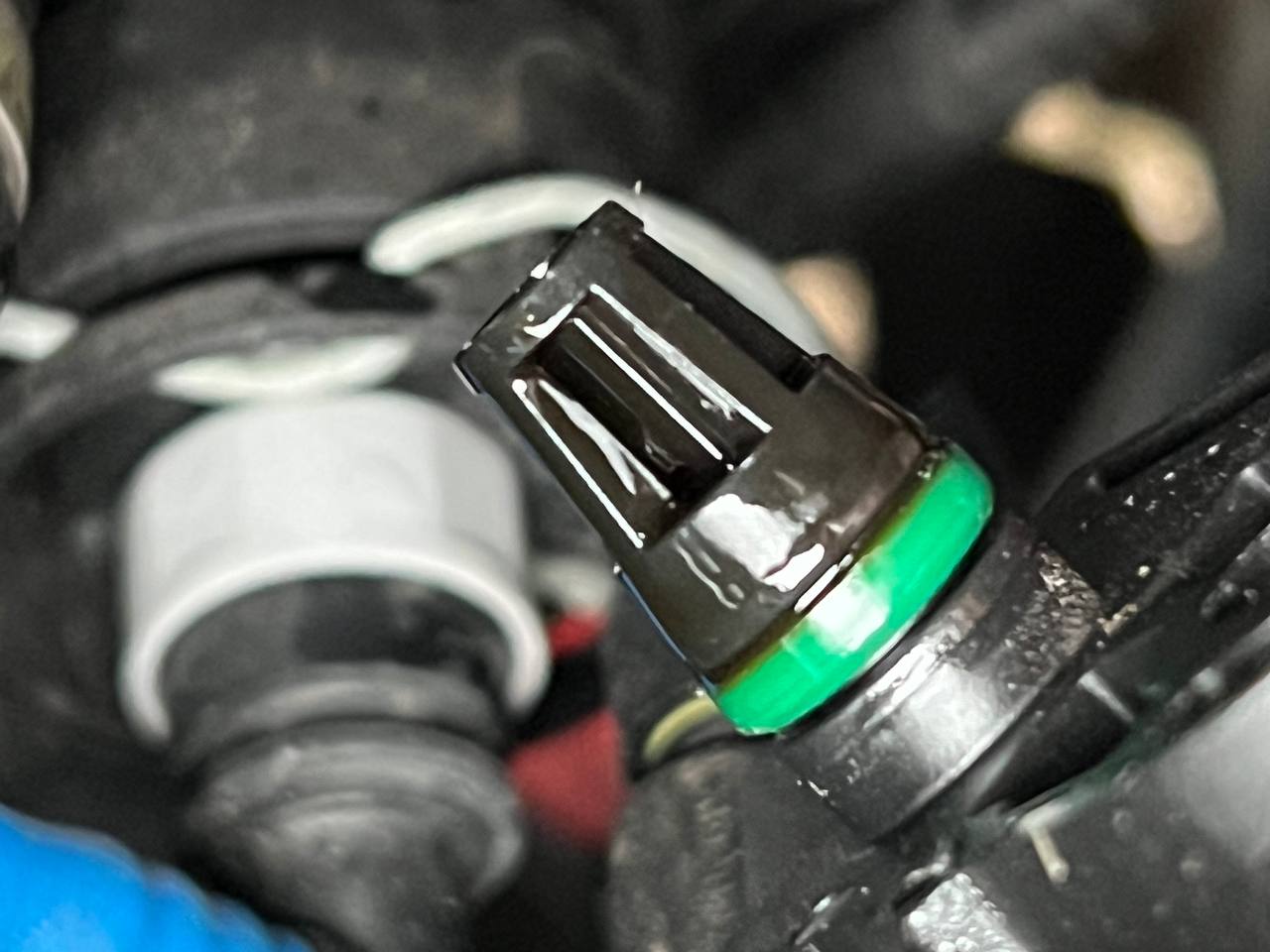

What's the MAP sensor looking like, it's not covered in oil
Like this one someone posted earlier
New plug
Yours
