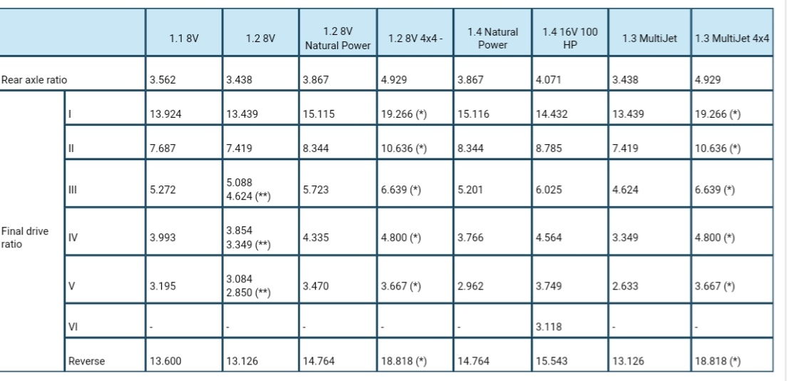

I payed £60 for a gearbox a couple of years ago, my car was a 1.2 and used a 1.2 from a 500 as the ratios are identical, not sure if the 1.1 is the same
Having driven them back to back when the cars were new, I'm 99% sure the ratios are different.
It's also possible that the ratios may be different in the eco models (from around 2009 until end of the 1.1 production run).
As has been said, if it's just the input shaft bearing & oil seal that's gone, I'd suggest repairing the existing gearbox is probably a better and cheaper option.
Here you go
The eco is marked with an *
The 1.1 is different, and will be very hard to get hold of, far fewer on the road
Putting a 1.2 will probably work, but far from ideal you will probably be driving more in 3rd than fourth around town?
Punto gearboxes are completely different ratios, they have tailer wheels, it will reving it's little head of at 50 mph in 5th
The panda 1.2 and 500 1.2 are identical
A 500 1.2 works fine in a panda 1.2 eco as test by me, but obviously you loose the eco part
I does not appear as if fiat altered the ratios between the 1.1 and 1.1 eco
