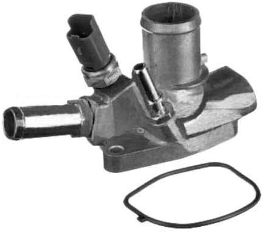

I don't know what engine you have but for the 1.2
Pre 2009 its
And for Post 2009 its combined with the temperature sensor
Which I guess is the one on yours
It's easy to check as it visible on the right side of the cylinder head

There are two thermostats which Koalar has very conveniently identified for you above. They are not interchangeable so have a good look at what's on yours and make sure the new one matches. The later one has the temp sensor and heater takeoff pipe whereas the earlier one - our 2010 1.2 Panda eco dynamic has the earlier one - changed around 2011? By the way notice the particular one Koalar has shown in his post shows it with a metal heater pipe stub - this is the one to source if you need that type. They seem to be more common supplied with a plastic pipe stub which is prone to fracturing as it ages.
I buy stuff from SRS all the time, they are my primary "go to". Never had a bad part from them and only very occasionally had a part wrongly identified.

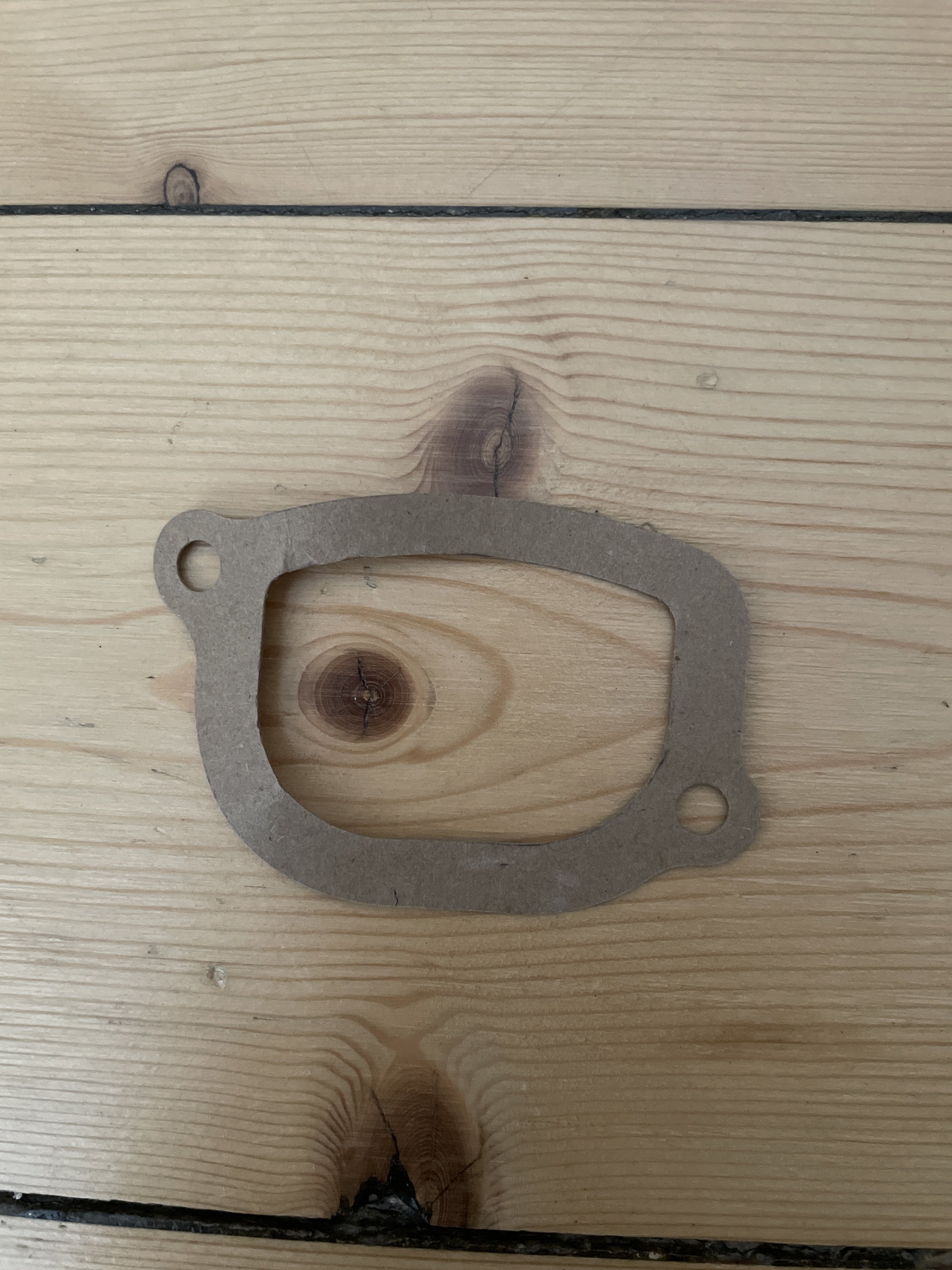

This may seem like a dumb question, but is this all the gasket should be? Just a bit of cardboard as a buffer between the metal of the thermostat and the car?
Yes, old school, most gaskets use to be like this
The original was steel
But the cheaper paper gaskets are fine
You have to clean all the old of, not easy to see
I put them on dry, never had a problem, others use a little RTV for belt and braces approach, there's no correct answer

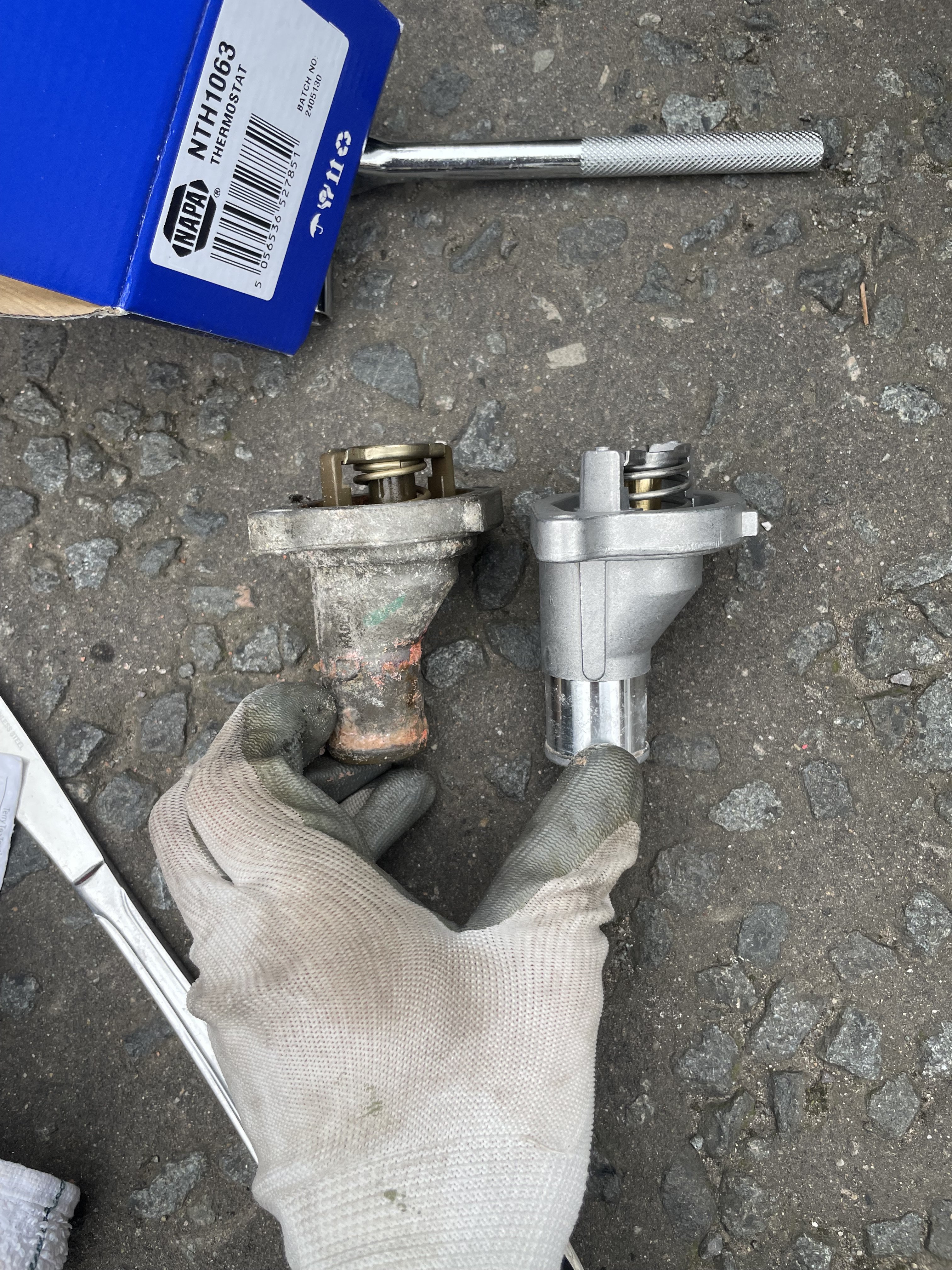

Following along with Jock’s guide here.
I had to remove the ECU to get that pesky bolt, but we got there! I’ve removed the ignition leads from the coil pack, though I can’t get the plugs out. Do I have to pull the retaining clip back? A bit wary of doing it and breaking them.
EDIT: All good and sorted. Got the plugs out 😀
And all done. Quick and easy with the help of Jock’s guide and a couple of other posts.
