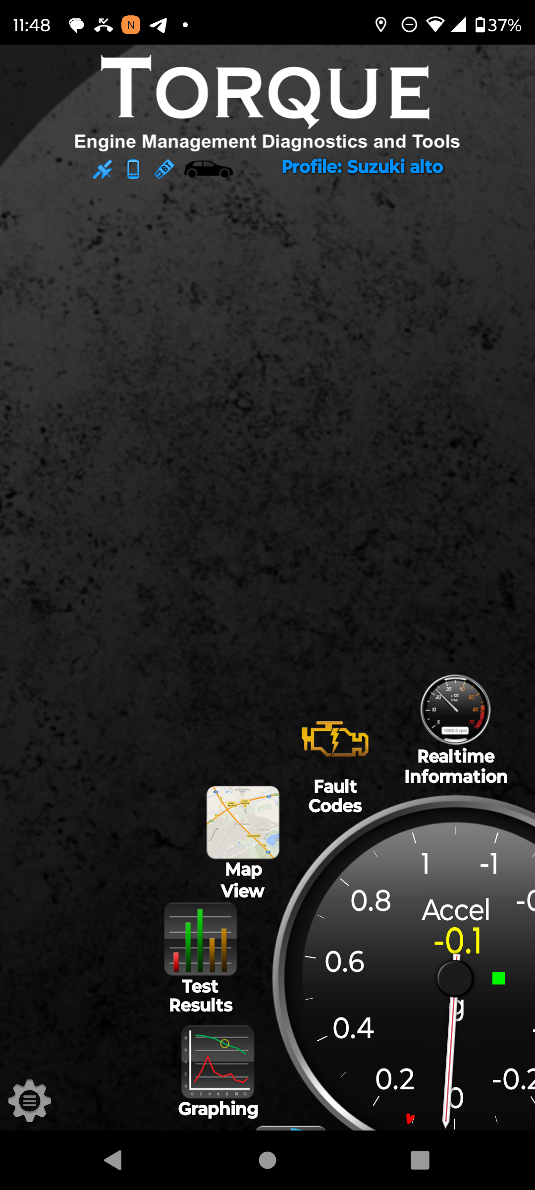

I've bought the Torque app but when I scroll through parameters to record it looks like the vast majority are not available.

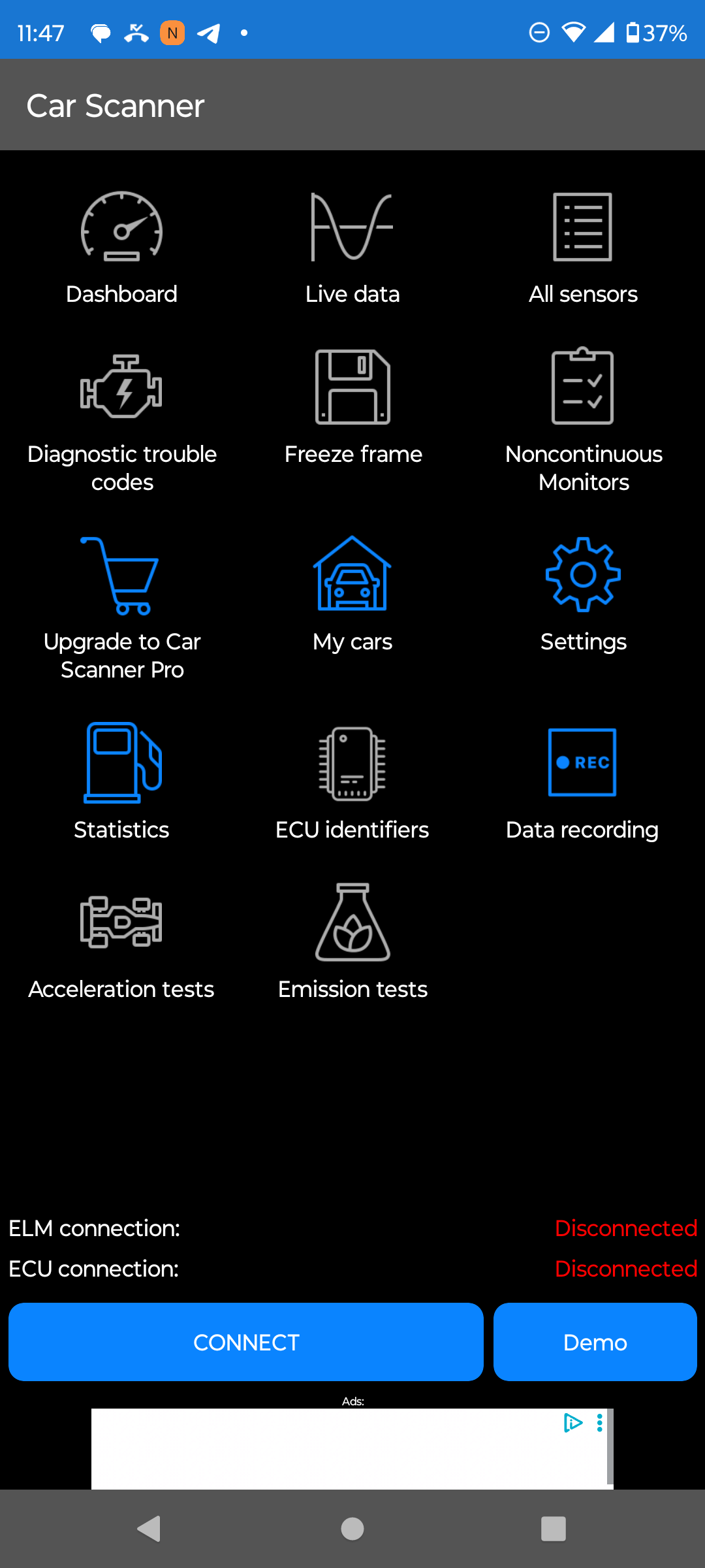

Looking at the Car Scanner app which seems to have a much better way of recording and then displaying the results that Torque.
With regards initial setup the Panda isn't listed. It says "select basic OBD-II / EOBD which shows only basic OBD-II sensors if your car isn't listed" will this display enough information?.

I use both, both are fine on my phone, although on a petrol panda

Downloaded and attempted recording with the Car Scanner app. Display of fuel pressure and rpm doesn't seem to start until engine running so not much use! Looked through the app guides online but not found anything obvious to help - any ideas?

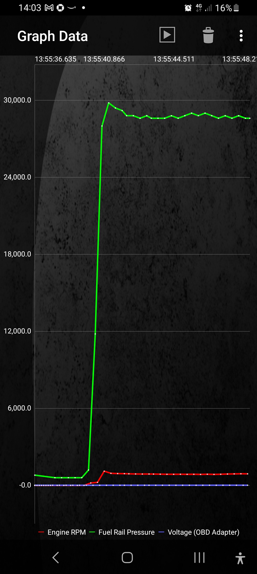

Car scanner and torque both record data from ignition on my petrol panda
Here's an example of mine
Ignition on, cranking and idling
Car scanner
Around 5 samples per second isn't great but adequate for most faults to show

Unfortunately I have yet to actually record the thing misbehaving. I thought Car Scanner was all primed and doing it's stuff until I actually looked at the recording - it would have been the ideal occasion as it took a good few seconds to go and has a little half-hearted attemp to start in the middle too - just like on that youtube video. Next restart it went straight away, and the one after that. I've seen no issues with pump pressure, pretty much straight up - unless there's an issue with Intermittent pressure regulation, I can't see it being the hp pump. Cranking speed always sounds about the same but sometimes it fires up straight away, sometimes not 🙄
