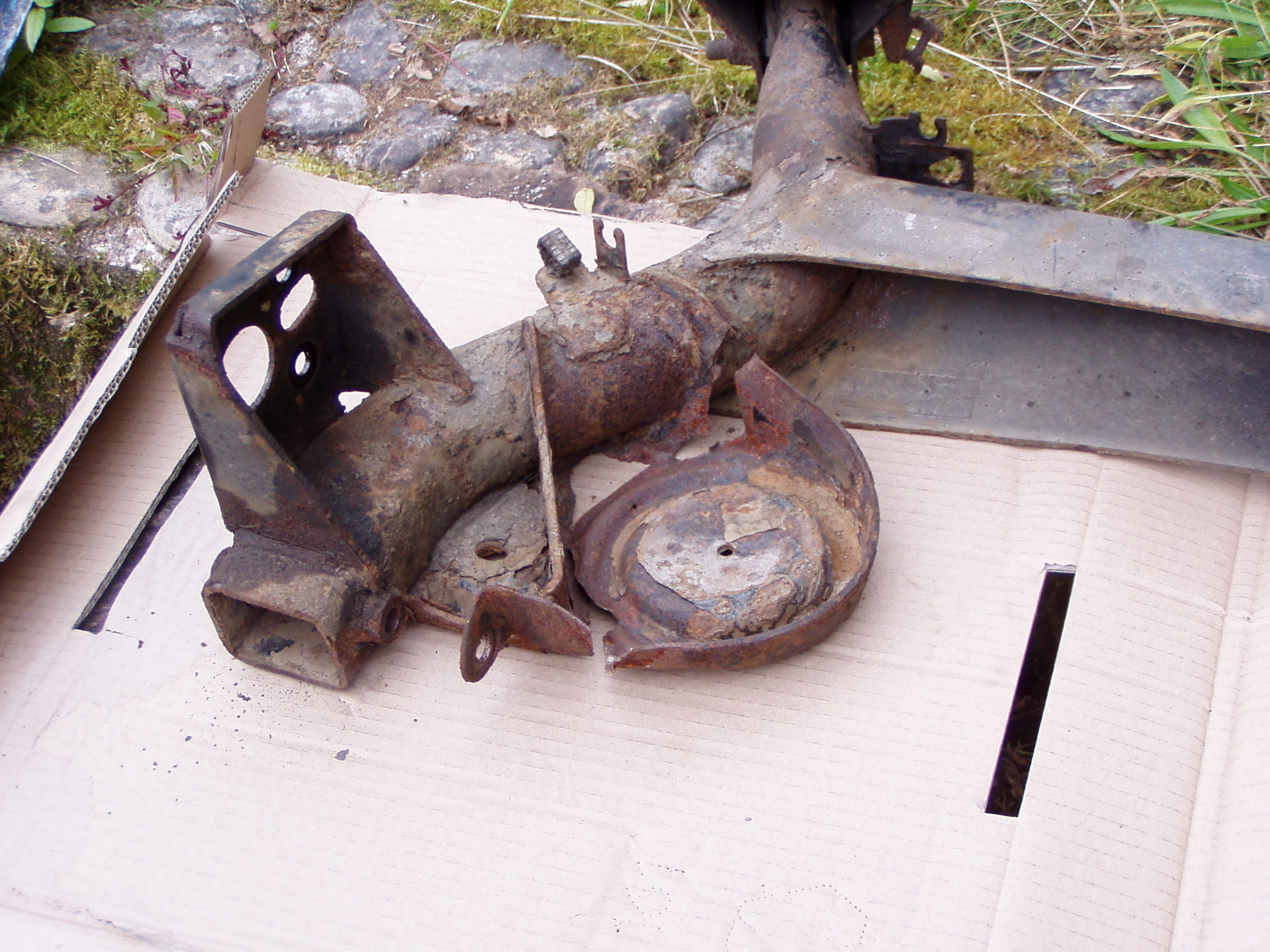

The rear axle is less daunting that it looks.
When I did mine, the only issue was the bolts holding the hub to the axle, these are tight, and the nuts rust on. Most of the studs came out with the nut, although one stud refused to come out, but the nut did come off instead. Apart from that one, I replaced all the others with new studs and nuts. An impact driver, if able to get it in there, would be a bonus. Studs and nuts were supplied by Shop4Parts.
It is possible to detach the brake backplates, and hang them up, to avoid brake bleeding, but I removed mine, taking the opportunity to overhaul the brakes at the same time, new cylinders, pipes and hoses.
Jack the back end up, support ahead of the axle pivots on stands. Support the axle and remove the dampers, and the axle will drop to the ground. At that point you can remove the hubs, to reduce the weight of it. Once bare, remove the pivot brackets and drop it to the floor.

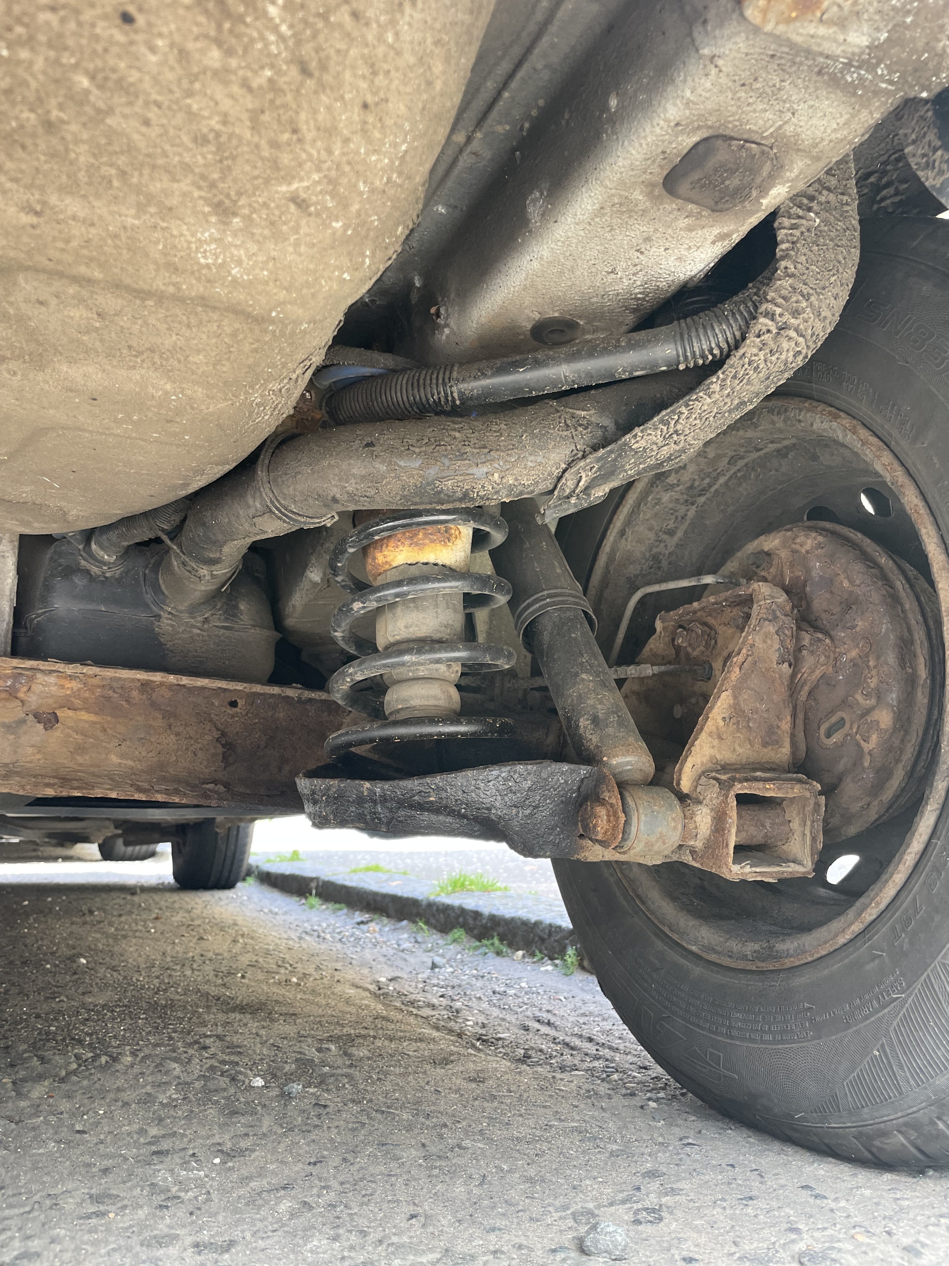

Post a picture of the axle, from the passenger side rear wheel
There we go. A picture of both sides.

If I were you I'd get under there with a wire brush and also a hammer/chisel and see if the rust is as bad as it looks. It might just look bad but be solid underneath.
If its as bad as it looks and you can't fix it yourself then you'll have to spend half the value of the car to have someone else repair it...and should just sell.
First picture doesn't look right
Looks like it's been patched previously badly
And weak near the shock mount
Needs someone else to look at it I get confused looks at photos, it's much easier when your under the car and got your orientation
Going out now, I look at some photos when I get back if nobody chimes in first
Aye, that’s what the mechanic told me. It’s definitely been patched at some point, something I didn’t notice when I purchased it.
I’m taking it in next week the Bonnington so we’ll see what the options are and, if necessary, it’ll be a sell job.
If that has been patched, and it looks like it has, it needs a new axle, soon.
I just magnified that first picture and it's pretty clear that it's a patch
Looks like a big crack running vertically just inboard of the bottom shocker bolt on the right hand side too?
Difficult to recommend anything other than replacing the axle.
