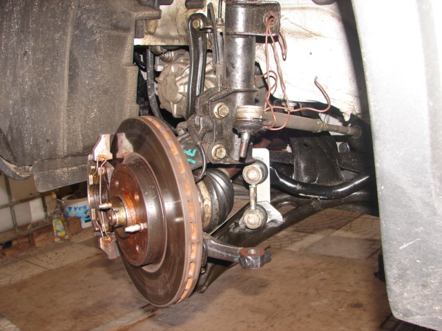

Glad to hear that you are a fairly competent mechanic . The top strut mount on my 2021 Panda has a 2mm wide gap which I drowned in squirty can chain lube Then wrapped it in a few layers of cling film . The anti roll bar bushes are not replaceable on my Panda one has to cough up €350 euros for a complete roll bar with moulded on bushes . I grease all of the ball joints using an hypodermic needle obtained from the local agricultural supplier to inject a few pumps of grease through the rubber gaiter .. Wiggle the joint after greasing . disconnect the steering ball joint to allow for a good wiggle of the struts . The anti roll bar drop link ball joints are a must for greasing they get quite a hammering . As far as the top nut torque / tightness is concerned I put a 10 inch long bit of tube on the allen key and give the nut a good tighten not enough to break the 6mm allen key . My Panda Hybrid 2021 strut top bearing is almost three times the dia of a friends Lancia Musa strut / fiat panda . Have fun .. Richard in Alvito Portugal .

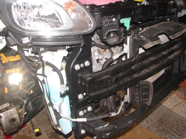

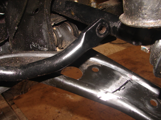

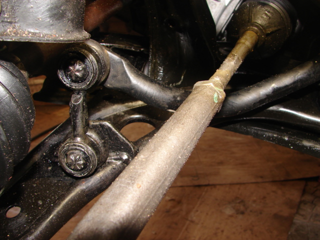

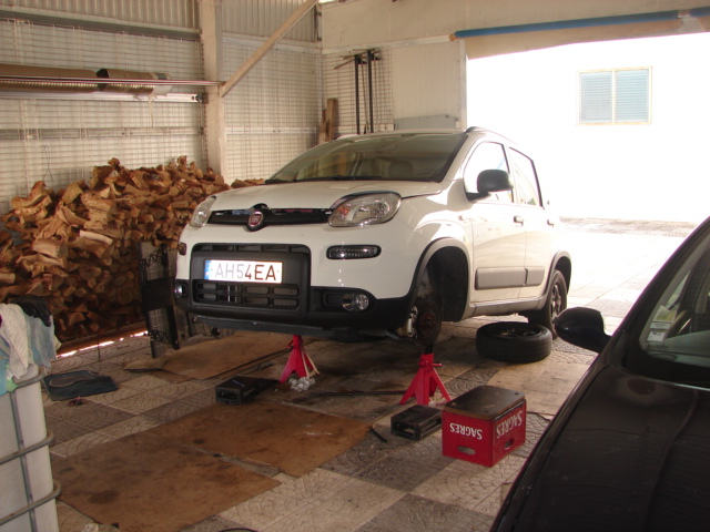

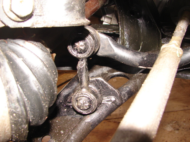

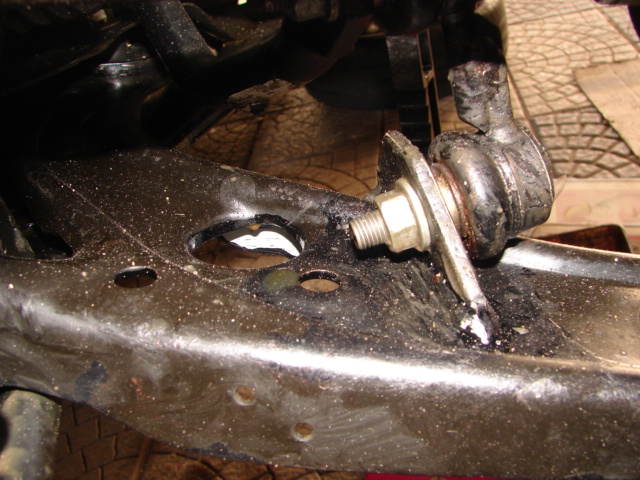

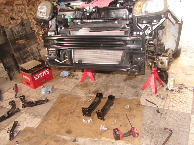

All of you guys are obviously not technical . the twangy centering steering is caused by the anti roll bar drop link loads being fed into the Macpherson strut which is a A STEERING COMPONENT. Check out the photos I shortened the drop links and welded a lug onto the lower wishbone to take the anti roll bar forces . the added bonus is a more positive turn in to traffic islands when pressing on .The welded on lug is 5mm thick steel plate double welded . As you can see the whole front has to be removed to gain access to the front lower wishbone bolt . Quite an easy job . under 1/2 hour . increasing the caster angle may make the steering even nicer .. I have yet to check the factory caster settings. for more info and measurements email me [email protected].
Your more adventurous than me. I am sure what you have done will improve matters as its not a very fine solution bolting the link to the strut. The problems I have have slowly crept up and the car was acceptable in original state. Im not a confident welder or I might follow suit. Im also a scaredy cat re insurance and expect they might want the mod certificating even though it looks right enough as per you pictures
Obviously not
Thanks for the photos, great job.
This is not a modification I would consider, as I said earlier this needs to go in the post 2012 section
Here’s how I see it
the arms on these cars are cast iron. It’s not easy to weld to properly. It also needs to be heated before welding and heat treated after. Finding anyone capable of doing it properly would be difficult and expensive
Moving the mount along the arm gives it a mechanical advantage. I haven’t done any calculations but just eyeballing it look to reduce the amount of force by around 50%. In these cars with no rear anti roll bar it’s going effect body roll and weight transfer
It would not be legal to drive in the UK without informing your insurance company and they would want at least another 25%
If you think the ARB is causing a steering problem you could just disconnect one end of the drop link and test on a private road before committing time and effort
Of cause I could be wrong.

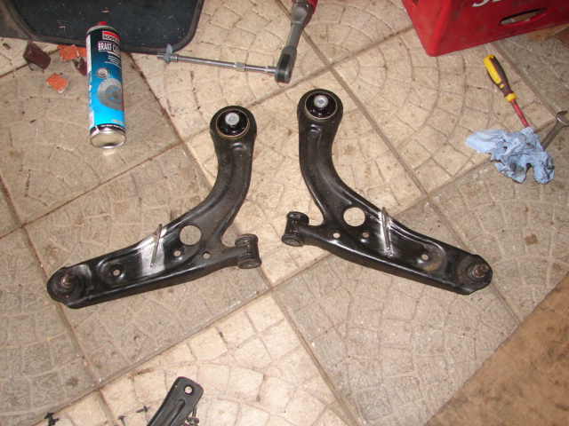

Well guys you are all barking up the wrong tree. Relocate the anti roll bar link DOWN onto the lower suspension control arm . I have just road tested my weird fidgety 2021 Panda Hybrid . the steering issues are GONE and my 2021 16,000miles Panda Hybrid is now behaving itself . The anti roll bar loads feeding onto the Macpherson strut is what is causing the Dreaded Fiat Panda Macpherson strut shuffle . The Renault Twingo rear engined car has the same suicidal anti roll bar inputs onto the Macpherson struts . Because the Twingo is the rear engined one the light front end ducks and dives all over the place .easily twice as noticeable as the dreaded .Panda shuffle . [email protected]
The bottom arms on later model Panda looks like welded pressed steel and the strut bracket is at the back.the 169 has the bracket at the front of the strut at similar height. Welding the later style bottom arms in a professional way is unlikely to raise any eyebrows. However the Panda 169 has cast iron bottom arms. Welding these will absolutely end in tears even though it's a better geometry option.

What are your maths for the old and new mounting points. I did a little model of my panda on a set of balance scales. ARB on a strut exerted 12oz moving it to the lower arm exerted 4oz

Not sure I would be comfortable putting heat into it or adding a bending load to the centre of it
Welding looks off to me both sides should melt together not a bead run across the top. Although at low loads it will probably do
I know I sound negative. I don’t mean to be. It’s up to you what you do to you car as long as it’s legal in you country.
The cast control arms used on older Panda (and maybe 500) will exert a lot of crash force into the subframe and then into the body shell. Until they break - suddenly. That will be a a brittle fracture thats impossible to define probably allowing the wheel to cause more damage to the body shell.
Going to a tubular steel bottom arm allows more defined bending to happen. Presumably causing less body shell damage and less impact on front seat people.
hello Koaler .. as you may have already guessed I am not up to speed on the computer side of things .. your info is amazing .. not a clue where to obtain such detailed info .the 5mm thick attachment lug was veed , out both sides and filled with mig . then given a good coating of self etch primer and synthetic Corostop black . I do my own aligning and was suitably impressed with the alignment on a Hunter platform . mostly my Hands on wire parallelogram and caster / camber gauge settings were within a few minutes . I am sorry for posting my adventures in the wrong section . Mainly because I am a thicko when it comes to computer functions . My Panda hybrid is now a delight to own and drive . No more dodgy self steering .Please do not shout at me I am only trying to be of assistance with what seems to be a well known weird steering issue .with the Fiat panda,s . for everyone's info please check out the HUNTER alignment printout .attached . The lack of caster probably is intentional to soften the front suspensions reaction to bumpy roads . unfortunately the Fiat designers have shot themselves in the foot because the lack of straight line caster stability is easily overcome by the anti roll bar inputs . The NEW Panda,s anti roll bar has moulden on integral rubber support bushes and they are not replaceable .. It looks like the bar and bushes come as one unit and the subframe needs to be lowered to carry out any servicing / replacement .€350 euros instead of €12 euros for the older Panda arb bushes . The rear axle beam was mounted centrally on the body but had quite an offset / crabbing . there was enough clearance on the mounting holes to correct the offset and I balanced the 3mm of toe in using stainless steel shims cut from my 2 metre rotor r/c model gas turbine combustion chamber left over materials . wet gas start for the camera .0.3 mm stainless steel tubing fabrication materials supplied by Harald Zimmerman in Hilla / Bielefeld his son Tobias has taken over his fathers running of their silencer manufacturing business . germany .
