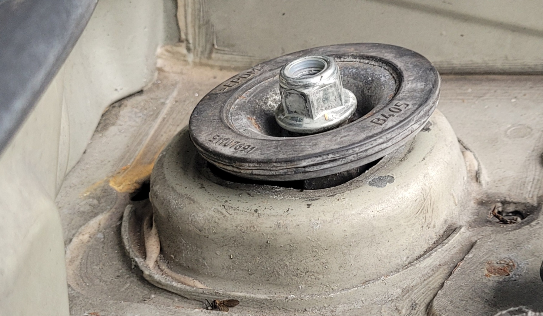

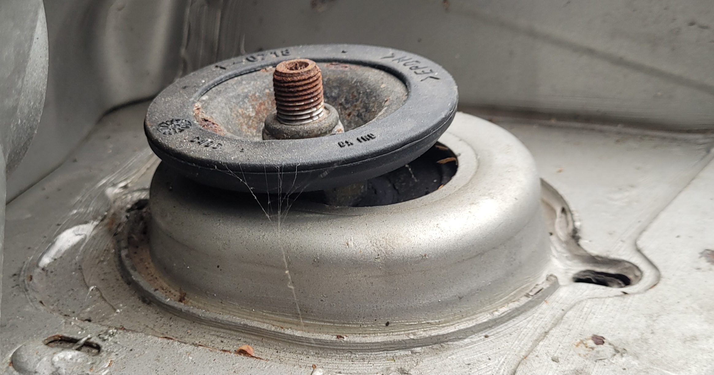

I have a 2011 69BHP VVT Panda for my son to learn to drive.
While it is ok, the steering doesn't centre and return great and bumps affect the steering more than I would expect.
Moving on, I picked up a low mileage 2004 Panda for spares and compared the strut tops.
Image on the left, with the spare nut on top (ignore that, it's just so I don't loose it) is the 2011 car and the strut top bearing part is aligned towards the front.
Middle picture is from the 2004 spare car (which I'm assuming is original) and the strut top is aligned towards the rear of the car.
So, I would expect the spare 2004 car to have more Caster.
Looking at the alignment I got done to sort the tracking on the 2011 car, Caster is red and about 0o, when it should be +2.5o - assuming +ve is towards the back of the car.
I'm hoping that when I change the struts with new tops and twist towards the rear that it will give me some Caster and a nicer drive.
Worth checking, if your car is not driving the way you think it should.
Me changing the struts won't be soon, but will get back here when it's done and let you know if there is an improvement.
Dave

My 2004 1200 8 valve both are the same as pic 2 Even when I changed the bump stop and the top mount on the N/S. You don't say if both sides are the same. If any work has been carried prior to you buying the car, the top mounts may have been fitted the wrong way round, search on here for info.
However, my knowledge is limited to my model only and the later model that you have pic 1 could be correct.
Correct
Depends how you pull up, reverse in, forwards, whether it's on a slope, how hard you brake and so on
Top mount do wear, and it's not unknown for someone to fit them backwards
But it's also not unusual for one side to be different to the other and usually nothing to be alarmed about
