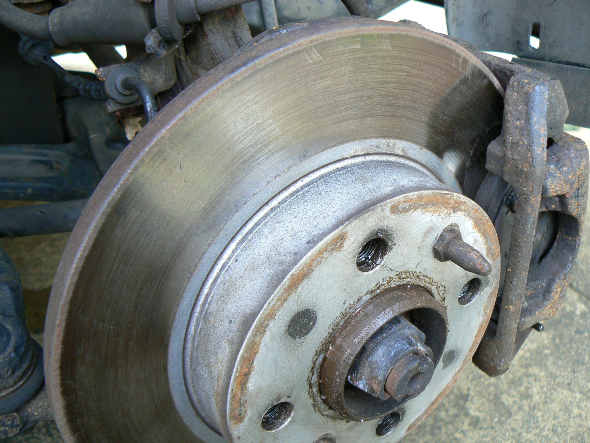

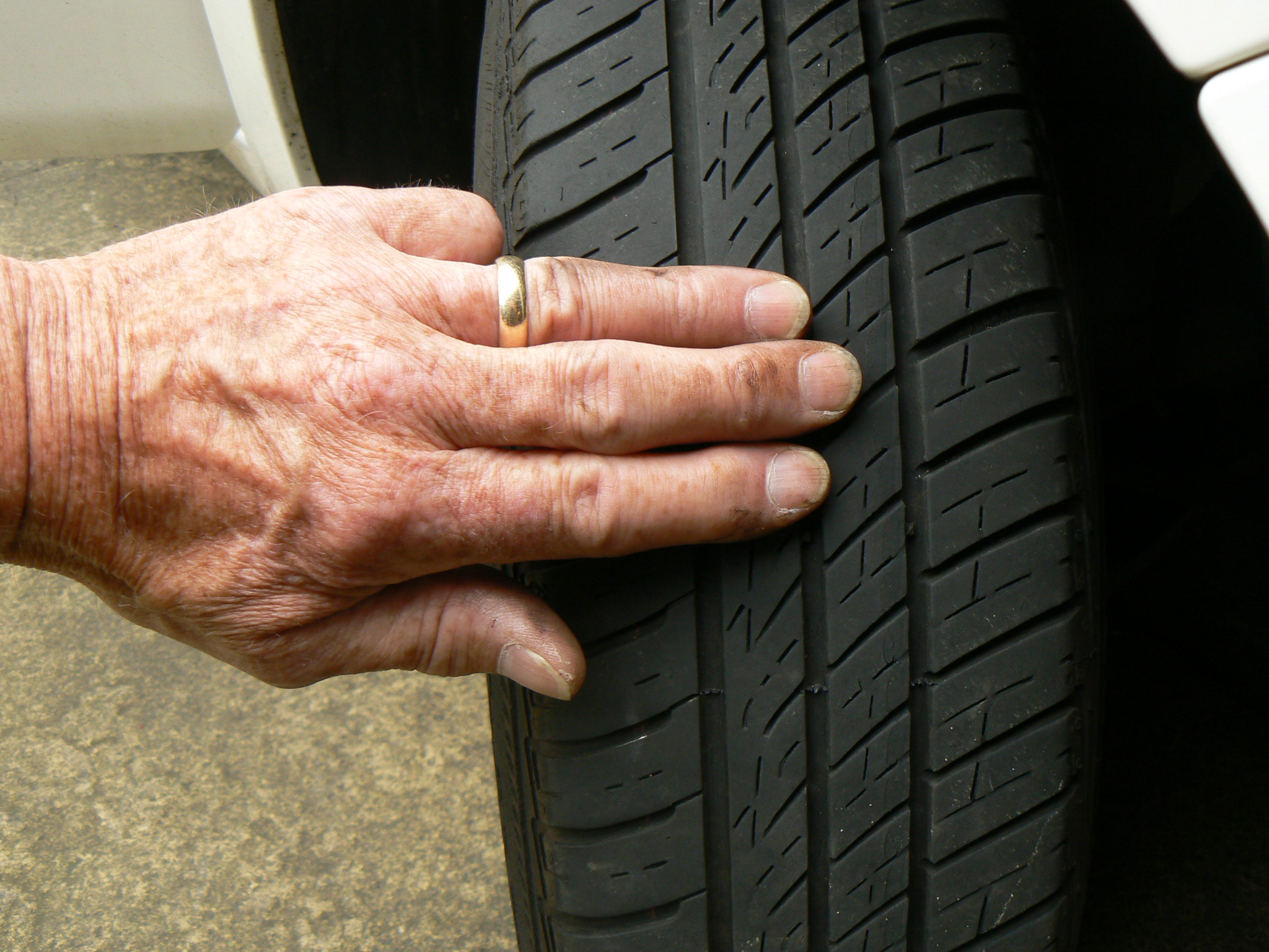

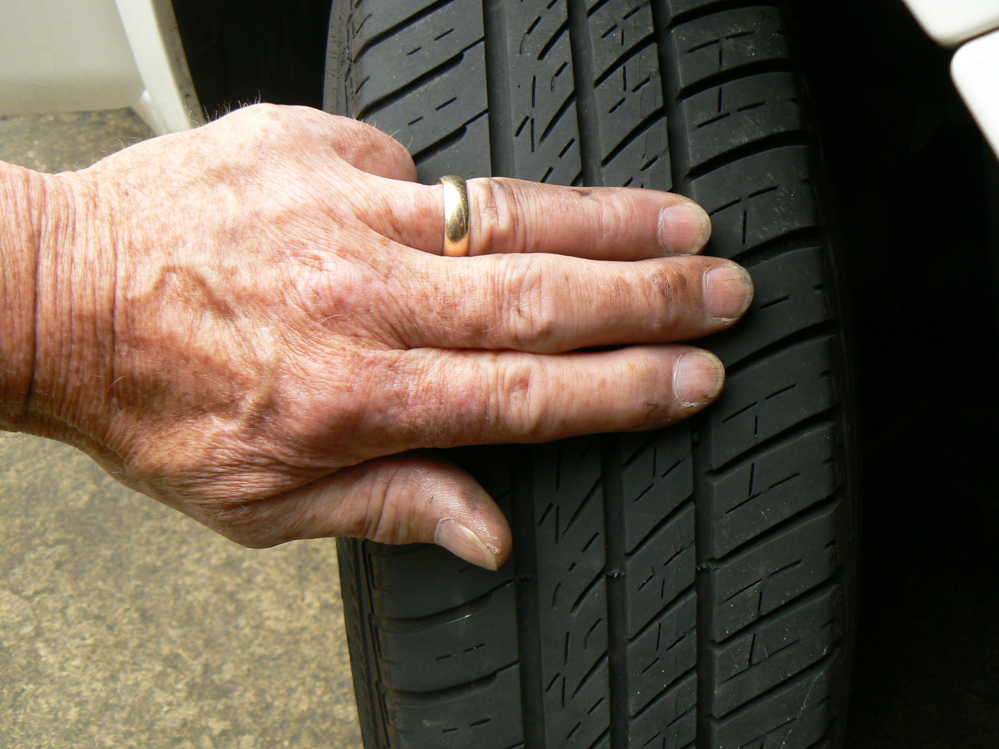

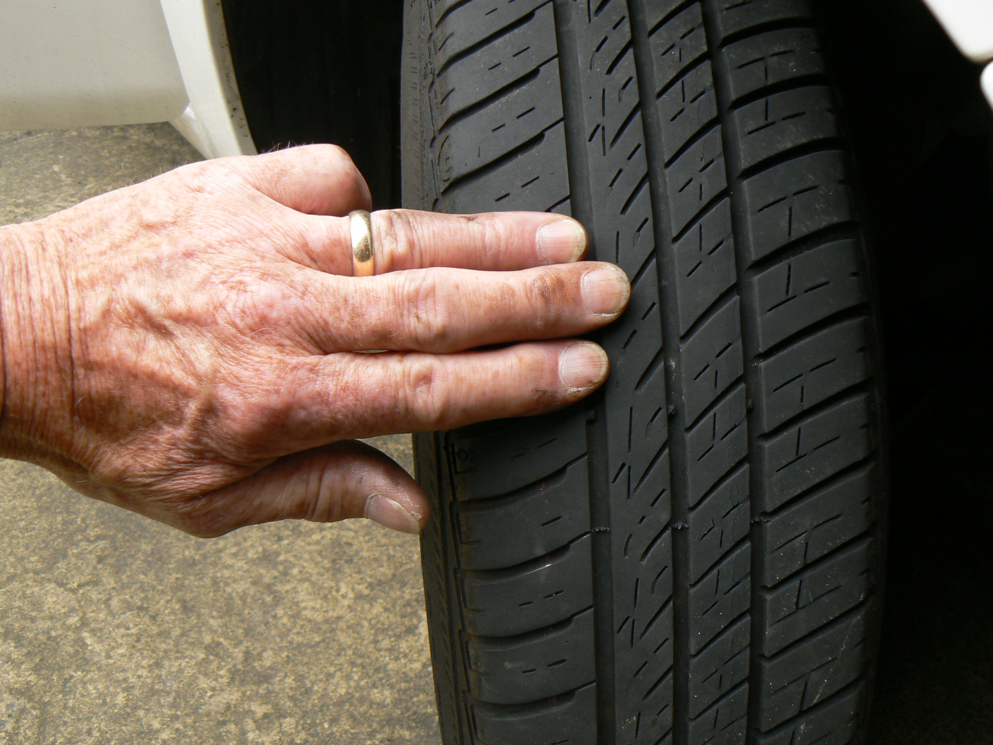

Mrs J was busy with sewing things so grabbed a coffee (Aldi Cappuccino actually) and sandwich and went and sat on the ground beside Becky's OSF wheel whilst I munched. Now I've had a fairly good look at her front suspension when I was working on the timing belt but not to the extent of actually, close up, for a number of minutes, looking closely at a front tyre. I had pulled in with a lot of lock on earlier so the front tread was fully exposed. This is what I was confronted with as I drank my coffee and it got me just mildly excited.

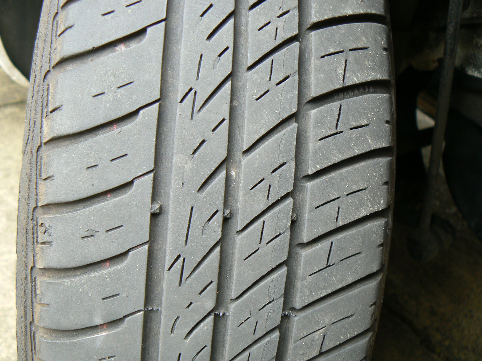

So what was I looking at? Well first off the outside tread edges are more worn down (less depth of tread) than the inside. This as a stand alone observation may not be significant as you would expect to see that if the car had been cornered hard by the previous owner. However if you look very carefully you will notice that on each block of tread the edges to the left are slightly rounded off and the edges to the right are very sharply defined. Now if you take your fingers and rub them sideways, to and fro, over the tread, feeling the edges of the pattern as you go,
you should find both edges feel the same, but in this case the inside edges felt much more "catchy" and "sharp" than the outside. Now I examined the other front tyre and found it to be the same, outside more worn than inside and rounding of the outside of the tread blocks with "lipping" of the inside edges. This is a classic indication that the toe is wrongly set. In this case the symptoms indicate too much toe in (in other words the front tyres are snow plowing down the road, or, to put it another way the front wheels a knockneed! If the wear pattern is reversed there would be too much toe out which means the front wheels are splayed out. A further indication in this case is that the wear pattern on the NSF tyre is a little worse than the OSF which is logical as road camber causes you (and you don't really notice it) to steer, very slightly, to the right so the left front will exhibit more wear. This effect is reversed if you've got too much toe out.
So. OK. looks like my Toe settings are incorrect, but is this due to wear, or maybe damage to a component in the steering, or actually being set up wrongly, or what? I spent about an hour going very carefully over everything I could get my hands on, pushing, pulling, levering, twisting etc also checking for damage to ball joint rubber boots and components themselves (ie is something bent?). I was very pleased to see how good those front brakes are looking.

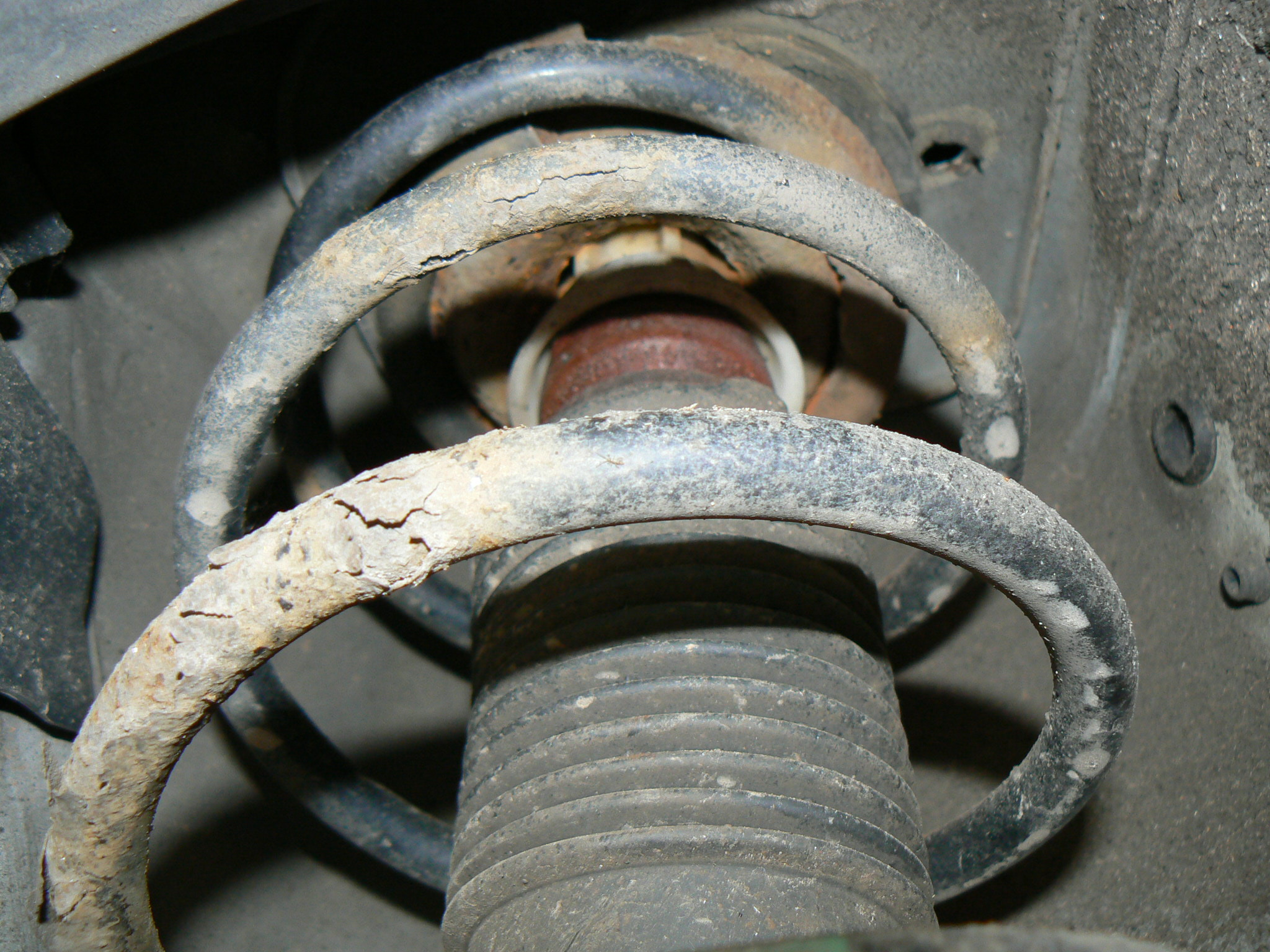

If you remember what they looked like when I stripped them, why, it's nothing short of a miracle! I was less pleased with the front road springs which look a bit rusty and the underneath view of the top spring mounts which also look a bit rough!

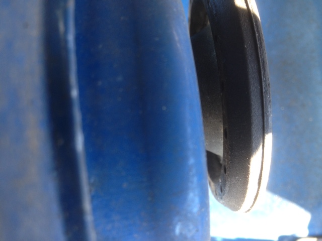

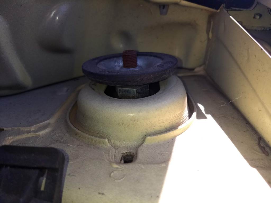

It was whilst looking at the front springs and the, somewhat limited, view of the spring top plates, that I went "up top" to examine what can be seen of the top mounts under the bonnet. Close examination clearly shows that the OSF top upper mounting cup Mr Haynes name for it!) is well proud of the body work
when compared to the NSF one, which is itself showing some clearance.

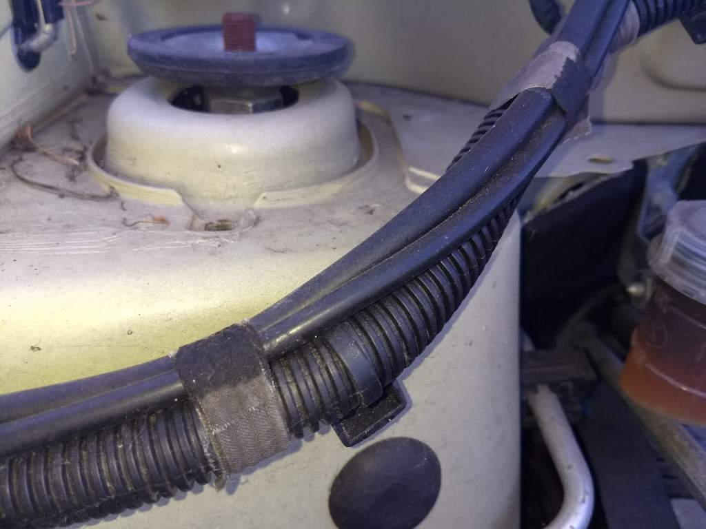

question for any knowledgeable gentlemen who might be reading this. should the cup be hard against the tower when new or will there always be some gap?
Where is all this leading I hear you ask? Well, I think I may have found the culprit behind the strange feel to the steering. I'm very suspicious of that OSF top mount. It's protruding much further into the engine bay than the NSF one. I think It'll have to come apart for inspection!

Thanks for your post Jock. I haven't had time to investigate as I am currently fitting a rebuilt engine into my Morris Minor. I did photograph the top mounts today and they do look high, pics hopefully attached. Steering as bad as ever. Will definitely stay where it is left, a few degrees left or right of straight ahead. Definitely not the tyres or power steering at fault.
The picture on the right (can't tell which side of the car that is) does look high, suggesting the steering top bearing has failed. It's not a bad job to replace and you don't have to replace the strut.
Wow Martin, those put mine in the shade. I think your's definitely qualify for the award of "Sh****d (worn out) Top Mount Of The Month"!

Here's my tophat same on any I have looked at. I don't have an issue.
There will be no movement with the weight of the car holding it in place
Your looking at the wrong place for a wander issue. Imagin moving the top a mm forwards and backwards. The amount it moves at the bottom is very small as its divided by the length.
Movement in the suspension arm is magnified by is length. Not that I am say this is where your problem is. You will have to take the weight of each joint and place a crowbar above and below and wiggle to find where the wear is.

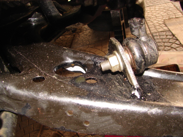

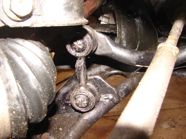

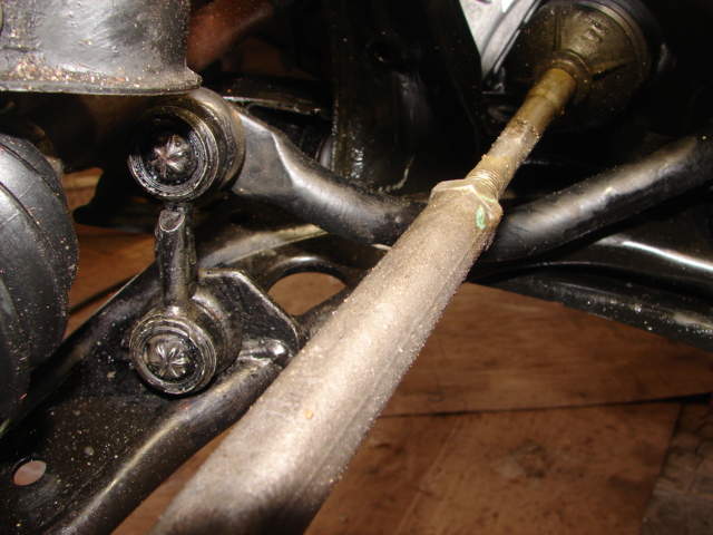

All of you guys are obviously not technical . the twangy centering steering is caused by the anti roll bar drop link loads being fed into the Macpherson strut which is a A STEERING COMPONENT. Check out the photos I shortened the drop links and welded a lug onto the lower wishbone to take the anti roll bar forces . the added bonus is a more positive turn in to traffic islands when pressing on .The welded on lug is 5mm thick steel plate double welded . As you can see the whole front has to be removed to gain access to the front lower wishbone bolt . Quite an easy job . under 1/2 hour . increasing the caster angle may make the steering even nicer .. I have yet to check the factory caster settings. for more info and measurements email me [email protected].
