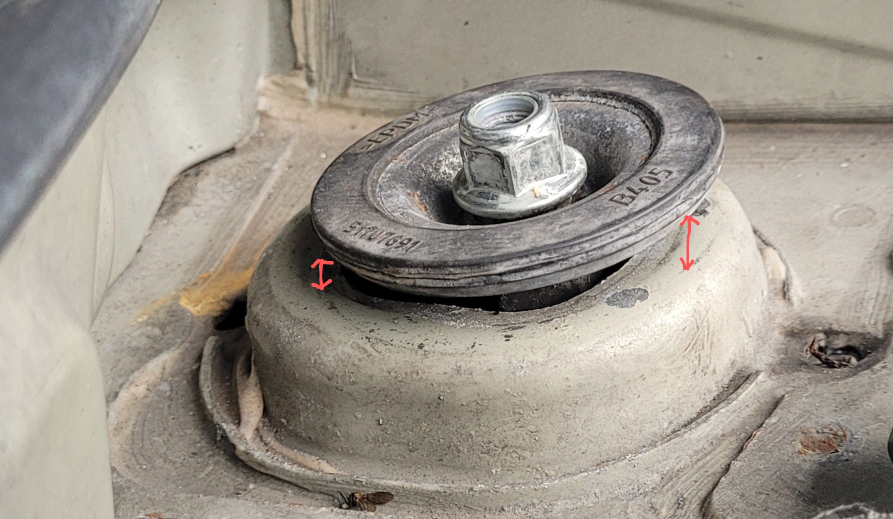

Doesn't look like it's sitting flush
One side higher than the other
Or is it just the photo
One nut is done up and the other loose which may explain. Wrong type of nut in this pic. Better replaced in pairs and with the correct nuts. There are top strut bearings and top strut bearings. Quite significant differences in the thickness of the rubber coatings from one type to another and I suspect this can affect how they seat and ride height. Any poor quality control in manufacture will mean slight differences that may equalise after some use. Getting the torque right on the the strut mounting nut is not easy. I think getting better quality top mounts rather than the cheapest may be beneficial but the cost difference can be a big issue. I know because I fitted cheap parts 5 years back to Daffo and I think they need doing again I shall move up the market this time.

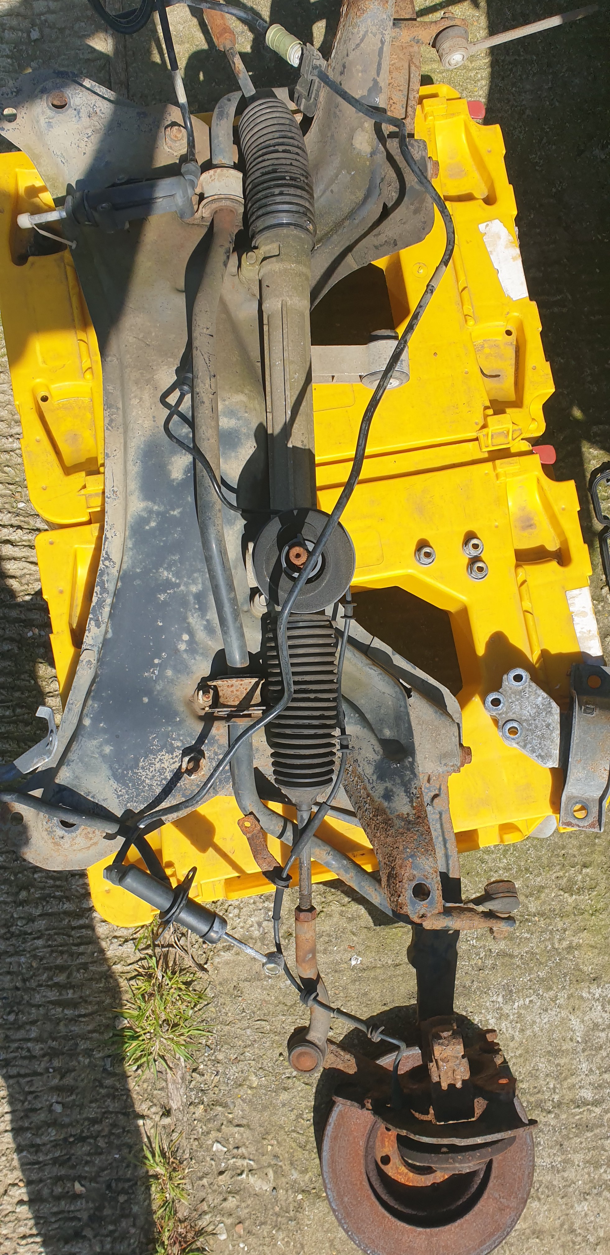

I think I've only changed one rack on a Panda, and i vaguely remember that the only reason for changing it was that someone had damaged it when trying to remove it. I do remember it being harder work than I expected when I started.
Every other time when it wasn't top mounts or front dampers, it has been inner tie rods (which are readily available and easy to fit).
I do need to change a front subframe at some point this year (rust damage on an otherwise un-rusty diesel Panda) but that's an easier job altogether (unless the subframe bolts snap, of course) and I'll probably use a secondhand one with rack already in it anyway as I've saved a few from ones on their way to the great Panda graveyard in the sky. (New gaiters and inner tie rods, of course)

The only fault I know with the rack is stiff after a bump
They feel fine at low speed say parking in a car park when there is maximum assistance
But if you are changing from one lane to another on the motorway there's a bit of reluctance to start to turn, then once you are in the lane it's again a fight to straighten it up
