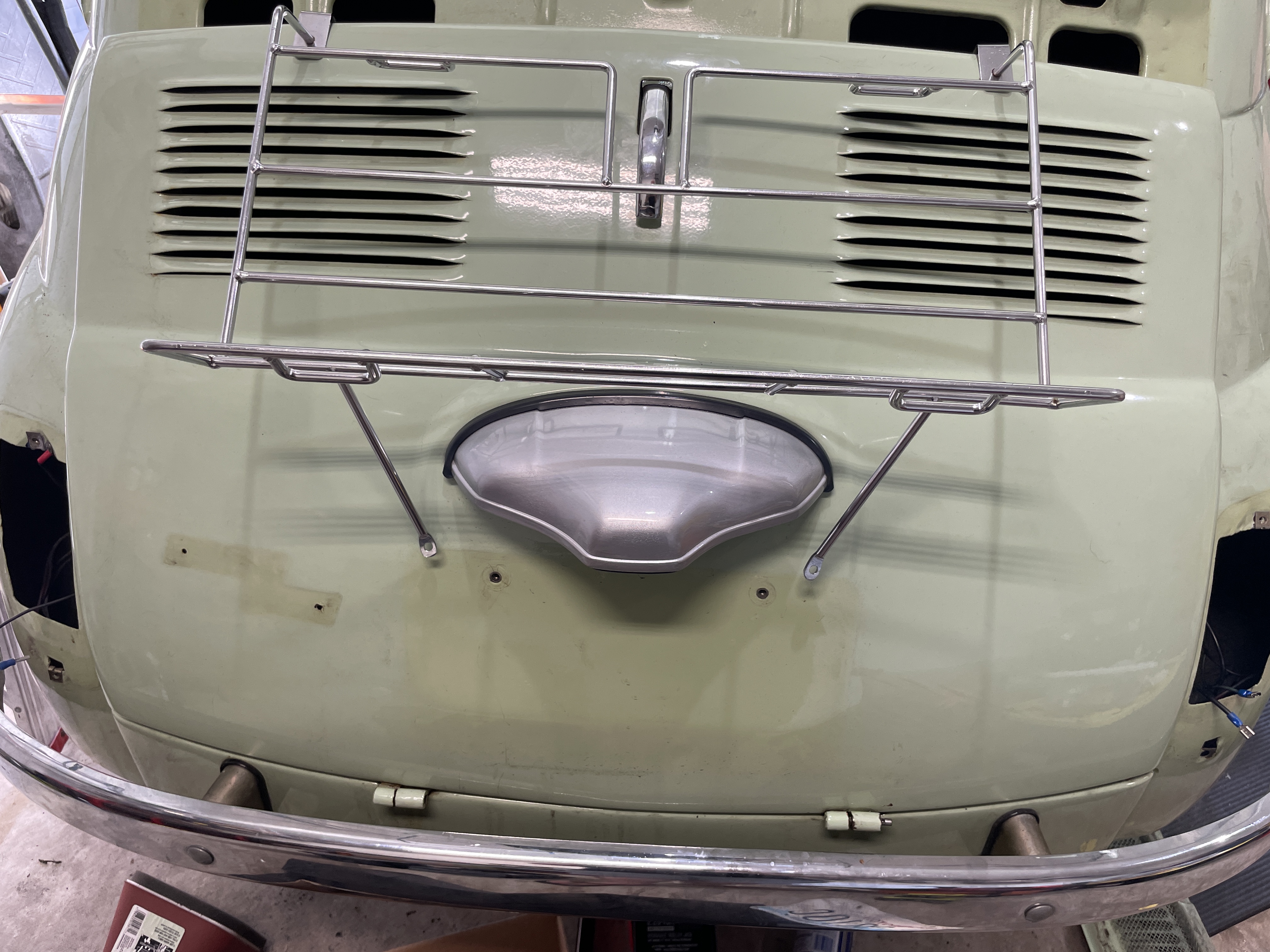

Can anyone recommend a decent quality rear badge that fits the profile of the boot? I’ve tried 2 that have both broken when attempting to attach the clips to the pins. Does anyone make one with a slight curve to fit properly?
What sort of badge and where are you trying to fit the Ryan? When fitting the badges on the side of my replica 695, for each badge I got 2 long screws that would fit them, ran an appropriate sized plain nut down each bolt, then "JP Weld" them into the bosses on the back of the badges, having run the screws as far as possible into the bosses. When the JP Weld had fully cured, I cut the surplus amount off the bolts which turned the into studs. Taking the nuts off the 'studs' cleaned the thread up. I then fitted the badges with washers and nyloc nuts--the badges did bend very slightly, but I tightened them in gentle stages.
.Being that my engine cover is permanantly open I fitted a bigger "Abarth" badge where the handle had been, so it also became a 'hole cover'. I also put about 3 layers of insulating tape on the back of all the badges so that the badge wasn't metal against the paintwork.
The “Fiat 500” badge on lower left side of the boot lid. See the darker area in the photo below. I’ll also be making a bracket to attach the “no drilling required” luggage rack

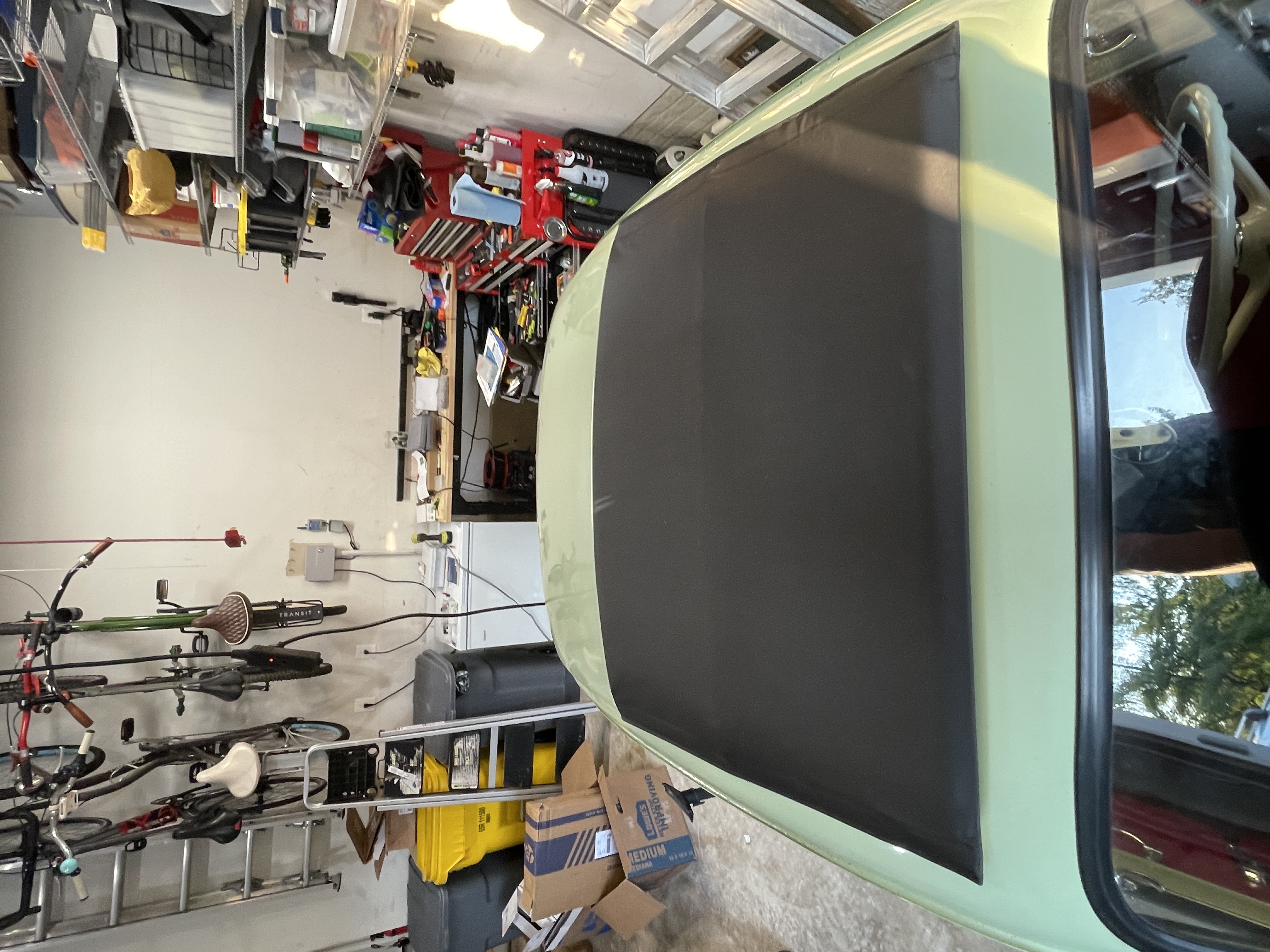

Been a bit quiet on the resto but I’ve gotten the new roof fitted (with the addition of Rivnuts to secure the corners.
Is there a proper way to “adjust” the sunroof? It seems one side is not sealing as well as the other.

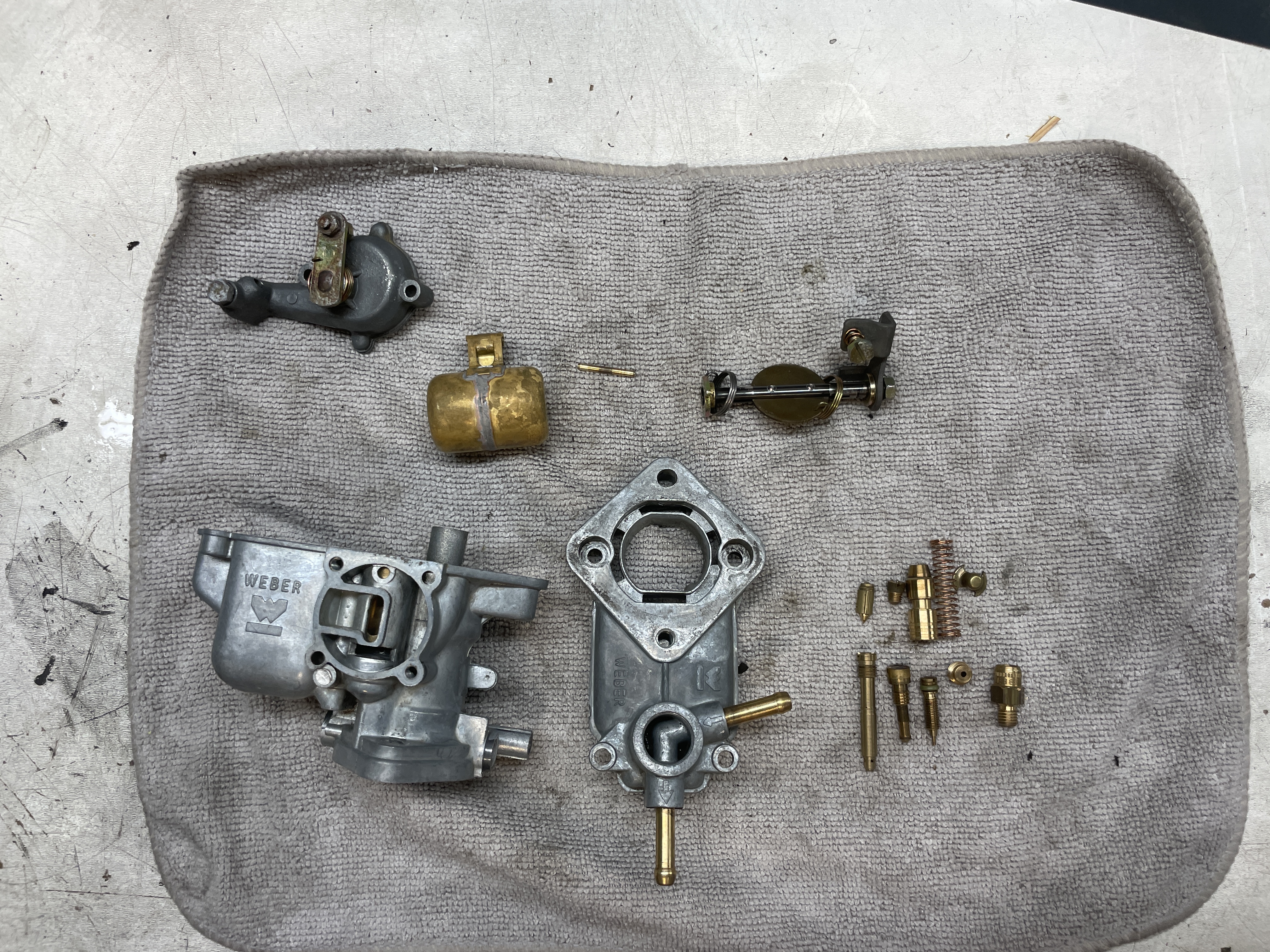

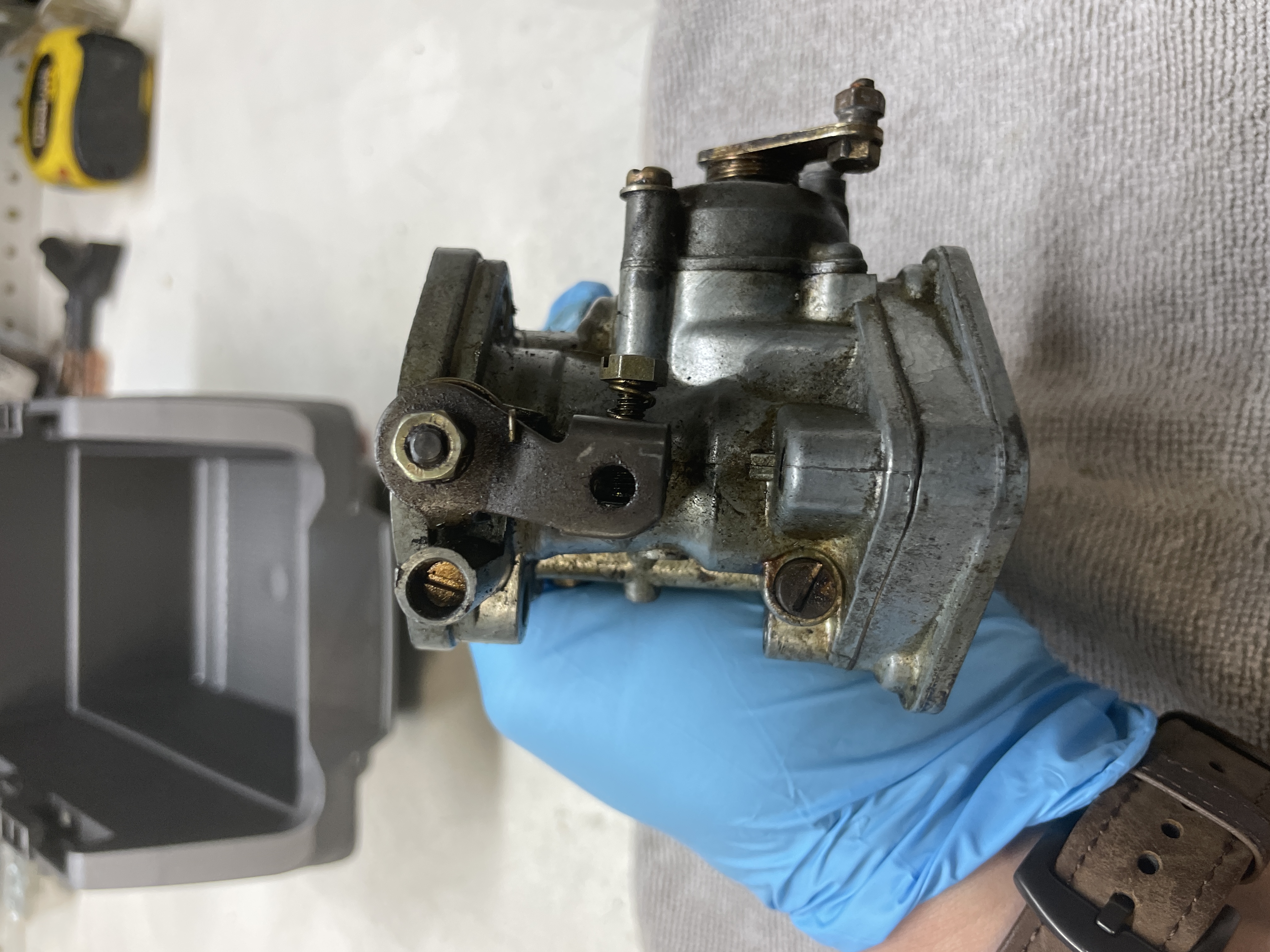

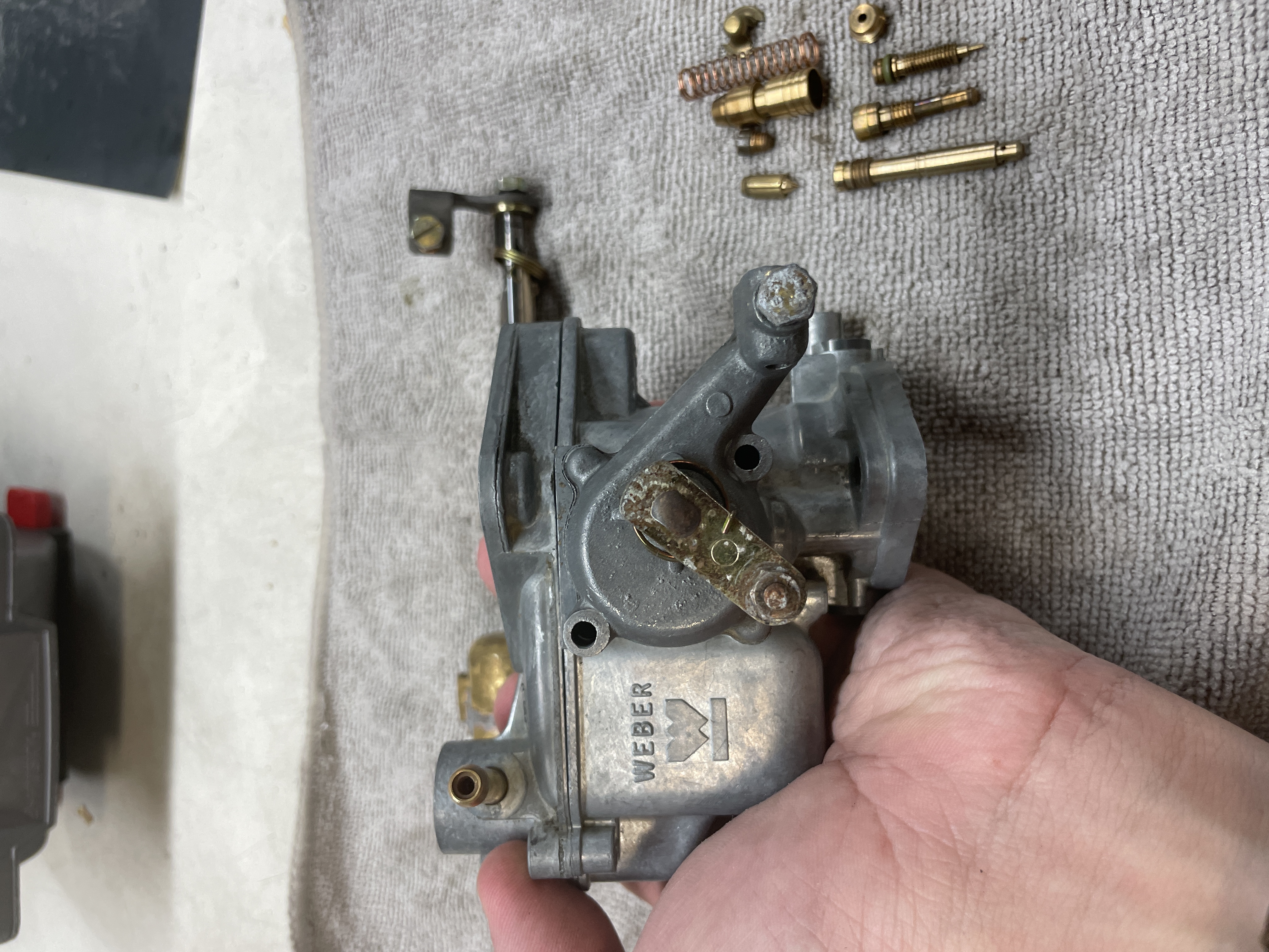

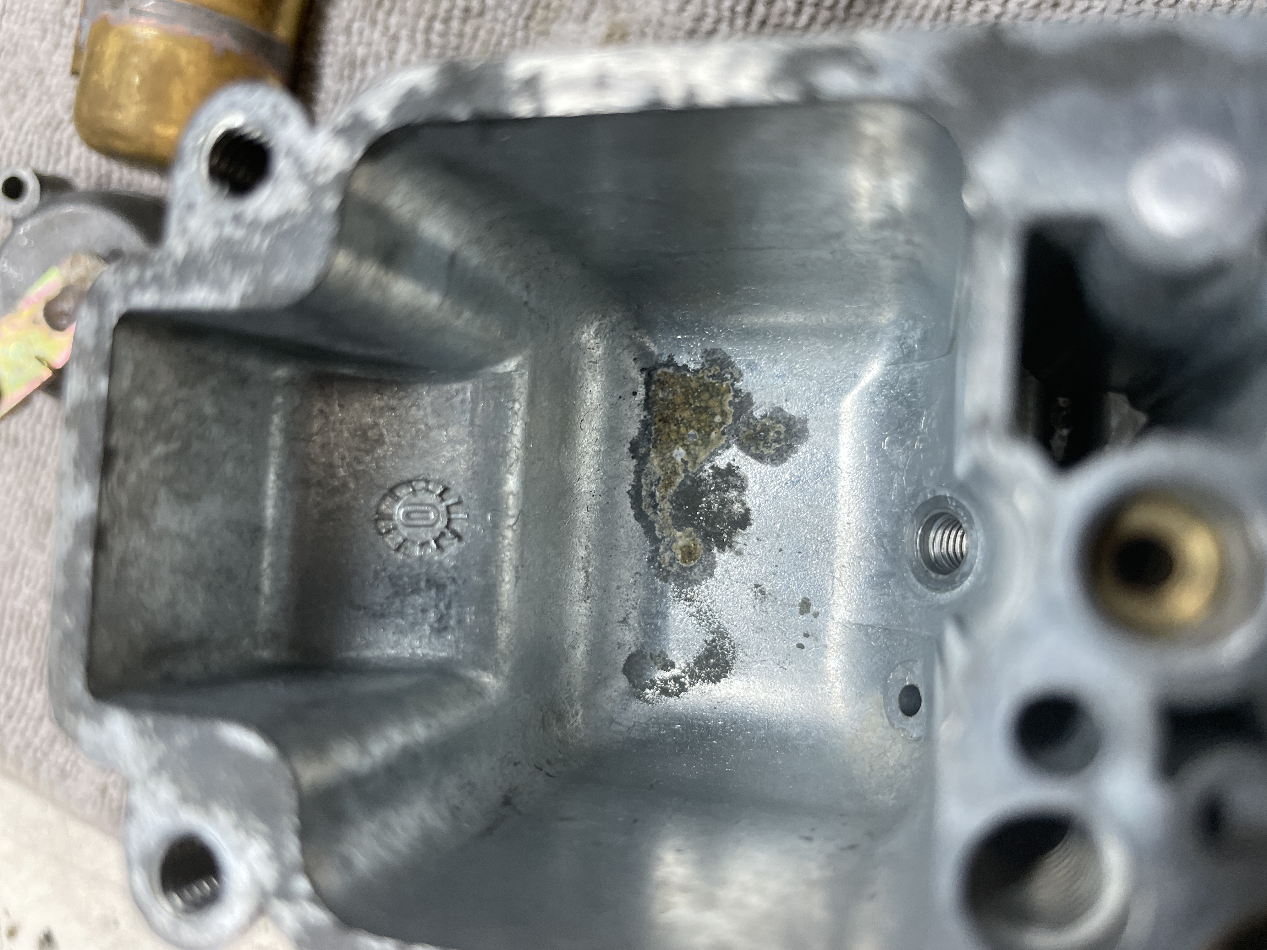

Got to cleaning up the carb today. Looks like I have some pitting in the bowl. The base needed a little “skimming” to get rid of the wobble. Some of the screws have been overtorqued at some point and are looking a bit rough. Other than that it looks in good shape and will get rebuilt from the kit I have soon.

Do you mean the 4 screws that hold the top cover onto the carb body?
I will look in my collection of 'bits' and see what I have got---I might just be able to help you out---let you know later today
