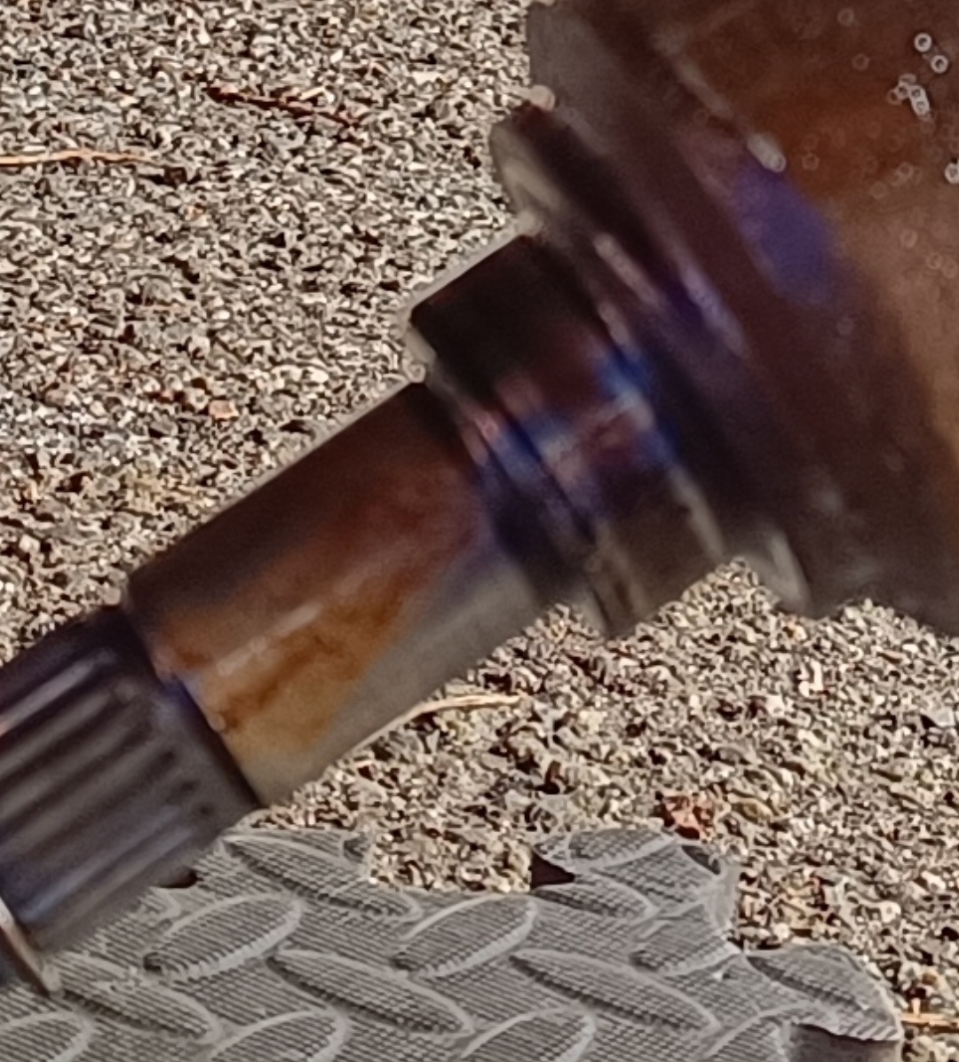

Must have been very low on oil for a while to get rusty here
Hopefully no lasting damage done to internal bearings.
And I hope that left rear tyre is getting replaced too ;)
Thanks, i think i'm going to be on a roll before long!
You're eagle eyed lol
Ah the left rear tyre, i'm going to get that replaced asap :)

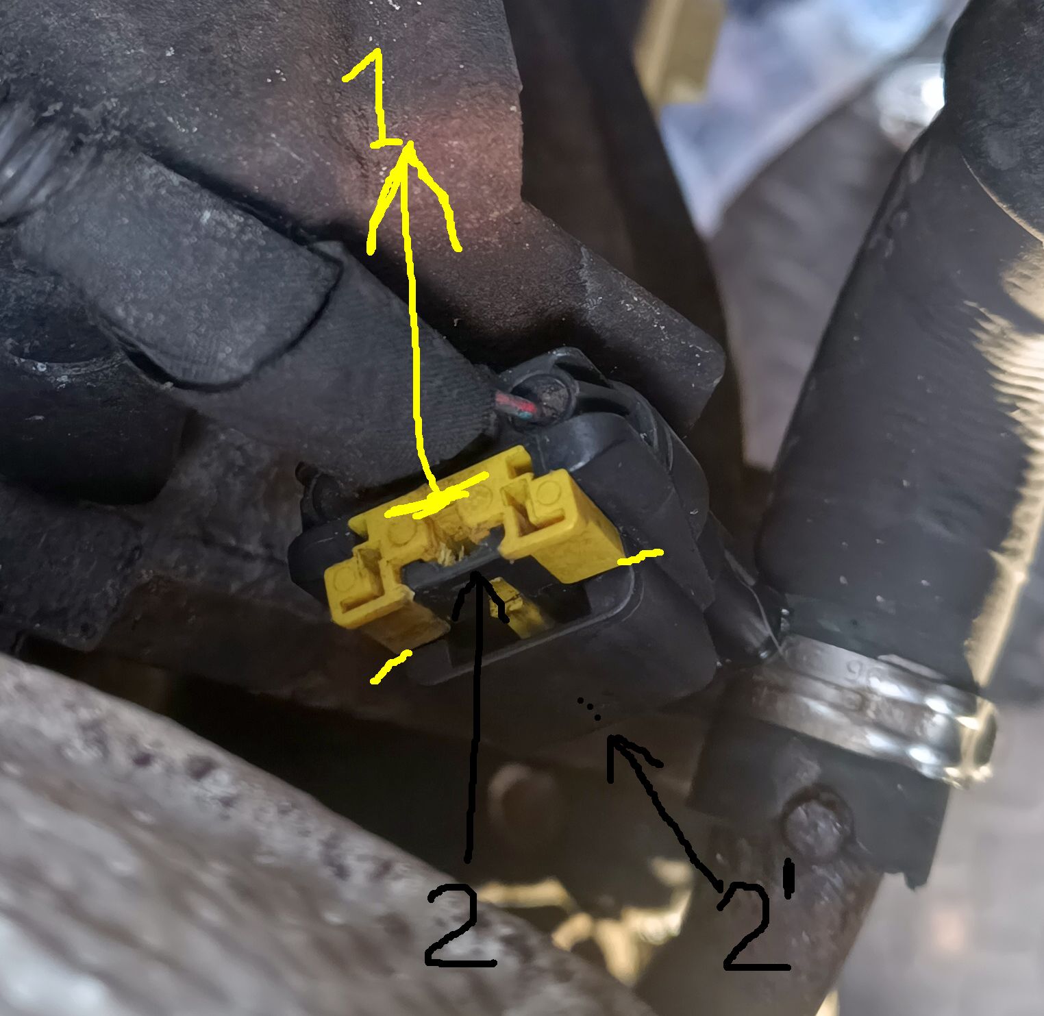

Anybody know how to remove these clips? I've already chipped off a little of the yellow plastic, by the time I learn on my own it'll need replacing...:)
Small screwdriver and you push/pry the yellow plastic up. It will then release/free-up the secondary (black) latch deeper in the connector.
Old locks/latches can be soft (or almost broken), so pushing black central feature will not work. Then you can release the black clip with same screwdriver, but this time you push it from the bottom up (hit in the center).
Google: https://www.fiat500owners.com/threads/o2-sensor-connector-how-to-pull-apart.151430/
I'll give this a try, thanks.
