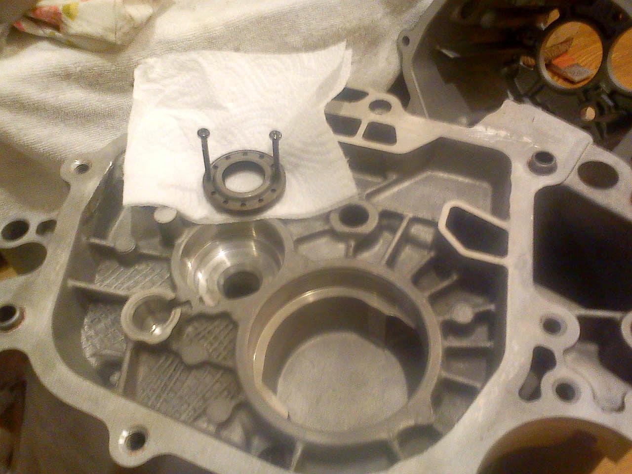

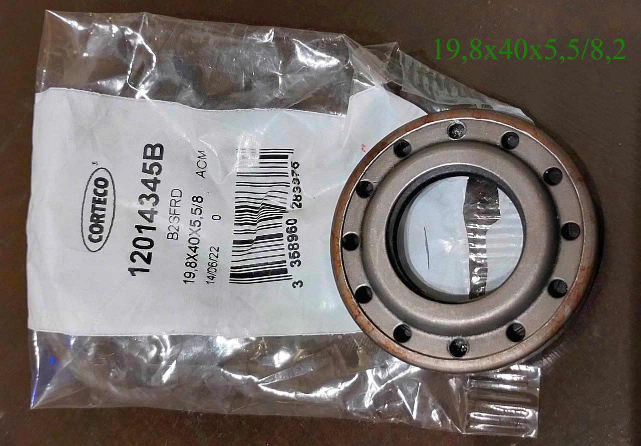

3. Input shaft seal for C514 family. I did mine years ago. It's a hard, tight press-fit (harder than regular seals - like axles etc.).

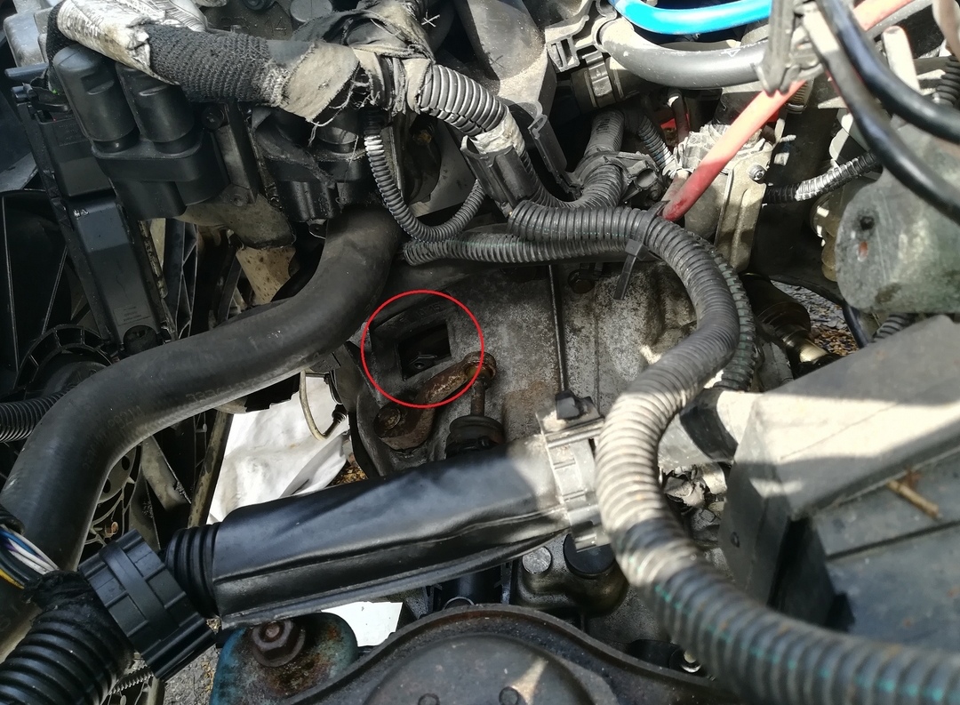

Stick a finger in this hole on the bell housing:
It'll be filthy. Dry OK, wet and oily means the input shaft bearing has had it. Can do damage to the internals if the bearing breaks up.
I just had a look in the bell housing and it is bone dry. I haven't had any difficulty changing gears previously so fingers crossed i've caught the gearbox in time.
