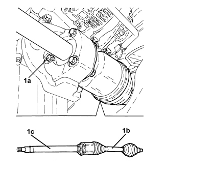

My son bought a Evo 2010 and the clutch is slipping, no place to do it for 2 weeks. had a browse online and though yeah I'll do it. Anyway all the videos are not of the 1.4 t jet.
Now im stuck on the right/passenger side drive shaft, not sure how to remove it as its not the same the drivers side. has an join bolted half way. like the attached. once I undo the 3 dolts do I just pull it out? start motor. also it has a pipe/oil maybe going to the gearbox at the front im stuck on too.

Once you undo the three nuts washers and long bolts , you should be able to tap the inner joint just forward of the three bolt housing and pull the bearing/shaft out as a unit. I can't remember on your model but some have special off set heads on the bolts to locate in the housing, I know Citroen do.
you are right sir. managed to pull it out ok.
