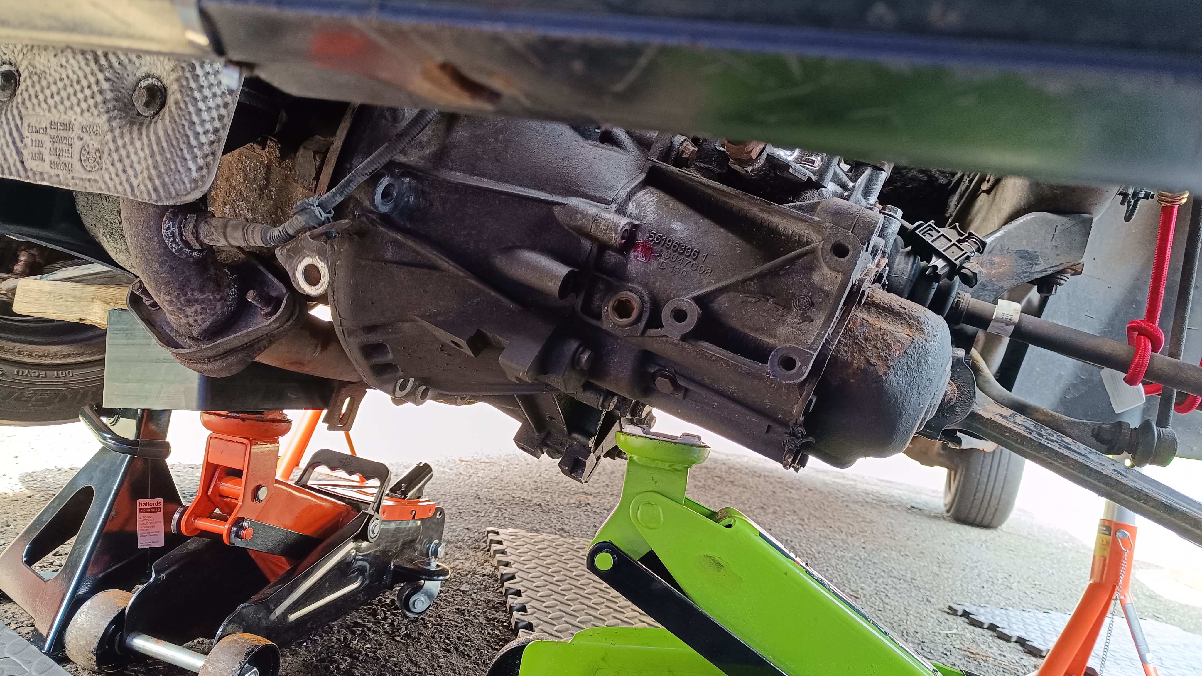

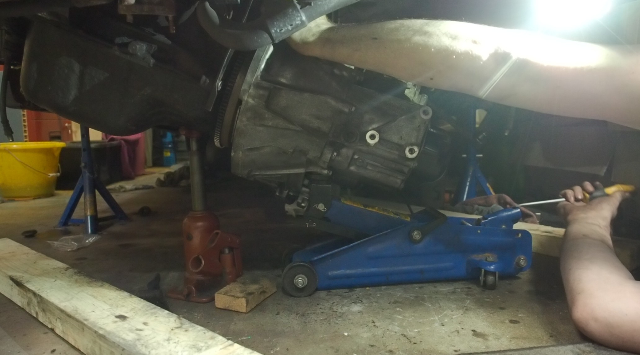

"Problem", again? Look at this guy from YT: https://www.youtube.com/@WMCS/search?query=Fiat
Gearbox weights only 30 kg, healthy adult male should be able to handle it.
The biggest obstruction for me was the axles - you should remove them completely from the car, unlike the YT dude.
It should be done by hands, not tools (jacks), because you need to "feel" what's going on, if it's stuck etc.
You can bend the input shaft if you try to force it into place. There is nothing to "wrestle" there.
