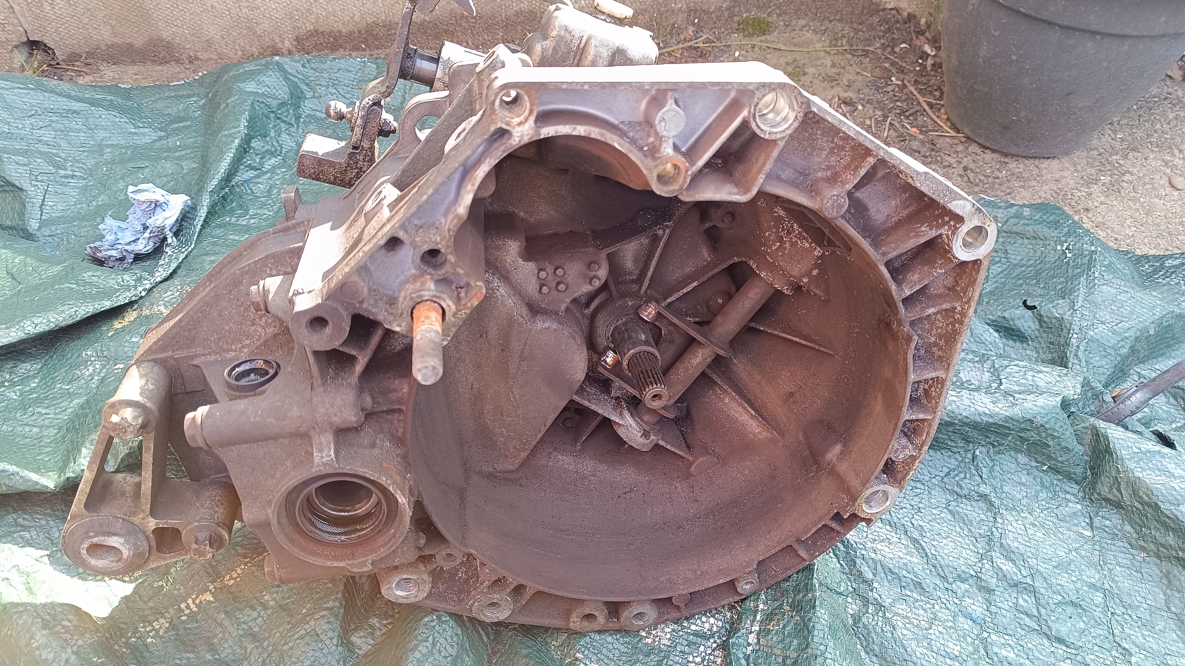

I have a few questions.
Is the gearbox oil circled in red below supposed to be there? i presume its meant to be grease.
What is this rusty nut doing? It doesn't appear to be holding anything.
How do i get the clip off without destroying it?
What should i clean the inner bell housing with? Water/soap? Brake cleaner?
Feels like i'm reconditioning the gearbox rather than replacing the clutch!
What else do i need to check?
1. Gearbox has no "grease", just oil. You have worn gear selector seal (20x30x7), there is a Guide for it! Grande.
Well, there is/was a grease, inside the ball bearings (some of them were sealed type), but we are not that deep yet...
2. Rusty nut holds the main "earth" lead! FAQs, "Electrical gremlin thread" in the Grande section had a picture...
3. Clip is just a regular circlip, there are tools for it (two types: for internal and external clips, that's all), pliers.
4. You can clean with water based stuff, just dry it well after. Plug the axle holes. Brake cleaner will do too. Plus brush (dirt must be agitated).
5. What else? Axle seals? Selector seal (point 1). How far/deep you wanna go? Go back to page-2 for example.

I'll start working through these and see where i get up to, thanks.
I'm struggling to find the right seal for the gear change shifter. I think the right ePer page is below...but which part is it? Is it even there? Or do i buy any 30x20x7? I might just leave this till later as it can be changed with the gearbox on the car.
The old clutch came off quite easily, unless the retaining bolts have a really low torque from new then its been replaced in the past.
How does the input shaft feel when you turn it?
Any play? Turning smoothly or any notchy feeling in the bearings?
I'd be very suspicious of an input shaft bearing that's run in low oil. The plastic cages have a habit of disintegrating if they get too hot.
Input "clutch" shaft bearing had a metal cage (old version of the bearing, ball bearing and sealed type, filled with grease).
Known for disintegrating badly. Examples on YouTube. You'll find cage debris in the oil, in the differential, axle seals etc.
New version/revision has open bearing, roller type.
Other bearings - same situation. Sealed ball type ones were successively replaced with open roller version.
