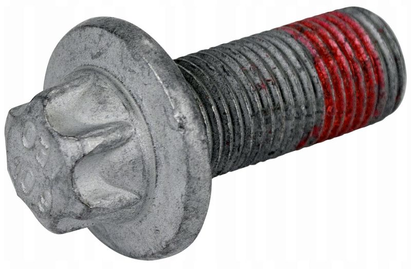

I'm still going round in circles trying to find the torques head caliper holder casting bolts, that hold it to the hub........4 wanted, 2 per side......

EPER, general view: https://eper.fiatforum.com/en/Drawings/Detail/F/F/FPUN/2Y/331/17/ALL/0/SubGroup
Click one level deeper ("Components" -> "Go"). Example: https://eper.fiatforum.com/en/Cliche/Detail/F/F/FPUN/2Y/331/17/0/1/SubSubGroup/55704023/1
Looks like the bolts are in the kit (not as a separate part). Google kit numbers or just "Grande Punto brake caliper bracket bolt E16" or similar query.
https://www.google.com/search?q=fiat+grande+caliper+bracket+bolt+E16 - bolts can be E16 or hex 19 mm. Fine thread for sure.
One of the results is a...FiatForum: https://www.fiatforum.com/threads/f...-for-the-front-brake-caliper-mounting.494988/
Both Google and people on forum will mix bolts in this area (some think it's about small ones, that hold caliper to the slider pins - those are 13 mm hex head and fine M8x1 thread).
Random shop (UK): https://www.fiatworkshop.co.uk/parts/Grande_Punto_Nuts__Bolts_Etc._.shtml - just make sure the pitch is right (1,25 or 1,5 mm).
Haha, both....
Will have to visit library again as internet phone screen and iffy internet ...
Nerd exact replacement bolts, correct diameter and pitch...1mm, 1.25, 1.5 ?
Suspect bolt will be ,*shanked* rather than thread all the way up to the flange, so shank accurately locates casting in correct position, with no ( or extremely tiny ) possibility of casting "moving" in brake application.

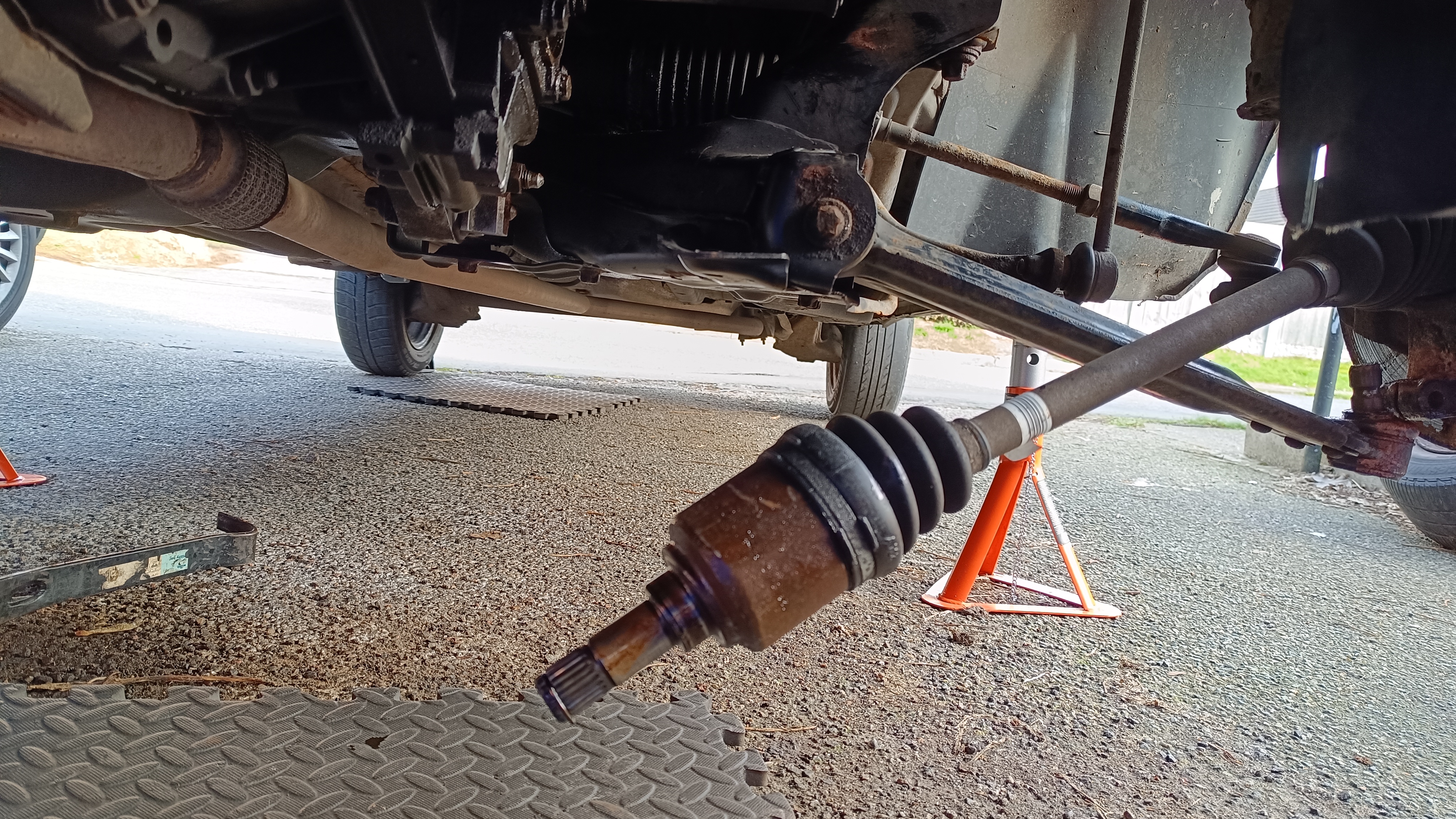

Success. I got the nearside driveshaft disconnected. It wanted to be turned to just the right position and tapped smartly as noted.

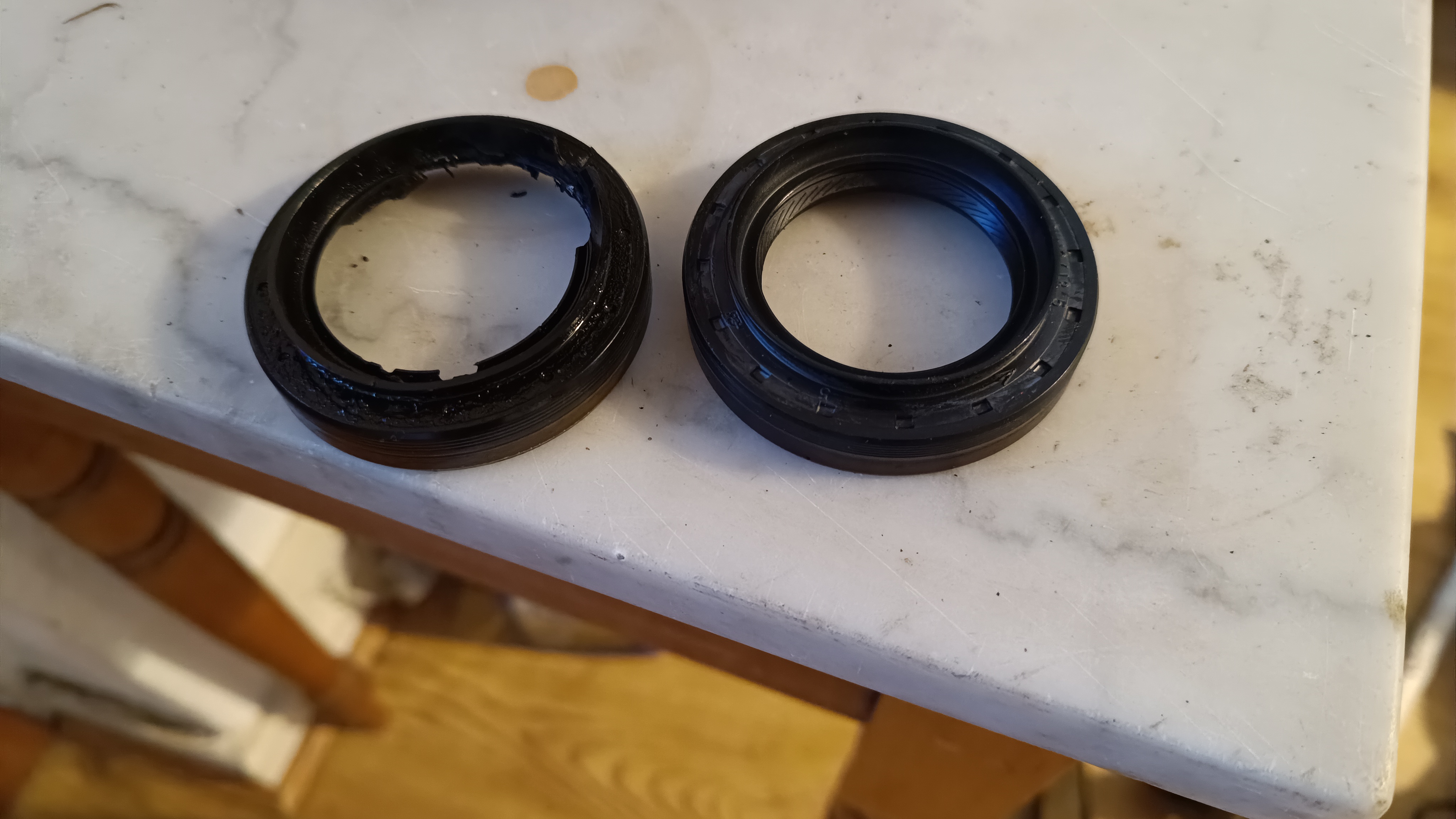

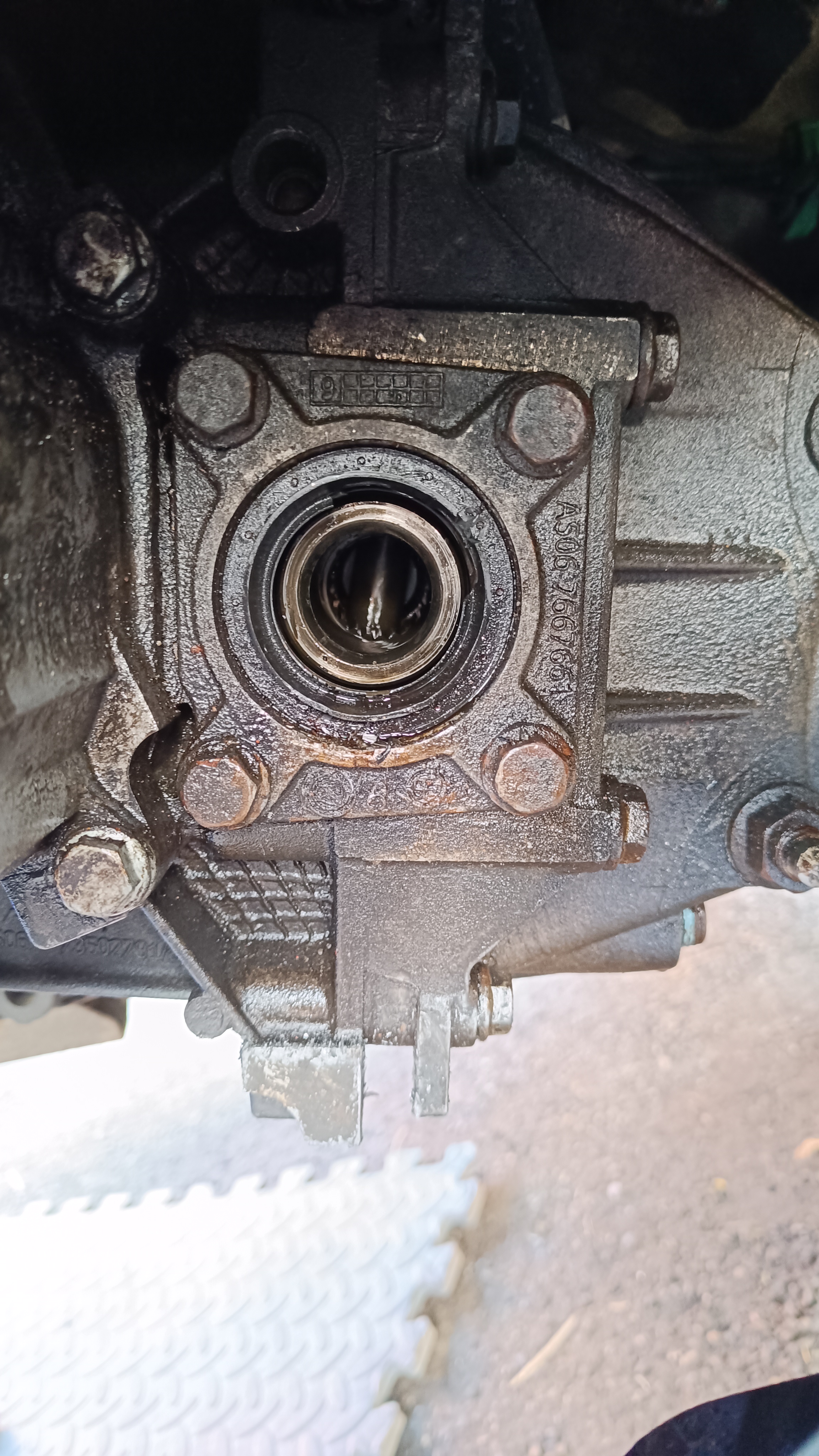

I almost took this little victory for the day and went to do something else, but then decided to try to get the driveshaft seal out, but it won't budge and is instead disintegrating! lol
Is there any easy way to get these out or do i continue disintegrating it until its loose?
Hurrah, success, give your self a real pat on the back. Stuff can be very difficult sometimes, but character building.
Post a better picture of the old seal, and the new seal.......
Don't be tempted to remove those four bolts that hold that cover on........get a manual, even a Haynes one is of some use.

Anyways, the shaft is out. Looks as if you did not remove/disconnect much at all ?!
Prey tell, to help others, what was disconnected/removed please to enable the inner joint to be removed from the gearbox please ?
Anthony,
A lone axle stand, mmmmmmmm
I have the car up on two axle stands, one either side. I've thought about getting it up on two either side, but people here said no real need.
I disconnected the control arm and left the rest in place.
Righto. I have the Haynes manual and will take a look.
