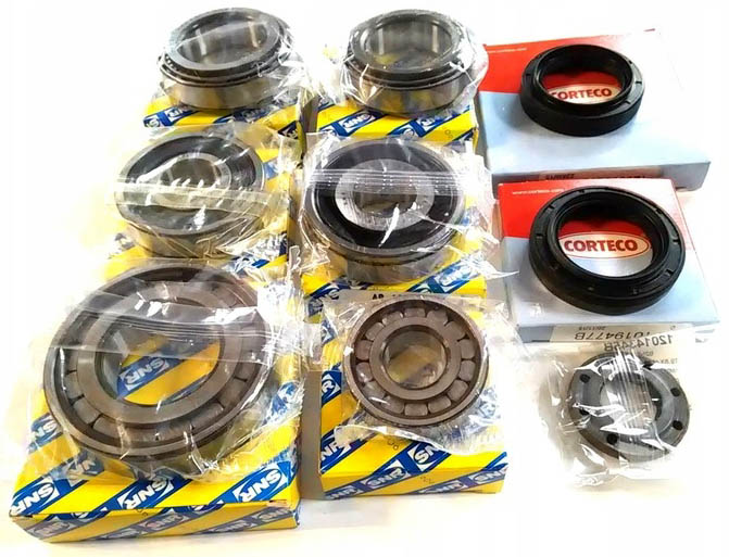

Sealed ball type ones were successively replaced with open roller version.
Well that's interesting. So later gearboxes (like the Punto EVO in this thread) have roller bearings in place of ball bearings for the input shaft?
Presumably more durable, hence Anthony's seems fine despite running with no oil?
Here's mine (2004 1.2 Panda) at about 100k miles (160k km). Not sealed, cage had evaporated, badly pitted, rattled horribly:
I put in a standard SKF 6204, but it would be good to know of a stronger replacement next time mine needs doing.
Grande 2009, input shaft, open roller bearing...
There are commercially available bearing kits, modified (one or more bearings are open roller, not sealed balls). This is "stage 2" set below.
Alternative "solution" is removing the seals. You turn the ball bearing into open type.
One failed bearing swap is not enough. Cage debris will fall into differential, killing main bearings etc.
You must completely dismantle the box and inspect everything.
