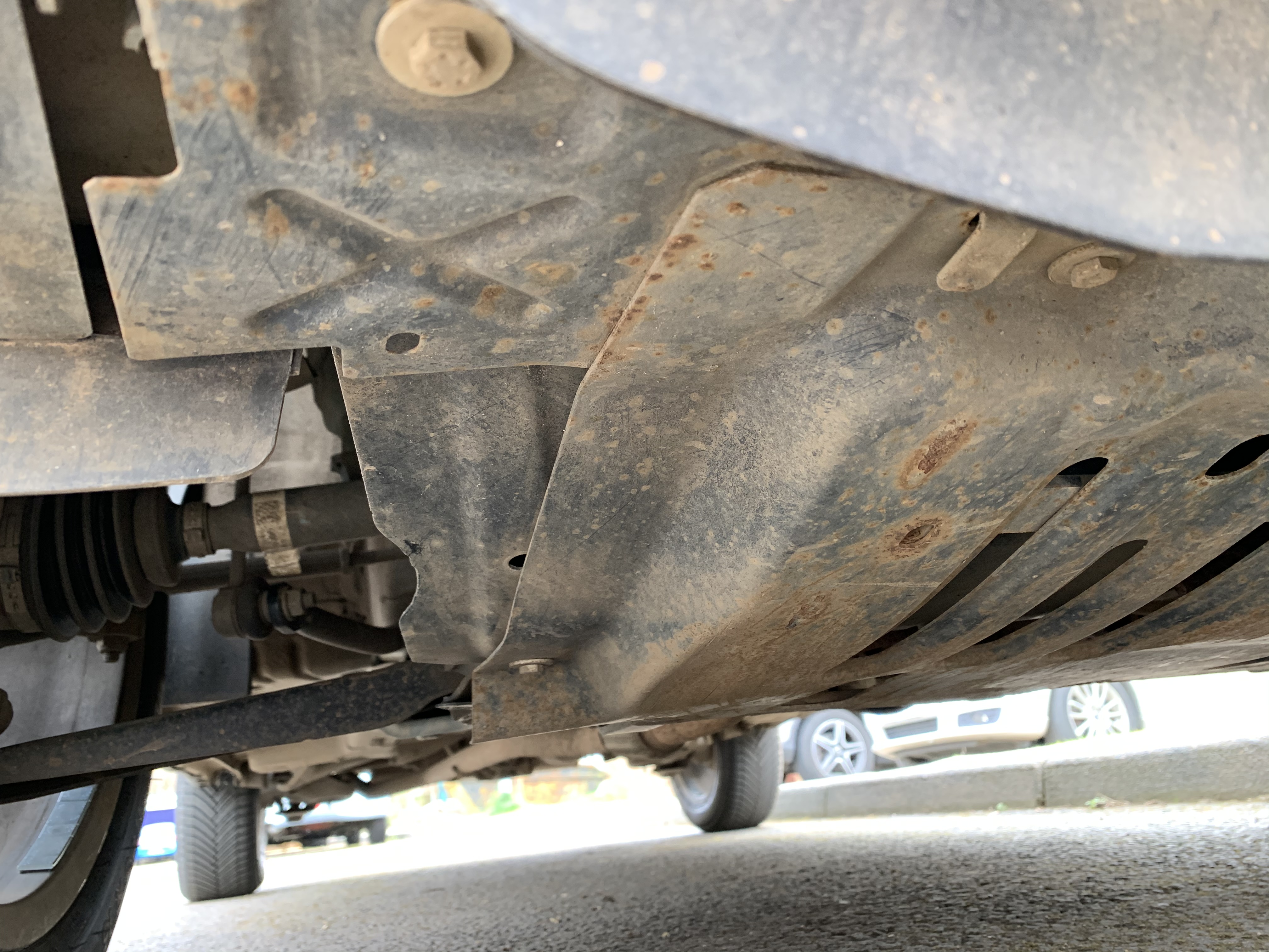

I was about to service my TA 4x4 for the first time today so had read up on the rusty sump guard stuff. Mine was not too bad - just a bit of surface rust here and there.
All good I thought until I came to undo the bolts holding it in place. Even with a good soaking of penetrating fluid half of them would not budge and started to round off. I tried ring spanners, open ended spanners and 6 point sockets but they would not budge.

I share your concerns which is why I want to change the oil ASAP.
I will have another go at the bolts this week using plenty of penetrating fluid and a bolt extractor socket - not used one of these before but Youtube videos suggest they look to be what is required.
I did notice some oil on top of the sump guard so I was hoping that someone had removed the sump plug with the guard in place and let the oil run out over the guard. It looks like it would just be possible to do this with the right length extension bar on a socket. Maybe this is just wishful thinking!

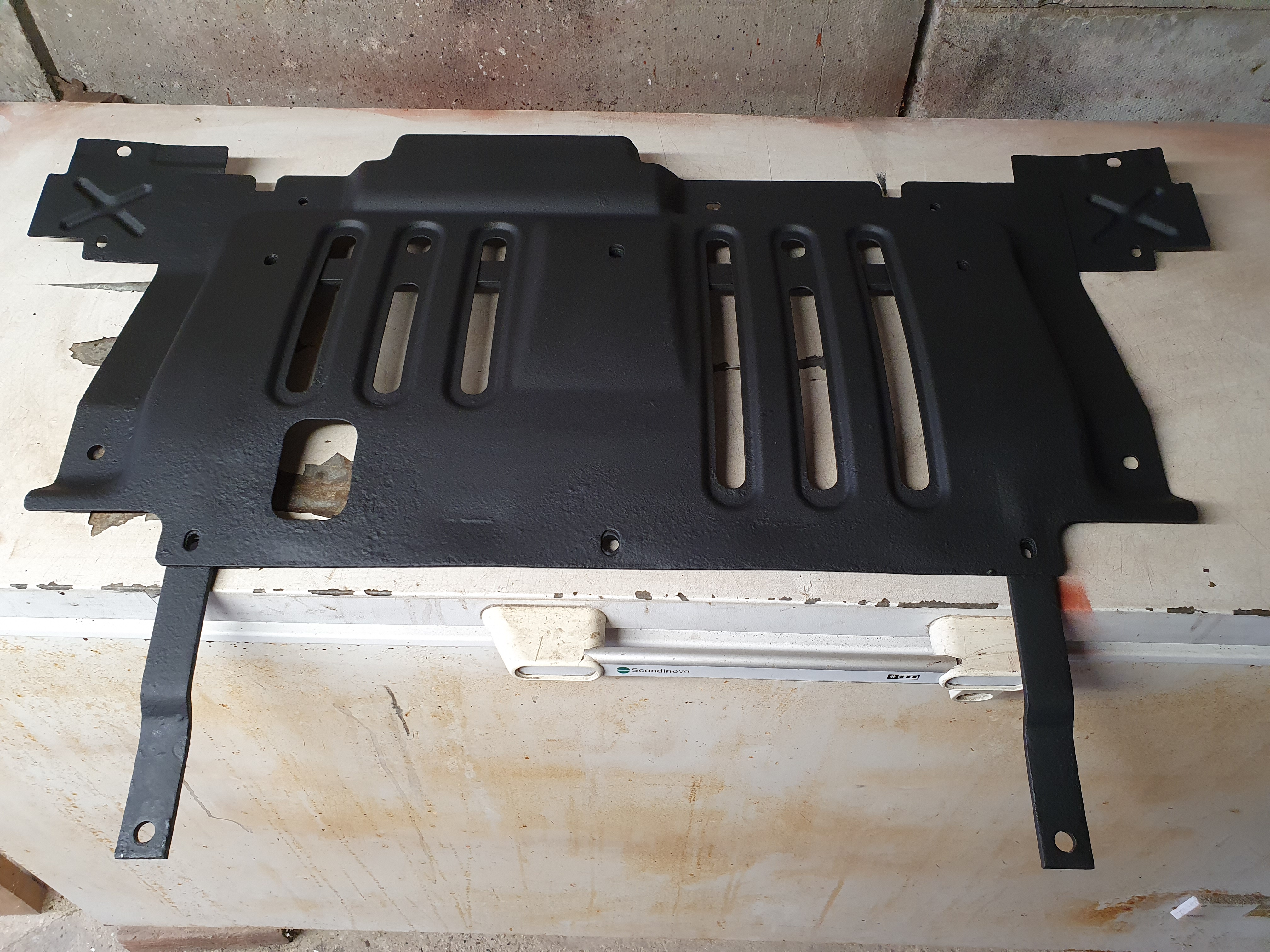

I think folks need to look more closely at the shape of the sump guard. It is generally curved from front to back, as well as being 'dished' so that all 4 sides are sloping. This is an easy shape to press but more complex to fabricate by bending. The guard effectively has two parts in its structure: there are strong thick, flat steel bars welded together to make a frame which offers the overall strength, and this is supplemented by the tray which acts to 'slide over' obstructions. A tray formed just from sheet metal would lack the strength provided by that heavy welded frame. (The photos in my earlier post here https://www.fiatforum.com/panda-iii/486312-rusty-sump-guard-2.html?p=4588444 show these two elements...)
The guard is also shaped quite precisely to offer maximum protection to vulnerable parts under the car – not only the sump – whilst not reducing the ground clearance by any more than necessary. The front section has (on my diesel) a very particular section right at the front which protects a special, flat-bottomed-profile plastic section of the turbo ducting. I wonder if that section of duct is unique to the 4x4 (to allow for more room underneath)? You can see it in these photos...

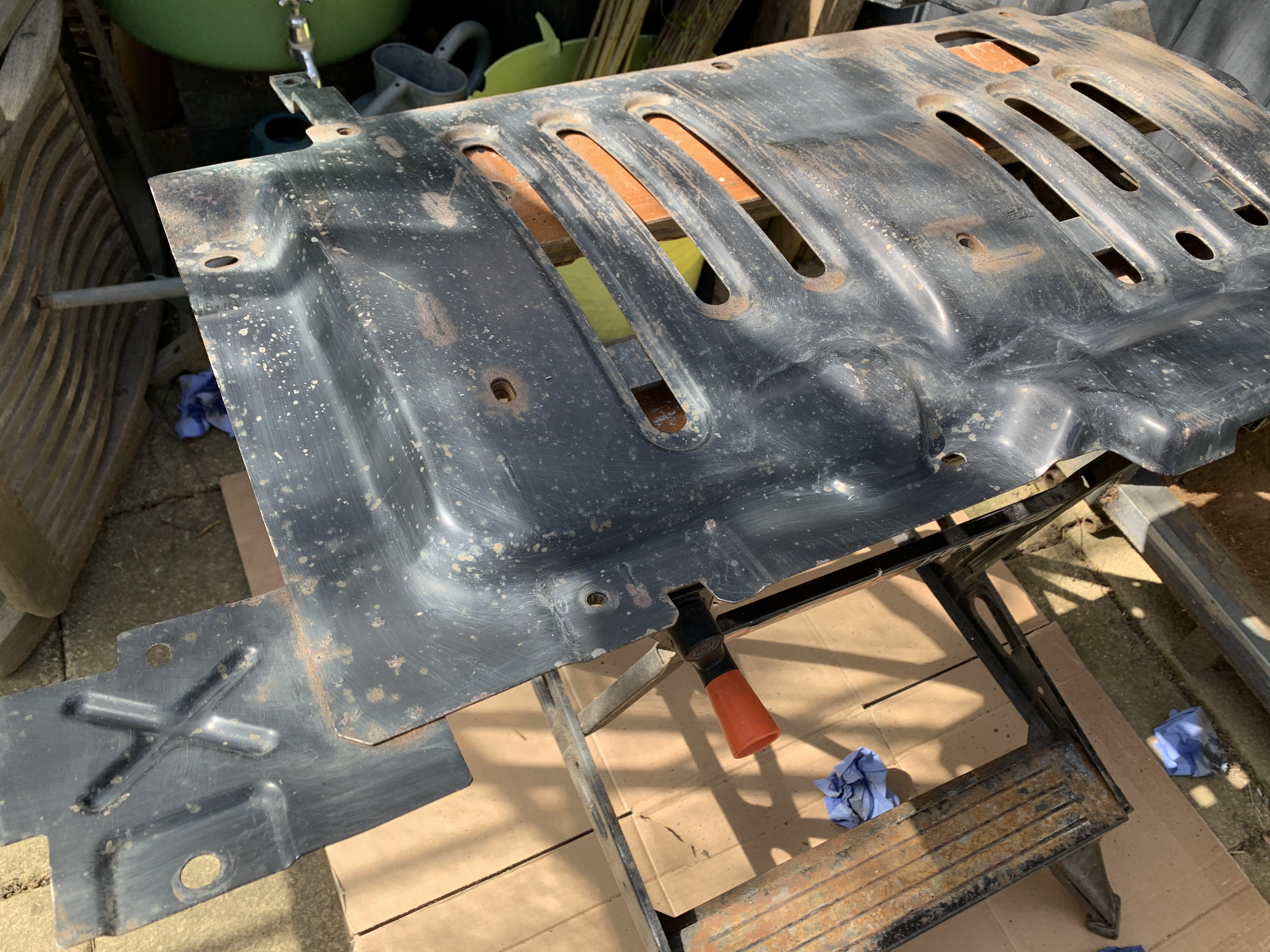

Hi all, sorry to bump this thread but after reading this I thought I'd take my sump guard off for a closer look.
It looked ok until I started cleaning it up. It's made of thin pressed steel welded to a frame. Without the frame it would have no strength for taking any knocks. Water and crud has settled between the frame and guard between the welds and helped it to rot. If I find a new skid plate, I'll have it galv dipped. My cross is a 17 reg done 55k

That's poor for a 17 reg.
Shudder to think what my 15 reg (which spends its life hammering up & down a muddy farm track) must be like.
