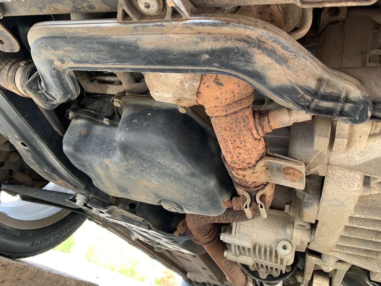

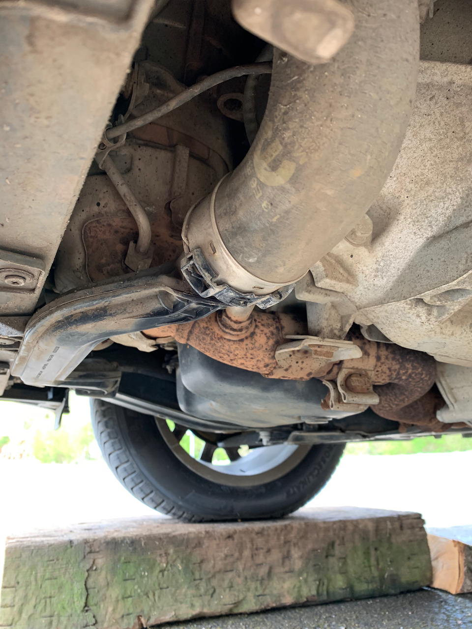

I think folks need to look more closely at the shape of the sump guard. It is generally curved from front to back, as well as being 'dished' so that all 4 sides are sloping. This is an easy shape to press but more complex to fabricate by bending. The guard effectively has two parts in its structure: there are strong thick, flat steel bars welded together to make a frame which offers the overall strength, and this is supplemented by the tray which acts to 'slide over' obstructions. A tray formed just from sheet metal would lack the strength provided by that heavy welded frame. (The photos in my earlier post here https://www.fiatforum.com/panda-iii/486312-rusty-sump-guard-2.html?p=4588444 show these two elements...)
The guard is also shaped quite precisely to offer maximum protection to vulnerable parts under the car – not only the sump – whilst not reducing the ground clearance by any more than necessary. The front section has (on my diesel) a very particular section right at the front which protects a special, flat-bottomed-profile plastic section of the turbo ducting. I wonder if that section of duct is unique to the 4x4 (to allow for more room underneath)? You can see it in these photos...

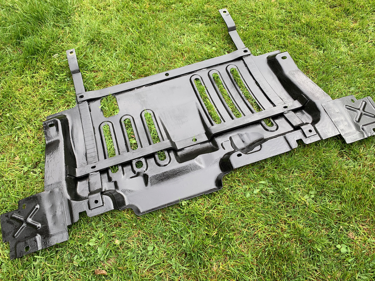

Hi all, sorry to bump this thread but after reading this I thought I'd take my sump guard off for a closer look.
It looked ok until I started cleaning it up. It's made of thin pressed steel welded to a frame. Without the frame it would have no strength for taking any knocks. Water and crud has settled between the frame and guard between the welds and helped it to rot. If I find a new skid plate, I'll have it galv dipped. My cross is a 17 reg done 55k
I'll put some pics on.

Hey Rosco, dont know if its any help but see my thread on sourcing a new one. Herts and Lunchbeers did some great work tracking down the part number for the twinair one. Will update on the quality when mine is received.
Many thanks artonic, I'll keep my eye on it.
That's poor for a 17 reg.
Shudder to think what my 15 reg (which spends its life hammering up & down a muddy farm track) must be like.
Still, out of sight, out of mind...
