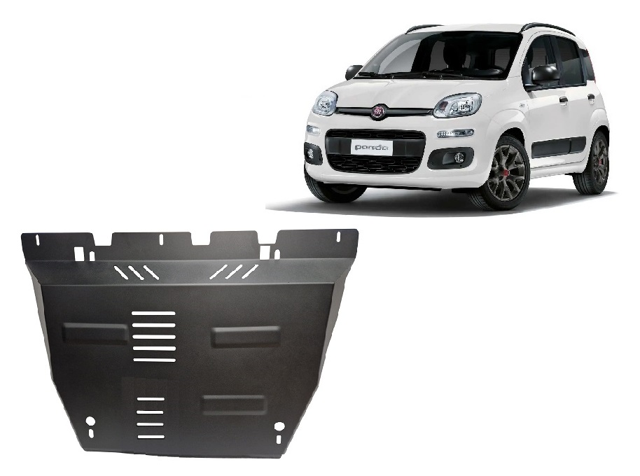

I'm going to have a look and see if it could be maybe blasted and coated (I have a tame powder coater) or whether I need a new one. New ones seem to be thick end of £400 :/ Would happily buy a used one if it was decent but I also saw this on ebay. It looks different to the original but I'm wondering if it might actually be better?
Ah, just seen this thread! Well, if mine is a goner (likely) I'll likely get one of these unless a decent used one crops up. Not planning to "off road" but might occasionally venture up dodgy enough tracks where knowing there's a guard there would be additional peace of mind.
There’s a British company that makes them for £150-200, the more expensive one has a removable plate to allow you to do oil changes without the need to drop the whole bash-plate
Technically, it’s a British company that supplies them but they’re made in Romania. I don’t know if that means any import duty might have to be paid. They also reduce the ground clearance a little owing to the more boxy shape. But, they do look good.

Ahh right, there was some being imported from Poland and Lithuania but both stopped after brexit…perhaps they took over!
