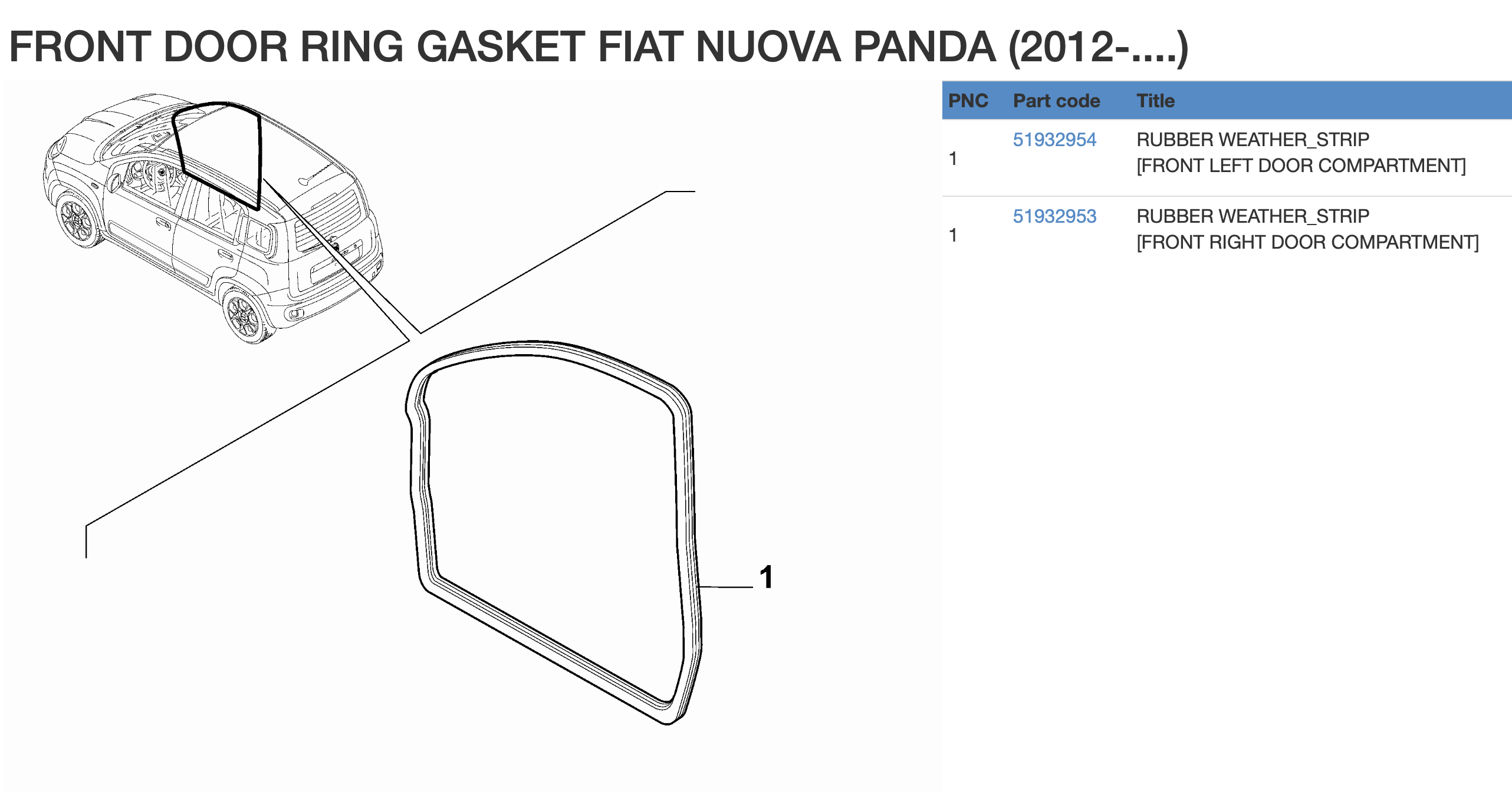

The genuine fiat part is one continuous loop and therefore are handed (different for each side of the car). The autodoc seals are just standard profile seals so you will have a joint. If you are going for a standard seal, the best and cheapest option is to buy a length form a seal manufacturer - plenty on-line. Just look at the original profile of you seal, match it to the pattern on the website then order the length you want (always order a bit more than you think you need.) I've done this for many different vehicles from 1950s to now, worked every time. In the meantime I'll try to find where I bought my Fait door seal from ....
Just typed "Fiat Panda door seal" and this (and many others) turned up on e-bay. Gasket Door Front Right Fiat Panda Cod. 51930236 New Original £44. There's loads out there.
Couldn't find ware i bought mine but pretty use it was e-bay. And yes it was genuine. Link below? but just noticed it's in italy!!
Here's the genuine part's part numbers... and (as mentioned above) note they are a very specific shape which you are unlikely to match with a strip of 'generic' material

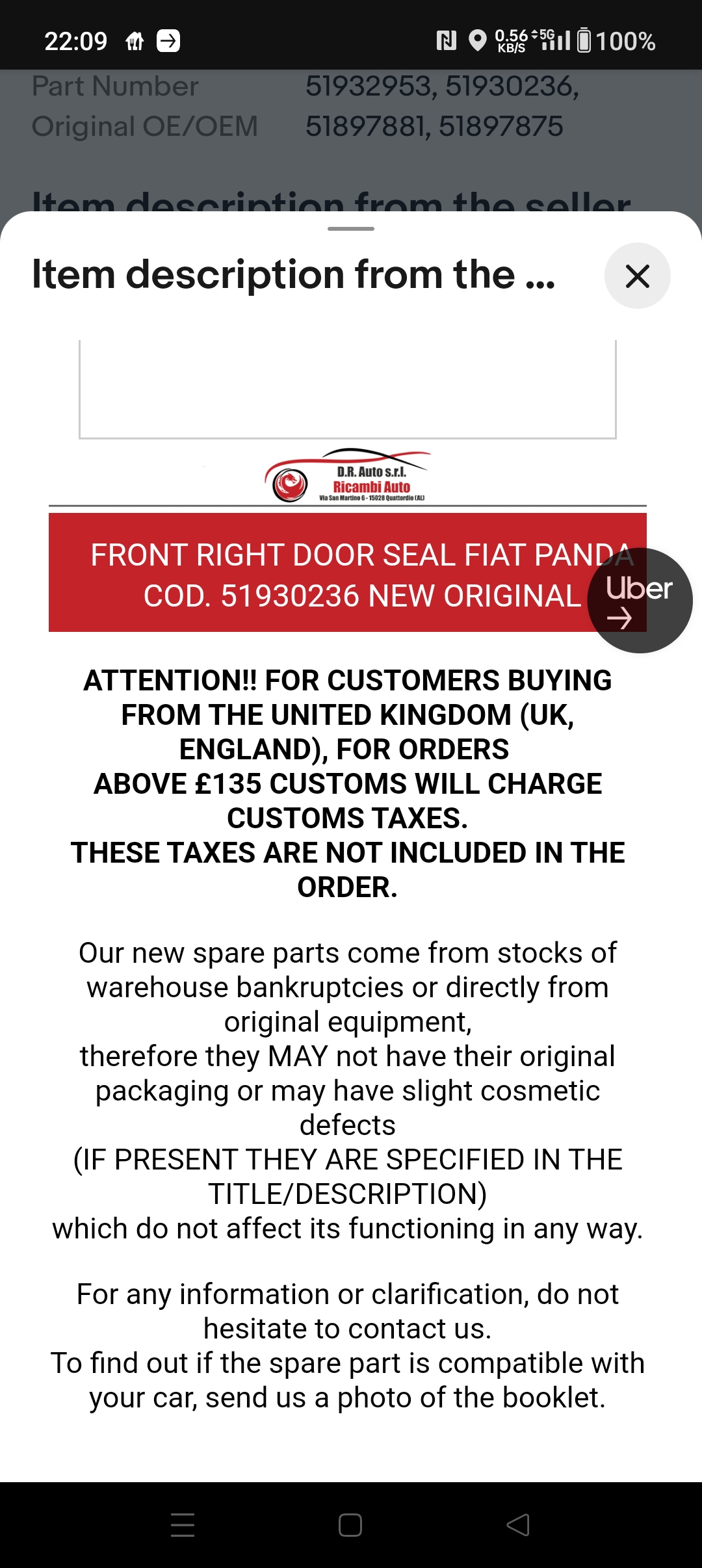

Thank you guys for these super good last three replies. I think my mistake or rather not knowing i had to add gasket to the search wording. But again obviously we need to import a lot. I will ask them if it fits my car. Its Fiat Panda not Fiat Nuovo Panda just saying. And i attach what the seller chosen by lambou stated on his ebay page about these door gaskets
The seller needs the VIN number to confirm but I can not find it anywhere! An I blind where is it? I had changed the driver side door a year ago has it been there by any chance? How to find it?
