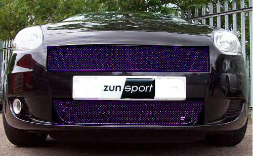

then the choice of grill (got a quote for powdercoating by a place near me).
Do you know whats involved in a powdercoating process, did you tell them it was a plastic component?
The grill is non metallic so........making the powder stick will be difficult as it wont hold the strong electrostatic charge needed to attract the powder and more importantly......whats going to happen when the plastic grill goes in the curing oven at the 180-200 degC required to melt and fuse the powder?
http://www.plasticcoatings.co.uk/electrostatic-powder-coating.html
Has your company got some special process for powdercoating plastic parts or, are you just talking BS again?

Nope the grill pictured (one I'll be buying) is stainless steel. Hence the powder coating.
The way I now read it its the SS one he intends to powdercoat not the original plastic, one which as we all know is almost impossible to do.

the grill im refering to is the zunsport grill which is stainless steel and it is this that i intend to get powdercoated. grill as below:
http://www.zunsport.co.uk/product.asp?id=57

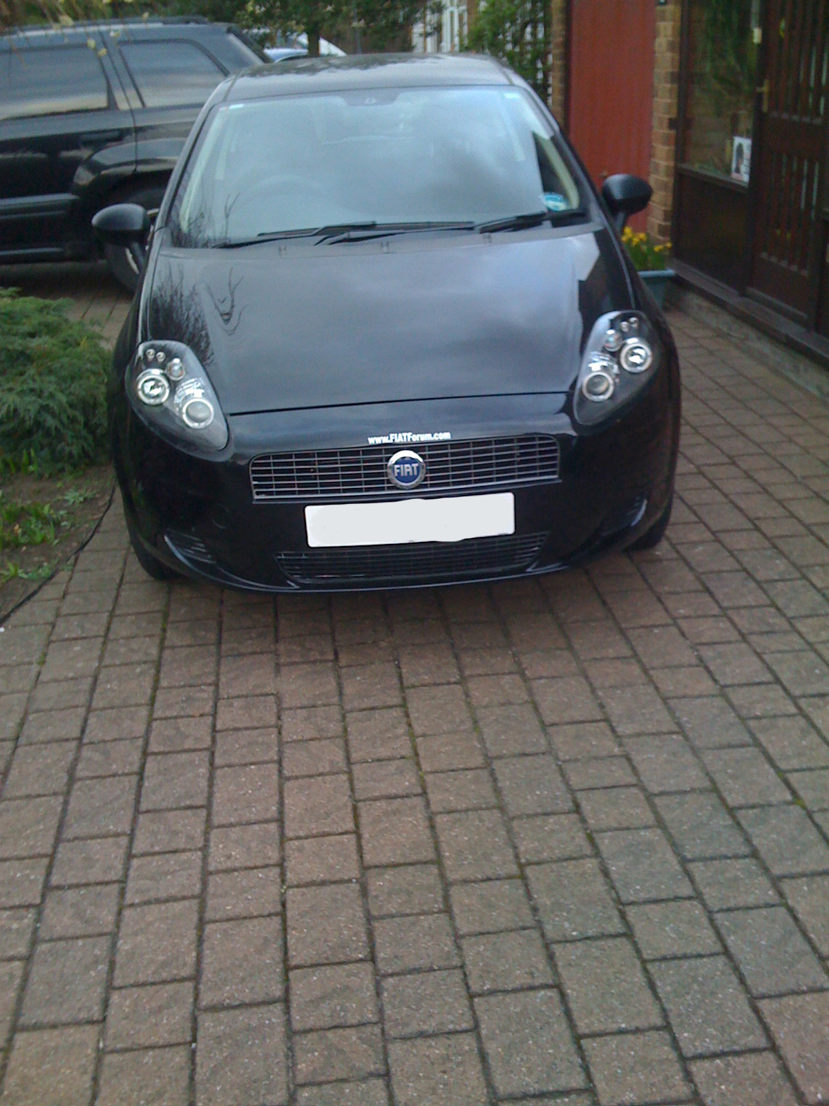

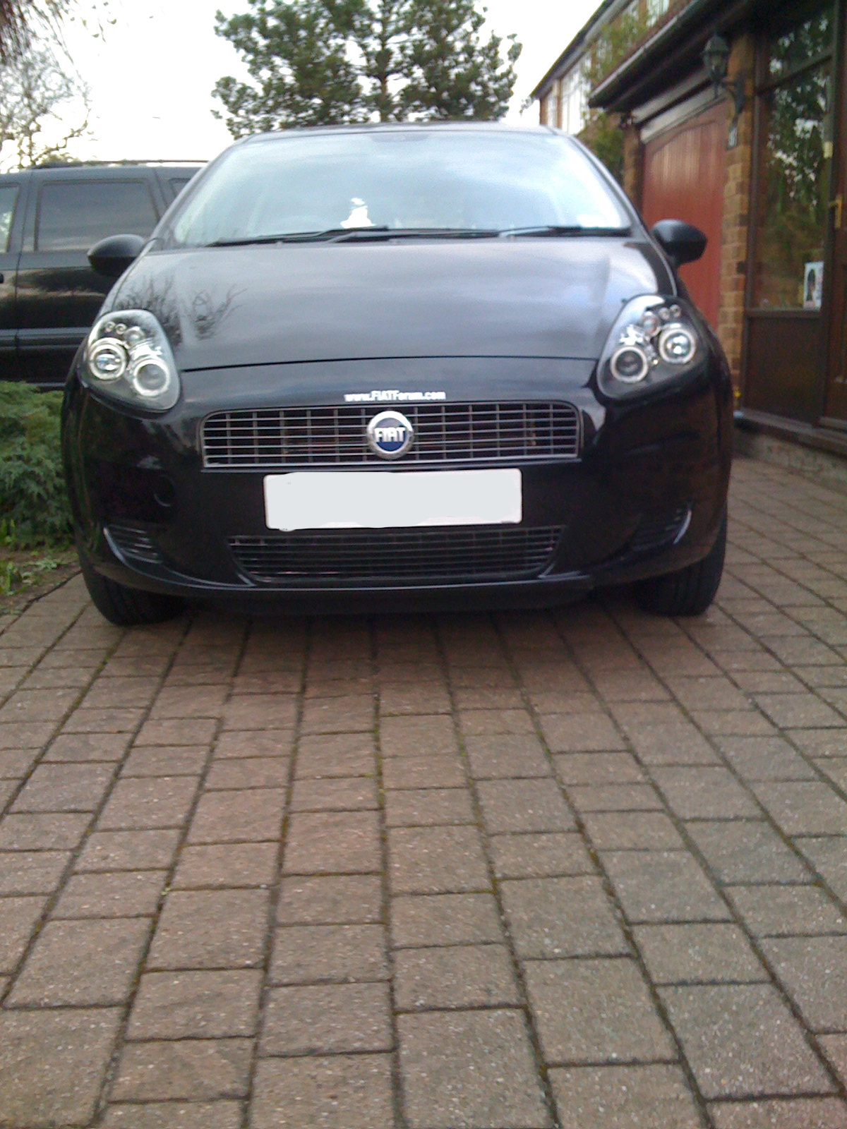

on the subject of doing mods my angel eyes are fitted and working. will need aligning tonight though.
