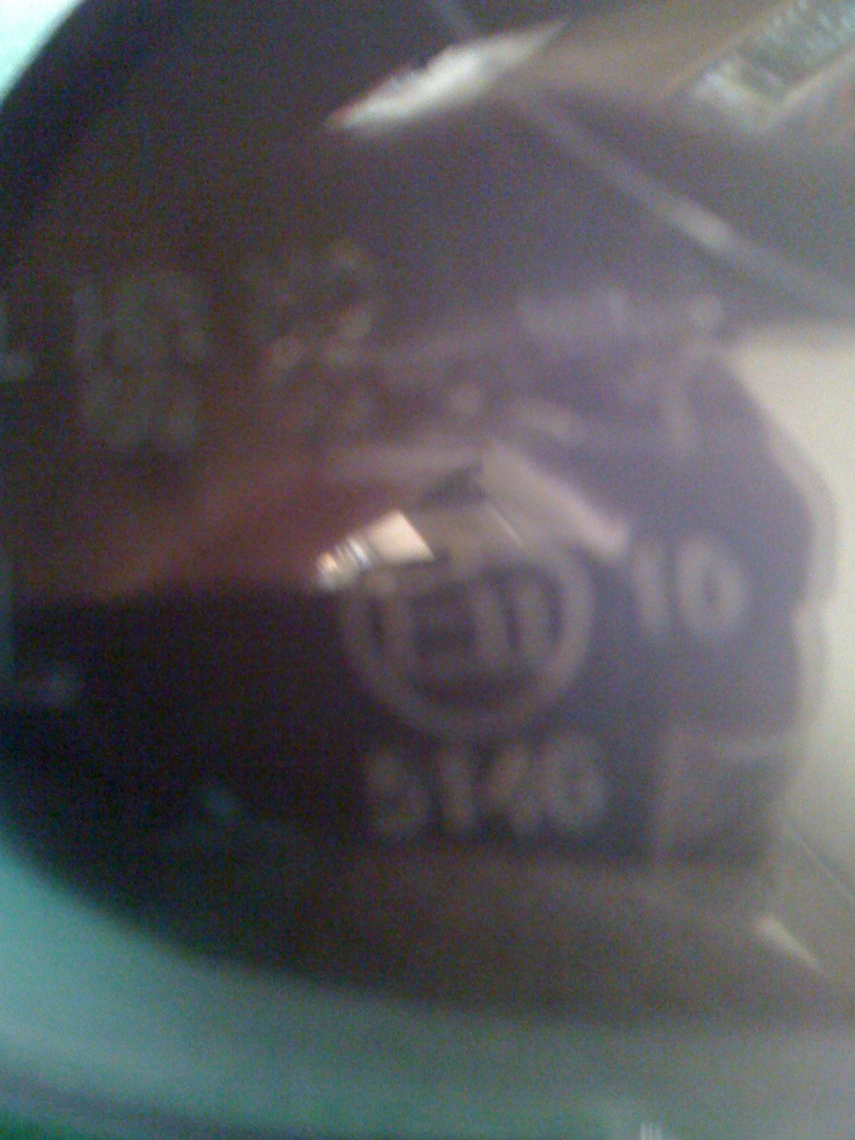

and have managed to find multiple ebay listings and websites refering to them as e marked but no further information.
any ideas as to where i can find this information?
The answer is in the question. Have you looked on the light assembly itself? you are looking for.......would you believe an E-mark...thats a letter E in a circle moulded into the plastic in a visible location. Look at the standard headlamps for an example. It means the component design has passed the various type approval and Electromagnetic compatability tests required by European law.
No E-mark means the part has not been tested and its compatability with other parts is unknown. It is an offence under construction and use regulations to use a non E-marked component on a vehicle where the regulations apply to that part. Upshot of using non e-marked components is you may invalidate your insurance, you WONT pass an MOT and if VOSA or a clued up traffic cop catches you your arse is toast.
If you have bought them cheap from some lying ebay trader chances are you have been ripped off.

you mean like so: IMG_0133.JPG
sorry for the poor quality pic.took with my phone plus trying to take pics of clear plastic is easier said than done.
