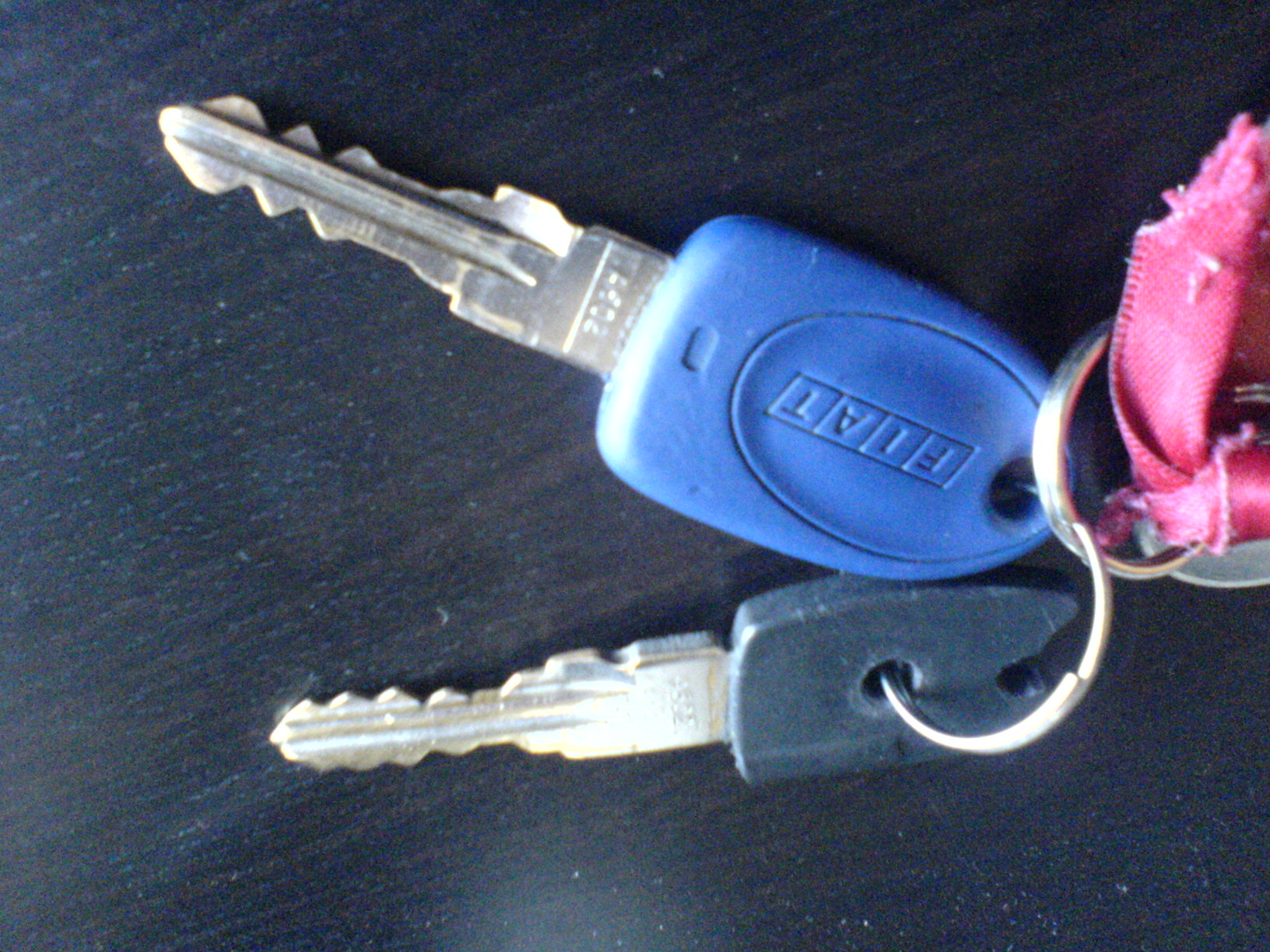

When i got my punto back in 11-2005 the only keys i got was a black & blue.
Black fits the ignition & blue to open the doors.Have got a Punto 60sx (date of registration is 31-03-1998) do i need to get a red key. where can i get it how much will it cost.

DenWestie- You dont need a red key, but you do need to always have a copy of your ign key (at home). The black key you have looks like it may not have a transponder in it?. Could be the immo is bypassed. Take it to locksmith and have it checked, if there is a transponder in there, then have a new key cloned/copied.

Patch124- Just order up a pre-programmed blue key (any code), probably cheapest from locksmith or e-bay for £10, and use your red key to introduce the blue key/s, using the normal procedure.

Cheers Tony ill let the locksmith check that out for me.
