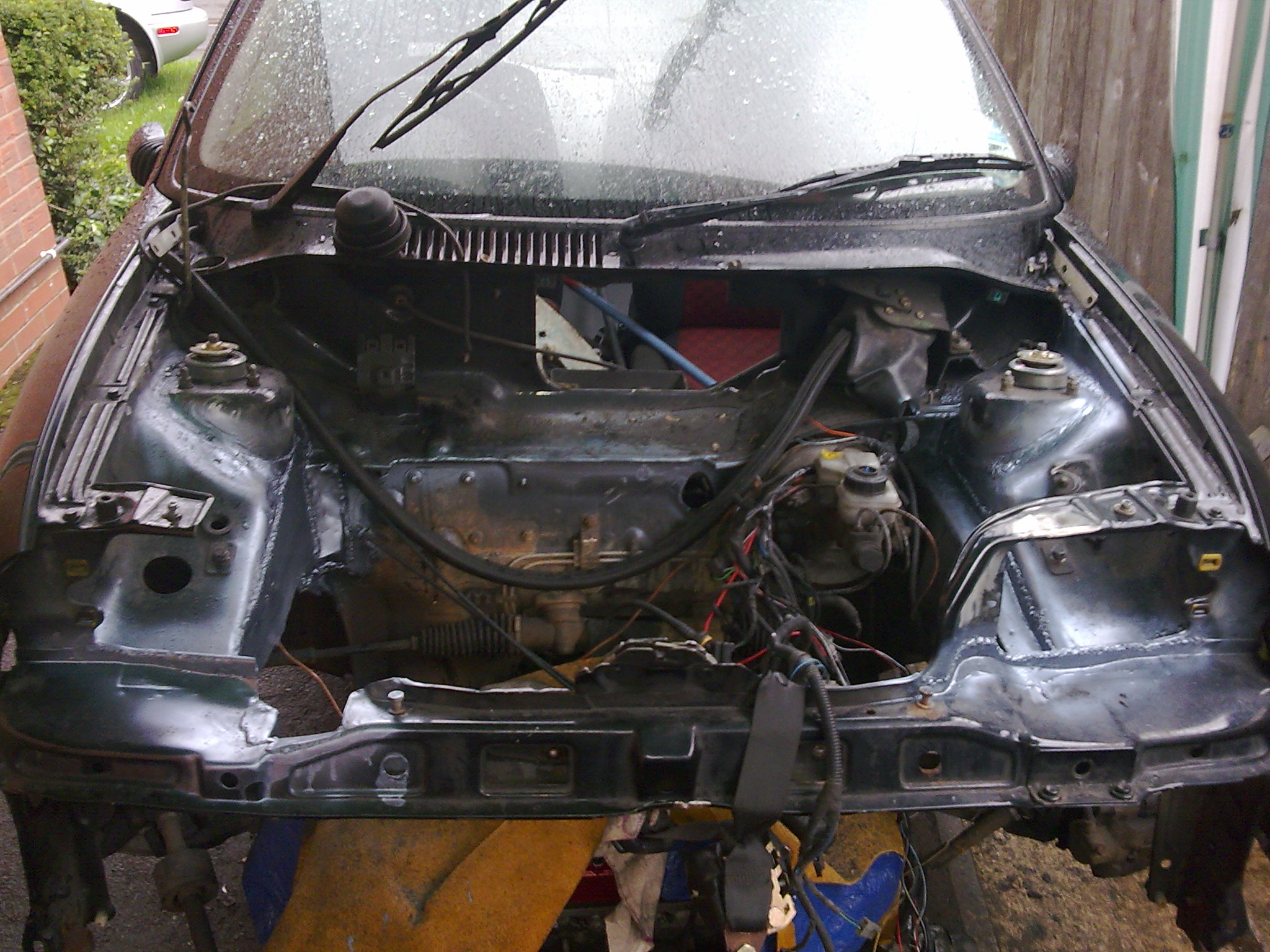

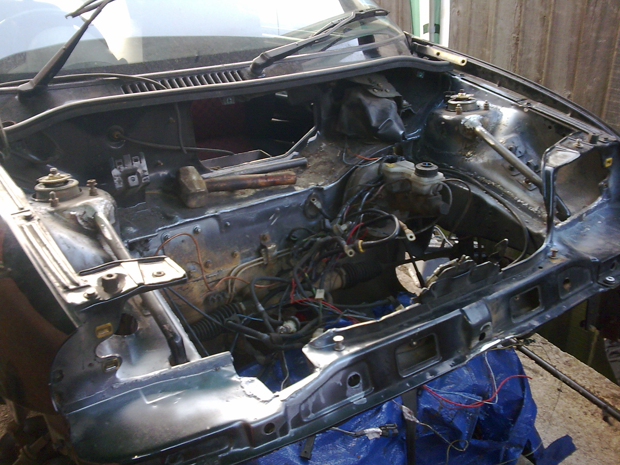

So far the car has been gutted, and im in the process of cutting out the wiring i wont be needing.
Im off on a 300 mile round trip tomorrow to pick the engine up, and then the battle of fitting it in will begin!

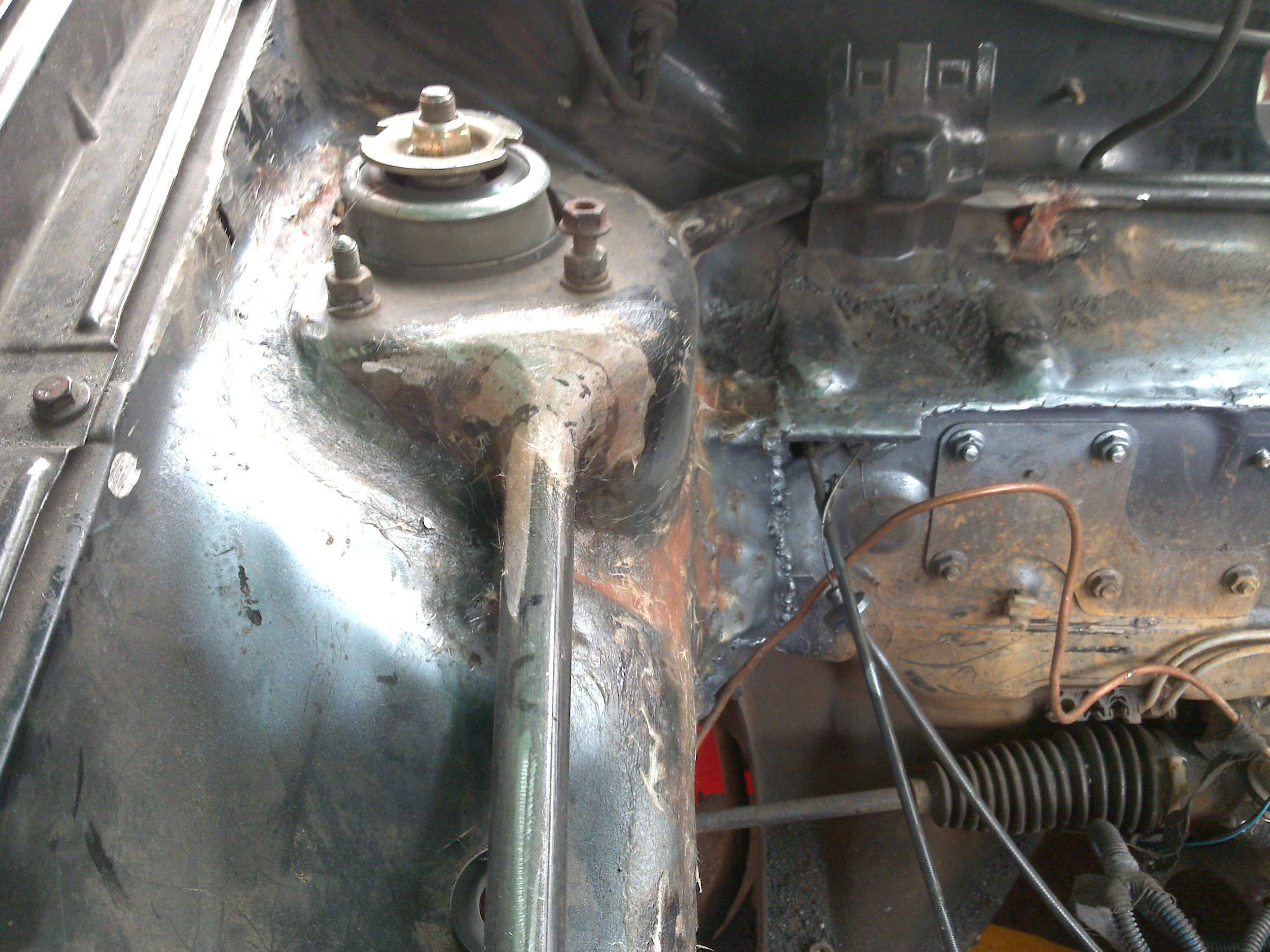

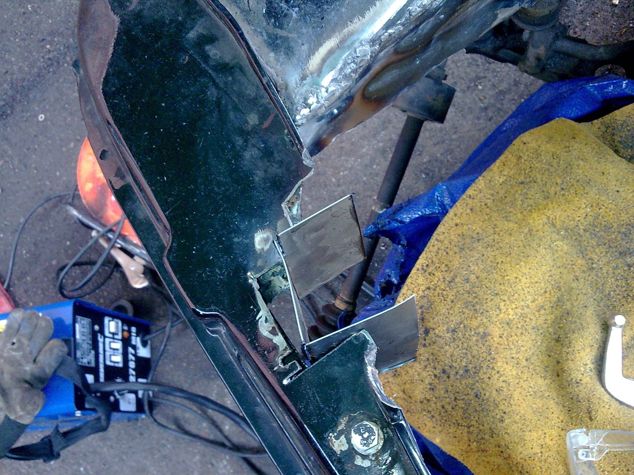

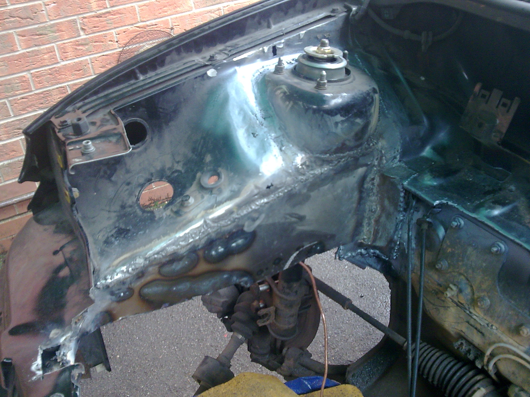

Today i realised the fiat is made out of paper rather than metal... the engine bay metal is paper thin, and my welders kept blowing through most of the time... sorted it out by using a really low amp welder, although had the odd blow through... The welding is strong but far from my tidy welding... its been a bloody nightmare.
Ive built a new left panel, and replaced it with some new metal.. its stronger than it was, but obviously not as strong as when the horn was in place...

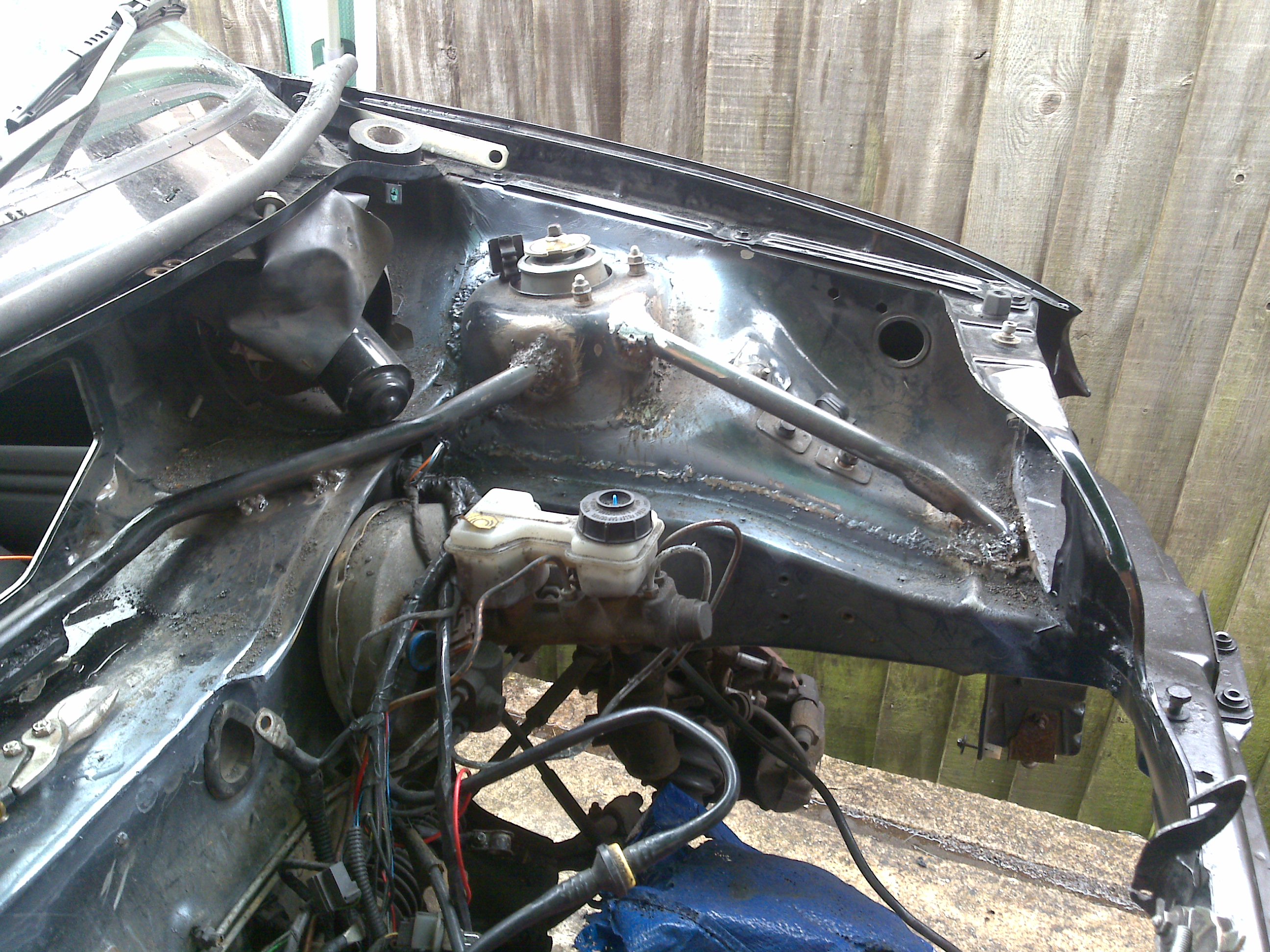

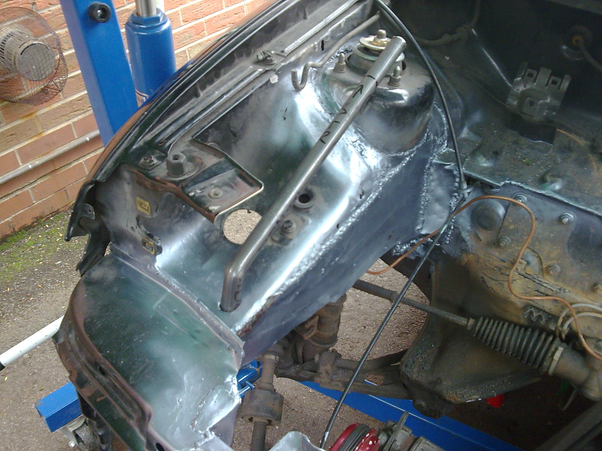

Tomorrow i will start making the frame, this will be welded to most of the existing metal, and will get the car a lot stronger than the original set up...
Im far from finished, still got a lot of welding to do... :(
All the engine bay will be smoothed/filled for a factory look when done... il keep the post updated...

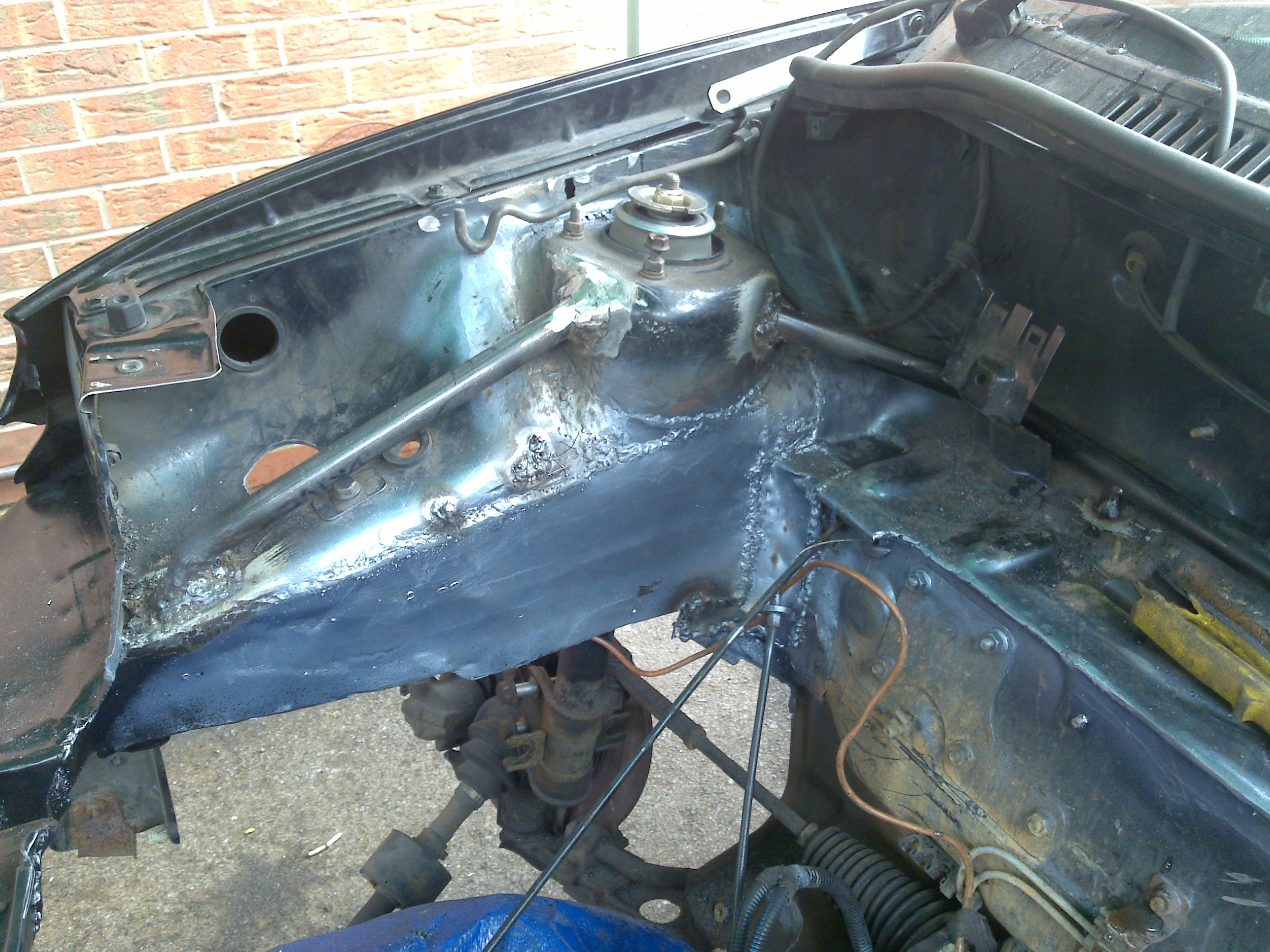

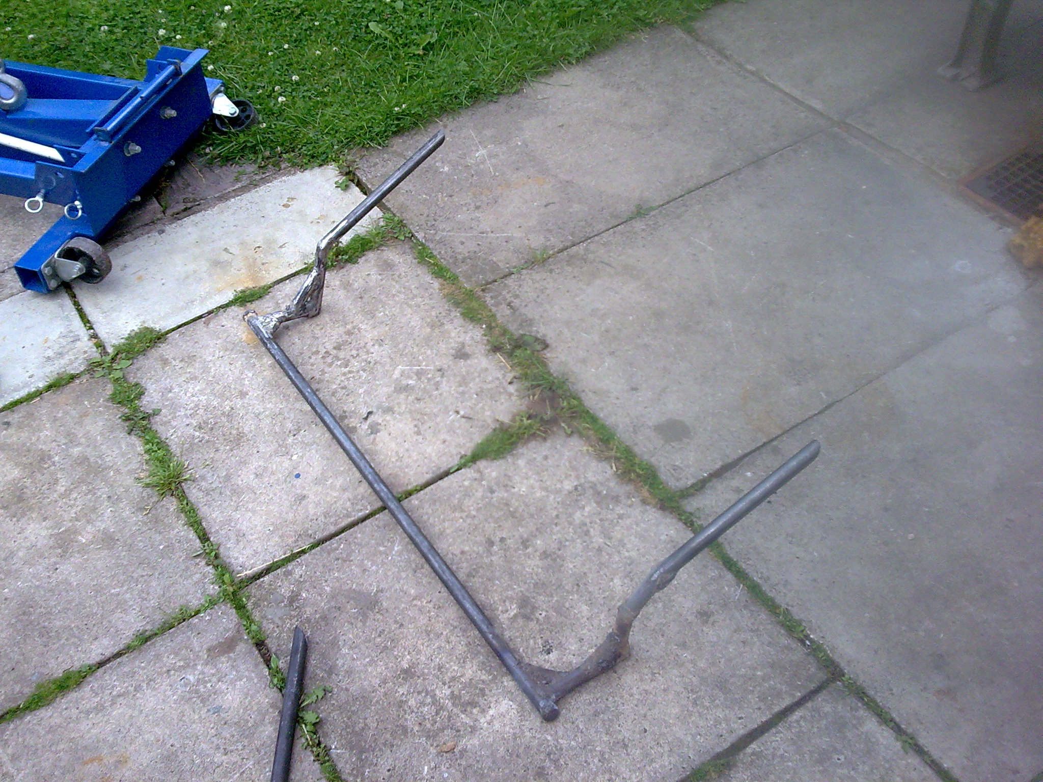

Been busy building the frame.... got a third of it done, still need to get the rear and the bottom supports done....

After another 4 hours of fun today, i have the rear part of the cage/frame made, and have skimmed a lot of the bay with glass fibre (or p40 as most people would call it).. This is due to me wanting to smooth everything down the line, but i want it to be 100% cured before getting the filler out.
I still need to crack on with the mounts and the bottom half of the frame. This will support the front bar (which runs under the main front panel) and connect to the rear bulkhead. This will need to be fabricated once the engine is in place, and i have the drive shafts to hand, as i need to make sure the cage clears EVERYTHING!!
