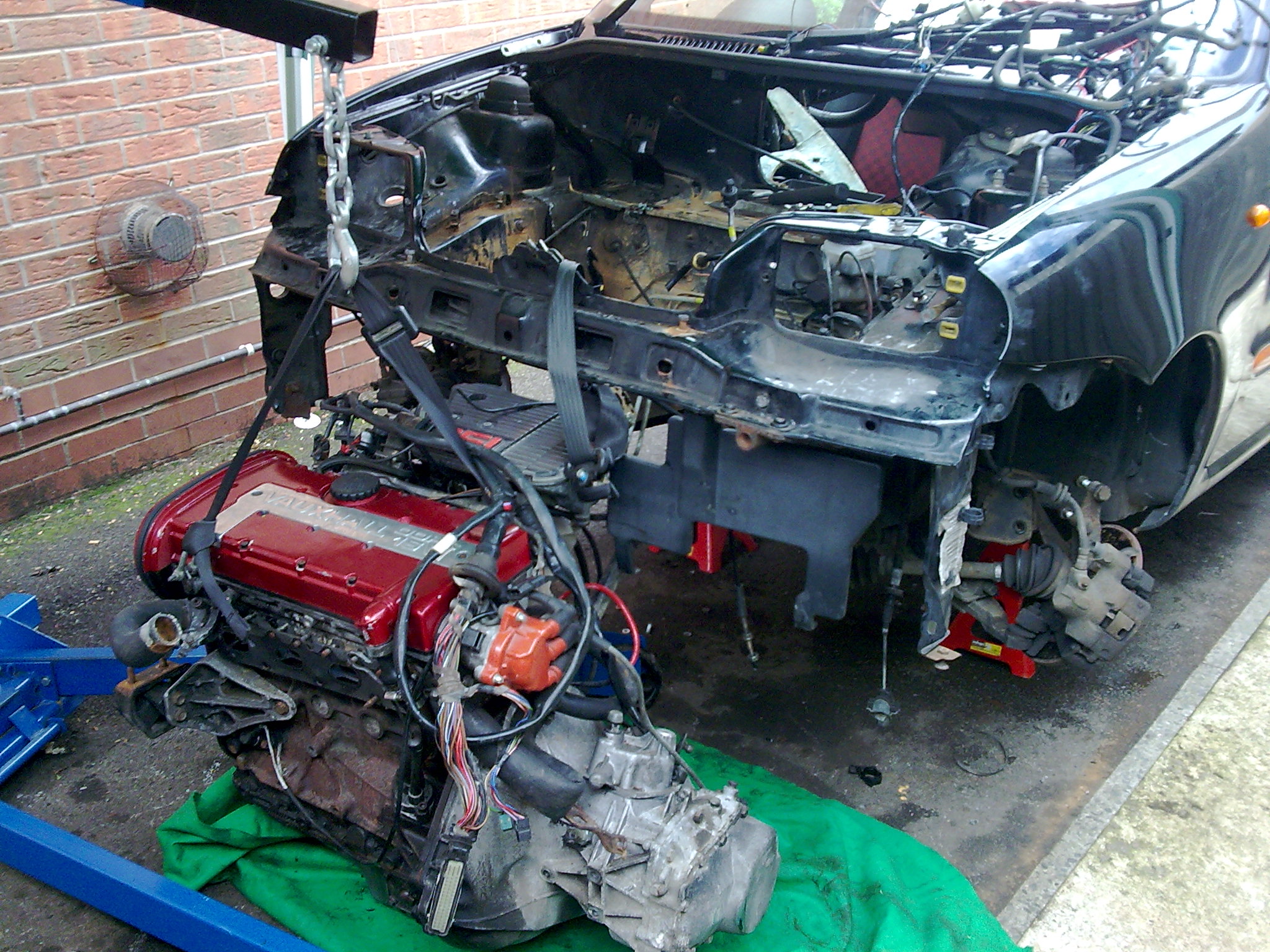

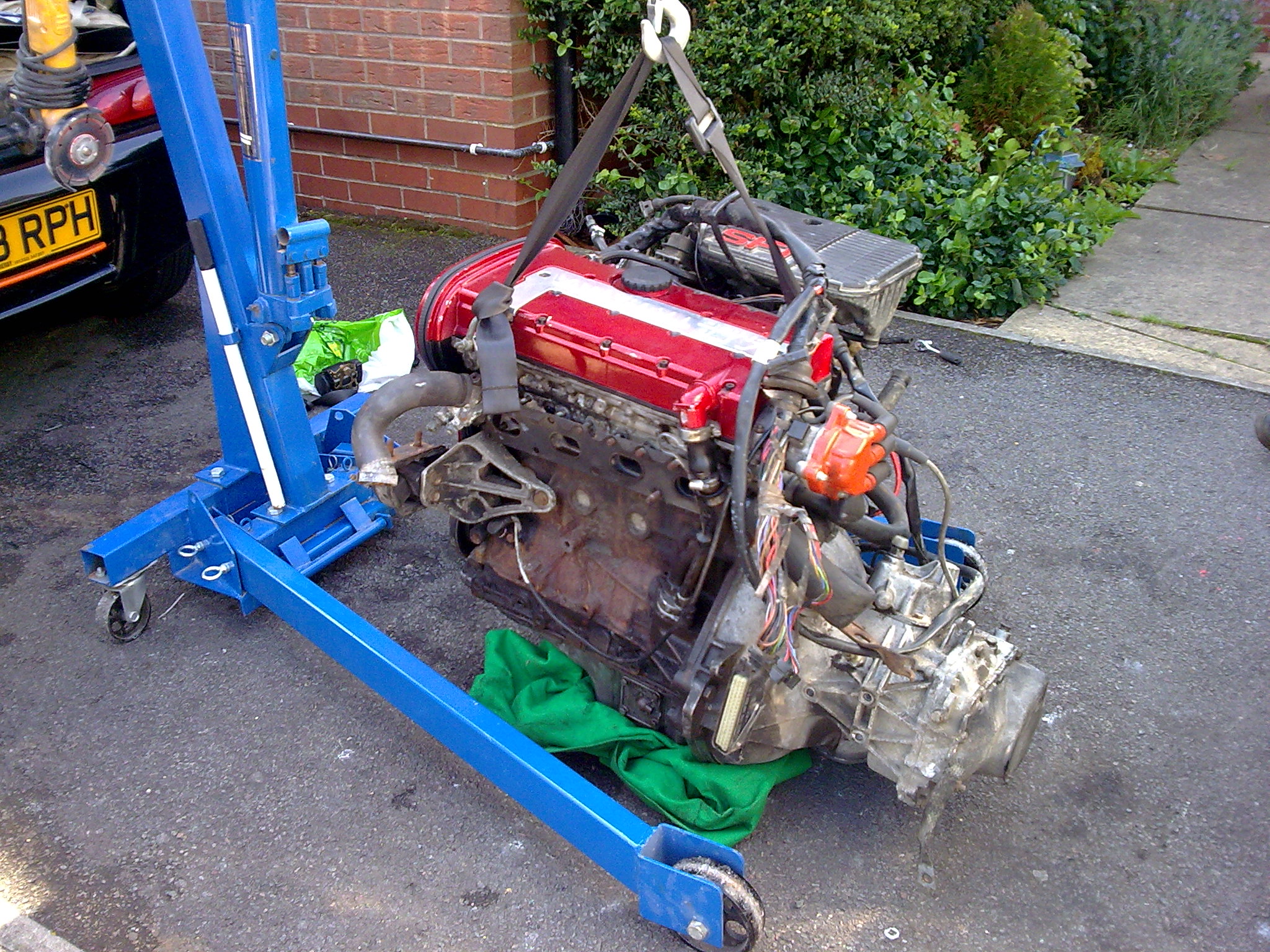

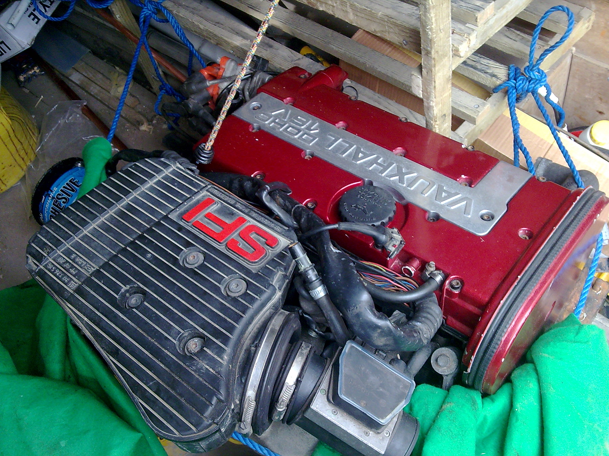

Just a quick update... managed to sort the engine out, although this is still in my friends gas works van (naughty)... and im trying to get hold of an engine crane asap... Also collecting the dreaded shafts tomorrow, some nice 300bhp ones, and seeing what can be done with them (if anything)... If i can get a fiat / vaux combo going il be happy, if not it might just have to be custom jobbies...
anyways heres the engine.... Its missing a few bits like selectors and the odd sensor here and there... Going to sort out a huge service as i wont be able to get to most things with the engine in place (eg cambelt, water pump).

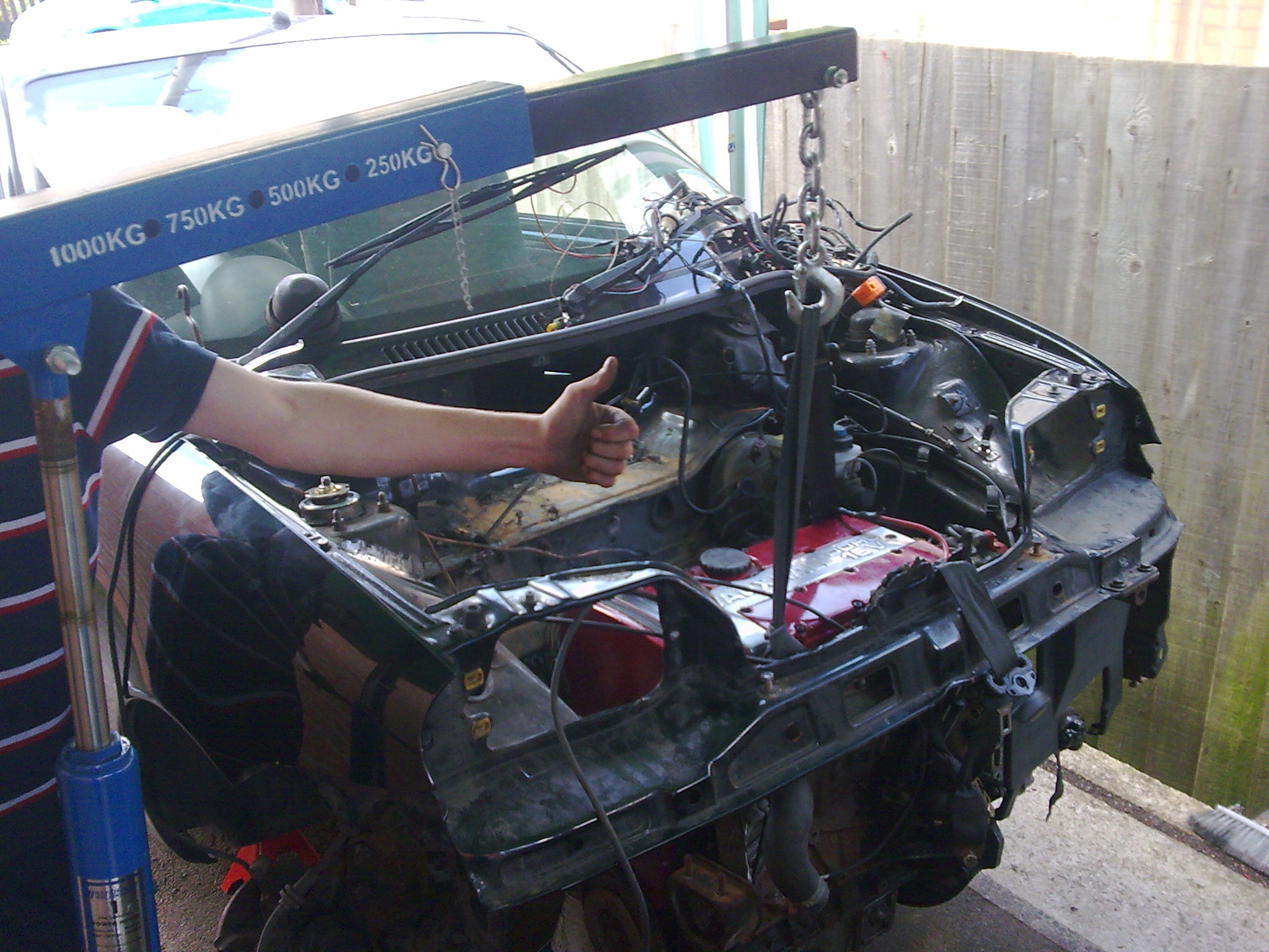

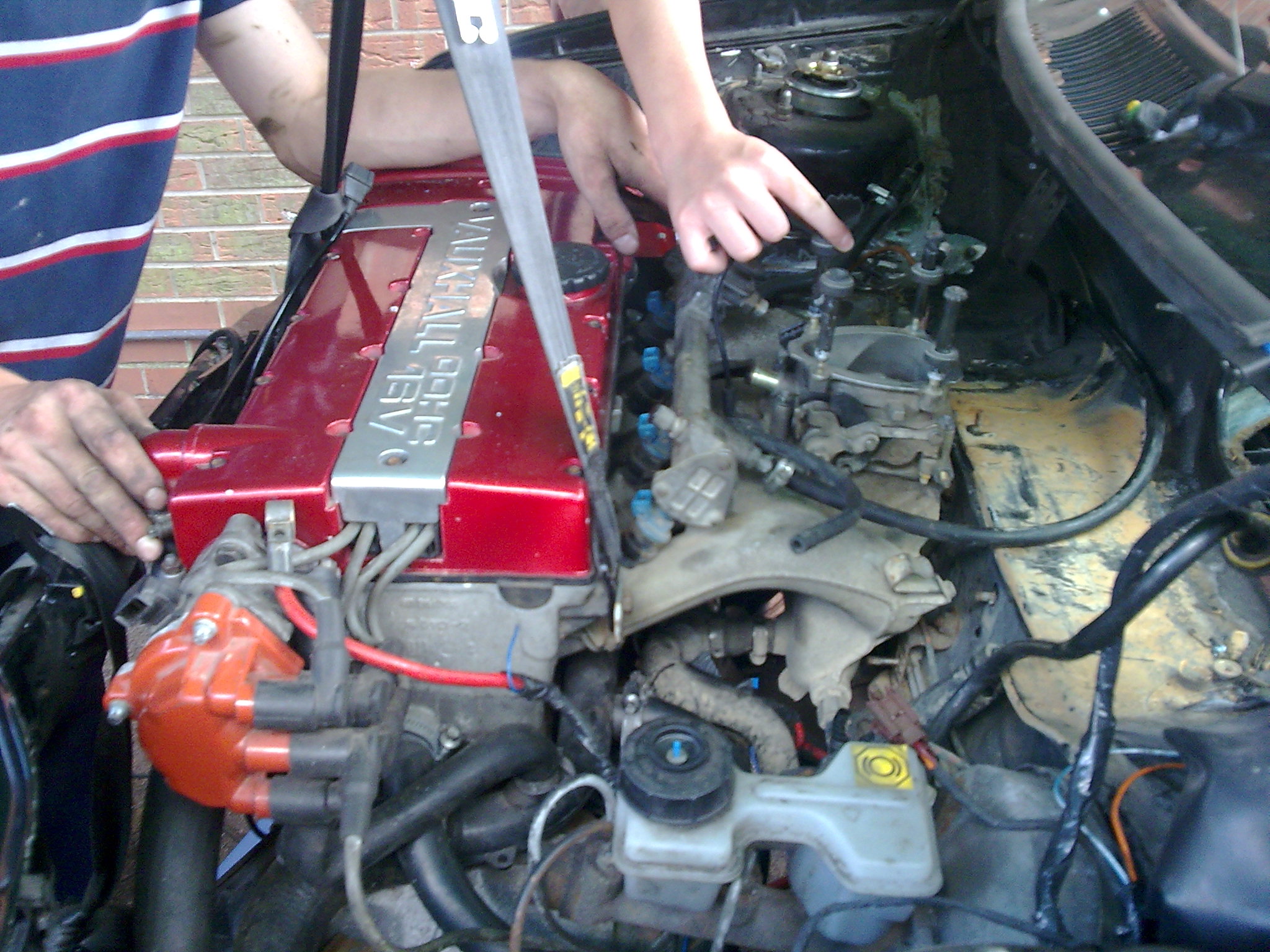

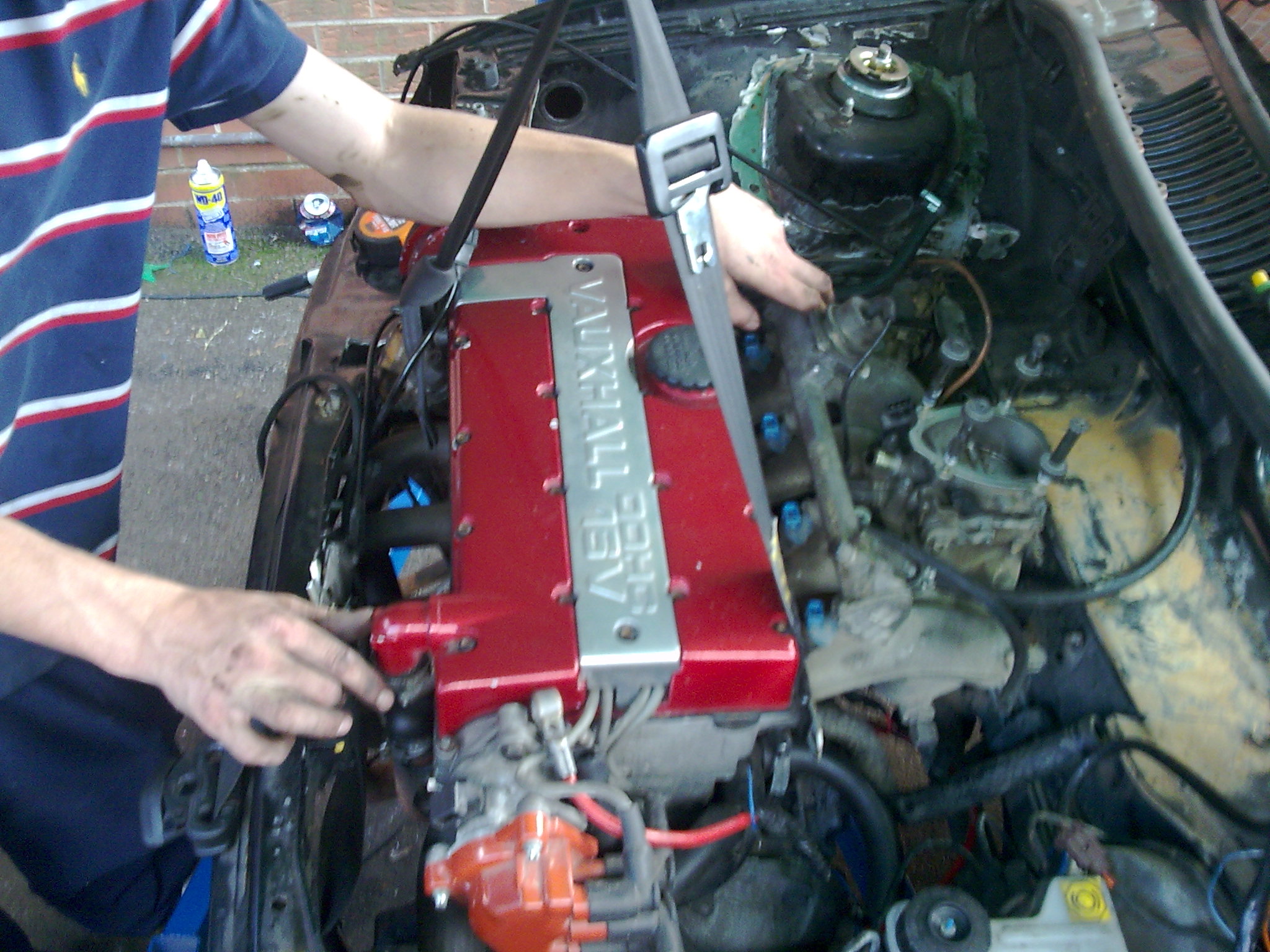

Big update as such for today.... We now have a fiat that can house a 2.0 16v... Theres a lot of structural work that needs to be done, as you will see over the next few posts, but for the moment we have been just cutting away stuff to get the engine to fit...
The shafts line up, and by the looks if it we can get the gear linkages to fit (internal cavalier shifter)...
Anyways heres a few pics... (were only in the basic stages yet, and will be making the car solid again)

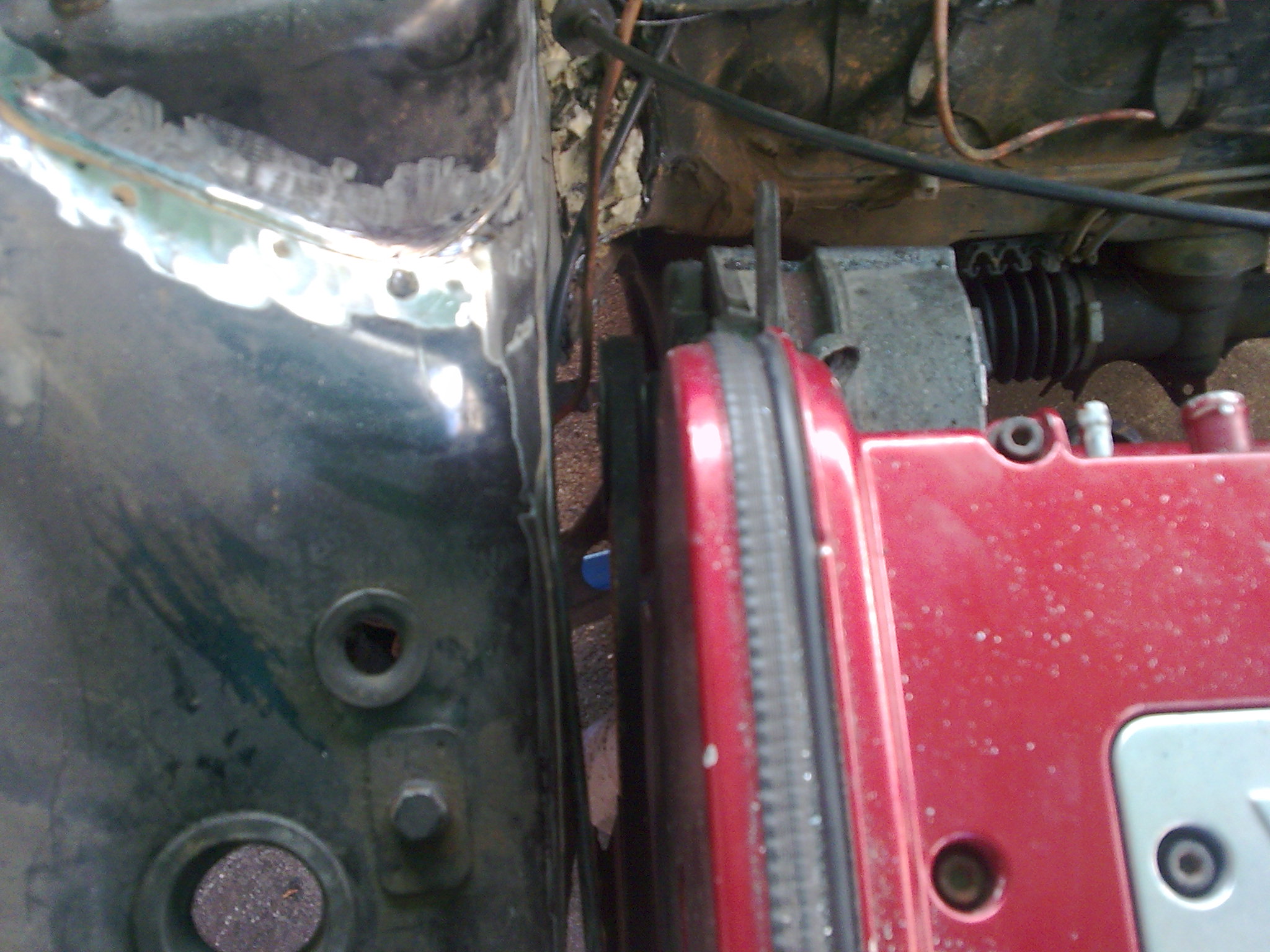

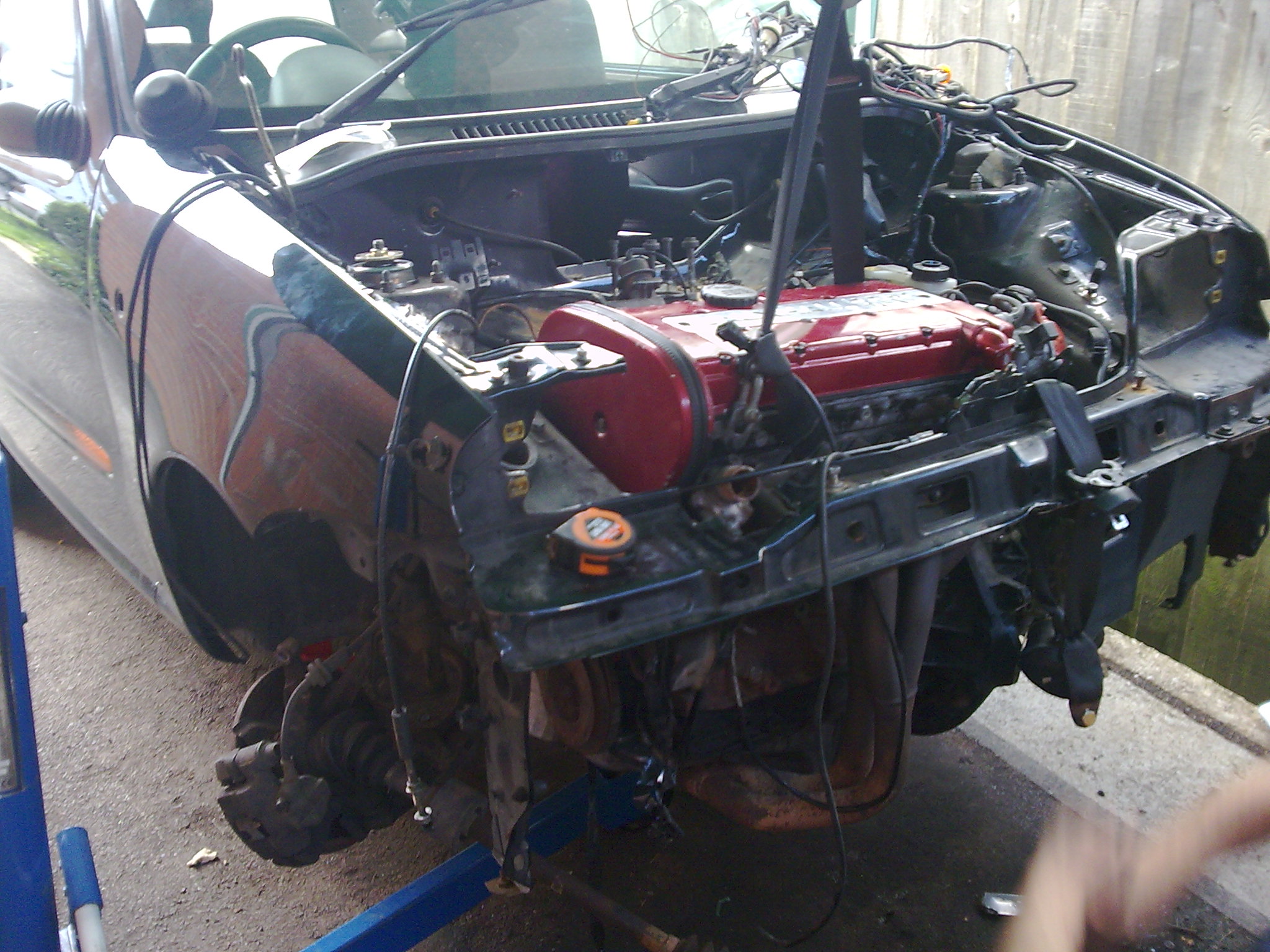

we have had to cut away some of the front panel as you will notice, which may cause an issue with lights, but were not worrying about that at this point.. were just more concerned on getting the engine in and running....
Its not the easiest fit...
So far we have had to remove the drivers side horn section, removed the rear lip on the bulk, and had to trim a bit off the part the lower passenger side lower arm is attatched to...
All this will be welded, and there will be a new bar fitted across the front for extra strength. We will also be adding the strength back from the horn section with extra frame work using 21.5mm tube with a 3mm thick wall.

From what I've read an oil filled redtop + gearbox is about 180kg. Thats comparable to other mass market 2L engines of the 90s.
Does anyone have any info on what the 1108 FIRE + box weighs? - ETA Found a linky (on this very forum!) to the FIRE 1108 weight ~110kg for engine and box, and the box weighs about 35kg.
So that means you're adding about 70kg to the car in front of the front axle. I think you're gonna need some weight in the back end to bring the handling back in line.
