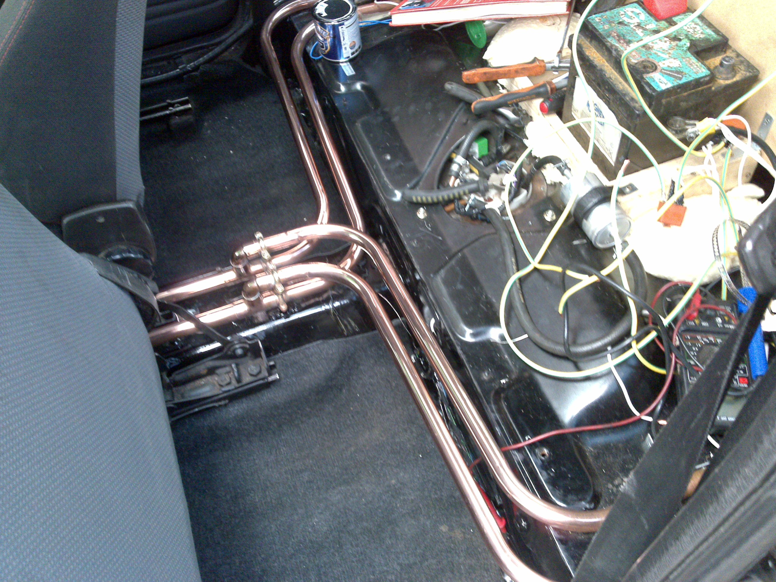

With regards to vents, you need one on the top of the tank and on the filler. If you only vent the filler, when the tank is almost full, it will spit back when filling as there's nowhere for the air to escape, and also if filled cold, driven so it expands and then you remove the filler cap, you get showered.
You can run the tank vent up to the top of the filler neck though, and then just fit a vent on the cap.

ah this is good to know. Can i get away with fitting a T piece into the pipe that runs up there already?
Or break out the small drill bits and modify the existing cap ;)

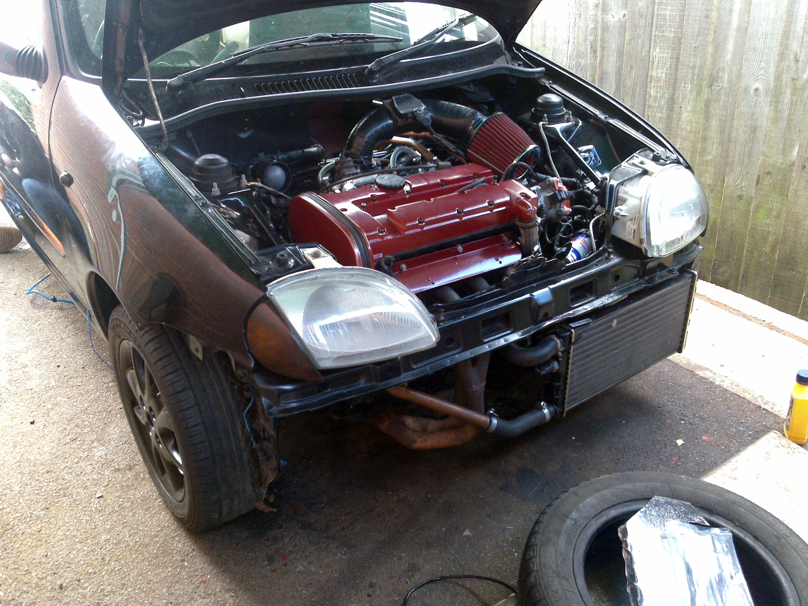

Had a bit of a busy one today....
Ive fitted in my cut and shut carpet into the seicento, which i think looks better than it being stripped out..
Ive also fitted the sporting seats back in place, and then attacked the pipework with some Mequiars NXT Gen Metal Polysh (as they spell it)....
I then went about removing the naff glass, and fitting the glass i had bought, and tinted myself a few weeks ago.. Along with new window rubbers... (i know the tint is really dark... supposed to be medium smoke, but it is under a shelter so looks darker than it actually is...)
Ive also 'T' pieced the fuel tank vent into an existing pipe (which i think is possibly a vent thats under the filler cap itself for the spilt fuel...) and will be trying to locate a vented filler cap asap...
The only other major thing ive done is fibreglass the rear of my headlight (3 layers of matting).. and fitted into place.

Loving the red colour of the block, whats the plan for the front, will the bumpers still fit?
Lol cheers, its a custom mix with Rover nightfire red (closet match to the seats i could get from memory) and a flick of silver metal flake...
As for the front, the standard bumper does fit.. although its been modified at the rear due to the rad, and ive had to loose the fog lights also, but other than that the car should be looking standard ;)
Just have the abarth spoiler and skirts to fit now :D and get rid of the orange bits...
Ive bought the abarth 14" wheels which are fitted at the min.... But then im trying to get hold of some 15" 6j MG wheels with a skinny 165 50 15 tyre for some sexy stretch on the tyres...
Ive bought some punto GT turbo brakes from the classified's section, so these will be fitted as soon as they turn up.
Hopefully the bumper won't get a bit melty... ;)
Is the beam from that headlight ok, does it look like you've cut a load out but it's really a little bit and you've matted the whole thing to make it stronger?
Maybe paint the inside of them black like Cinq sporting light units as a finishing touch, if you can be bothered with popping the lenses off - only the housing mind, not the reflector :p
Again, nice to see your project still going :)
