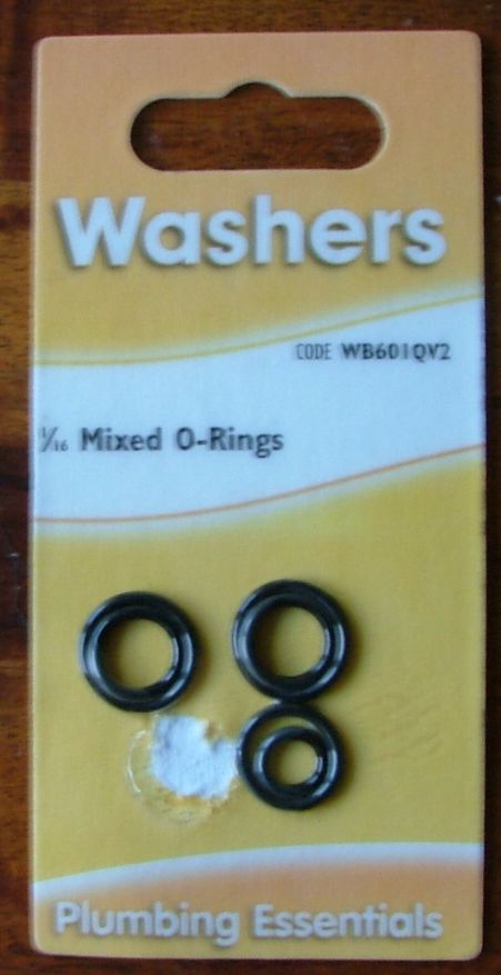

read the thread and ordered the replacement linkages as the linkage on the drivers set kept falling off. Whilst i waited i tried something else. I got some washers from B&Q (see attached photo) which cost about 99p. The one thats missing is in use; with the linkage in place, slip it over the bottom end of the spindle and work it up a couple of mil and its will hold in the 'cutaway'; basically the spindle's diameter is narrower a coupe of mil up - this has held for a couple of weeks where as before the linkage was falling off every 2 or 3 wipes.
Hope that helps.
M.
I used the same principle but with a thin ponytail hair band, last about 6 months. I also tried knicker elastic but that's far too flimsy :)
