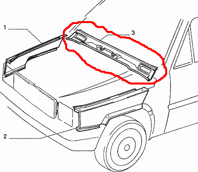

Scuttle pannle, passenger side
Rear tail gate
Rear tail gate is a write off, and the rest is going to need a lot of welding. Underside checks out with solid jacking points. Rear arches solid but have surface rust. Look better after a blast with the sander.

Scuttle panel removed
Photos to be sorted out soon, sorry for the some what ott list, its more for my reference as I know what i'm like with bits of paper.
I was happy with everything till I saw the mess under the scuttle panel
Im in this deep however I may as well crack on.
I have two options, find a panda non runner and cut the bits I need out of that, Or get my self a anvil and vise and make up some sheets my self.
All in all, PANIC!!!!
