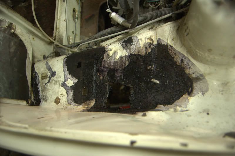

I was happy with everything till I saw the mess under the scuttle panel :eek: Im in this deep however I may as well crack on.
I have two options, find a panda non runner and cut the bits I need out of that, Or get my self a anvil and vise and make up some sheets my self.
All in all, PANIC!!!!

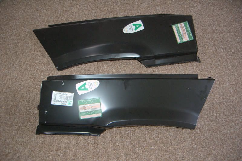

I made a few calls today and as it turns out one of the stockists for the body panels is VERY local.
So ill be off to collect some shiny none dented, none rusted panels tomorrow. I haven't gone OTT and have just got the bits I need for the time being to keep me going + I need to check fitment quality is OK.
Its like waiting for Christmas all over again!
I still need a complete bonnet though :(

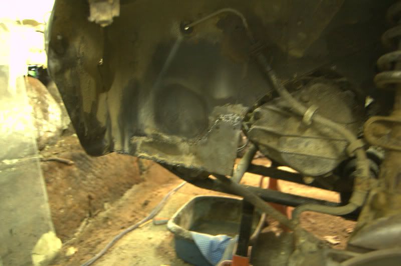

Today I have been cutting templates for bits of metal I need to reattach to the car!
Some more work today, patching up
Im getting better slowly but will be taking my self off to a course
So cut out the bad:
Put in the new:
Cut out the bad: (its a funny colour because of the rust killer, i then cleaned it up)
It plated, then a fibreglass resin to tidy it all up
Tidy welding in the front arch near the suspension mount. I had trouble with little fires developing in the box section when I was working on the same area. I get paranoid about fires though, hate the thought of my pride and joy going up in flames.
Si
Iv'e had that trouble too. It seems that welding after your car has already been waxoyled, is like spraying it in Napalm and then introducing it to a heat source :(
