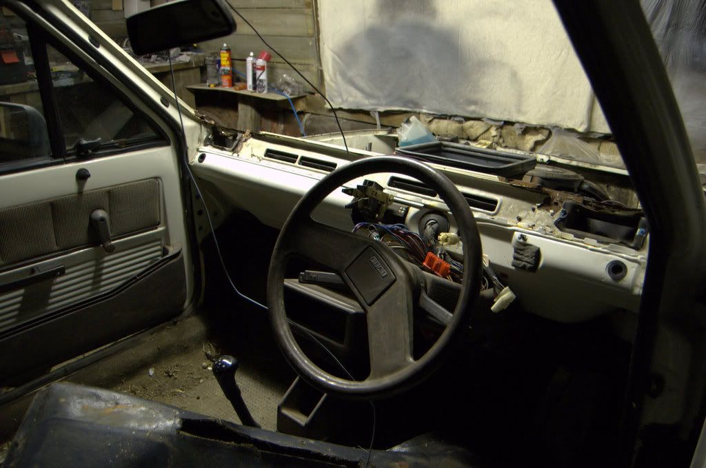

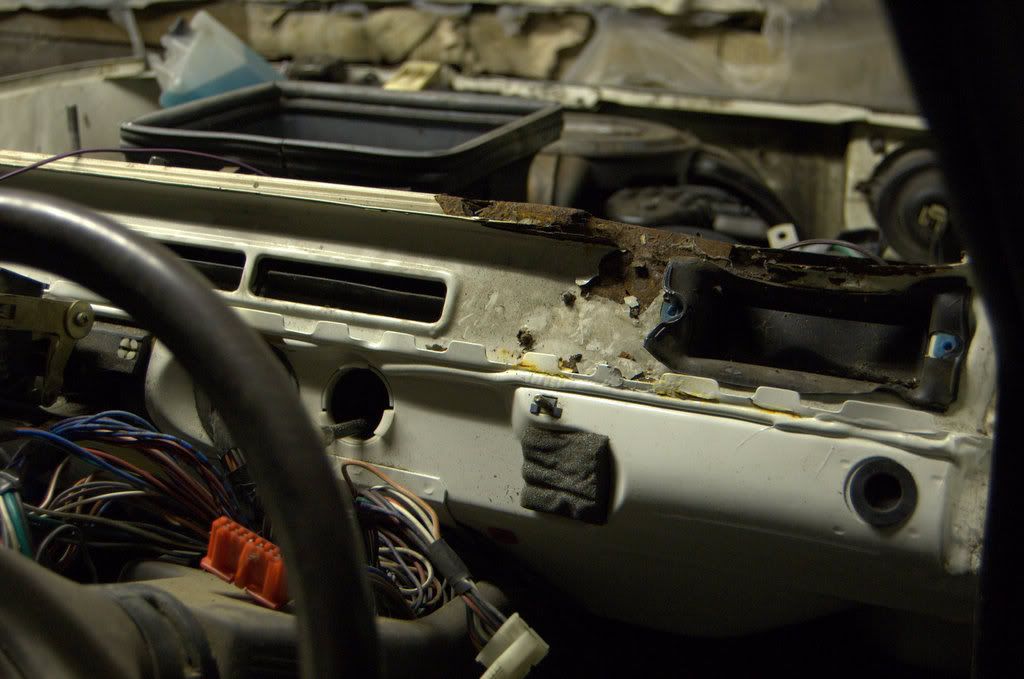

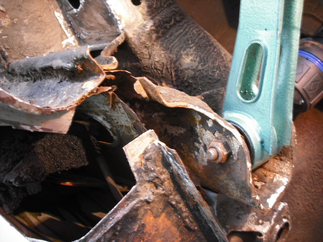

Some more progress tonight, I managed to get the dash out, cut my self several times and got to see just how far the rot has gone.
The good news is its limited to the top section, the bulkhead/firewall is sound. With the engine out I should gain good access.
So, the question remains, as there are a fair few mounting points for vents, does any one have a scrap panda that I can cut this section out of?
The second photo shows it best. I need the section just above the carpit "castle" retaining bits.
Its the complete upside down "L" section I need where the vents sit in, the scuttle pannel screws in and the window sits on top off.
I will pay a good price for this part....

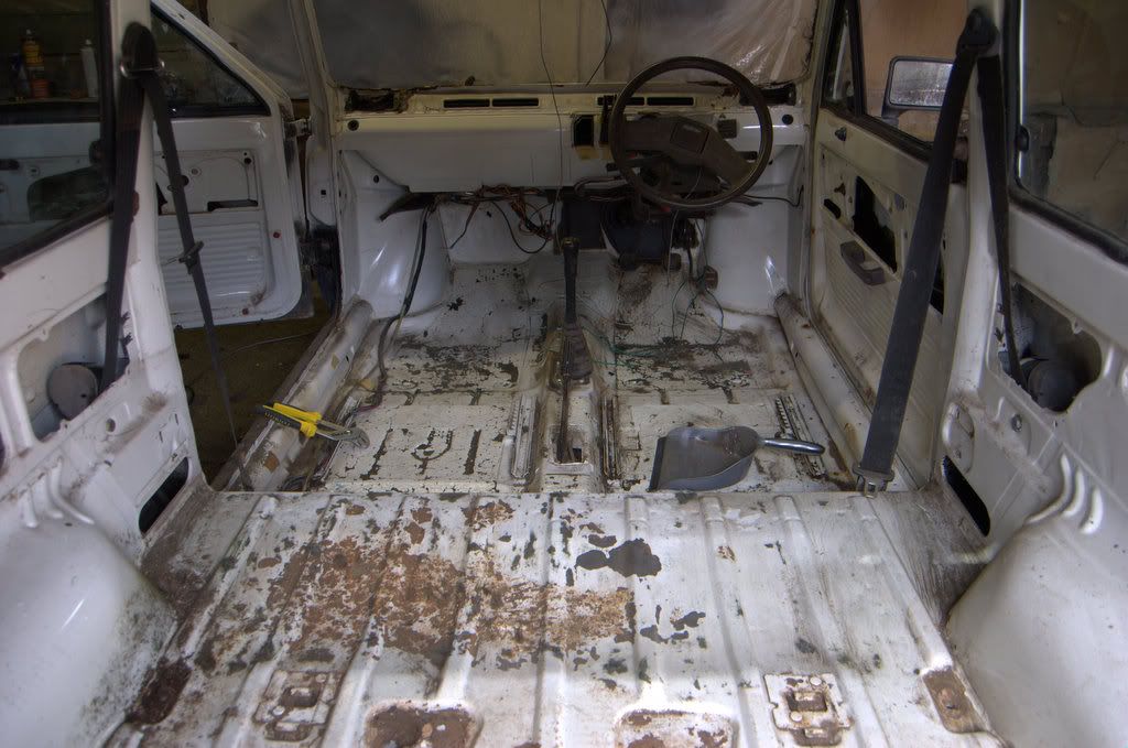

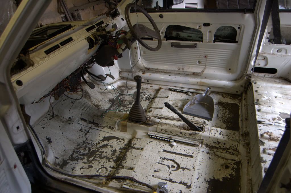

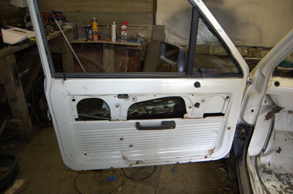

Today was spent continuing to strip her, make notes, photos, bag and tag every screw/bolt/nut In all honesty, that's what's really taking the time at the moment
Today I:
Got the front carpet out
Removed sound dedining bulk head
striped front doors
striped rear section of car
removed rear light clusters
Removed rear mud gards
Removed rear wheel arch liners
Removed rear glass (VERY easy :D)
Removed drivers side plastics
Then cleaned the inside out best as I can but will continue tomorrow with compressed air to make sure all the, well soil and straw are gone. I filled a complete wheely bin bag with crap today :eek:
Some photos (I have 100's but your not interested in bolt locations ect)
I also had time to take a sander to the rear after the photos and tidy up the surface rust where the wet hay had been (n) Looks much better now

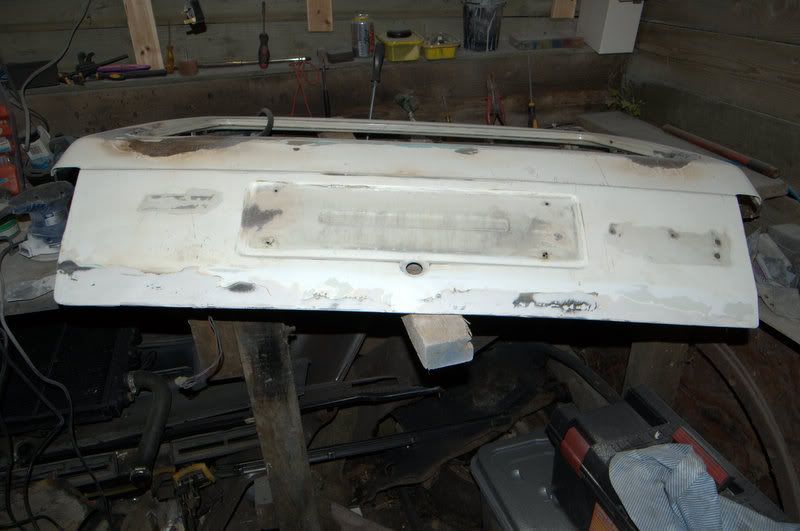

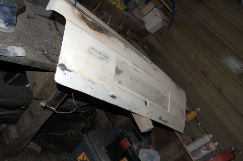

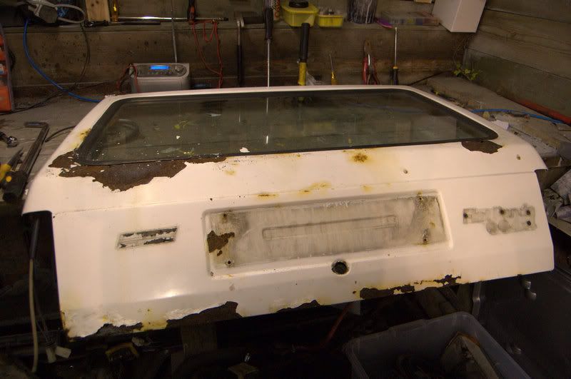

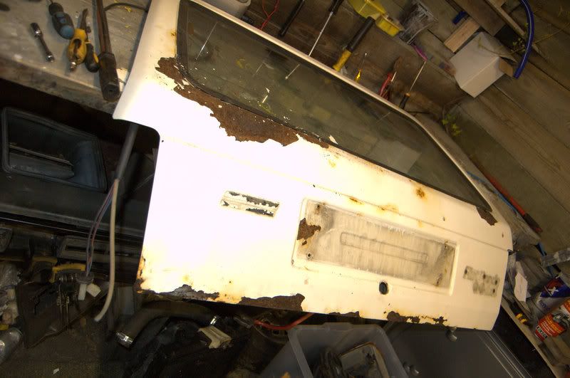

Well its nice to make some REAL progress instead of simply pulling stuff apart.
Originally I was going to just scrap the boot lid as it was in my opinion far to far gone.
I was however told (and then looked) that the mk1 panda boot lid was different to the others as its got the number plate indentation.
So, with that in mind I have spent two evenings attempting to save the one I have :(

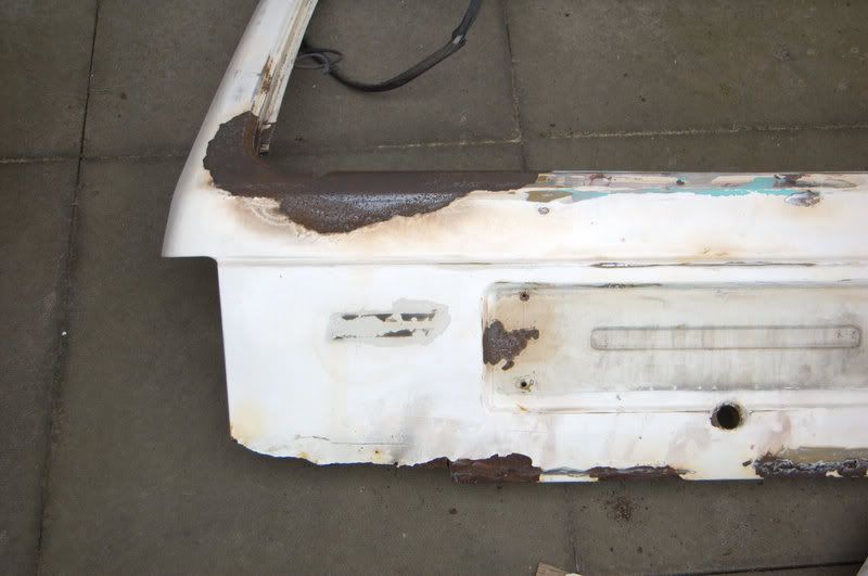

So I started off with this (I told you it was bad)

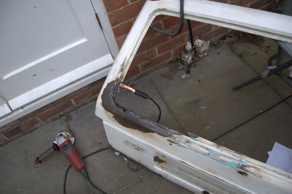

Then its angle grinder time, no point peeing about, bad metal cut out
Then its making template and cutting sheet metal, oh the joy

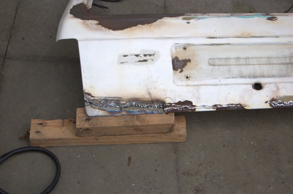

welding
more welding
Im not very good at it yet, ill be taking a night course soon

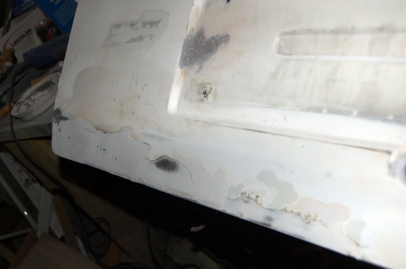

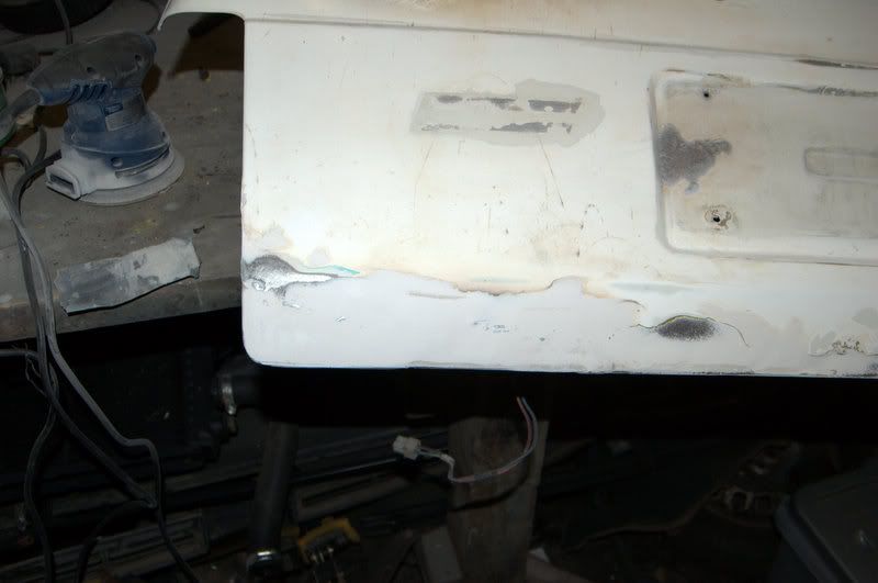

First stage of final tidying and some filling
Hopefully ill have it finished tonight, its safe to say this is by far the worse rust on the car :(
