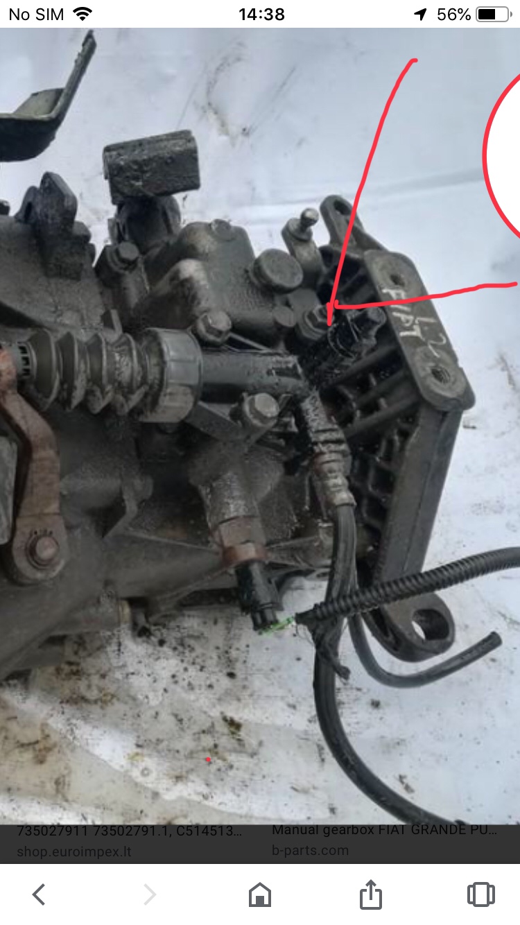

Bought a real grafter of a little Panda due to circumstances.
Struggling with gears selection and came across this post.
Now here is the issue
Lots of play in gearshift end 4th is where reverse should be about.
There is No 13mm bolt on mine. Looks like it was welded.
So currently having to drive in 1st, 2nd and 4th only
Sometimes with lots of grinding it will engage 3rd.
New gearbox? Or can it be fixed?
Thanks guys
Hi KoalarLet's try and isolate the problem
And see if I understand the problem correctly
Does the gear stick feel right moving up and down, but sloppy left to right
Does it feel any different if you try and select any gears with the engine off
Is there someone that can help you while they move the gearstick you watch in the engine bay
Any recent worry done on the gearbox or clutch to your knowledge
Has the problem suddenly happened or gradually got worse
