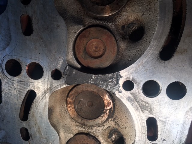

Just epoxied it 🤣
My door mirror
Rear mirror
cylinder head and block
Are all held together with original slow cure JB weld epoxy
Has to be clean
Has to be rough

My door mirror
Rear mirror
Has to be clean
Has to be rough
