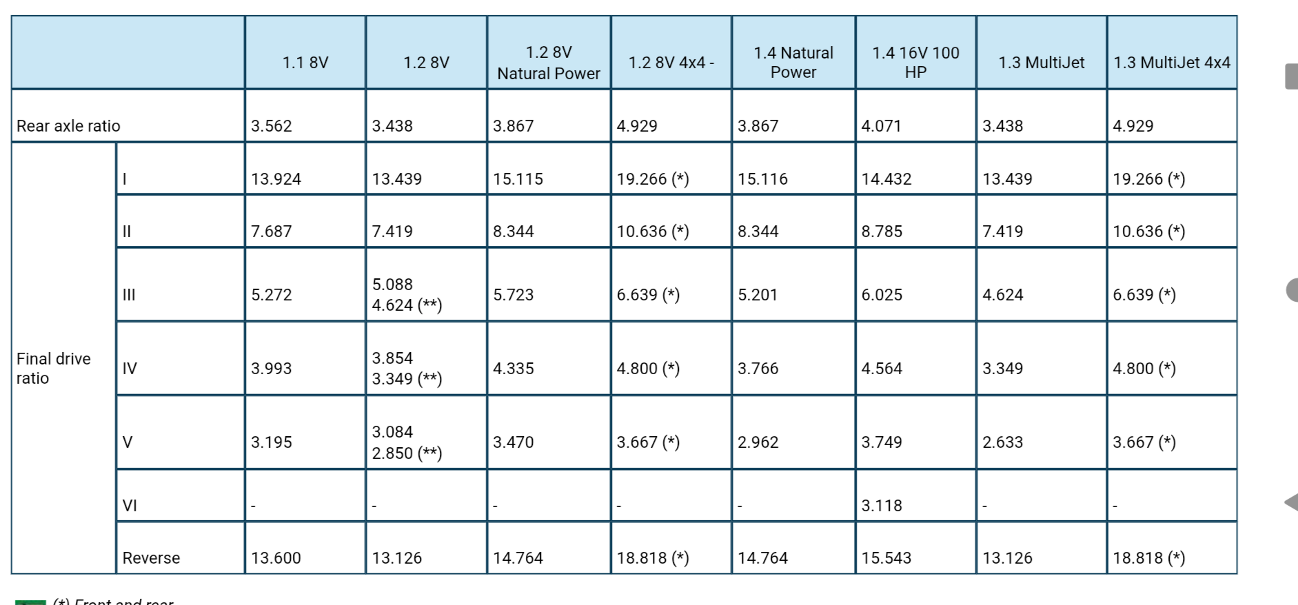

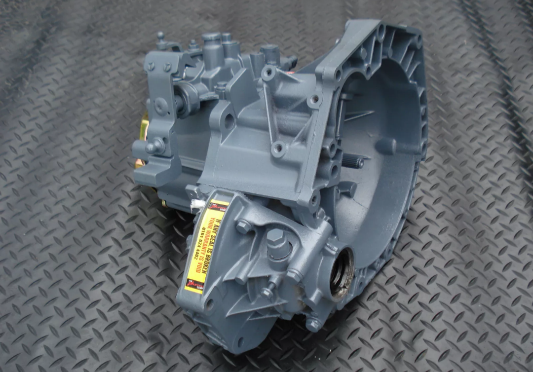

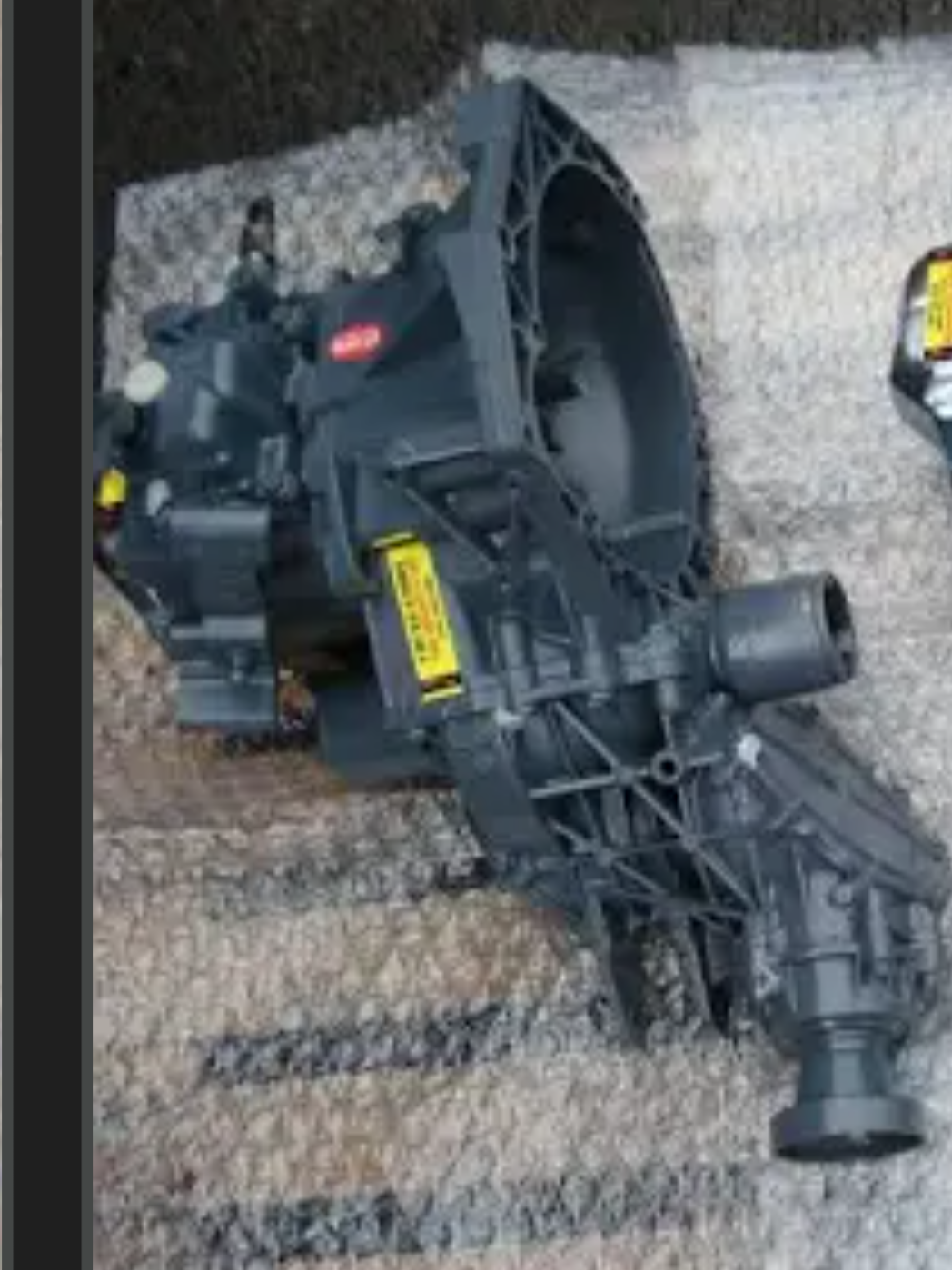

Is the gearbox for the 4x4 the ratios are different and the bell housing castings are different
The drive and the idler unit are in a unique differential half casing matted to a standard gearbox casing.

Thanks for your reply Koaler. Your advise is appreciated.
My local scrap dealer said it's the same gear box so I'll go and pick it up tomorrow.
