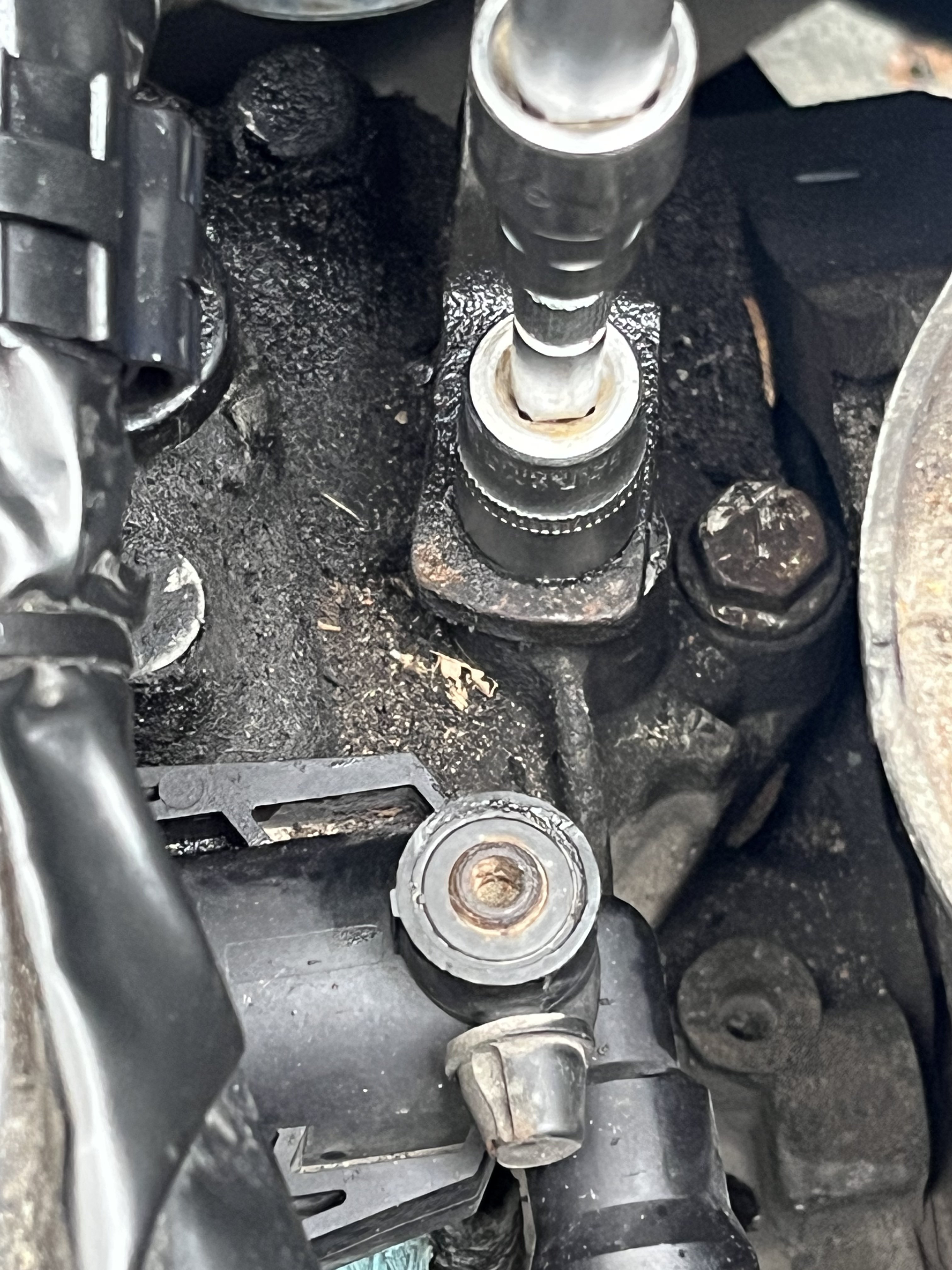

Difficult one to be sure as I never touch that bolt
Is suspect it’s going to be similar to this
Where after dropping the shaft it got out of sync.

It’s got a ball joint with a thread I’ve tried adjusting both sides but I’m willing to listen because I’ve probably done it wrong I did undo the lever though an the shaft went in but I pulled it back out an made sure the square went back into the slot in the lever an tightened it back up

Has it got anything to do with me taking the gear selector lever off
Put it into 3rd gear,put a 12mm or 13mm open ended spanner,and pop the ball off the plate,(gearbox end) and adjust the ball joint longer/shorter so the gear lever moves closer to first position. One way makes it better,one makes it worse. Can’t remember which way to adjust it!
no,it’s adjustment issue,as you have gears,if there was an issue,it would be stuck in a gear,and you couldn’t drive car as two gears engaged at once would Lock the gear box making it impossible to move/drive. I take it you’ve put new cables on?
I’ll try that tomorrow an yeah new cables as it was starting to get stiff when changing gear
Adjusted it still no reverse or 5th adjusted both ways now in your thread before you said about when the shaft goes in takes 35/40 mins to sort has that got anything to do with it sorry to badger you pal can’t find anyone to help on a weekend

So... the Rod dropping down has no effect as long as it returns?

I suspect that the large lever on top of the gearbox isn’t properly lined up with the little lever
It would require cleaning and sealing with RTV so am reluctant to suggest this until all other option are exhausted
Ok I wonder if it has dropped down and then turned and is no longer engaged properly inside the gearbox …. Someone said that might of happened?
