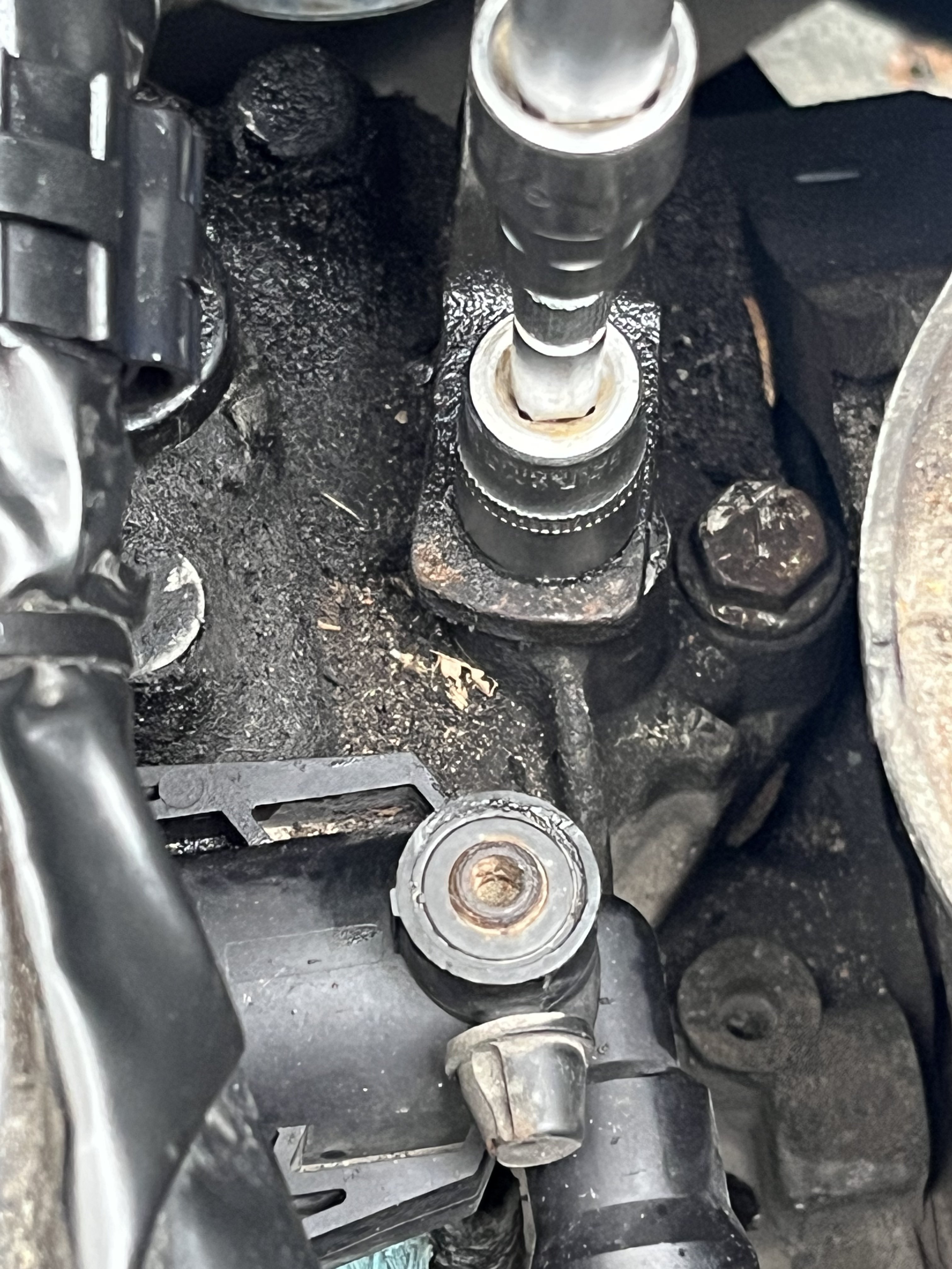

I’ve took the selector lever plate off an now I can’t get 5th or reverse how do I fix it thanks
Are we talking about the little bracket the cables slot into or the big plate on top of the gearbox
That thing my sockets on
Difficult one to be sure as I never touch that bolt
Is suspect it’s going to be similar to this
Where after dropping the shaft it got out of sync.
We really need @multipete to chime in but they have been active lately
