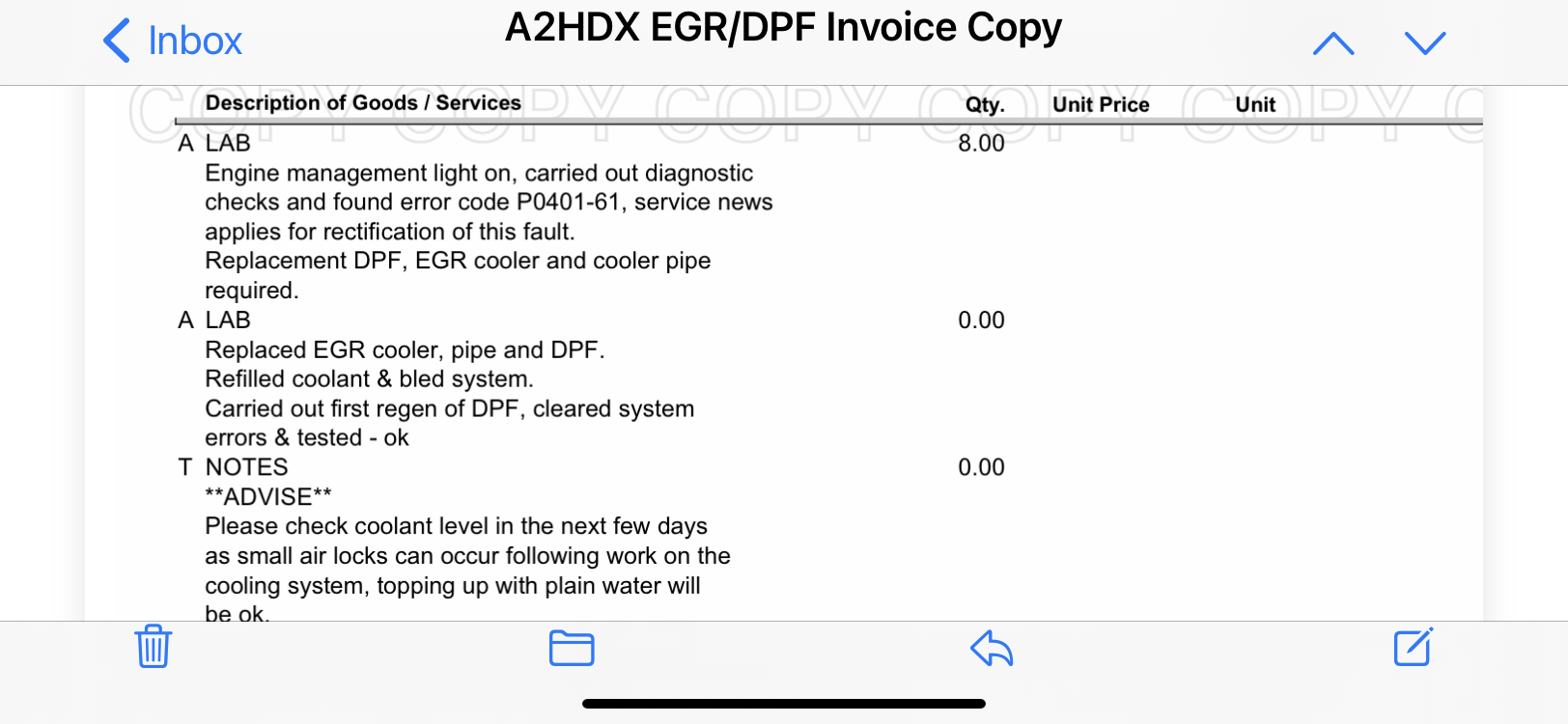

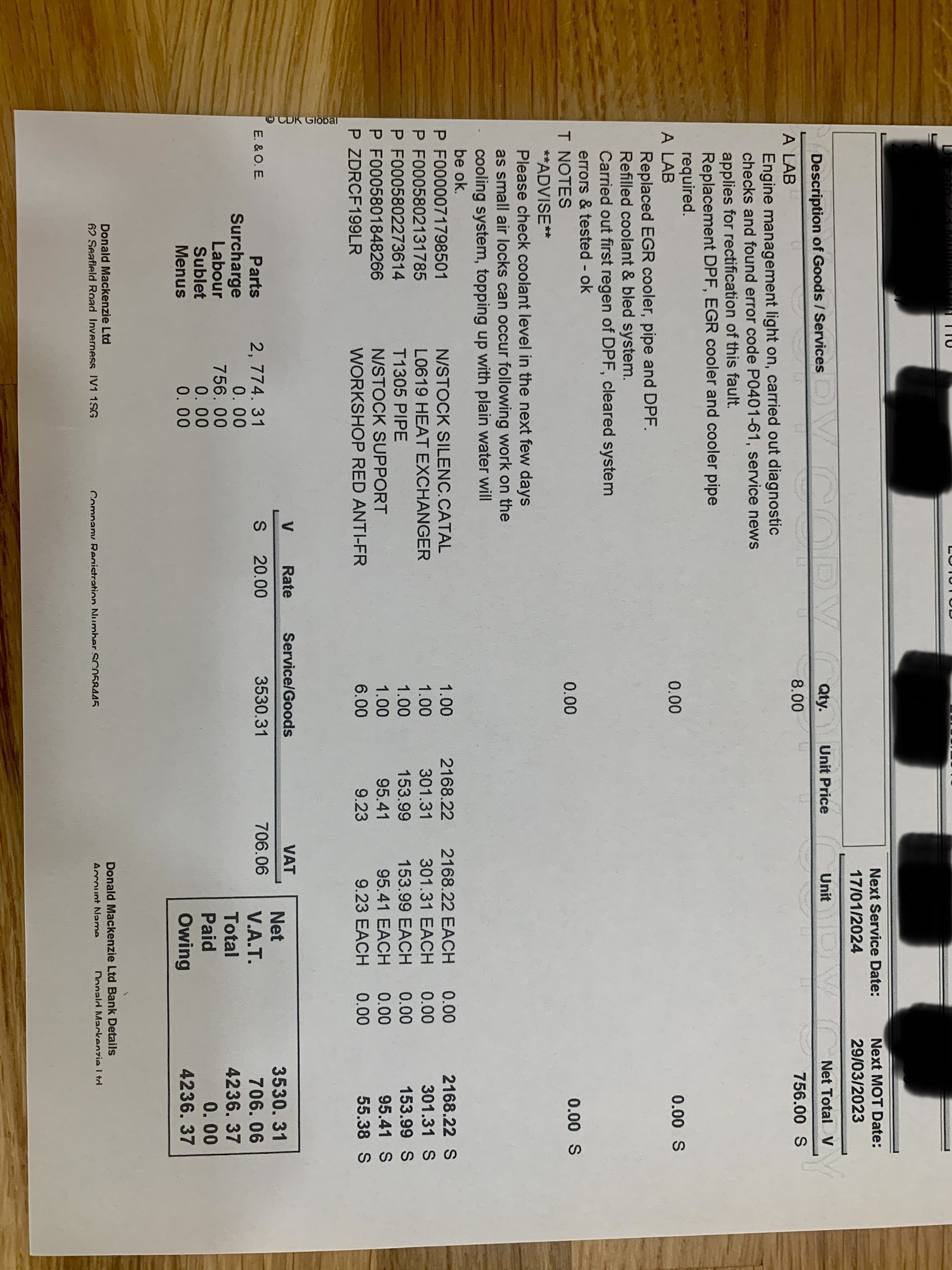

This was just done last week and I’m very hopeful, and garage that done it Donald and Mackenzie of Inverness were great cost around £4000 , I was luck as I had a guarantee , I have the parts that came out and they are bad, well black with soot etc 😊👍

@Shugzter do you by chance have an invoice with part numbers? I'm interested to establish if you have a new DPF or whether it's a factory exchange service. The repair bill looks very low on price. It would be good to know if replacement DPFs are built stronger/ better.

Here it is ,
Hope this helps
How do I do that now?
There is a button to 'report' then the admin should delete the photo, it would be good then if you could add a new photo with all the parts list yet missing your top detail of van ID etc that we we have he info yet your details are hidden safe. There are dozens of us worldwide with this engine fault so we do need to help each other. Thanks for the info tho
