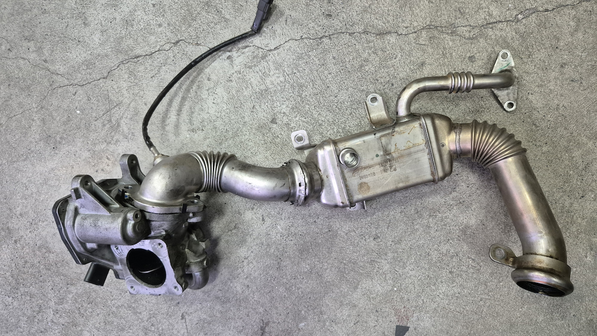

has this photo of a blocked cooler cut in half
Doesnt look too bad. I dont believe replacing is required generally - cleaning with break cleaner and compressed air is sufficient. The sieve holds up particles that could harm - even oil and
I think this is an example of a very blocked cooler the 8 channels (with bent tubes ) have coolant passing through. the outer chamber has the gases passing through with "black stuff" condensing in the channels.
A different cooler blocked sieve.
